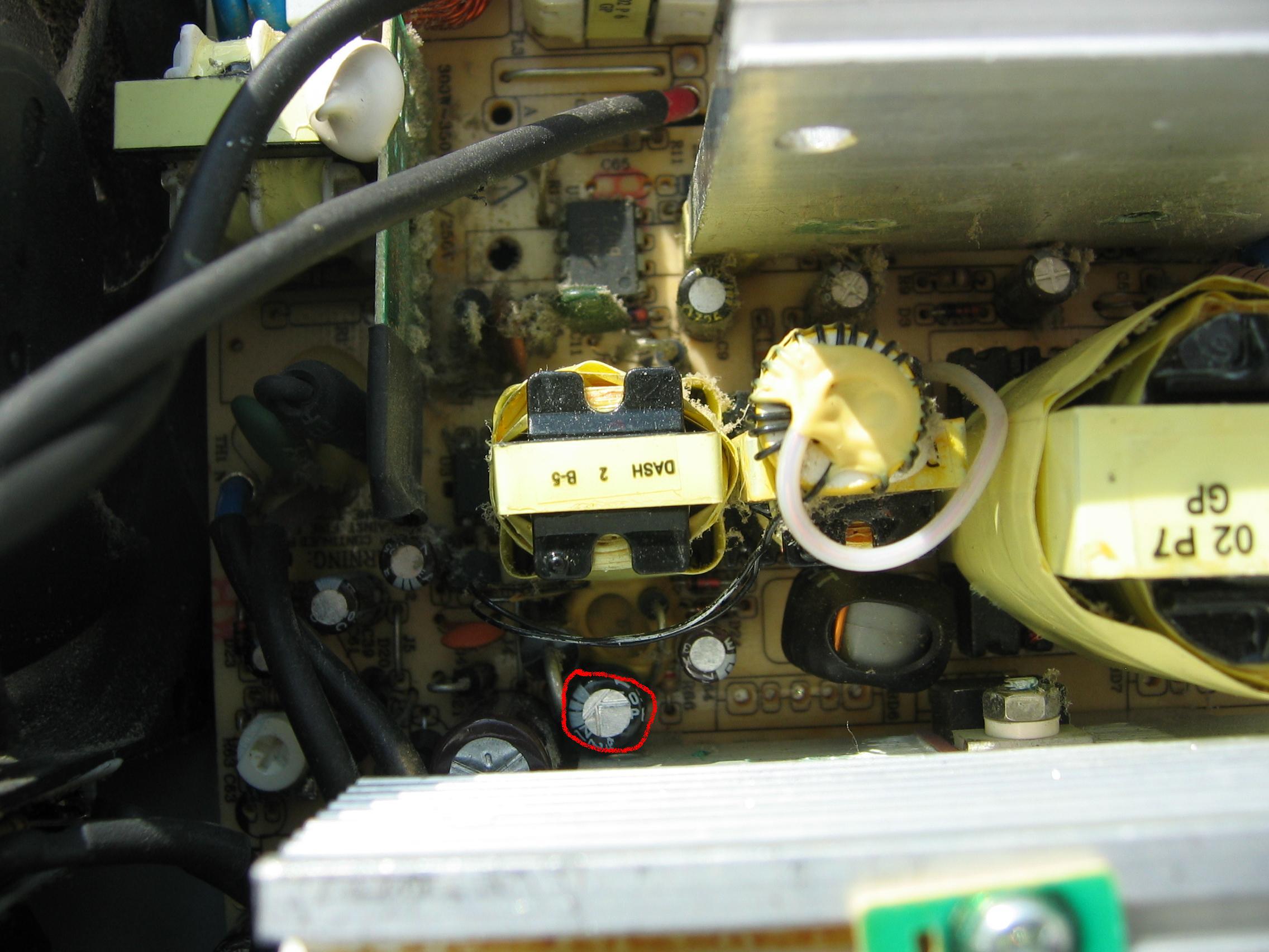

                  So I got a bit of movtiation after reading your response and decided that I would take another crack at it with the existing tools I have. I didn't desolder the wires, but instead, pried the cases back a bit so I would have more room to work.
                  Since I wasn't going to build a LED power checker, I decided to try and use min/max and manual range mode on my multimeter. The Fluke also has a bar graph that updates 40/seconds.
                  So with all those settings, I was hoping to capture any brief under and over voltage condition on the schottky rectifiers on the secondary side.
                  Even with all those settings, the multimeter never moved from 0.0V.
                  So I started probing the transistors and found that Q6 (C945 NPN transistor) had 15.76V DC on the collector pin. The good power supply had a voltage of 11.76V.
                  I then traced the source back to a Teapo SEK capacitor rated at 100uF 25V (the pcb designation is covered up), but I circled (red) its location in the picture. I found this out at 1:30am in the morning, but decided not to solder that late at night.
                  I didn't have an exact replacement so I used a Rubycon 220uF 16V ZLH and soldered it in this afternoon. As soon as I hit the power switch the fan started to spin. With an old hard drive and fan acting as load, I got voltages on the rails: 12.717V, 5.0675V standby, 4.9581V, and 3.33544V.

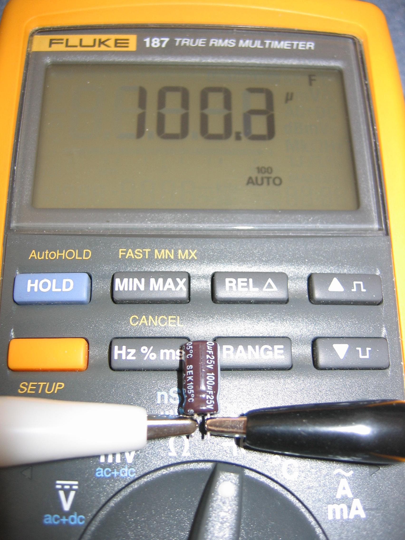

                  The readings for the FSP3528 chip look like the same as the "good" PS.
                  I measured the capacitance of the Teapo and as you can see, it is exactly 100uF. I don't have an ESR meter to measure the ESR.
                  Thanks to everell, Duncanbest, selldoor and mockingbird for helping me learn how to fish in the world of ATX power supplies. I wanted to find root cause rather than blanket and blindly replace all the caps even though they are crap brands.
                  PS. The "good" power supply had a bad 2200uF 10V capacitor on the 5V rail. The "bad" one, in addition, to the bad Teapo had a bulged Capxon 3300uF 16V cap.
                                        That'll be C37...
                                        I read with interest - is the conclusion that this cap just has bad ESR even though it's capacitance is in spec - and this was causing the problem?
