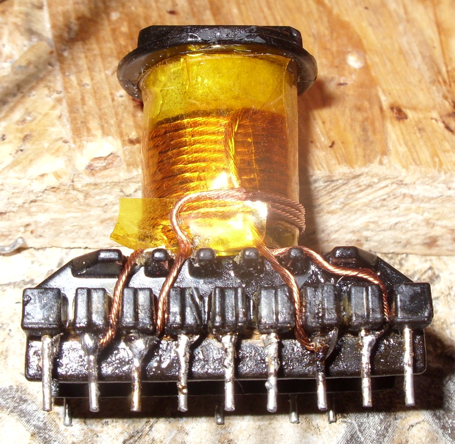

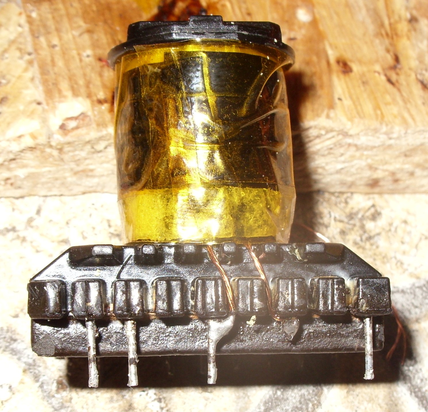

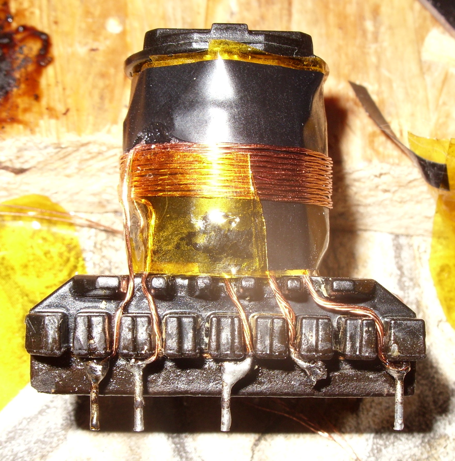

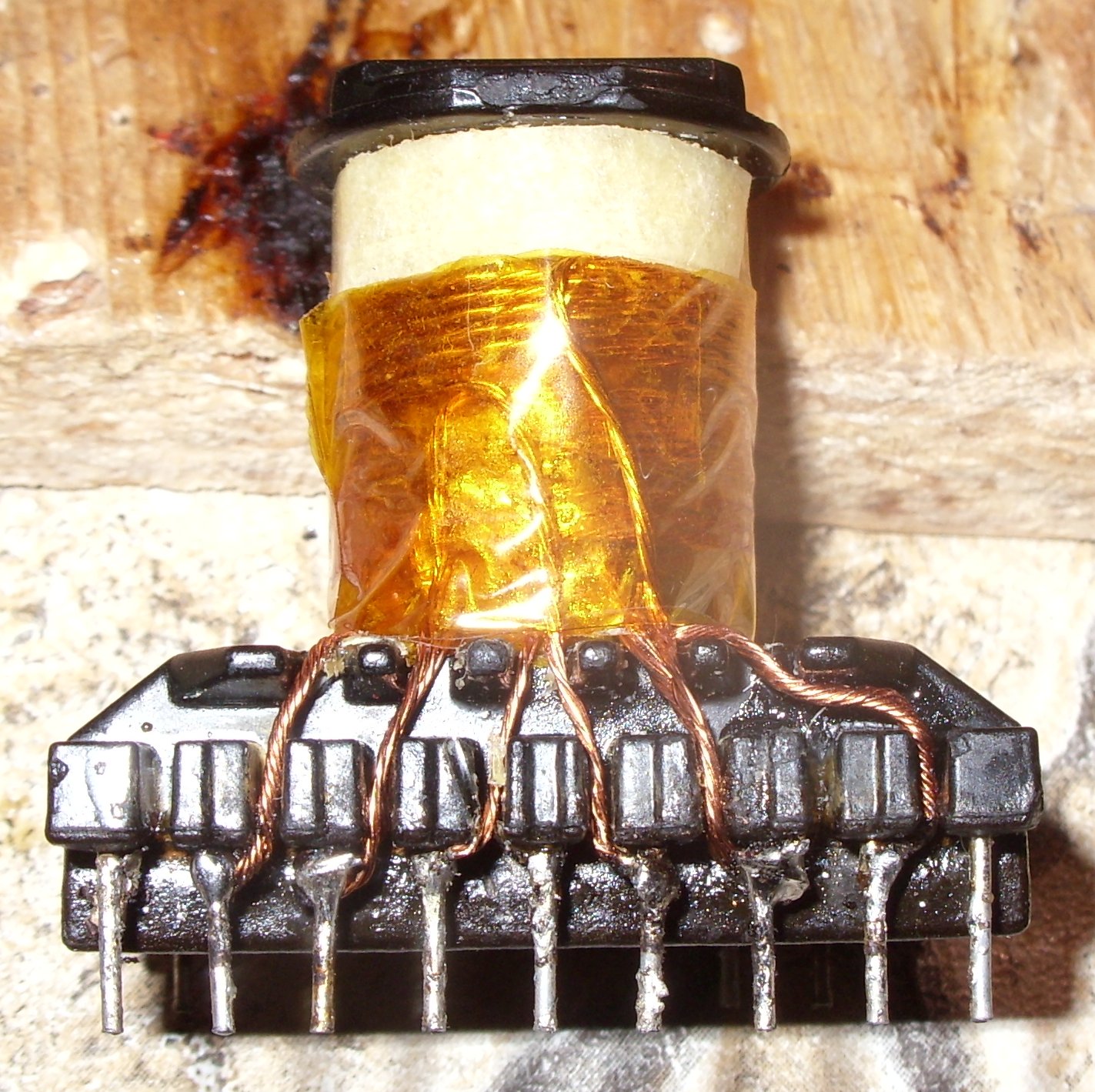

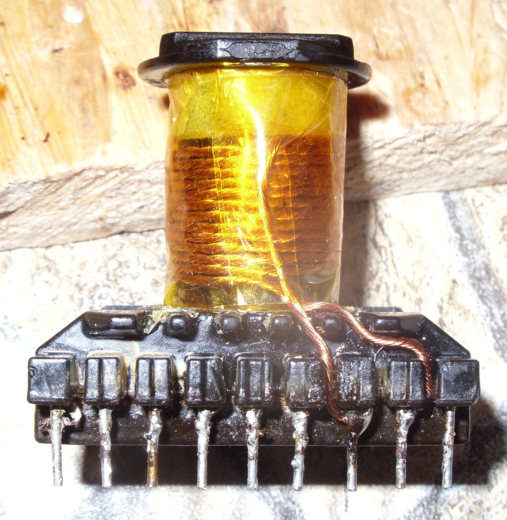

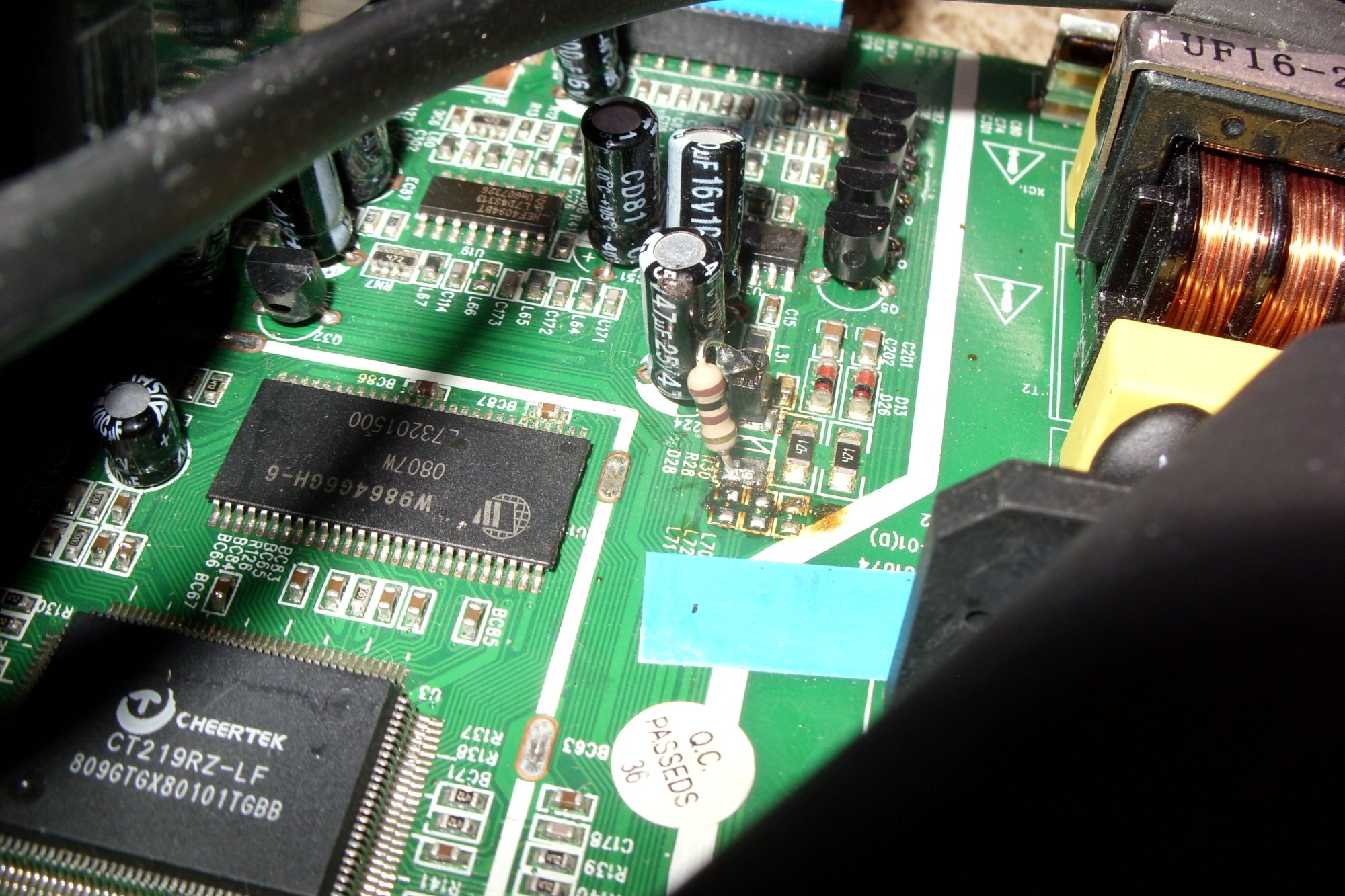

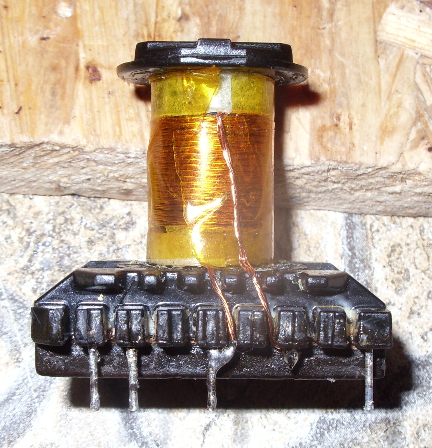

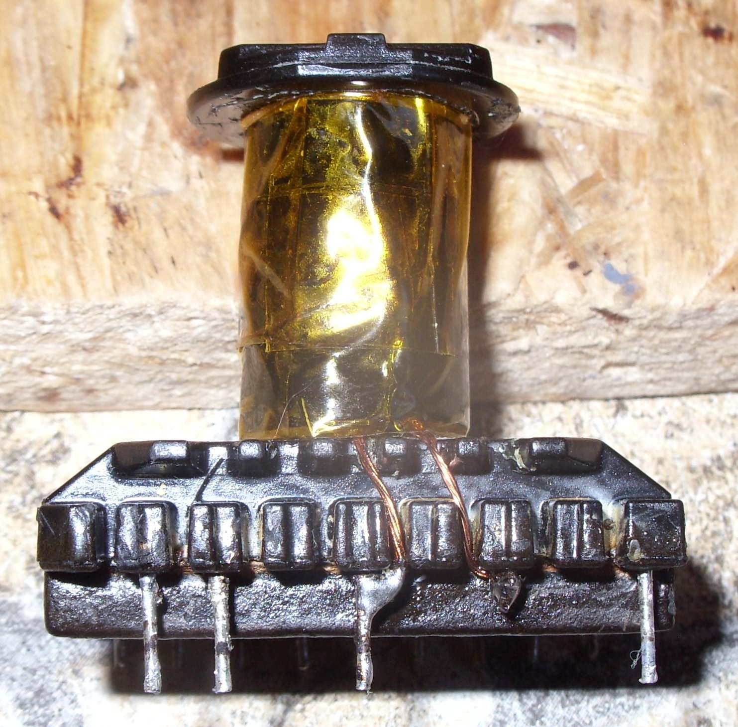

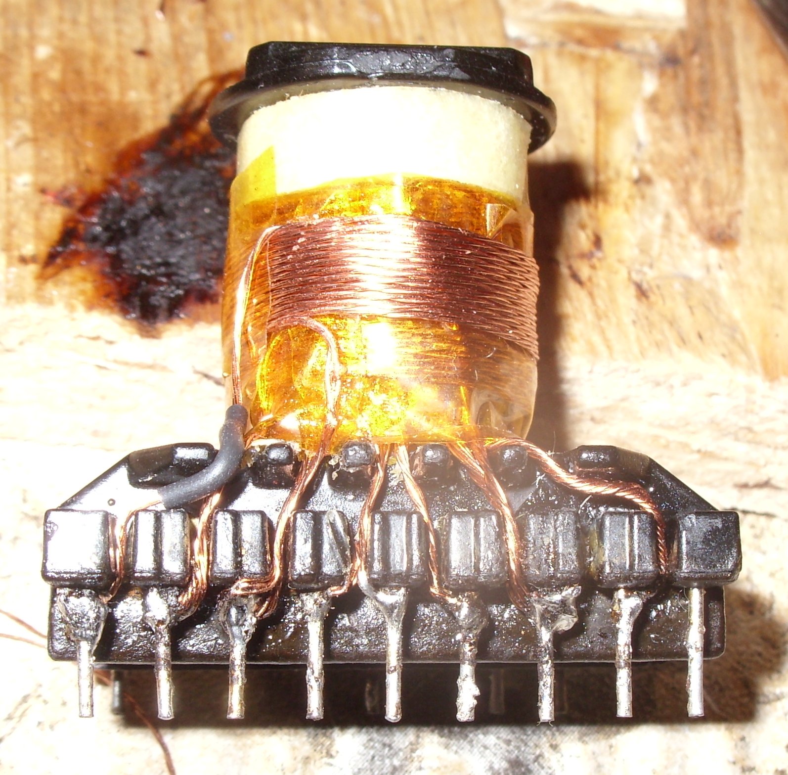

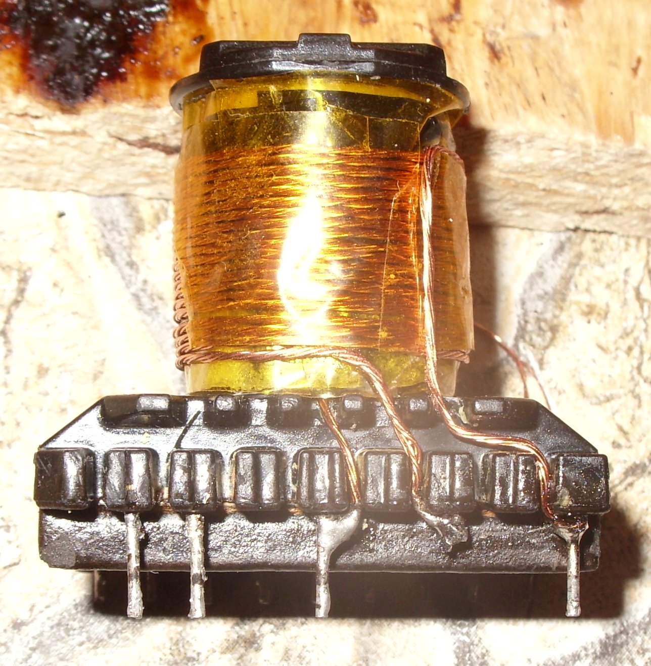

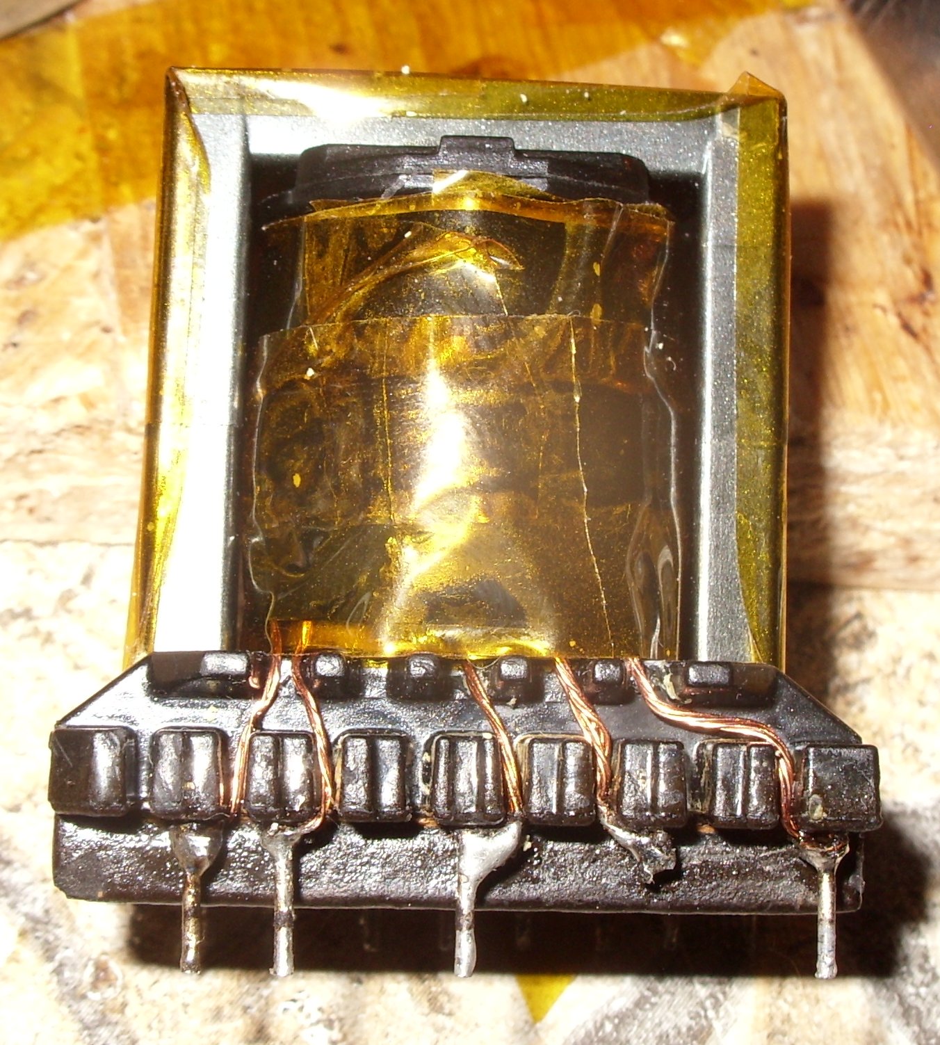

            And... we have ourselves a transformer. I documented every step with pictures for your viewing pleasure.

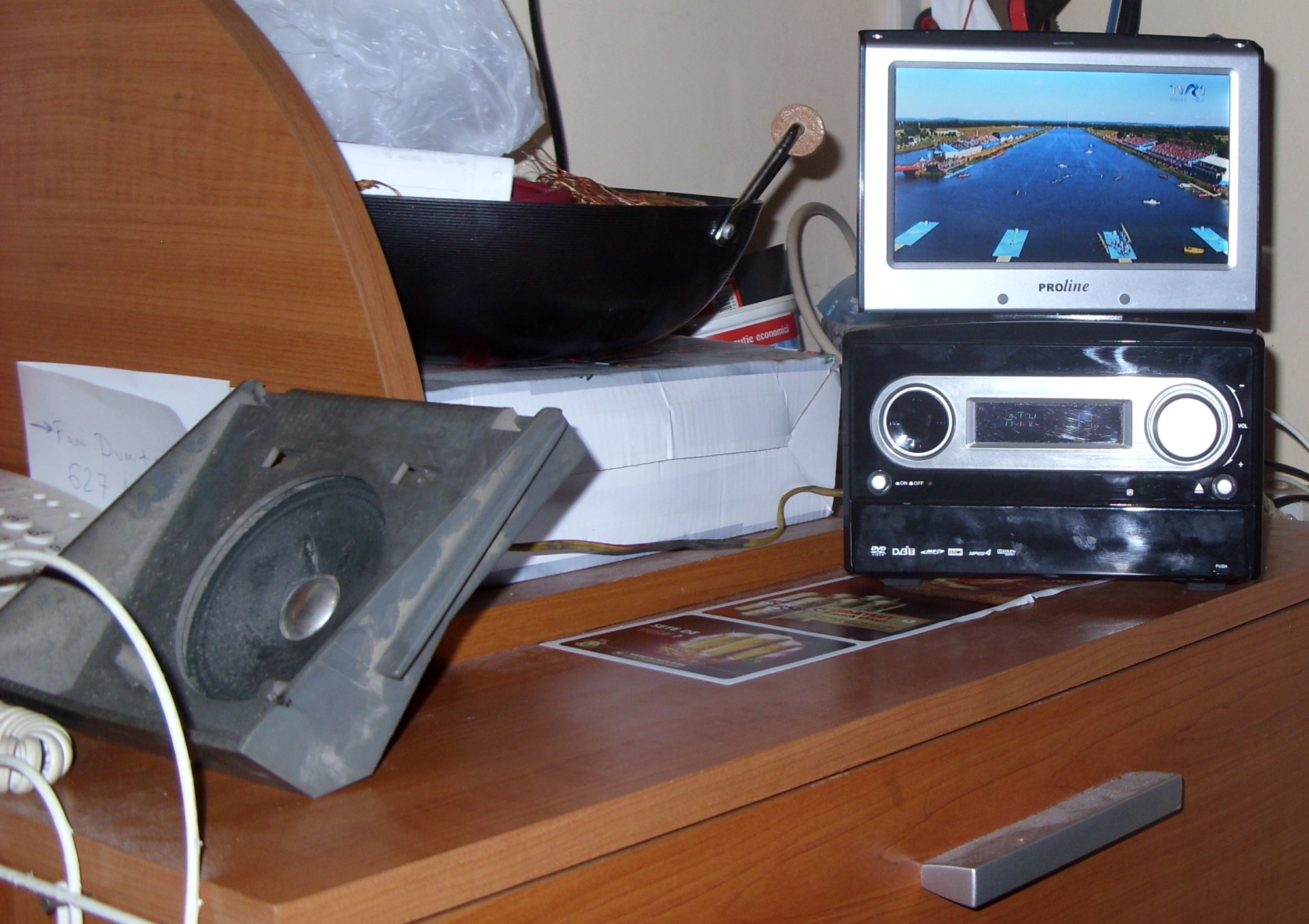

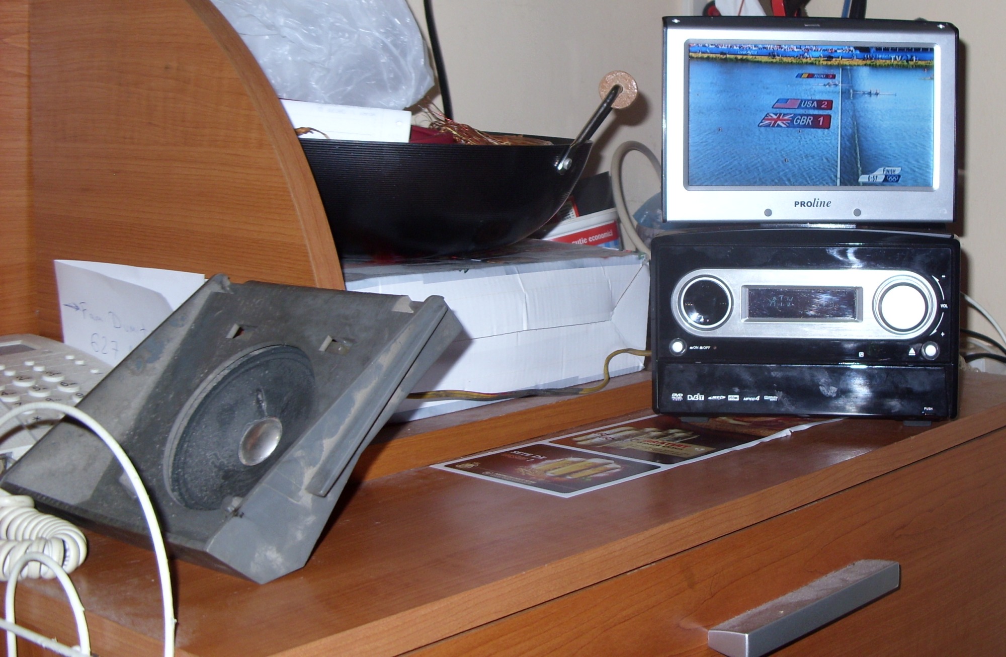

            Dropped it in... and IT WORKS! Everything's working fine, nothing gets hot and voltages are within spec. The only one i screwed up was the one for the VFD filaments - it ended up around 17v and lit the filaments red, and some segments were showing even when they were supposed to be off.
            A 100 ohm resistor in series with the diode going to the VFD dropped that voltage to 8.15 volts, and the VFD is now working great. Sure, it's a cheap hack, but as long as it avoids taking that transformer apart again... i'll take it.

              Sick dude!
              BTW, that 100 ohm resistor will probably burn up eventually.
                That's why i'm replacing it with a 0.5W one tomorrow. There's a couple more resistors that i bodged, including the startup resistor for the controller, so i have to hit the store anyway.
                Now that i know all voltages, i have to say that this PSU design seems even more idiotic than it looked at first glance.
                There are two separate 12v windings on the transformer, with their own diodes and caps and pi filters and everything, one feeding the LCD backlight (the one wound with only one strand of 0.3mm wire, which burned due to the shorted tantalum cap), and one feeding the tuner, which was wound with two strands. PS. I used 0.2mm wire as i have like 100 meters of it on a spool, so the number of strands is different - that's of no concern to you, i did the math. I don't yet know which one of these rails the DVD motors are on, we'll see.
                Also there's yet another separate winding for the VFD filaments (the one i messed up and wired to the wrong place), when they could just have used a regulator from the 12v, or just a plain simple resistor.
                I'll likely parallel the 12v windings - there's no real reason for them to be that way.

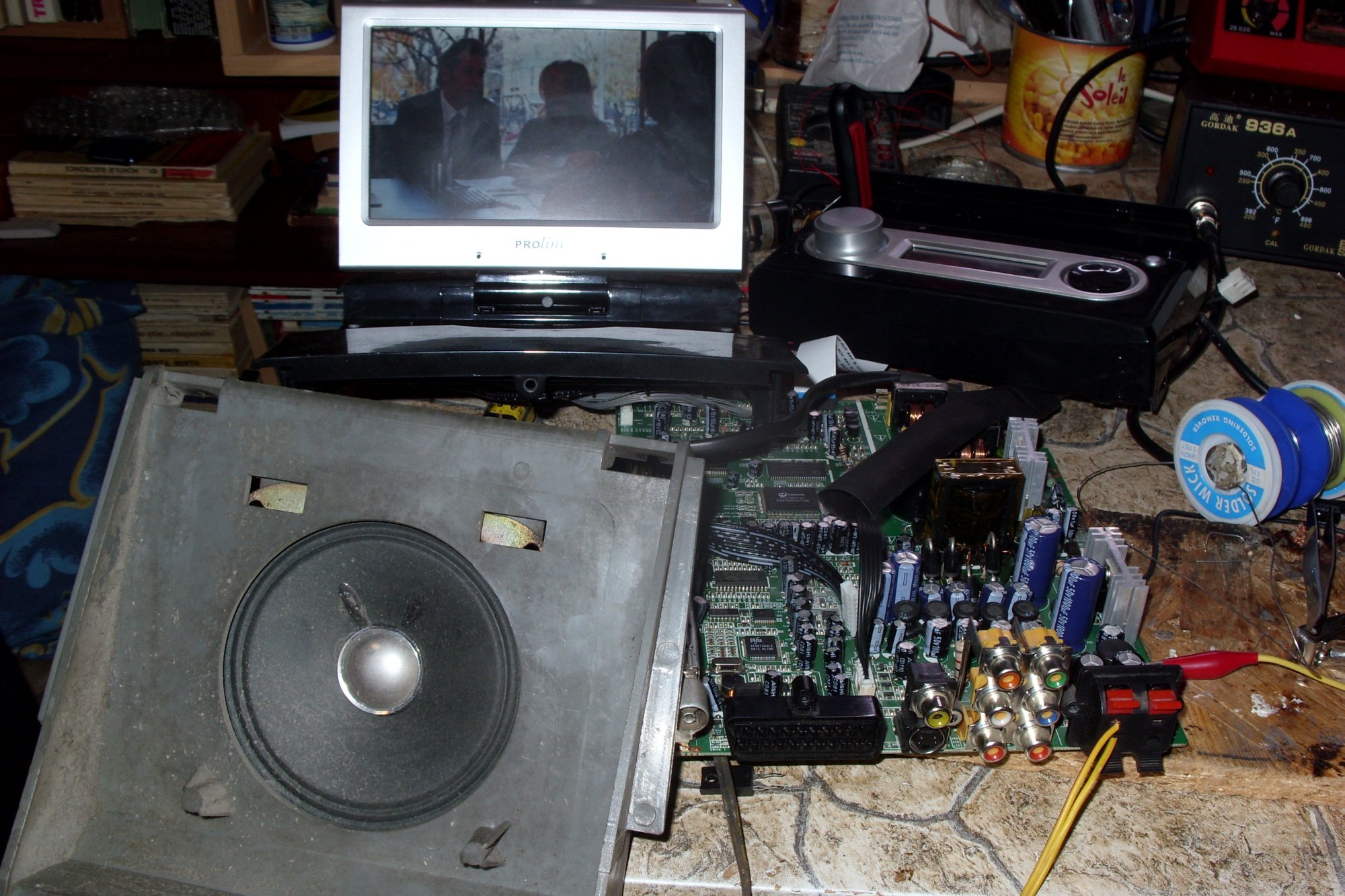

                      Sure thang they are. The 12v winding with the thicker wire is for the tuner, which uses less power than the LCD which is on the thinner one! Also, the "12v" drops to 10.8v when both LCD and tuner are on. I kinda suspected that, since 5v has 3 turns, and 12v only 6... It should have been 7. I know why they did this tho - to make it efficient and cheap, they didn't bother with a minimum load resistor on 12v, and being a flyback, the voltage goes pretty high when neither LCD and tuner are operating. I measured up to 15v as the thing starts up, and 13.4v when the lid is closed and the LCD backlight is off. I can see why that tantalum blew. I tested the one i put in up to 17v, so it should be okay, and anyway, it's all fused now.
                      Anyway... I stopped bothering. Both diodes on the 5v got a 2A automotive fuse each, same for each 12v rail. Job done. I'll be doing the final board cleanup today, putting it all back together, testing the DVD drive, and calling the owner to pick it up tomorrow.
                      I also stabilized the feedback in the thing, which stopped the annoying whine coming from the transformer. After trying almost every trick in the book with no success, i remembered that the datasheet of the UC3842 says you can connect a resistor from Vref to Comp to have more current flowing thru the opto's transistor. A 1k did the trick here.

                          I don't think so. Rather, better noise immunity. I don't really dig the layout of the primary.
                            I always wondered how you do those traffos. Very nice pictorial documentation!
