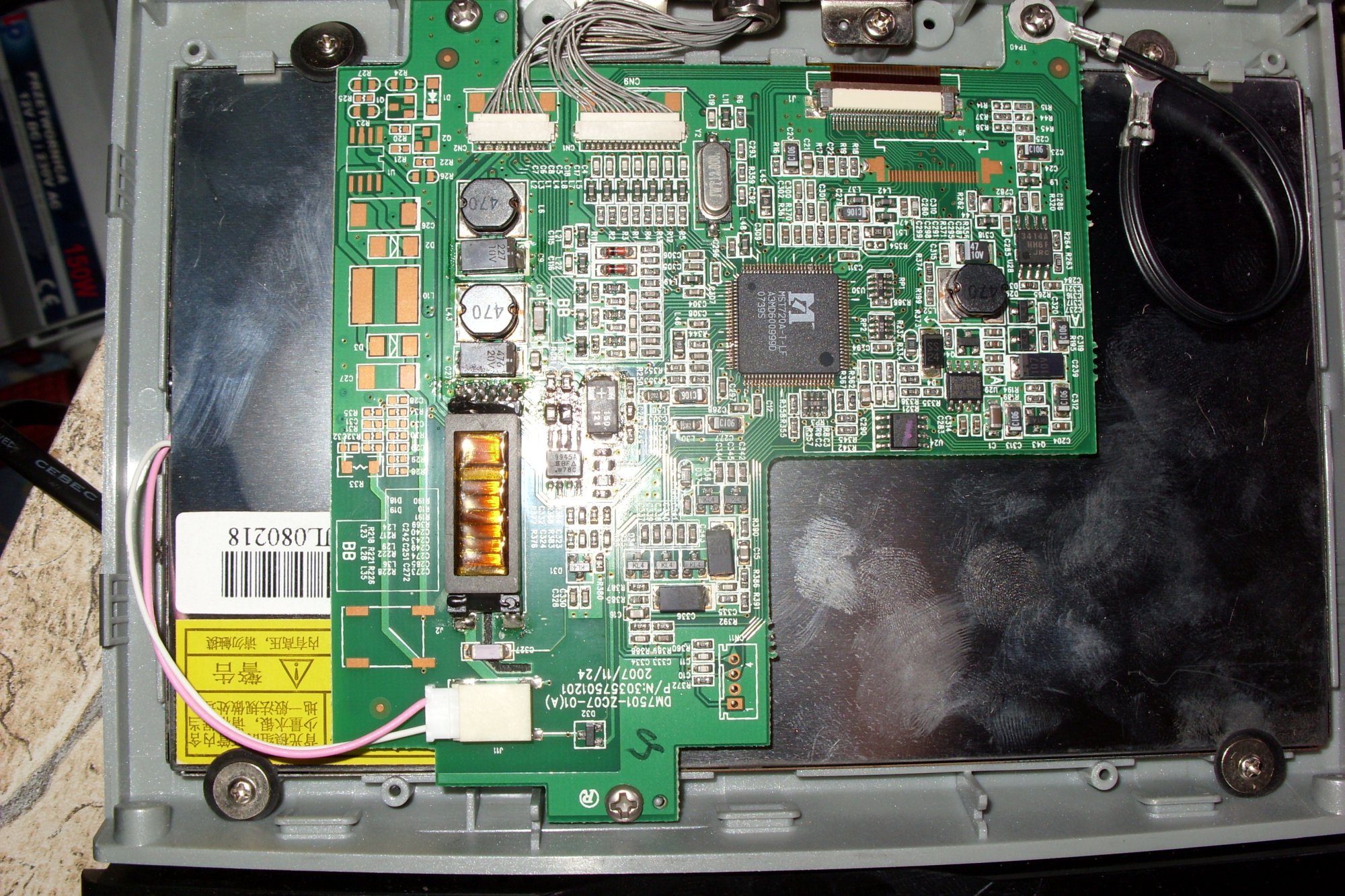

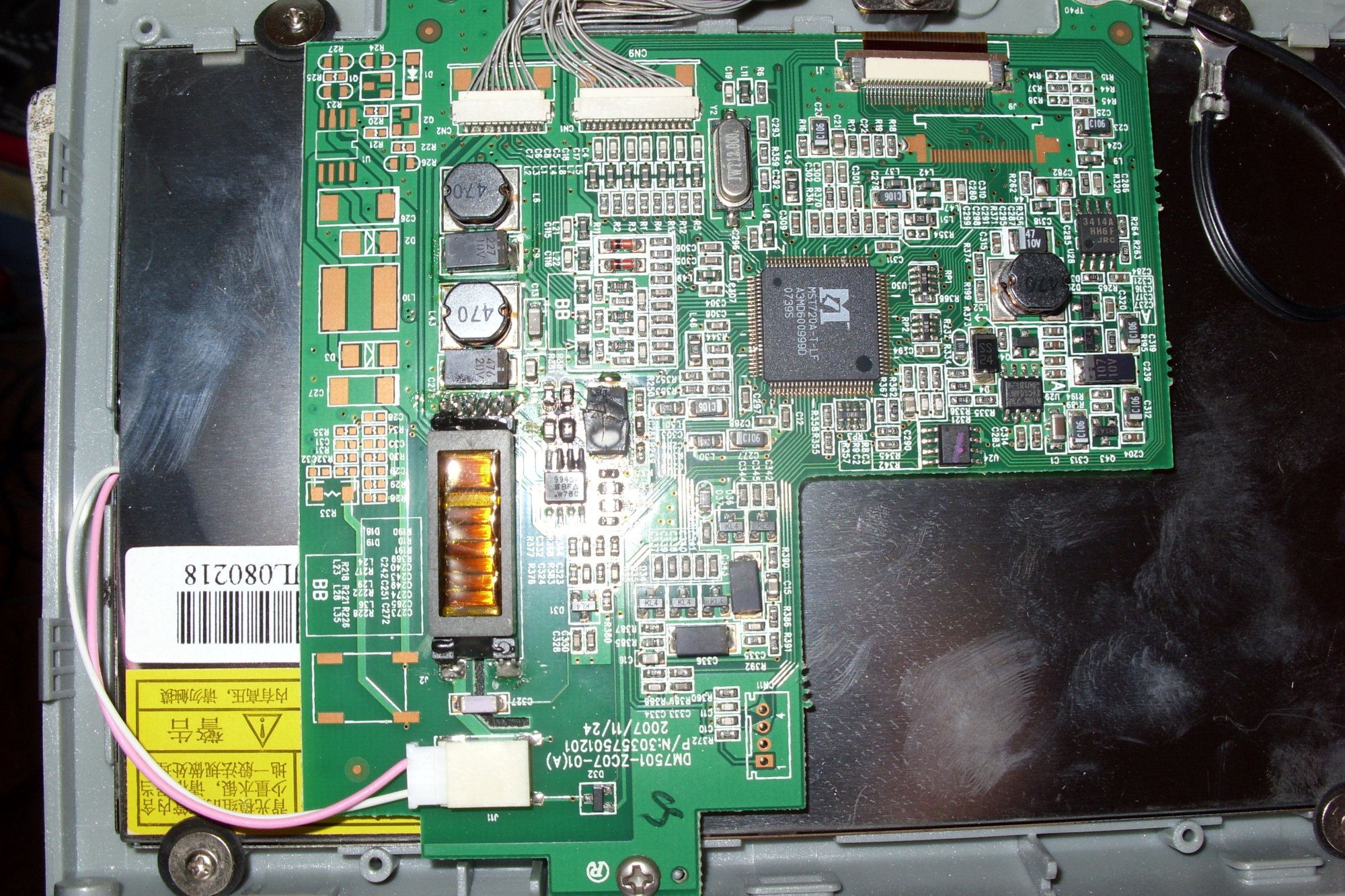

                        Coming back to our stereo here, i took the LCD apart to find THIS (see pic). Yes folks, that is a tantalum capacitor that has blown and gone short. That little bugger killed the whole supply. Had the power supply been better engineered, this disaster could have easily been avoided. But more on that later.
                        It was 47uF/20v. Replaced temporarily with a random 100uF 25v lytic, will search for a better replacement the following days. Everything's working fine now, all that's left is to rewind that transformer.

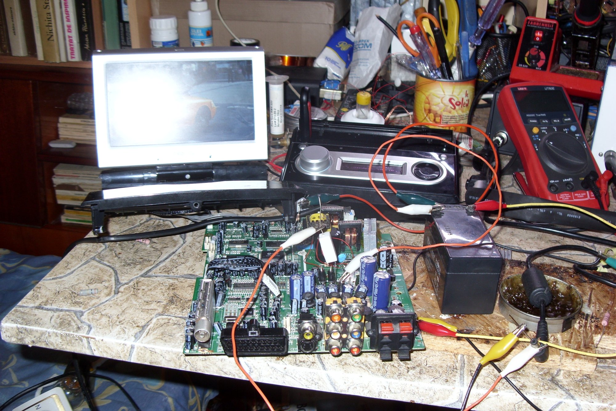

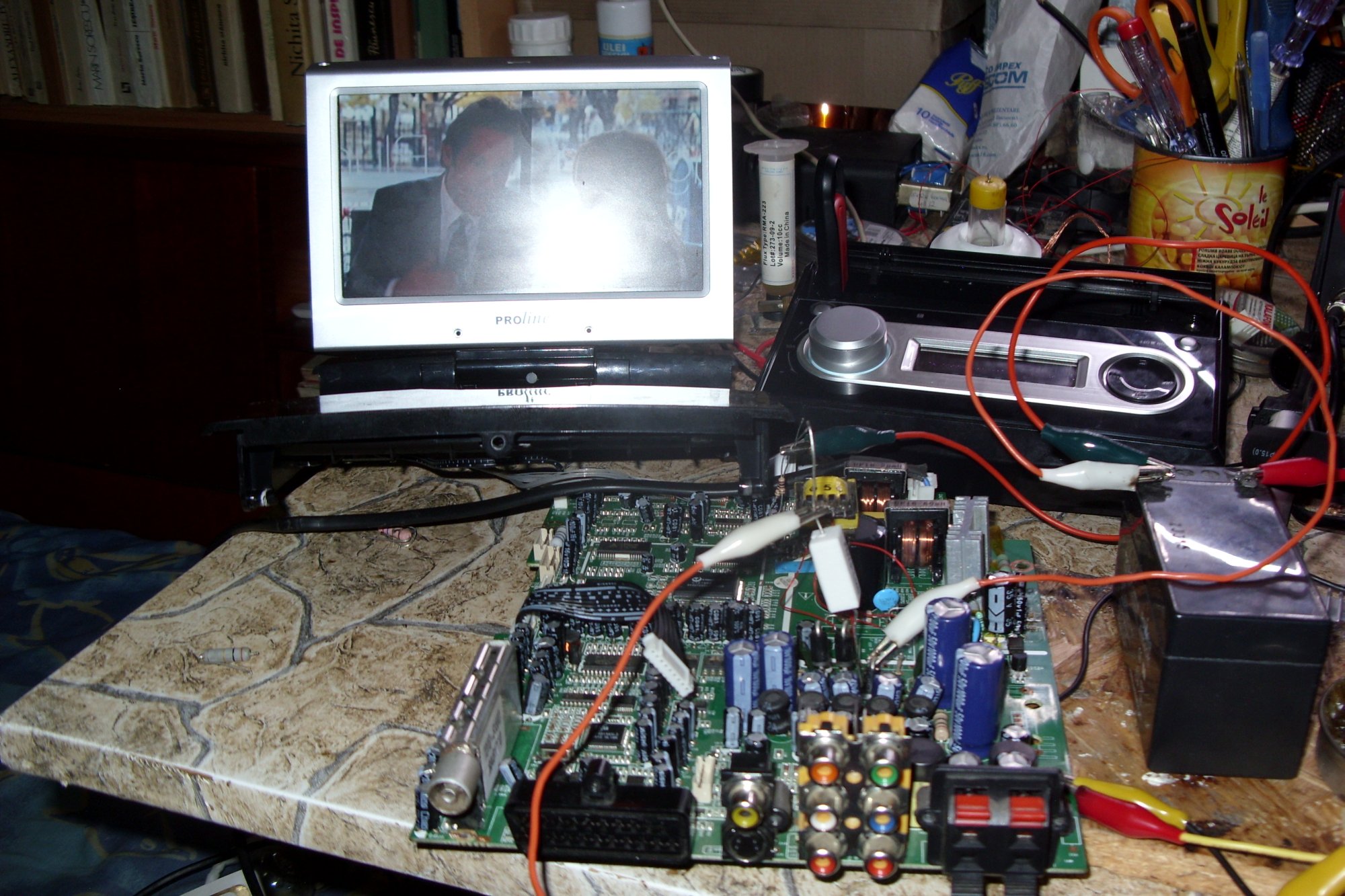

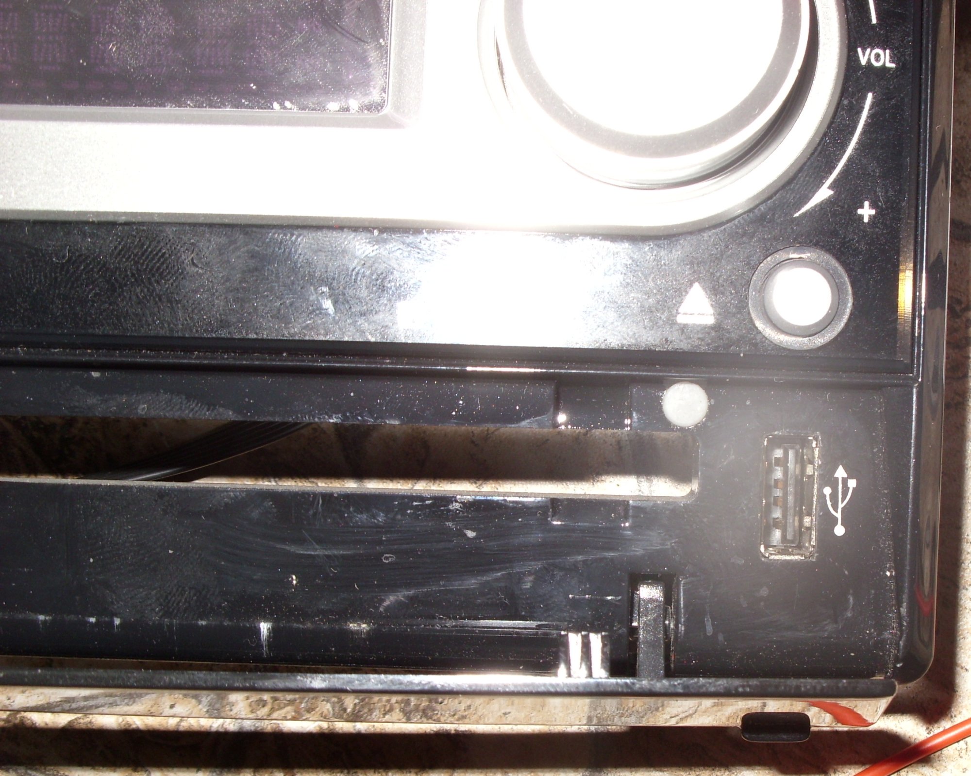

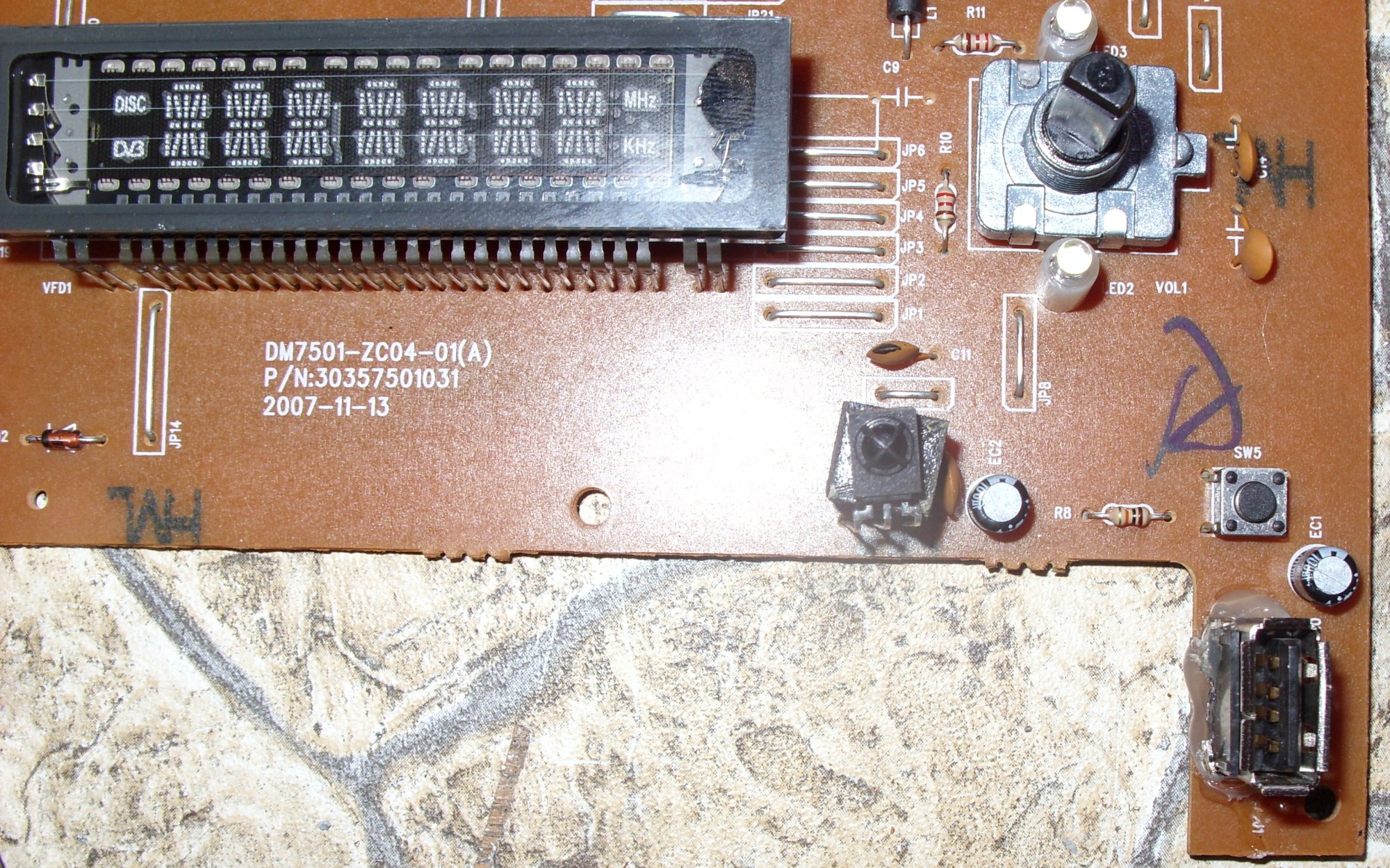

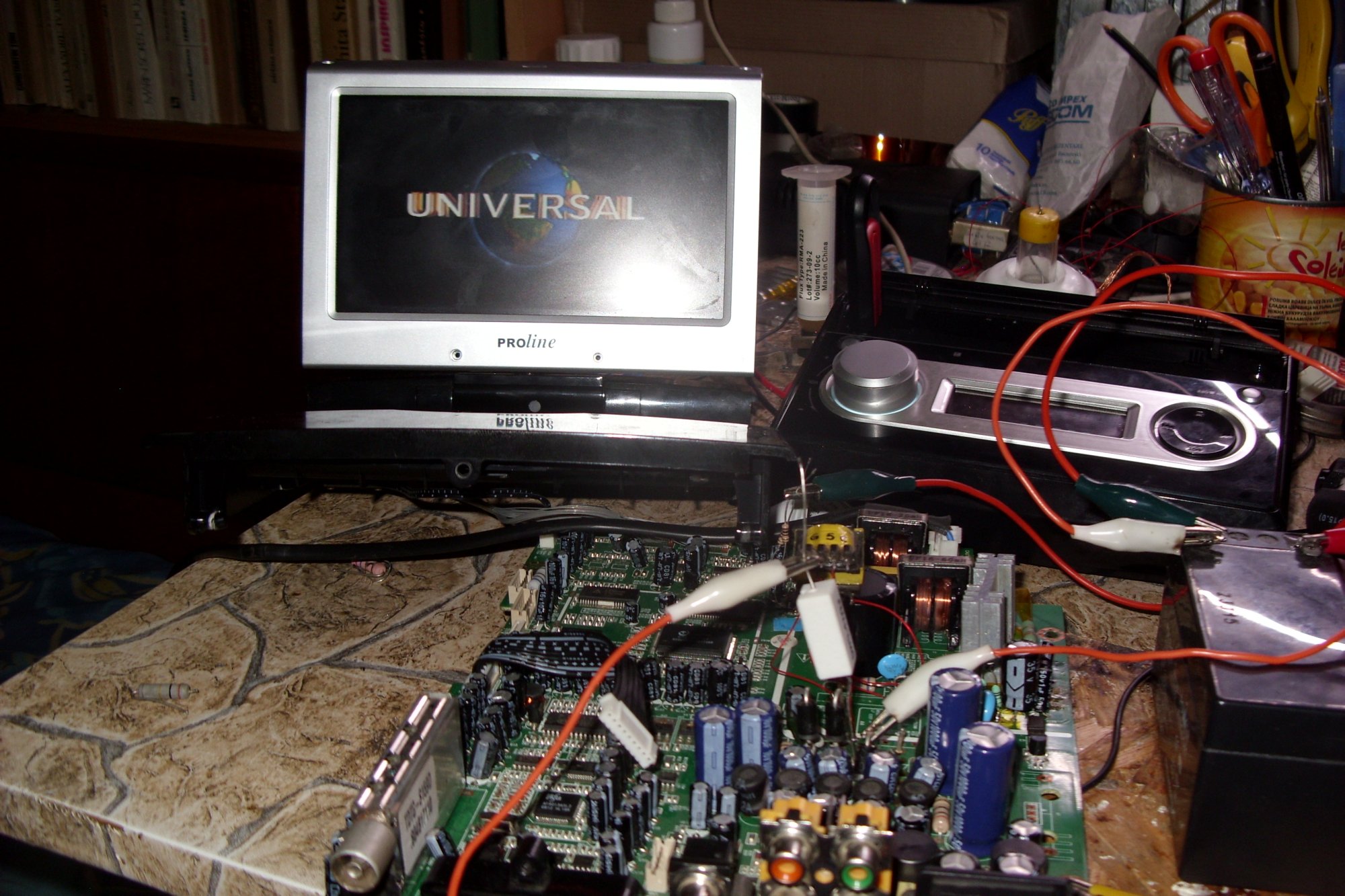

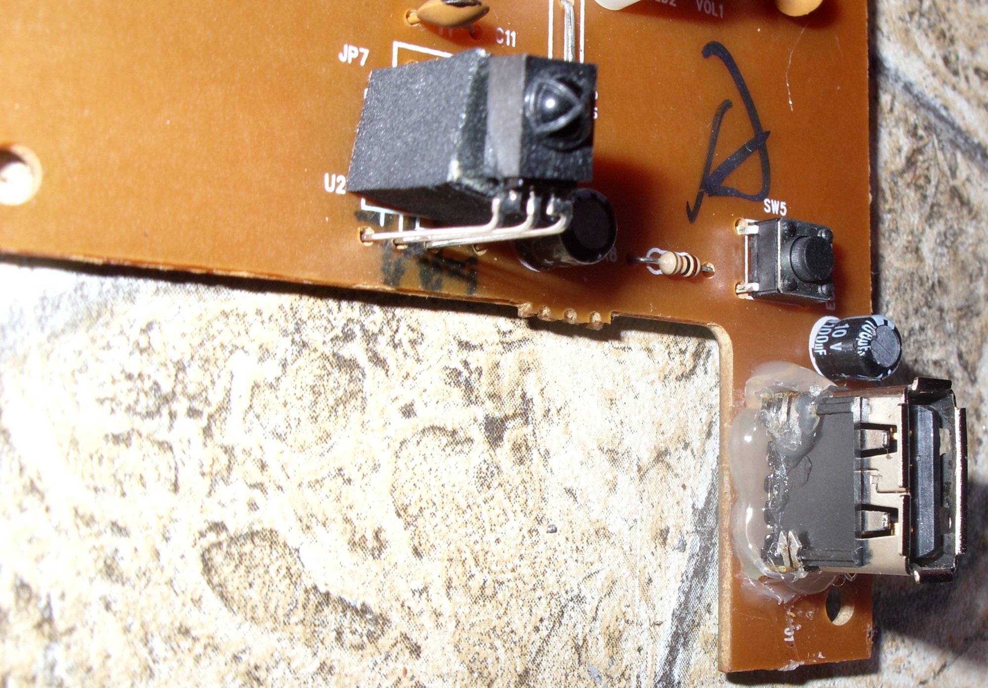

                            Got the OK from the owner regarding the price so i'll be rewinding the transformer.
                            Here's some more pics from last night. The USB connector on the front had its plastic tab broken so it was very touchy, i replaced that as well. I pulled one from an old laptop motherboard, and the one i pulled was sitting on the board, while the one on the stereo was mounted upright. A little intervention from the latest addition to my tool set fixed that.
                            Also are a few pics of the whole thing in operation and the paraphernalia required - it isn't my fault this thing uses half a dozen different voltages! I found a suitable replacement for the tant on the LCD too, on the same laptop board i pulled the USB from.

                              Unwound the transformer, and it confirms my findings. Tantalum cap on 12v rail went short when no one was watching. 12v rail had a single 0.3mm wire - too thin to trigger the primary overcurrent protection. Insulation melted and it shorted with the 5v rail. Switching transistor keeps pumping more current into the primary in an attempt to keep the 5v regulated, auxiliary voltage rises, and the whole thing goes boom.
                              No visible damage to the primary tho, but judging by the inductance it was definitely shorted as well. The way it was wound was atrocious - each half primary has two layers (it's just 40 turns in total, 20 on the inside, 20 on the ouside, but for some reason they only wound on the middle of the bobbin and left a lot of space on the top and bottom), and there was no insulating tape between the two layers of each half primary. That's a sure recipe for disaster. Worse, the melted windings went thru the tape and were less than 1mm apart from shorting to the primary. Imagine the destruction and the safety risk that would have been.
                              Now let's mention what could have been done to avoid this disaster. If a zener would have been used on the aux winding, as soon as the aux rose beyond limits it would have shorted, brought the controller Vcc down, and a lot of the damage would have been avoided. But simpler than that: A plain, simple FUSE on the 12v rail would have made this repair a breeze. Tantalum shorts, fuse blows, 12v goes out, everything else keeps working, easy repair. But no. They were too inept to do that, and their idiocy resulted in this catastrophic failure. I will be winding the 12v with two strands of wire instead of just one, and also fusing all rails and adding a zener to the PWM controller supply.
