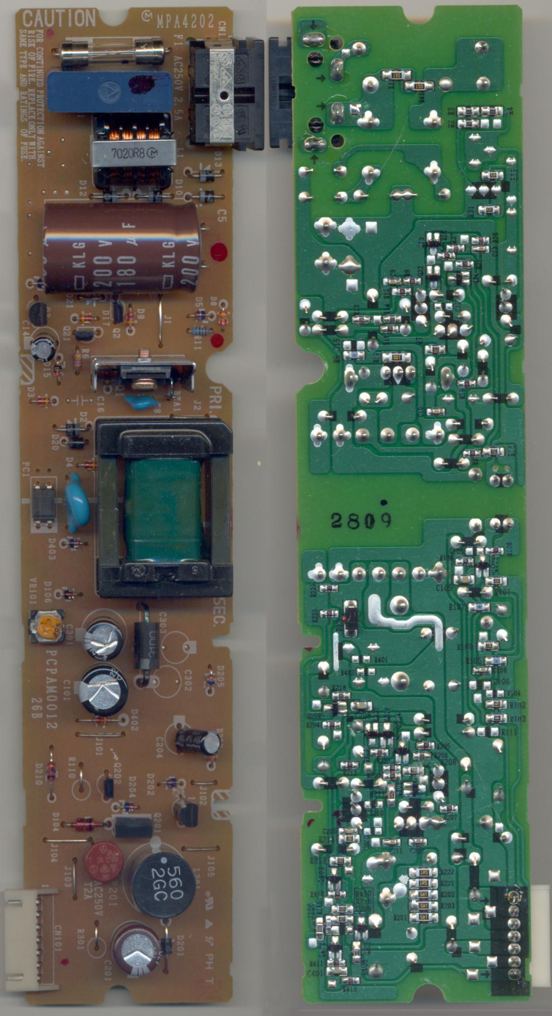

    I have ruined an otherwise good, I believe, PSU as my hand eye coordination isn't what it used to be.
    The story so far ...
    What we have here is a PSU from a Canon i850 Printer. The printer did not turn on and so I went to check the power supply output voltages thinking it could be there rather than the logic board, which I really wish I knew how and could fix, but everything checked out with the proper voltages. I looked at the logic board and have no clue if it could be fixed or how. (As an aside is there any place out there that assists with fixing those sorts of boards? )
    Anyway I thought I would double check the PSU and while doing so the probes slipped and I guess I shorted something as now there is no 5V output but I do get 24v and 27v.
    Contacts from output connector from top to bottom are as labeled on case +5V GND +24V GND +27V GND CONT.
    I don't know what CONT is or if it matters. Thinking back to what happened I can only think that I connected the 5V and GND but cannot be certain except that there is no 5V out anymore.
    So if there is any tests or info that could lead me hopefully to a bad component that could be replaced to resurrect the PSU I would appreciate it, you all are so helpful. If I can give any info on the board that can't be seen in the photo please let me know.

    Check F201 and the big diode on the secondary right next to the secondary capacitors (cant see the diodes #)

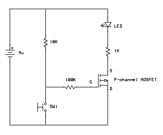

                    This is the easiest test I can describe...
                    Basically connecting the mosfet up in a circuit to see if it will light an LED when the button is pressed. The 100K resistor proves that all the current wont flow through the gate (and through the switch) if the mosfet is shorted gate-to-source. If the mosfet is open circuit, it wont do anything; if the mosfet is shorted source-to-drain the LED will light even when the button isn't pressed.

                        Well after looking through the parts box I found the requisite materials and built the circuit in the schematic and the mosfet checks out as good. I.e. when connect to 9v LED is off. When the switch is pressed the LED is on.

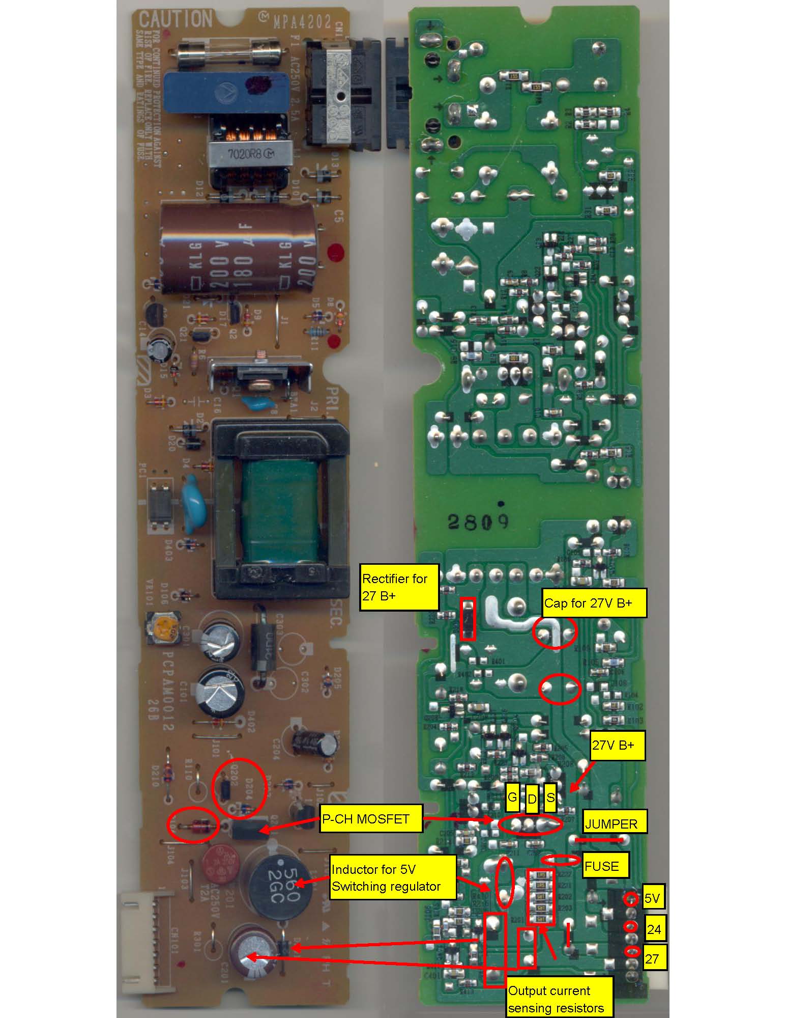

                              Here goes.
                              For the Rectifier
                              24v on the side to the top of the photo
                              27v on the side to the bottom
                              27v shows on the right side of R207, I think that is where I am supposed to check
                              Cap for 27v
                              27v on left
                              0 on right
                              The cap you have circled below it
                              24v on left
                              0 on right
                              For the inductor
                              From GND on output connector to either leg is 0
                              It has continuity between both legs, not sure if it supposed to.
                              For the MOSFET
                              G and S show 27v
                              D 0
                              For the two diodes, lifted one leg and they check out ok.
                              D104
                              27v on cathode
                              0 on anode
                              D204
                              27v on both sides
                              for Q202, says C1741A on it, not sure how to test this independently,but
                              27v on all legs
                              Fuse has continuity
                              C201
                              show 0 on both legs
                              D201
                              shows 0 on both legs but as stated in post 5 it checks ok too
                              Hope I got all that right
                                Re: Canon i850 PSU Trouble
                                The MOSFET is getting the 27V OK but it is not switching on and off like it should, since you had already checked the MOSFET and it is tested OK, so there may be bad transistor that driving the Gate circuits is bad. I cannot trace it that well from the pictures.
                                It looks like the Gate is connected to the transistor to the right of the MOSFET, cannot see the designator on the picture, IC201?, which you had indicated earlier as 431? Which is the ref diode.
                                You can try replacing that, it is commonly used for regulating the switching power supply circuits.

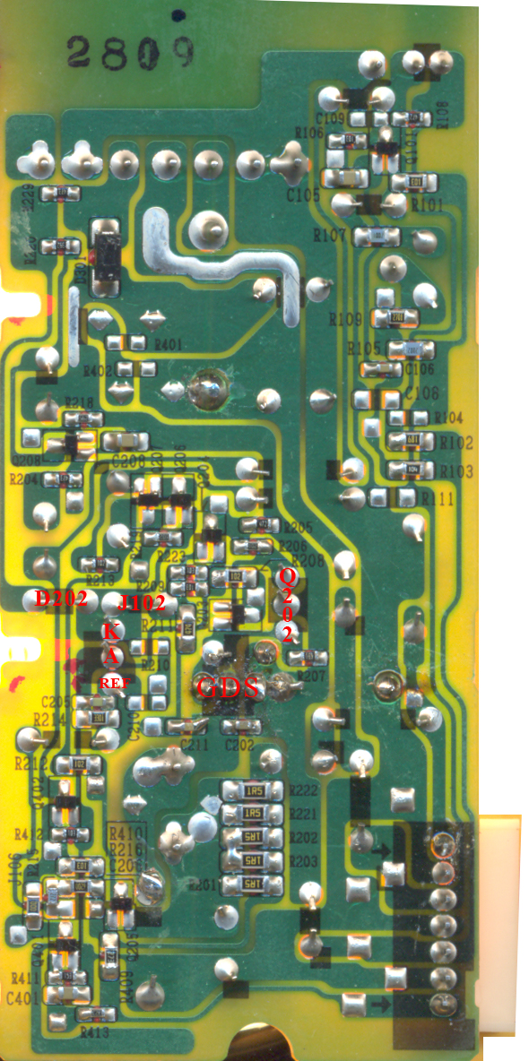

                                  I tried to get a better photo to be able to trace the runs and put a few labels on. Let me know if that helps or if I should put some more labels on.
                                  On the IC201, TA76 431AS 2 F
                                  I get
                                  0.8v on cathode
                                  0 on anode and Ref
                                  Is there a way to test it?
                                  Is the Fairchild TL431A the same or an acceptable sub for the TA76 431AS 2 F datasheet I referenced in post 5.
                                  IF this is the faulty component, I happen to have two other 431's
                                  a WS TL431AA 336D from a DVD player power supply. I think this is the datasheet. http://www.alldatasheet.com/datashee...S/TL431AA.html
                                  Also have an AZ431 AZ-AE1 735D78 from a Digital Converter Box power board. Datasheet here I think
                                  http://html.alldatasheet.com/html-pd...4/5/AZ431.html
                                  Would either of these work or are they not to the correct specs?

                                    No, the gate is driven by Q202 and Q203
