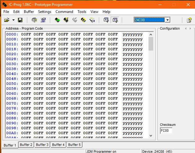

    Looking better on the mainboard there are 2 memory IC's.
    One an EEPROM of 2MB where is stored the firmware, this one I've attached on the other post.
    There is also an other EEPROM (24C08) of just on 1K and in this one are stored all infos and settings.
    This EEPROM is not erasable so this could be the reason that if its not possibile to complete hardware reset or overwriting it it with Canon Service Tool.
    Taking it off with programmer even if its still not erasable can be over written.
    Next to modify and overwritten this EEPROM leaving the other AS IS, printer stopped to give 7 LED error and works properly.

                          Sono riuscito a leggere la eeprom 24c08 qualcuno mi sà dire quali sono i byte da cambiare per azzerare il contatore di inchiostro pieno? grazie
                          I managed to read the eeprom 24c08 can someone tell me what are the bytes to change to reset the full ink counter? thank you : duh:

                            ho scritto questo file nella eeprom 24c08 della mia mg2550s ma non è cambiato niente, continua ad essere bloccata.
                            I wrote this file in the eeprom 24c08 of my mg2550s but nothing has changed, it continues to be blocked. :cestino:
                            • joepales
                              • Jan 2021
                              • 19
                              • ITALIA
                              Re: Canon Pixma MG2550S dump BIOS
                              Finalmente ho resettato la mia mg2550s ho semplicemente dissaldato la 24c08 e lo riscritta con 00FF in tutte le locazioni di memoria, lo risaldata e la stampante è tornata
                              come appena acquistata, ora la posso usare di nuovo, ringrazio questo forum su cui ho
                              capito come procedere.
                              Finally I reset my mg2550s I simply unsoldered 24c08 and rewrote it with 00FF in all memory locations, resolder it and the printer is back
                              as just purchased, now i can use it again, thank this forum i have on
                              understood how to proceed.

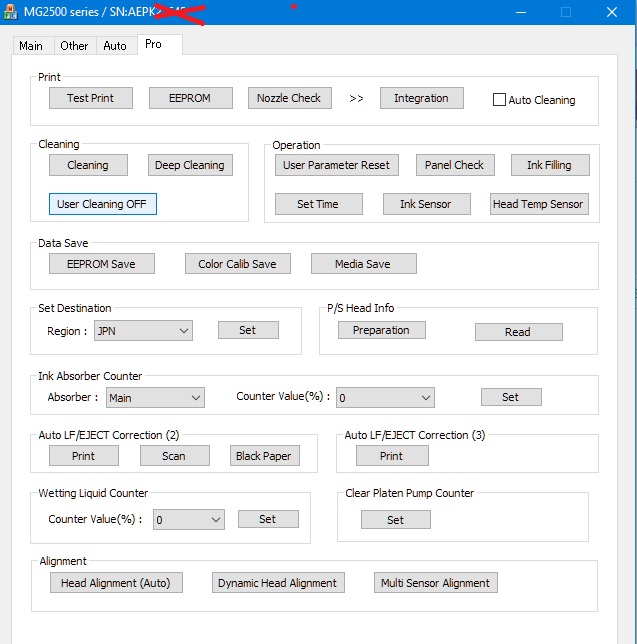

                                service tool 4718 is compatible with mg2550s, I used it with mine and it worked, the mg2550s goes into service mode when at power on you hold down the triangle and then the power key while holding down start, press 5 times triangle then release and it is in service mode, with tool 4718 press first stamp and then eeprom

                                    hi,
                                    I haven't anymore this printer but to enter Service mode follow this sequence: (resume button => this one with triangle)
                                    1. printer must be off
                                    2. push resume button and keeping it pressed, push ON button.
                                    3. keeps ON button pressed and release resume button
                                    4. press 5 times resume button
                                    5. release power on and resume and you're in Service Mode
                                    6. on control panel of 4718 Service Tool first press "TEST PRINT" button then EEPROM button.
                                    If it doesn't works follow the sequence I posted at #1 thread, this enter into Service Mode for sure but I didn't tested it with 4718.
                                    If this still doesn't works follow #16 about points 1 and 2 in this way:
                                    1. power on printer
                                    2. press and keep pressed resume button, then press and keep pressed ON button

                                        24c08 dump from a working 2550s.
                                        no idea how many copies it already printed, but with this i revived two wasted ink pad printers.
                                        beware. it will change your s/n, i didn't ever tried to edit, i used a ch341 programmer to write the dump, just load and write, no need to erase
                                        btw,rewriting 00ff on the eeprom as joepales said does nothing on my printers
