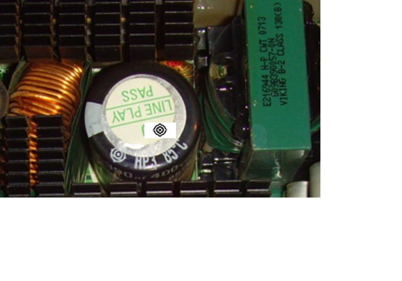

                          Figured I'd post some pics of my PSU. Maybe you guys will see something I don't. I'm really perplexed by this issue I'm having.
                          I should note that my system will start up fine if I cut the power before pressing the button. This is true no matter how long the system is powered down. Very strange.

                                  Blast! i am wrong again- still an honest mistake- I attach a pic showing the logo on your cap which as you say is hitachi and the logo for FU*
                                  I think it is the same but in negative Ill have to get some new specs!!
                                  Sorry thought I had something there.
                                  Anyway the Cooked caps bit may still prove correct.
                                    Re: Strange power related issue
                                    Definitely a Hitachi cap. That "S" shaped vent is unique to them.
                                    Hitachi make very high quality primary side capacitors. Similar caps are used in industrial three phase motor inverters. So they should last. Besides, the most common failure when that big cap fails is it kills the PFC circuitry because the energy can't be dumped quick enough from the inductor into the cap, fries the MOSFET and sometimes the diode too.
                                    The PSU looks pretty well made (good caps and good component choices), might be a CWT from the green transformers? Not sure...
                                    I would start suspecting the motherboard.

                                      Up until now I've been scrutinizing the PSU, but today I turned my attention to the motherboard. As I said earlier, I've been suspecting the MOBO ever since I inspected the PSU thoroughly.
                                      I decided to rule out the PSU by installing it into another PC so I could test it with another MOBO. My other PC is housed in a CM storm scout (it's just a basic PC), so it was pretty funny seeing this huge PSU in such a little case. Anyway, the system ran fine and didn't have any issues powering on. I left the system on standby for a good while, but it started right up every time. So... The PSU seems to be functioning perfectly.
                                      It actually does make sense to me. This MOBO isn't built to the same standard that the PSU is. It's EVGA branded, but FOXCONN made.
