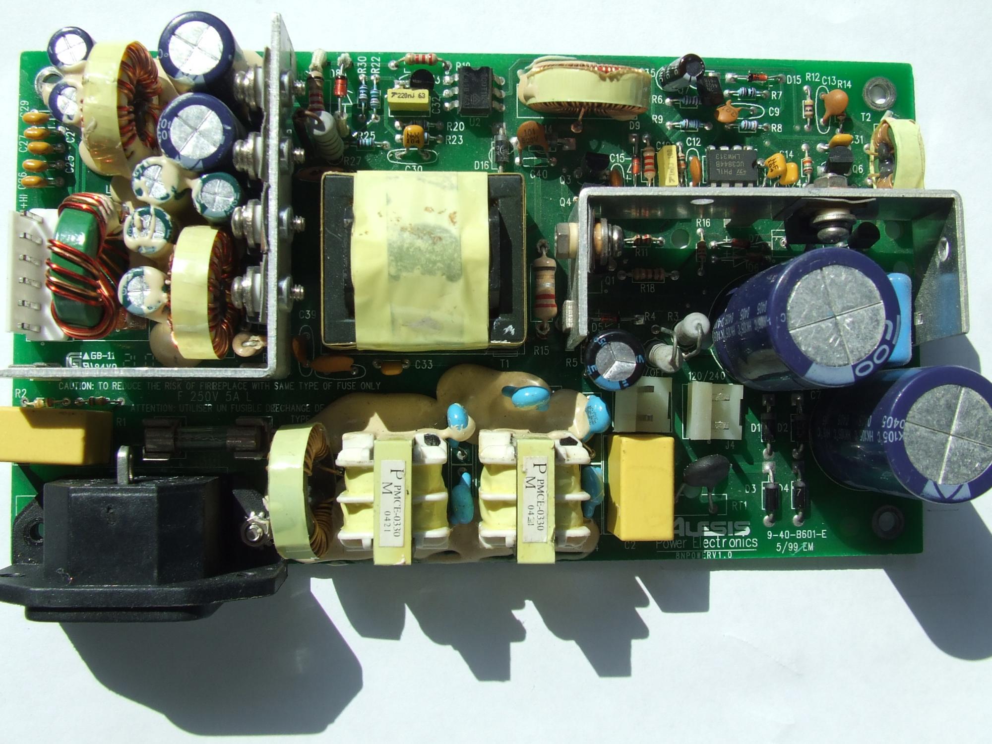

    Hi first post on this forum but have been lurking for some time. Im having trouble repairing an alesiis m1active mk2 monitor. The fault is in the power supply, a couple of weeks ago one of the monitors cut out and after switching it off and on again at the switch it went on fine again for a while... until it cut out again.
    After a bit of research i found that this was a common fault with the power supply in this model, the cause being a resistor which overheated toasting one of the capacitors. I Went ahead and replaced c35 and c8 as directed to on this forum http://www.neufeld.newton.ks.us/electronics/?p=232
    After replacing these caps the fault has changed in that the speaker still cuts out after about 20-30mins usage but then switches itself back on again.
    Would be very greatfull for someones help on this one.

    Hi - Welcome to the forum- you may have been better in the Audio Section but perhaps the audio experts will recognise the heading.
    First question is what caps did you use Manufacturer and Series. If you got them at maplins they may not be suitable for this application.
    If you think about it - those two caps were dried out - the others in there are the same age and have been virtually in the same environment and if this was a computer monitor we would usually advocate changing most of the caps.
    We can help a lot more if you please post good clear pictures of each board, front and back and close up of connectors, (max resolution 2000x2000 and 2MB) using the manage attachments button, which is found by clicking "go advanced" under quick reply.

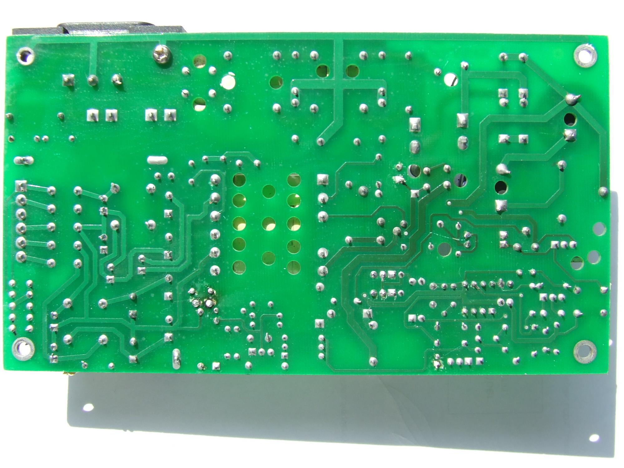

      Forgive me for being hasty, Here are pics of the board. My skills in electronics are very limited, as far as tools go I have a fairly decent soldering iron and multimeter but no esr meter yet. The cap that I replaced c8 with was a Jamicon 116C2(m) 50v 220uf and the cap that I replaced C35 with was an ANC RG 1uf 100v cap, both rated at 105°, both came from maplin

                          Ok replaced ALL of the electrolytic caps last night (both power supply board and crossover amplifier board) and cleaned and reapplied thermal paste.
                          Through testing it today all seemed well for about an hour untill the original fault occured and the unit cut out and switched itself off but did not switch itself back on again.
                          Strangely enough after switching the unit off at its switch the blue light lit up and speaker surged back into life for a second.
                          Any ideas as to what the fault could be?

                                Perhaps you can repost pictures of both boards after the repairs. You should also check all the caps are the right way around/polarity and check all your board with a microscope for cold joints or cracks.
                                On the picture of the back of the board there is a bit of solder splatter around
                                the left hand resolders point - perhaps clean it up. Did you do that soldering- what was being soldered? and if you did not do it perhaps re-flow it.
