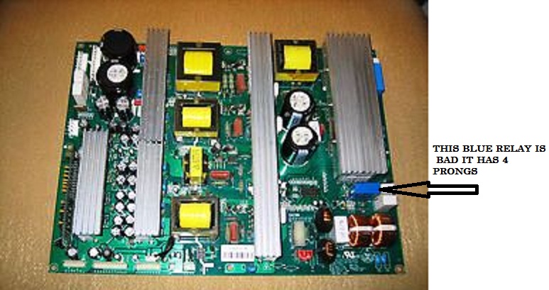

    I have a Viore 42in tv MODEL #PDP42V18HA
    USP440M-42LP POWER SUPPLY a new replacement is hard to find and a good used one is not easy either all I need is a new relay does anyone know were I can find a new relay that I can buy and replace it.
    THANKS haileys_crazy_daddy

      You need to get the brand and model number information, find the datasheet for it online - match every character in the model #, as the characters define what it is. Then either find a place you can buy the same part or find an exact match made by whatever brand a place like Digikey or Newark sells (e.g. American Zettler or Omron or ). If you find the datasheet and find it confusing, post the brand, part # and a link to the datasheet here. I'm sure some one (or several some ones) will be able to help you decipher it.

        I already posted the brand and model# Viore 42in tv MODEL #PDP42V18HA the power supply board # is USP440M-42LP as far as how do I know it's the relay this ain't my 1st rodeo I was able to find some relays once but I had to order them from over sea's by the time I had them imported I could get a used board off ebay I would reather repair the one I got I'm sure someone that lives here in the states has a Whole bag of these relays sitting on a self somewere

                what is the information as printed on the RELAY itself? not the model number of the TV since they could have changed the relay manufacturer for the same board, same model of the TV. They will use the cheapest one they can find.
                The information as printed on the relay will give the coil voltage rating, the contacts rating, etc. Then we can see if you can get the replacement relay that will fit the board.

                      Looking around a bit in Digikey, looks like their main relay brands are Omron and Panasonic Electric Works (formerly Aromat), both very good brands.
                      The "bad news" for your search is that there are myriad types and styles of relays. The "good news" is that relays, to a fair degree, are a commodity product - you often/usually can get identical products from multiple vendors. The relay part number will identify:
                      * The series (form factor)
                      * Coil voltage
                      * Contact arrangement (PCB layout, number of poles, number of "throws") and current rating
                      PeteS in CA
                        Re: Bad power supply relay
                        The close up picture of the relay will help, the bottom of the board where the relay is will also help so we can see the footprint of the the relay.

                          The whole psu is only 40 bucks at Retechtv dot com,just search the USP440M-42LP in the area up top.

                            I received the psu today for a total of 63 + 16 brokerage fees because i live in Canada.Installed it into my Akai PDP42Z5TA Plasma and all is good.For 80 bucks i ended all my headaches of trying to track the psu problem.In my case the TV had the red light on as normal then i would power on the TV and the red light changed to green and would power off in 2 seconds with no chance of being able to test.I unhooked all boards but the problem was still the same.So that lead me to the only problem was within the psu.After searching the net for awhile i came across retechtv which had the psu for way way cheaper than anyone.Really 39.99,I could not believe it.Anyway once again i enjoy this old tv.
