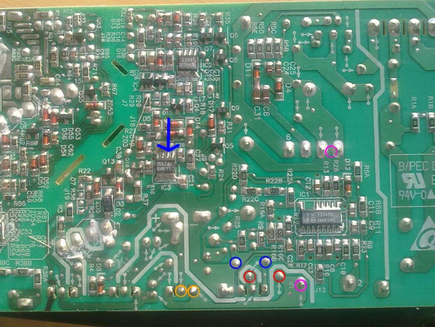

                                      I attached a picture with some test points. With the power adapter disconnected from the wall, measure the resistance between each set of circle test points of the same color (ignore the blue arrow for now). For the orange test points, check with the diode test function (in both directions) instead of measuring the resistance. Ideally, you should get a diode reading in one direction and open circuit (OL) in the other.
                                      Post your results here.
                                      Finally, the blue arrow points to pin 2 of the PWM controller, which is a L6384D (a high voltage half bridge driver). Pin 2 is Vcc. Check the voltage on that pin (with respect to HOT ground) and post what you get. Be careful not to short anything there.
                                        The Orange test points read 380 Ohms one way and OL the other.
                                        The Red test points read full continuity both ways! This is L7 although it looks more like a diode than an inductor!
                                        The Pink test points are full continuity both ways!
                                        To test the Blue points R15 I have to solder in some parts including the main cap!
