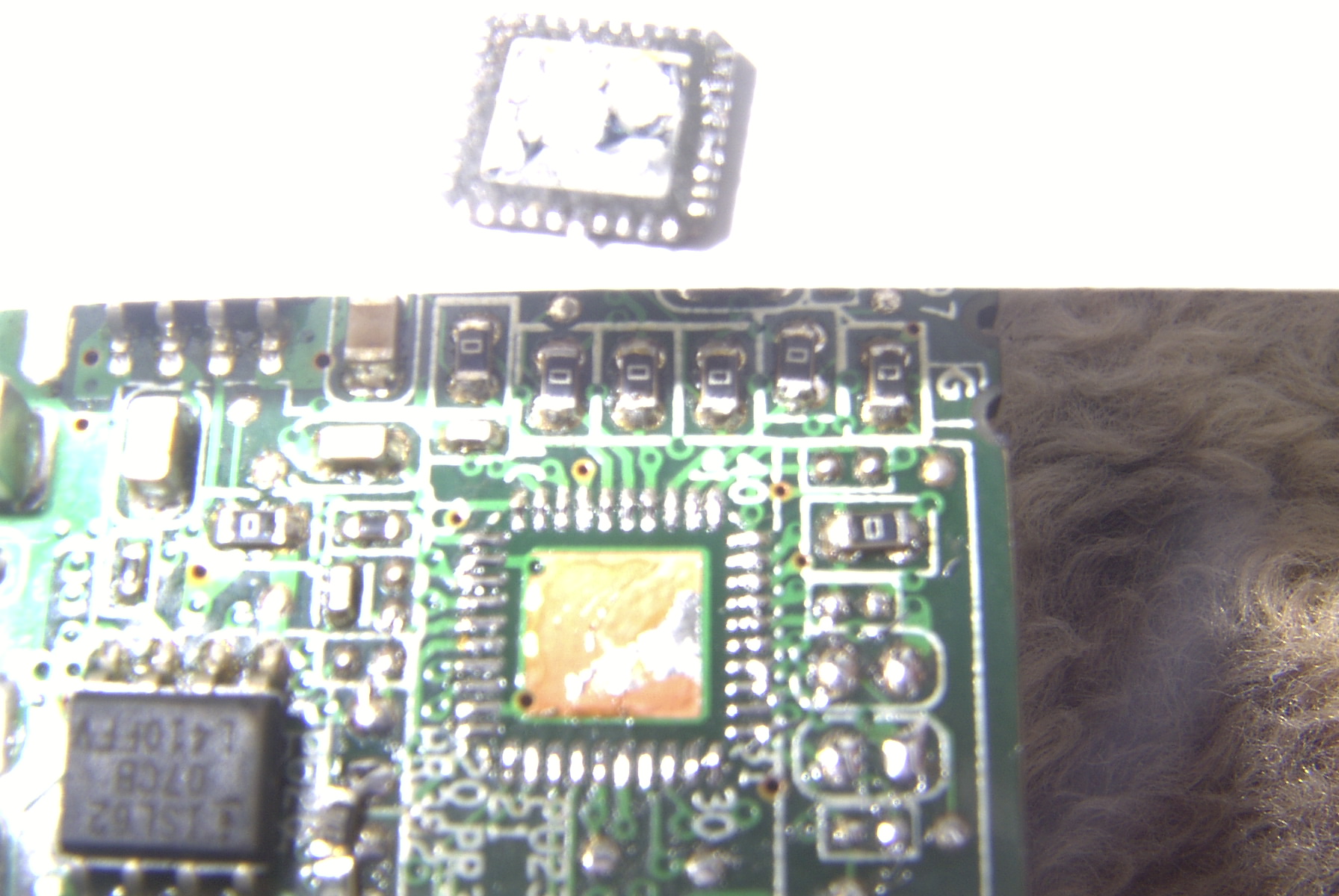

                          #32
                          Re: Help troubleshooting Dell laptop
                          Originally posted by bassmen999
                          Here are some more pics as you asked:
                          I'm still hashing with these dells.
                          Bassmen, Your board picture shows a chip to the right side.
                          It's the Intersil 6247cr power control chip. I think these are blown, and this is why a board replacement is the only answer.
                          http://www.intersil.com/Applications...device=ISL6247
                          This is a data sheet, difficult replacement.
                          Jim

                            #33
                            Here's a bit more on this, sorry I'm obsessing.
                            Data is proprietary for the intel version but not for the amd chip, here's the data..
                            This is how the board utilises ceramic caps.
                            This probably fails due to overheat, just my HO.
                            All the 1150's I've opened up have a large dust ball hidden in crevice of heatsink,
                            people say they are hot, this may be why.
                            Jim

                              • arneson
                                • Sep 2005
                                • 1267
                                #35
                                Yes, as a test of my soldering skill I removed what I thought was this forty pin surface chip. Turns out it has 41 pins, the entire bottom substrate is pin 41, gnd.
                                I was succesfull with this experiment, took very little time to remove and replace. The other board ended up looking like I'd never been there.
                                This was the most difficult soldering I have attempted, but it worked.
                                Jim

                                  #36
                                  Wow - way cool. That's way beyond my abilities to diagnose/replace. However - why are these power controller chips failing? Are people attempting to install desktop (non-speedstep/mobile) P4 chips in these systems, causing the power controller to overheat?
