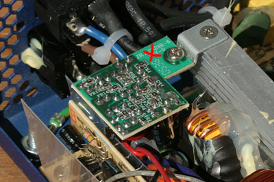

    My old psu work normally. I done it by cut the two wires to the inductor
    and short them afterward. But I would like to know more or can I modify a PSU to active PFC?
    Secondly, can anyone tell me the way to increase the speed of the thermally
    controlled 12cm fan inside the psu? It justs spin too slow.

    i doubt if you could easily convert a passive pfc to active pfc, why not just buy an active pfc unit next time.
    Secondly, can anyone tell me the way to increase the speed of the thermally controlled 12cm fan inside the psu? It justs spin too slow.
    this is probably the source of the problem, thermally controlled fans in psus are often pushing far too little air because people want to buy silent psus. so you could instead give that fan 12v or 7v. the easiest way to do that is to take the 12v off a molex and feed wires back to the psu fan. you could also solder fan wires to the 12v on the bottom of the psu pcb.
    if you think 12v is too much you could use a resistor or even better to connect the fan to a front panel fan controller then you will be able to play with the fan control how you like. Just be careful if you are soldering wires to important fans that when you work inside the case in the future that you check the wires do not get disturbed/broken because if the psu fan becomes disconnected and is running fanless you may have a big problem.
    personally i could really use a fan controller that i could set up to have different fan speeds with a switch. the unit would allow tuning of all the fan speeds and then assigning those speeds to the switch so i would have the choice of silent/medium/gaming. it would be nice also to include a switch for lights so i could have the same choice no lights/few lights/all lights.

      Modifying a PSU to "Active PFC" would essentially require you to add a PCB with all the various components - which wouldn't turn out to be particularly cost-effective, particularly since the active PFC would not in any way increase the PSU's efficiency, as far as your electricity meter is concerned at least.
      Certainly a passive PFC PSU can be modified in the way you describe , essentially downgrading it to "no PFC". There's a model of Fortron (ATX300-GTF) to which I do this procedure as a matter of routine, after one such PSU of mine killed itself when one of the wires leading to the PFC coil melted its insulation on a small, hot FET heatsink on the primary side, and shorted to said heatsink.
      Then again, I find it hard to believe that this heatsink should have become so hot in the first place, so the FET in question may have been defective after all. **
      As Will said, the easiest way to eliminate "temperature-controlled" fan problems is to simply wire a fan directly to the PSU's own 12vdc. With cheap PSUs, I just solder the wires from some old fan directly to the PCB; while in the case of "nicer" PSUs, I tend to like to use the EBM/Papst fans - they're effective and reliable, and most of their models come with a 4-pin "molex" attachment which you just plug into the PSU.
      ** Confession: I had "modded" that particular PSU to run a Compaq. It probably found this highly offensive.

          looking at the fortron bluestorm there is the usual fan control board attached to the heatsink. i havent measured the input to that board but i am assuming it is 12v. it would be an easy job to solder the fan wires to the input there and bypass the fan control, if there is a similar accessible board on your psu
          warning : dont mess around inside psus when they are on unless you know exactly what you are probing and what not to, the primary heatsink (near the big caps) is usually 160v to ground

            My fan is connected to a pcb but the pcb don't touch any heatsink!
            Isn't it my fan is not a thermally controlled fan ?

                There should be a thermistor somewhere that is used to monitor the temperature. It's sometimes near one of the heatsinks and bending it one way (so it touches the heatsink) or the other way (away from it) can be used to increase/decrease overall fan speed.

                    if you want a thermally controlled fan to run full speed 24/7 just short the thermistor.
                    it will either be on the fan itself, or you will be able to see a diode somewhere.
                    ive done this with thermal controlled NMB fans, works great, remove the solder bridge and back to normal
