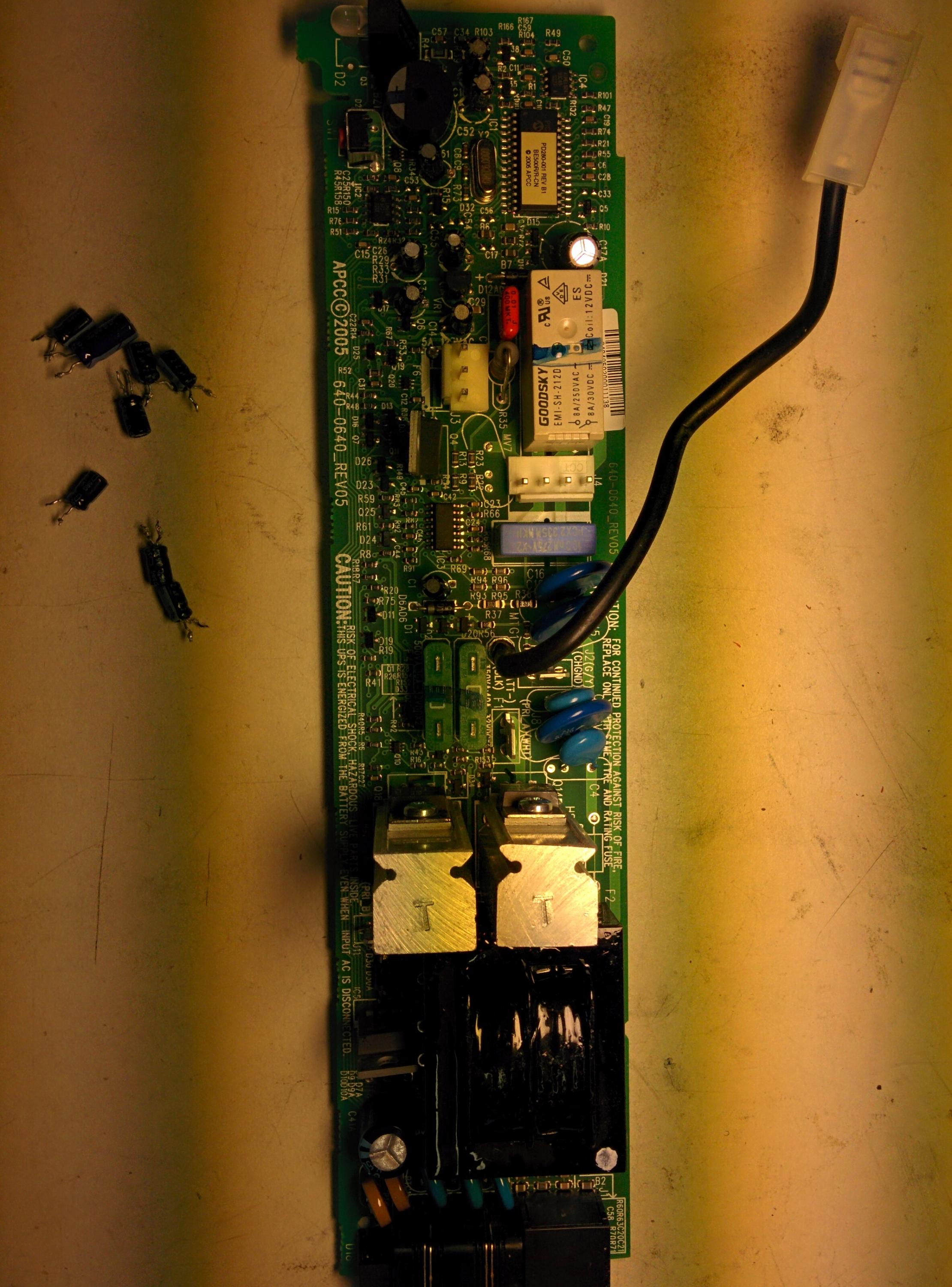

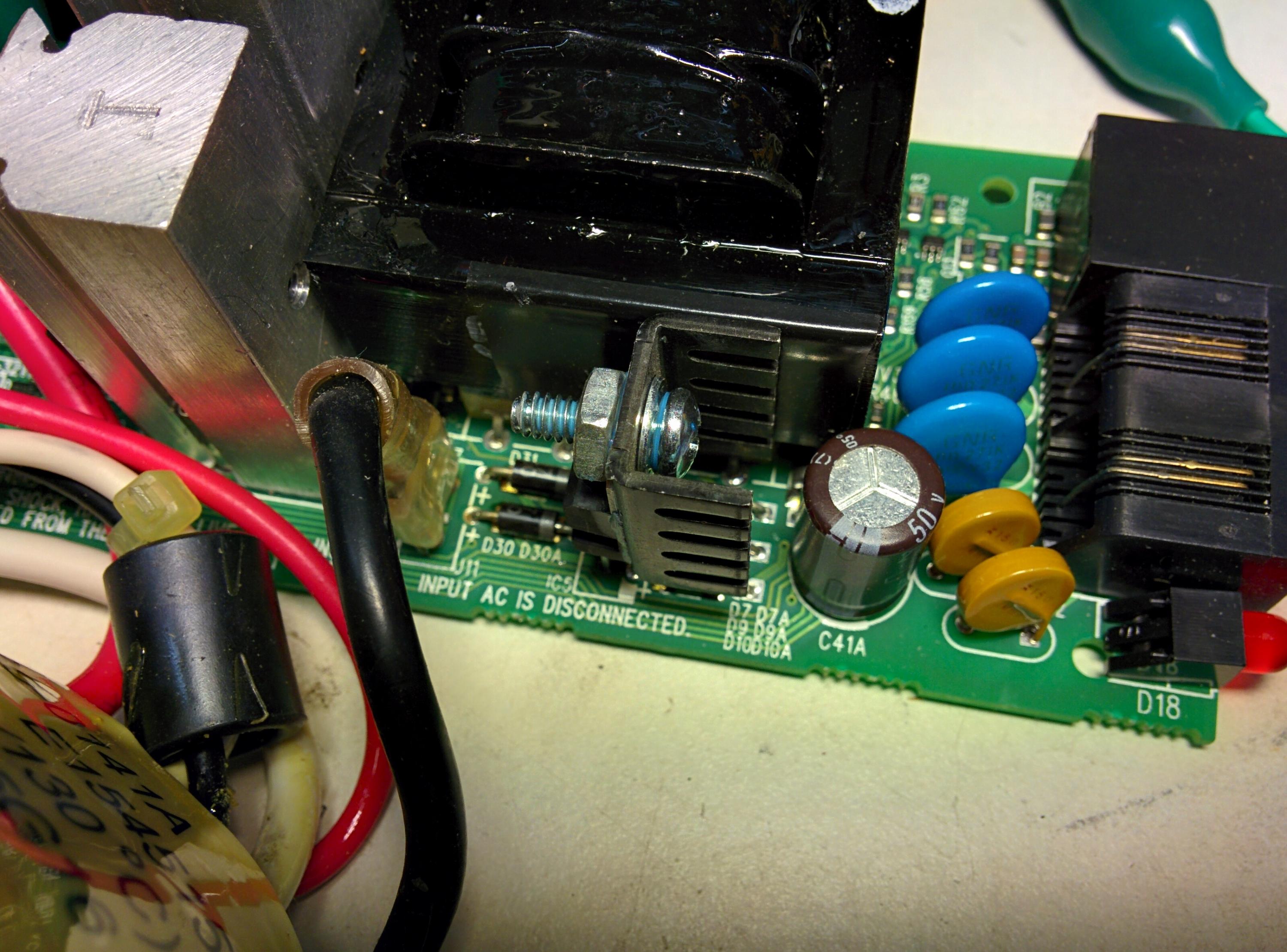

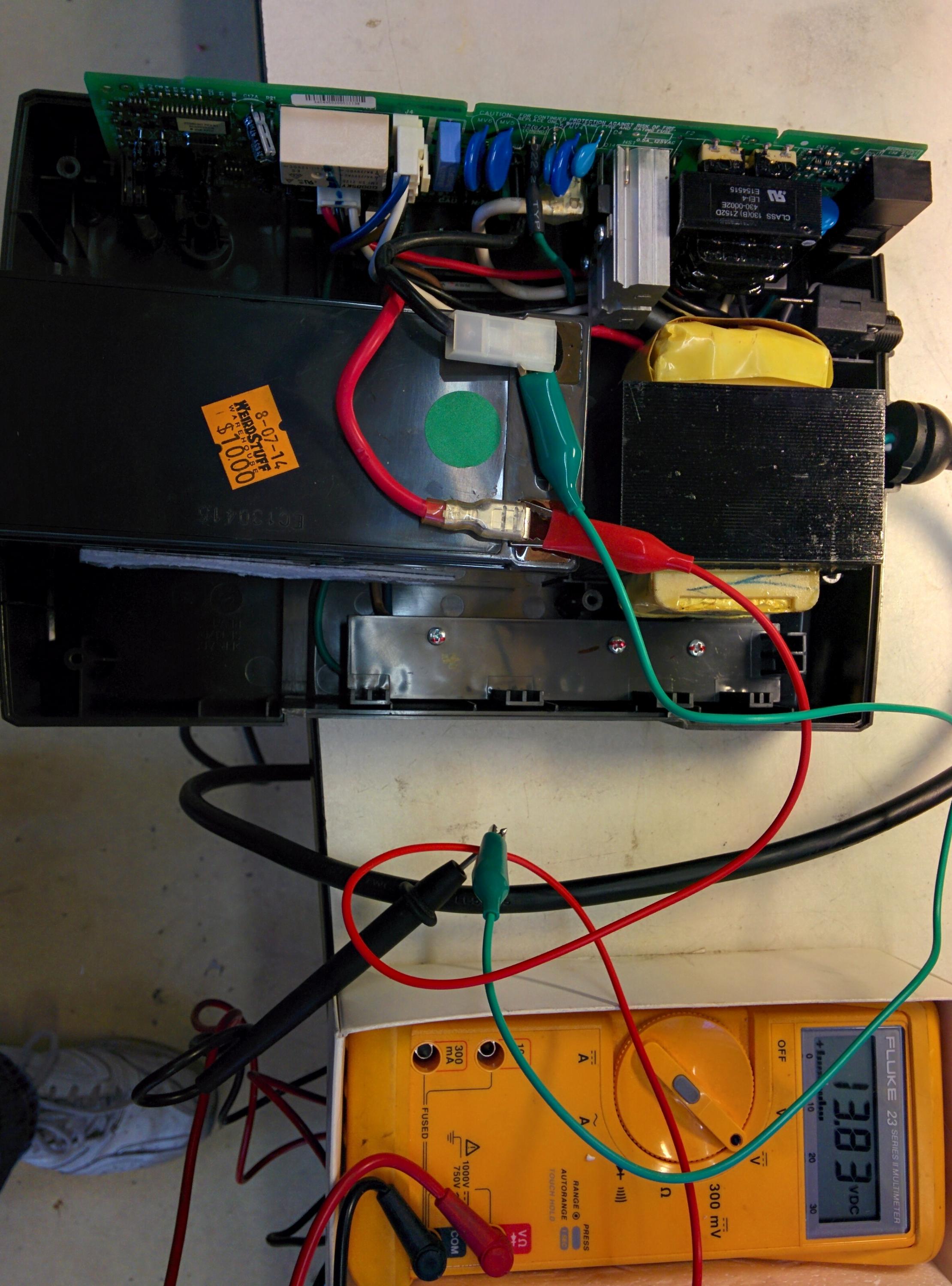

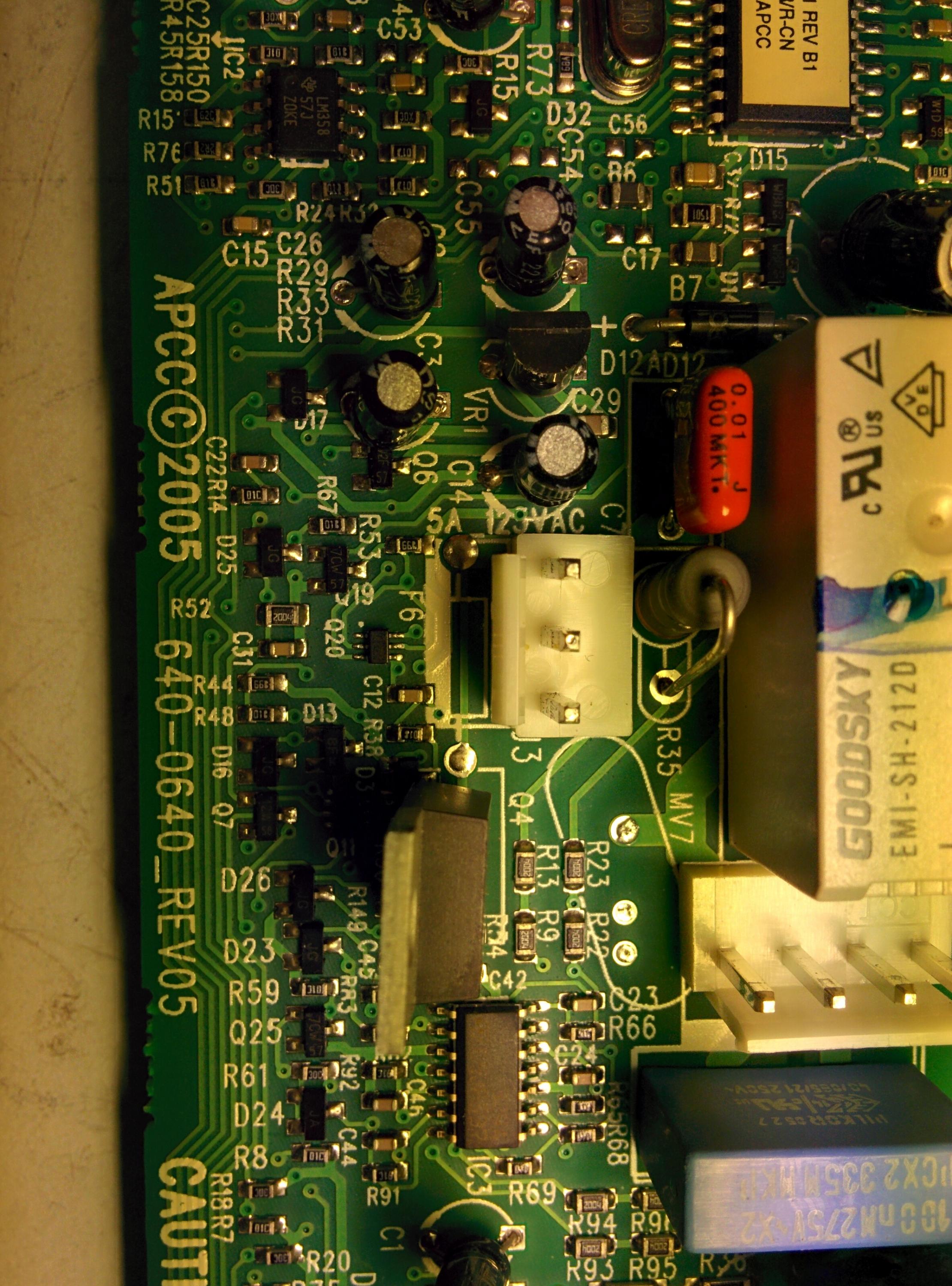

APC UPS units - troubleshooting
  • paulzak
    replied
    Re: APC UPS units - troubleshooting
    After recapping I started wondering if I wasn't getting charging because of a flakey 7815 as the old one looked as though it had gotten hot. I replaced it and it's charging now! It gets pretty hot when it starts charging so I added a heat sink. As battery voltage comes up, it gets less hot. Still not clear if there is something defective upstream causing the heat other than the inherent inefficiently of these linear supplies, but I buttoned it back up and we'll see. You may be able to see the heatsink in the attached photo. Paul
    Leave a comment:
  • paulzak
    replied
    Re: APC UPS units - troubleshooting
    Definitely no inline diode from the transformer. I'm certainly learning as I go.
    Leave a comment:
  • paulzak
    replied
    Re: APC UPS units - troubleshooting
    I think I can answer my own question. It looks like it could be a center tap but I'm not clear why it would be on the positive lead.
    Leave a comment:
  • Behemot
    replied
    Re: APC UPS units - troubleshooting
    Isn't there some diode? BTW often there is separate winding just for some low voltage…you don't need much power from that, just like an amp or so.
    Leave a comment:
  • paulzak
    replied
    Re: APC UPS units - troubleshooting
    I'm still waiting to receive the filter cap for the 15v linear supply but I have a question related to UPS design theory. I have 15.1v at the output of the 15v voltage regulator which is all good.
    The positive battery lead comes from the transformer. As far as I knew, you can't use a transformer for DC. How is this part of the charging circuit working? I understand the basic linear supply with bridge rectifier/voltage regulator chip/blocking diode, but the transformer has me stumped.
    The negative lead comes from the PC board.
    Are they using a winding as a choke?
    Thanks, in advance!
    Paul
    Leave a comment:
  • Behemot
    replied
    Re: APC UPS units - troubleshooting
    Sorry, I meant from the transformer, to feed the battery. Indeed, this linear regulator design is very ineffective (but easy and cheap). APC abandonded that very long time ago. Yet all the cheap plastic units of (most likely) Must Power origin use this in 2016. Sometimes the regulators overheat so badly they bake the board around them with all the caps. I think this is connected to particular revision/version of the board. They also use aluminium wires for the main transformer.
    It was very pitiful display at CeBIT - there was like 6 to 8, companies, including Delta Electronics, some others calling themselves OEM supplier, and EVERY SINGLE ONE OF THEM had that thing in their portfolio. They are all the same (besides the configuration of sockets and the front panel - OFC every one has to look slightly "different", but you can recognize that on first look). So bad units and they even argue with you that they definitelly "design and manufacturer" that by themselves.
    But somehow could not explain why 5 more companies around them have the same units and they don't make it for them And why all the other units in their portfolio - why I am positive actually aretheir own designs and made in their fabs - look completelly different I mean even low-end and high-end units from Eaton or APC share similarities among them. These chinese rebrands are completelly different than everything else they got. But they definitelly make that on their own
    Well, I guess they can have it licensed…but than, another thing I noticed: all of them regardless the brand also have the same label sticker on the top-back part, which is the same style (color, font, layout, everything) for all, only the brand name is different. Yeah, they make it my ass As even Delta is just sourcing it from other fab as it makes more sense to buy this cheap crap and make high-quality units in their own tier 1 lines, those ppl either did not *really* know or they new but could not tell. But even arguing with me telling me those lies to my own face after SO MANY of them I have seen with my own eyes, man…
    For example, check the Sweex http://www.sweex.com/nl/notebook-pc-...res/ups/PP200/
    They are made both as off-line and line-interactive, this single-battery and also two-battery versions. 1500-2000VA models use small fan in the backside.
    Last edited by Behemot; 03-17-2016, 11:53 AM.
    Leave a comment:
  • paulzak
    replied
    Re: APC UPS units - troubleshooting
    Thank you! Bhemot, I've replaced 8 of 10 electrolyics so far. I'll replace the last two in the next couple of days. It's good to know that some designs do charge from the SMPS. This unit was, in hind sight, probably a good starting point. At least I recognize the components in a full wave rectifier PS. SMT would seem to make repair considerably more challenging. I'm vaguely following so far. As long as I don't need to do anything with an SMT device, I'm happy.
    Leave a comment:
  • Behemot
    replied
    Re: APC UPS units - troubleshooting
    This is some older design, the later CyberFort II units (Back-UPS something) used SMPS for charging. It has to take the voltage from the battery.
    In those newer designs the small caps almost always go bad. Check them too, there will definitelly be some feedback for the microprocessor.
    Leave a comment:
  • paulzak
    replied
    Re: APC UPS units - troubleshooting
    Originally posted by smile
    I found pcb schematic, the battery is charged by LM78M15, 0.5A max.
    The schematic shows 2 diodes (D18 and D2) that are connected to OUT pin one after another. This lowers voltage as diodes have voltage drop.
    I added third diode (in a row to them) and now I have steady 13.00 - 13.09 Volts varies with AC voltage.
    So now my batteries will no longer dry out !
    I think this may be the key to a problem I'm having with the charging circuit on an APC BE500R. I've taken this device on as a science experiment rather than to save it; it's a mostly worthless device but what better to learn on? I'm $25 into this.
    I'd surmised that charging wasn't derived from the switching supply; the inverter is working fine with an externally charged battery. I'm very excited to learn that this positive regulator is likely a place to begin looking! Nothing on the board looks blown, but the LM78M15 looks like it has been hot at some point!
    Do you guys generally make extensions to the connectors to work these devices live? Given the short leads, this may be my only option.
    I will next probe the VR and I'm still waiting for a 220uF 50v cap which lives nearby and looks to be relevant.
    Any help full thoughts other than don't electrocute myself?
    Thanks, Paul
    Leave a comment:
  • sadeoo7
    replied
    Re: APC UPS units - troubleshooting
    i said that they where optimized for a higher depth of discharge but the NPX series are in fact high rate. sorry for my mistake.
    here is the datasheet if you want to check them out
    https://cdn.badcaps-static.com/pdfs/...f090d72a8a.pdf
    Leave a comment:
  • Behemot
    replied
    Re: APC UPS units - troubleshooting
    Deep cycle, or cycle-use batteries are better for different kind of use, especially for different kinds of go-carts (like golf carts, baby cars etc. etc.) where you regularly do full discharge and full charge cycle.
    For UPS I'd take if any, than high-rate. Those are usually of higher quality and should provide higher currents - neccessary for high-loads of the UPS when there is often as much as 40 A draw.
    Leave a comment:
  • sadeoo7
    replied
    Re: APC UPS units - troubleshooting
    i find that Yuasa Batteries specially the NPX series are higher quality than the batteries offered by CSB.
    the NPX series from Yuasa are made for higher depth of dicharge and oftimized for standby use.
    the equivalent to a NP9-12 (12v9ah) is a NPX35
    Last edited by sadeoo7; 03-03-2016, 01:43 AM.
    Leave a comment:
  • smile
    replied
    Re: APC UPS units - troubleshooting
    Also what can you guys say about
    CSB-HR1251WF2 - 12V 12.75Ah 51W Pb CSB - 37.36 €
    CSB-GPL12120 - 12V 12Ah F2 Pb CSB - 40.84 €
    CSB-EVH12150 (blue one) - 48.66 €
    I always thought that deep cycle is better hence the higher price for EVH version. Then how come they rate the HR 8 years (plain marketing nonsense ?), the
    The usual CSB-GP12120 is 37.50 € same as YUASA NP1212, but YUASA has additional membrane that prevents evaporation, CSB does not. Hmm....
    Is there some site where I could see dissembled new batteries from CSB, YUASA etc. and to see that it's really different products, not just marketing nonsense.....
    Leave a comment:
  • smile
    replied
    Re: APC UPS units - troubleshooting
    Originally posted by Behemot
    Just use Panasonic batteries and you won't need any crazy adjustments. I suggest LC-RA1215P1.
    I had better luck with YUASA NP1212 and the price is right. The Panasonic is not available locally in my country !
    What I wonder is why England has CSB EVH12150 red, made in VIETNAM.
    While the rest of the Europe has EVH12150 BLUE made in CHINA.
    Last edited by smile; 02-28-2016, 06:13 PM.
    Leave a comment:
  • smile
    replied
    Re: APC UPS units - troubleshooting
    I found pcb schematic, the battery is charged by LM78M15, 0.5A max.
    The schematic shows 2 diodes (D18 and D2) that are connected to OUT pin one after another. This lowers voltage as diodes have voltage drop.
    I added third diode (in a row to them) and now I have steady 13.00 - 13.09 Volts varies with AC voltage.
    So now my batteries will no longer dry out !
    Leave a comment:
  • Behemot
    replied
    Re: APC UPS units - troubleshooting
    Just use Panasonic batteries and you won't need any crazy adjustments. I suggest LC-RA1215P1.
    Leave a comment:
  • smile
    replied
    Re: APC UPS units - troubleshooting
    I have ACP BACKUPS 650MI , how do I change charge voltage to lower value?
    The VR1 does not adjust it, I set it back to where it was default.
    Any ideas?
    Leave a comment:
  • Behemot
    replied
    Re: APC UPS units - troubleshooting
    Seems like the batteries are bad, you have a multimeter?
    Leave a comment:
  • dark84
    replied
    Re: APC UPS units - troubleshooting
    Hi!
    Sorry for my bad english!
    My UPS do same thing that on the video:
    http://www.youtube.com/watch?v=htykTLWTsH4
    Anyone has an idea what is the problem?
    Thanks!
    Leave a comment:
  • Toasty
    replied
    Re: APC UPS units - troubleshooting
    Found some of them:
    http://www.jjoseph.org/notes/apc_sma..._float_voltage
    http://osdir.com/ml/monitoring.nut.u.../msg00120.html
    Not responding: http://www.networkupstools.org/protocols/apcsmart.html
    Leave a comment:
  • jason123
    Sony XR-55A80J OLED TV 5 blinks - Troubleshooting steps
    by jason123
    Hi there,
    I see a couple of posts related to the troubleshooting of similar TV. The one I have is acting slightly differently and I'd love your help.
    So it has the 5 blinks. Previous owner got a TCON, no luck. Got a new Main board (though he didn't do the USB firmware update), again, no improvements.
    I see 2 posts that are relevant:
    https://www.badcaps.net/forum/troubl...j-oled-5-blink
    https://www.badcaps.net/forum/troubl...g-hardware-dev...
    10-29-2025, 02:01 PM
  • blues_spirit
    practical courses for troubleshooting pc motherboards
    by blues_spirit
    Hello from France,
    mon2 kindly advised me to post a thread to ask the question(s) I'm concerned about. I'm new to the forum and I'm looking for practical courses for troubleshooting pc motherboards especially laptops in Europe, if possible in France. I have been a computer network system administrator and a corrector of administration modules for automated programs under Unix. But I really miss the practical "ops" side of troubleshooting. So I would like to start from the beginning: 1.8V, 3.3V, 5V and 19V tests for example, etc...
    Do you think this is feasible for me? I...
    12-18-2022, 12:56 PM
  • piernov
    Reminder: rules and organization of this section
    by piernov
    Activity on this forum has been increasing steadily and the workload for the moderation team as well in order to keep the place clean, so please make an effort to keep it organized.
    I've been deleting more and more posts that make a mess, so take a minute before posting to make sure you make a proper request/offer.
    Reminder about the rules and the organization of the "Troubleshooting Desktop Motherboards, Graphics Cards, and PC Peripherals" section.
    This section and its subsections are about the following classes of devices:
    • Desktop computers
    • All-in-one
    03-31-2023, 06:17 AM
  • sheffieldyorky
    ZAB/ZAB A,B/ZYJA BLOCK DIAGRAM Acer Aspire
    by sheffieldyorky
    Hey there people
    While working on my Acer Aspire with the OS failing to load, I encountered a motherboard number of DA0ZHQMB6E 0 REV: E. I was getting nowhere fast or slow, for that matter.
    This is what I tried, but not in any order.
    Google
    YouTube
    BIOS
    Command Prompt (administrator privileges)
    On Google AND YouTube, I was getting mixed messages, try this and try that, but when you cross reference the advice it is either the wrong model (even though you enter the correct search term) a YouTube case in point, with the search term "how to...
    10-25-2025, 02:22 AM
  • lapfix
    Lenovo Air 15ITL NM-D211 missing RSMRST !
    by lapfix
    Lenovo Air 15ITL.
    NM-D211
    This laptop won't power on , when power supply is on it takes 0.001 , button trigger on it becomes after a couple of seconds 0.061 amp..and nothing
    No heating (Of COURSE) , no short to GNd at all coils present , 3/5 valw is present , 3/5 vl present.
    With the power plane , at state 4 +1.8VALW and +3ALW_PCH must be present but no one due to enable signal is missing .
    when button trigger on , 3v dow to zero than 3v , the super io send BTN_OUT#_R to pch but no rsmrst ..0v.
    i follow his line , no short .
    10-21-2025, 05:53 AM
