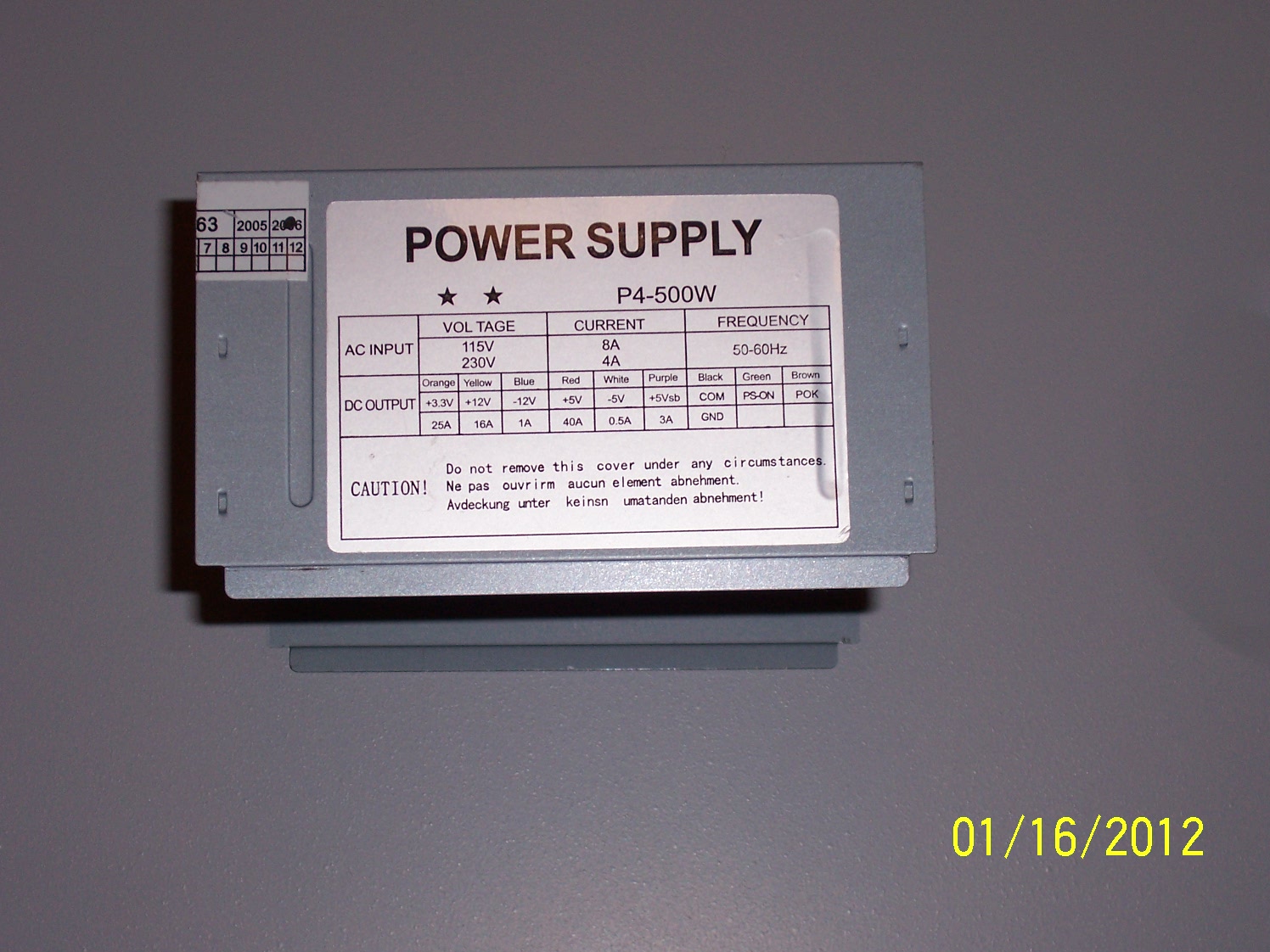

    Keerda ATX-2000B alias P4-500W 500 watt psu

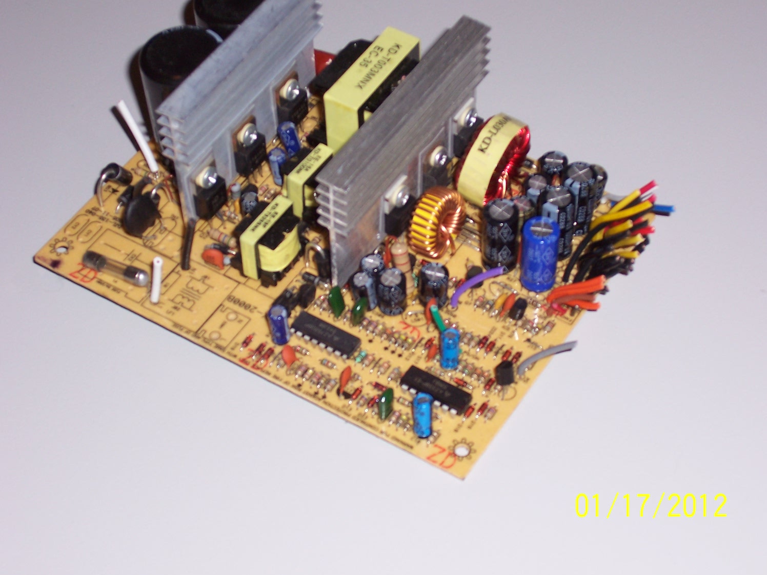

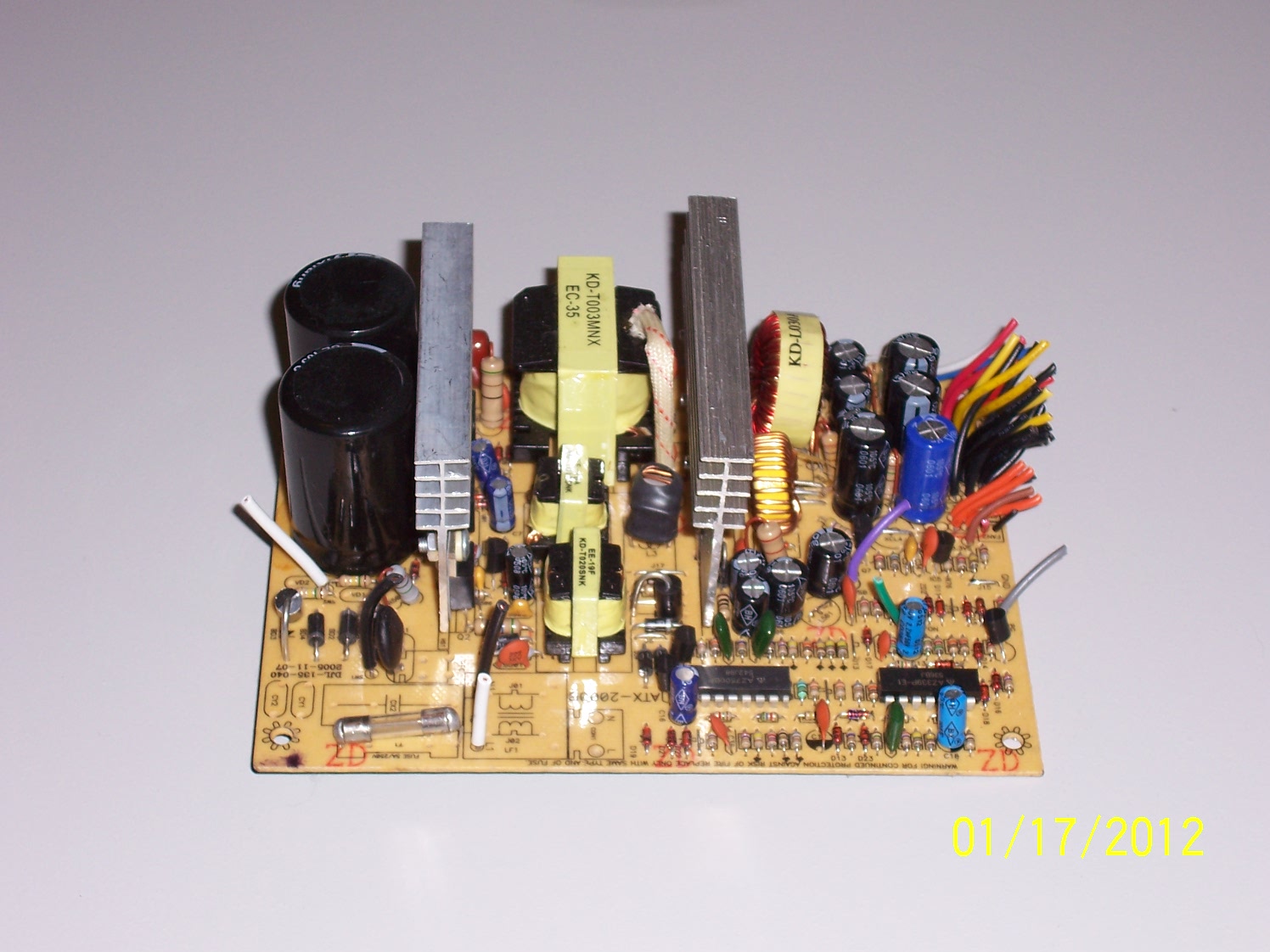

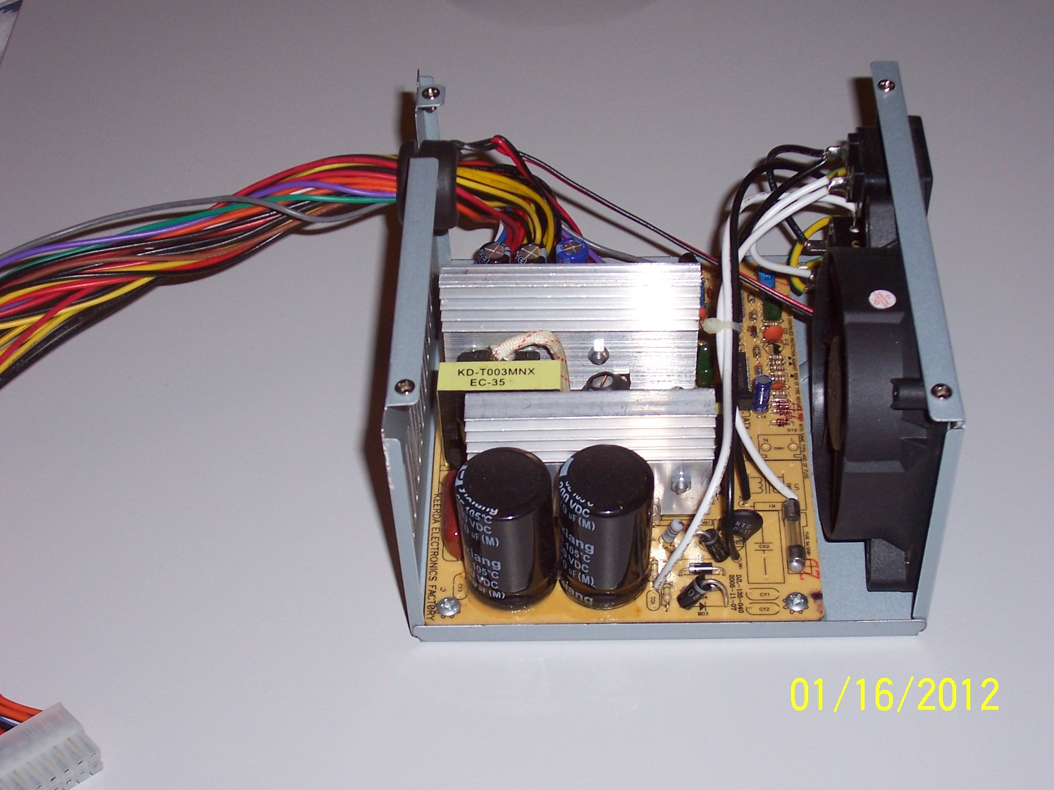

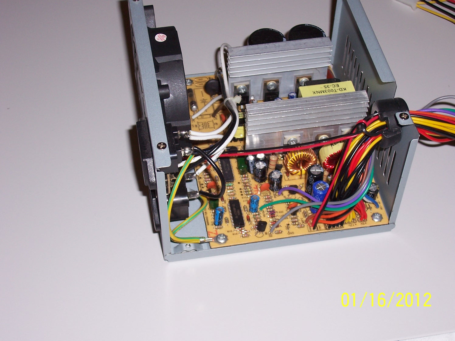

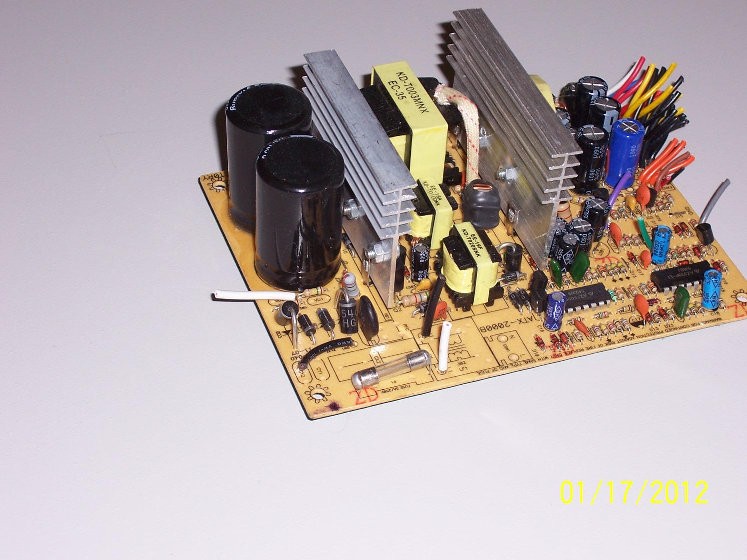

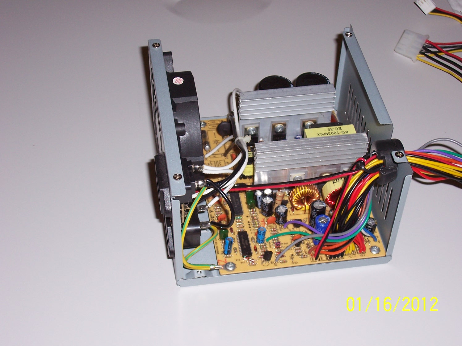

    I looked at the label and thought wow, 500 watts. I picked it up, and it was so light weight, I thought - is anything inside??
    So look at the pictures.....what do you think?

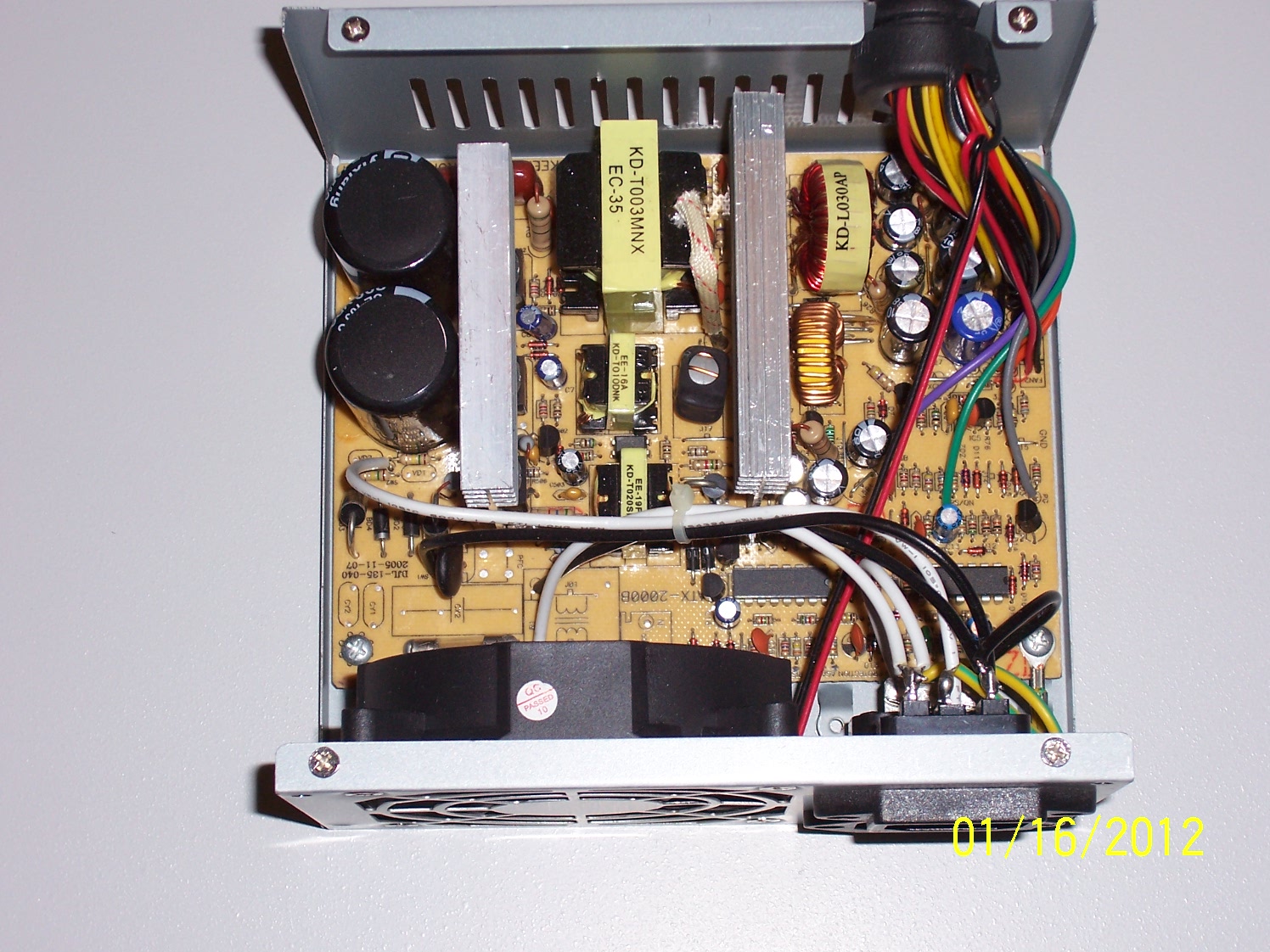

    Here is what I found inside:
    NO line filter
    No bridge diode, two 1N5408 diodes and two RL207 diodes
    Two YIXIANG 470 uF/200 volt main capacitors
    Two TT2146 switching transistors TO220 case
    2N60 transistor for two transistor 5vsb circuit
    AZ7500BP PWM chip
    AZ339P supervisory chip
    Output diode 5 volt rail MOSPEC S20C40C
    Output diode 12 volt rail STPR16 20xxxCT (x indicates marking rubbed off)
    Output diode 3.3 volt rail PEC516 SB1640CT
    Output capacitors all “BH” brand
    One 1000 uF/16 volt 10 mm
    Two 2200 uF/10 volt 10 mm
    One 1000 uF/10 volt 10 mm
    All other capacitors less than 1000 uF
    NO coils in output filters
    By the way, did you notice the UL certification number? How did this power supply get into this country???

    No PCB space for the output coils? Stick it in a fire and watch the caps go
      Look closer - i think i've spotted it. Once again the classic 494/339 platform. And just look at that proud label: POWER SUPPLY. It doesn't even say it's for a computer! And maybe it would be better that way.

        Re: Keerda ATX-2000B alias P4-500W 500 watt psu
        Now that you mention it, I can see spaces for coils on the 3.3v and 5vsb rails, but not for the 5v and 12v rails
            TT2146 is good for 7A. So the primary is overspec'd.
            The "ATX-2000B" suggests a 200W design and that's exactly what the secondary silicon is built to:
            STPR1620CT - 8A @12V = 96W
            S20C40C - 10A @5V = 50W
            SB1640CT - 16A @3.3V = 52.8W
            (Another few watts for 5VSB and -12 maybe.)
            Exactly. AZ7500BP looks like a direct clone of the TL494.

              The Yeulin has the same size and type heat sinks, but has a larger output diode for the 5 volt rail. They both seem to be "overrated". I think I will trade this one for a Bestec 12E. At least it has some potential!
              Has anyone seen any of the yixiang brand input caps? Or the BH brand caps in the output filters? I have never seen these brands.
