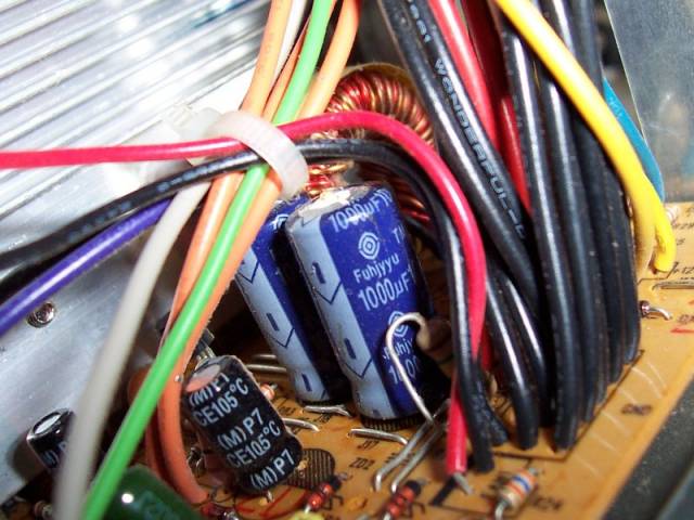

    My computer has been acting very strange lately with random restarts and what seems like a loss of power and many complete freezes of the system. I took apart my PSU today, made by TurboLink, and discovered these:
    Two blown capacitors...
    I've looked at my motherboard twice with no sign of bad capacitors although I guess you can never be sure, right?

    That looks like a Deer made powersupply, do yourself a favor and throw it in the junk and buy a decent powersupply instead

      I would take Per's advice on this one - Turbolink-branded PSUs are often Deer/LC Power under (a very thin) disguise. But Deer or not, Fuhjyyu caps (which in your case are definitely burst) are not among the best - and, judging from the picture, those solder joints between the output wiring and PCB appear weak too.
      The problems you've been having are certainly very typical for a malfunctioning PSU.
