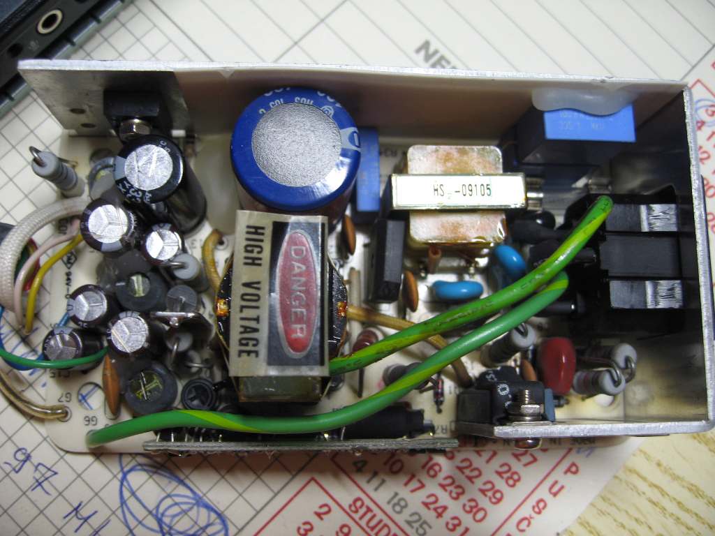

    Hi to all,
    OK, i have one SMPS from SynOptics and it's not working. Ratings are 100-220V 47-63Hz, 0.6A-0.03A, output is +5V 2A, +12V 0.7A and -12V 0.1A. It is used as power supply of some network hub (i need that hub working - and yes, i know that switch can be found under 20$ ) Fault is - no output voltage.

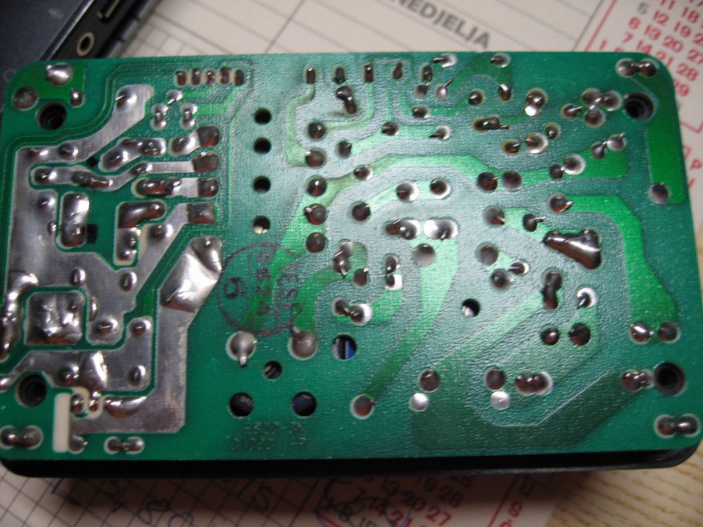

    When AC plug is plugged, i can measure 310V DC on main filter capacitor on primary side and the same (DC) voltage on primary side of transformer. There is no AC voltage on primary side of transformer. From the other, secondary side, there is absolutely zero voltage (ac or dc) comming from transformer. From secondary side, nothing looks burned, nothing shorted (measured by dmm), every component looks good on testing with dmm. I tried without cable cause i first thought that cable is shorted, but nothing. Only small discolouration on PCB is under switching transistor (i guess it is switching transistor), which can bee seen on the picture from above (near the bottom right corner).
    Caps are Rubycon
    Any ideas where to continue?
    Thank you!

    Re: SyncOptics SMPS - no output voltage
    From the lack of an IC I'm guessing it's a 2-transistor self-oscillating circuit.
    Check the transistors, they may have failed open.
      Hi, thnx for the tip. I found this FET with markings SSP6N60A as failed.
      I can't find it here in shops, can you recommend replacements?
          http://pdf1.alldatasheet.com/datashe...G/SSP6N60.html
          Any N-channel MOSFET with equal or better ratings will work. There are many manufacturers making 6N60s.
            Thnx guys, i found the same FET but there is no improvement. Any further ideas?
            • b700029
              Banned
              • Sep 2010
              • 640
              Check for anything else in the circuit that's damaged.
              I wouldn't just replace one damaged component without checking all the others, or it might end up dead again.
