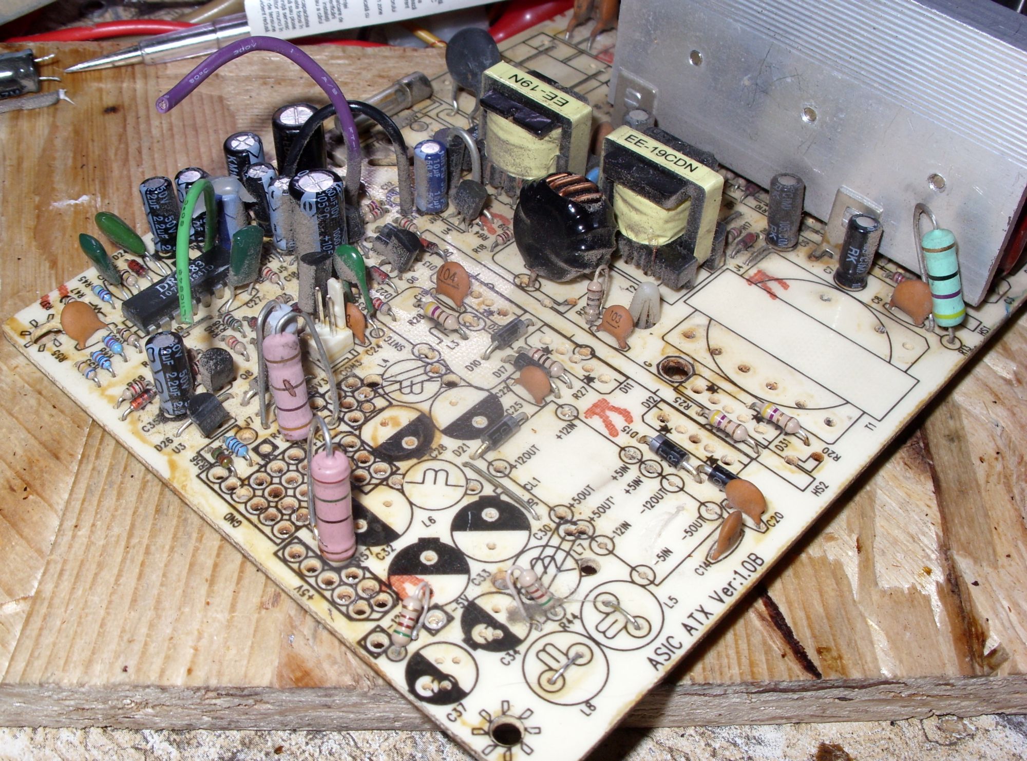

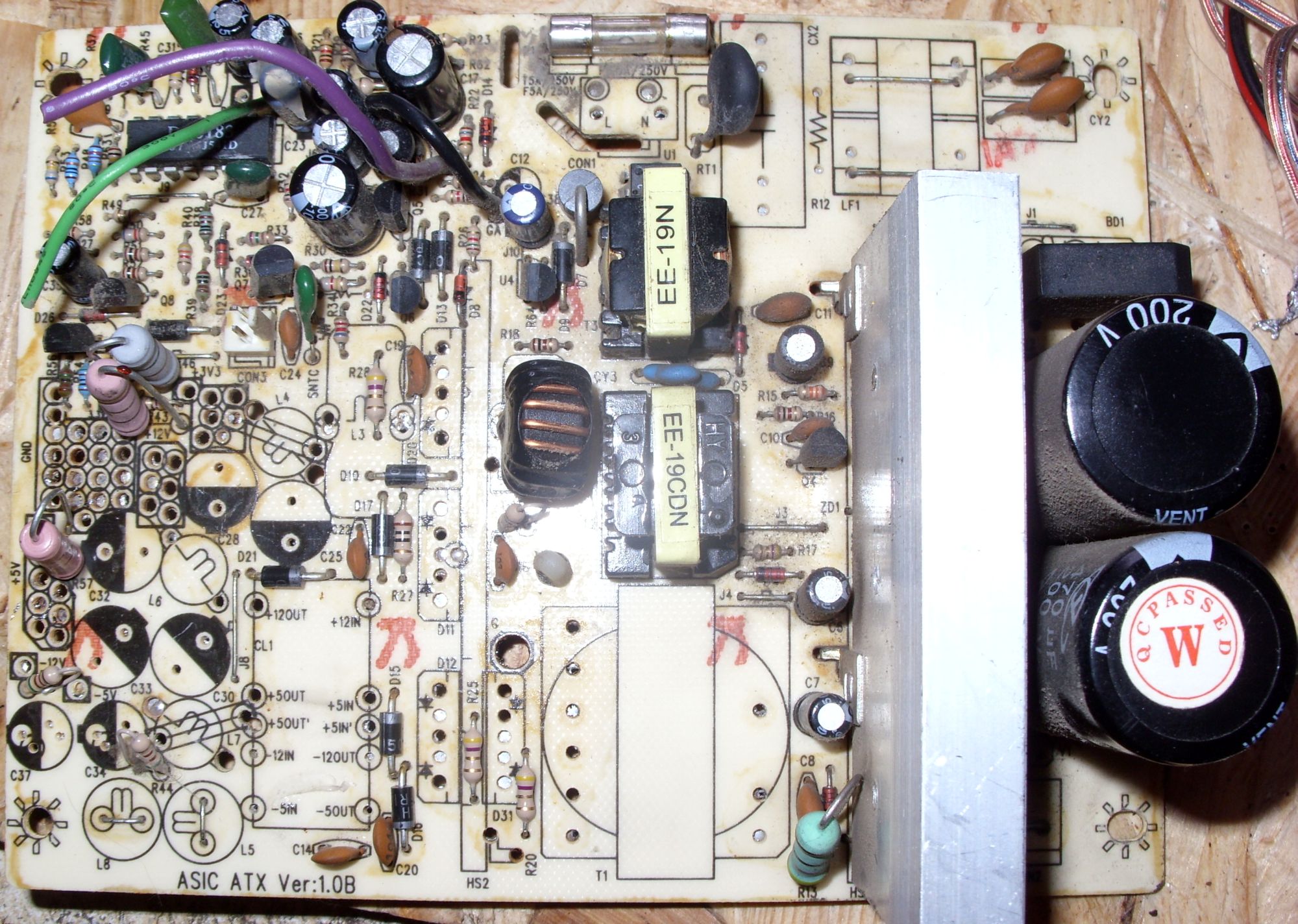

Here's what we have on the dissection table today...
JNC LC-A300ATX

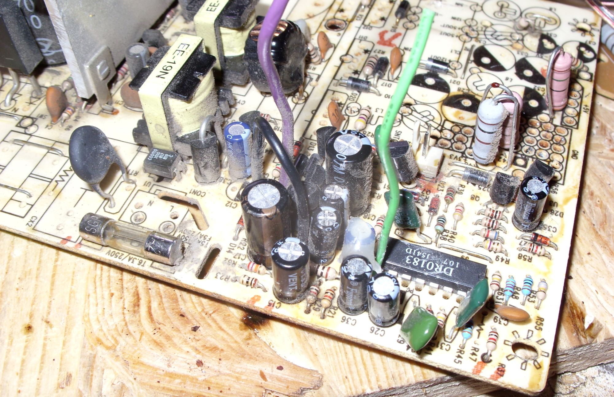

Platform DR ASIC ATX Ver:1.0B
The custom DR0183 controller works at 60kHz based on info i've found on the net, see attached archive for more photos and partial schematics. His version was rev "A" though while mine is rev B, mine is a bit better built and more honestly rated. It still had crap secondary caps unfortunately (JEE, all bad). Main transformer (EI-33 ASB) had 19+20 turns primary. Together with the 1uF coupling capacitor, this resolves to just under 200mT flux which is appropriate for this core at this frequency and power. 3+3 turns for 5v, another 4+4 turns in series with 5v winding for 12v. So we have 3 turns for 5v and 7 turns for 12v.
30A schottkys for 3.3v and 5v, 10A fast recovery for 12v.
Label was honestly rated if you want to believe this...
3.3v @ 20A, 5v @ 30A, 12v @ 10A, -12v @ 0.8A, -5v @ 0.5A, +5vSB @ 2A
Max combined load on 3.3v and 5v: 160W, 300W total.
It also has a temperature controlled fan. Hey, they didn't cut so many corners on this one.

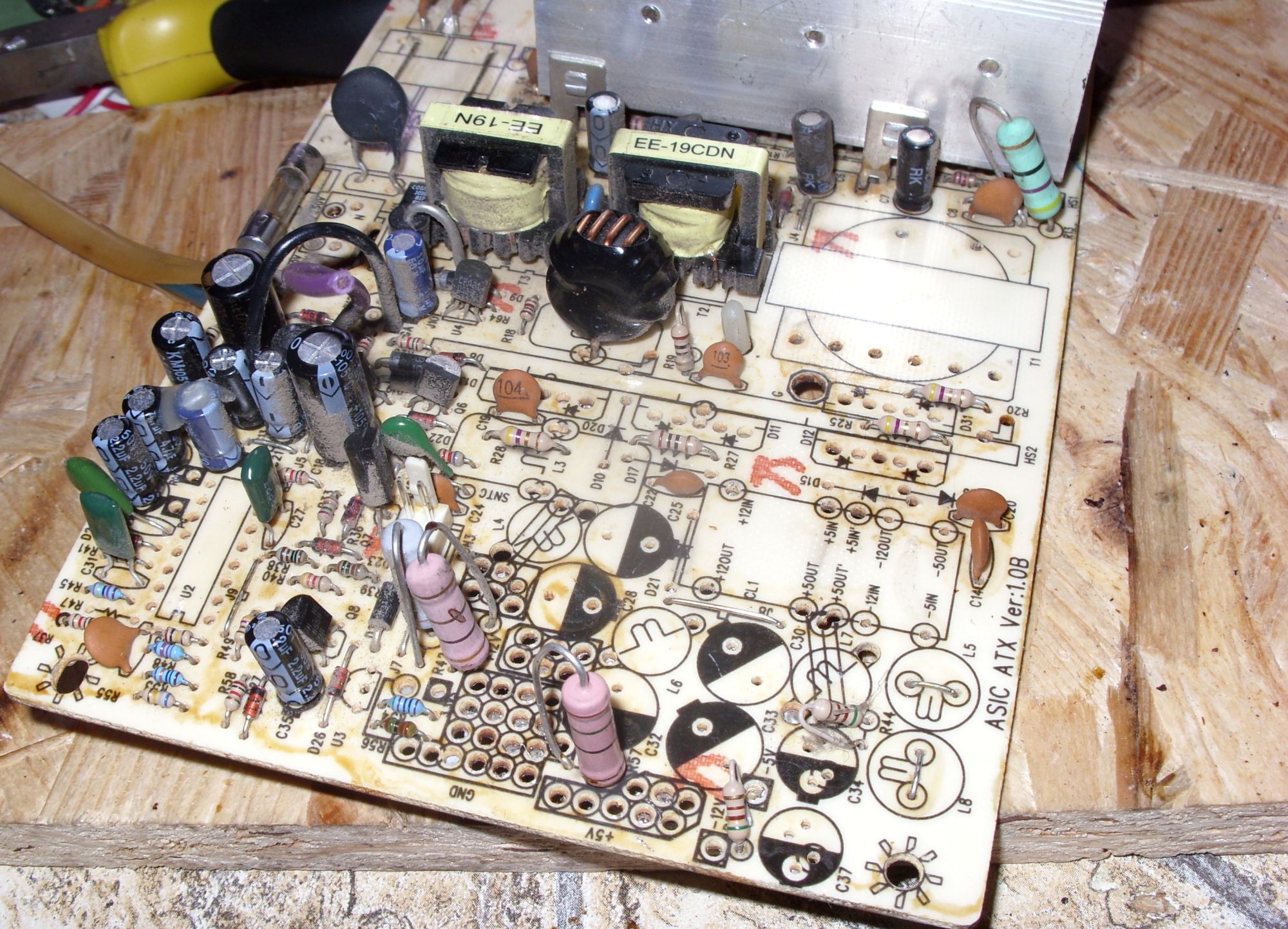

I proceeded to remove all the wiring, the bad caps, the secondary rectifiers, the secondary heatsink, the inductors, the little diodes for the negative rails, the main transformer, one of the TL431s... And finally the controller as well. Sharp eyes will see that i have also replaced a bad cap in the standby section. And believe it or not, i could strip even more stuff out and still have the standby section work, but i can't be bothered.
I left the standby supply intact as we're gonna need it. Btw, the standby section on this unit provides two voltages, 5v and 16v. The presence of the 16v rail is welcome, as that's what we'll use to feed our TL494. If you feel like adding some of the missing input filtering, now is the time to do so.
Next step, coming soon...

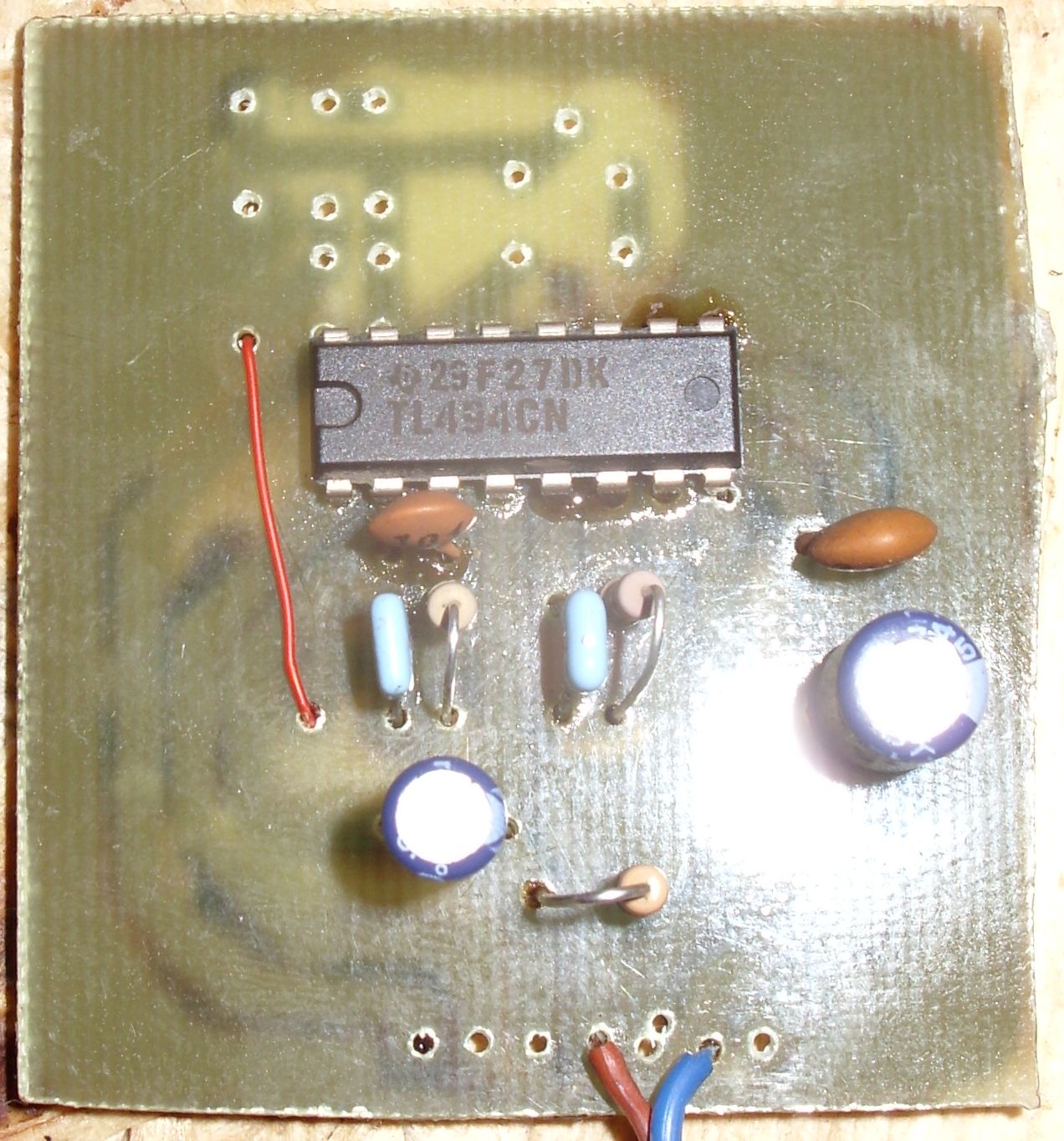

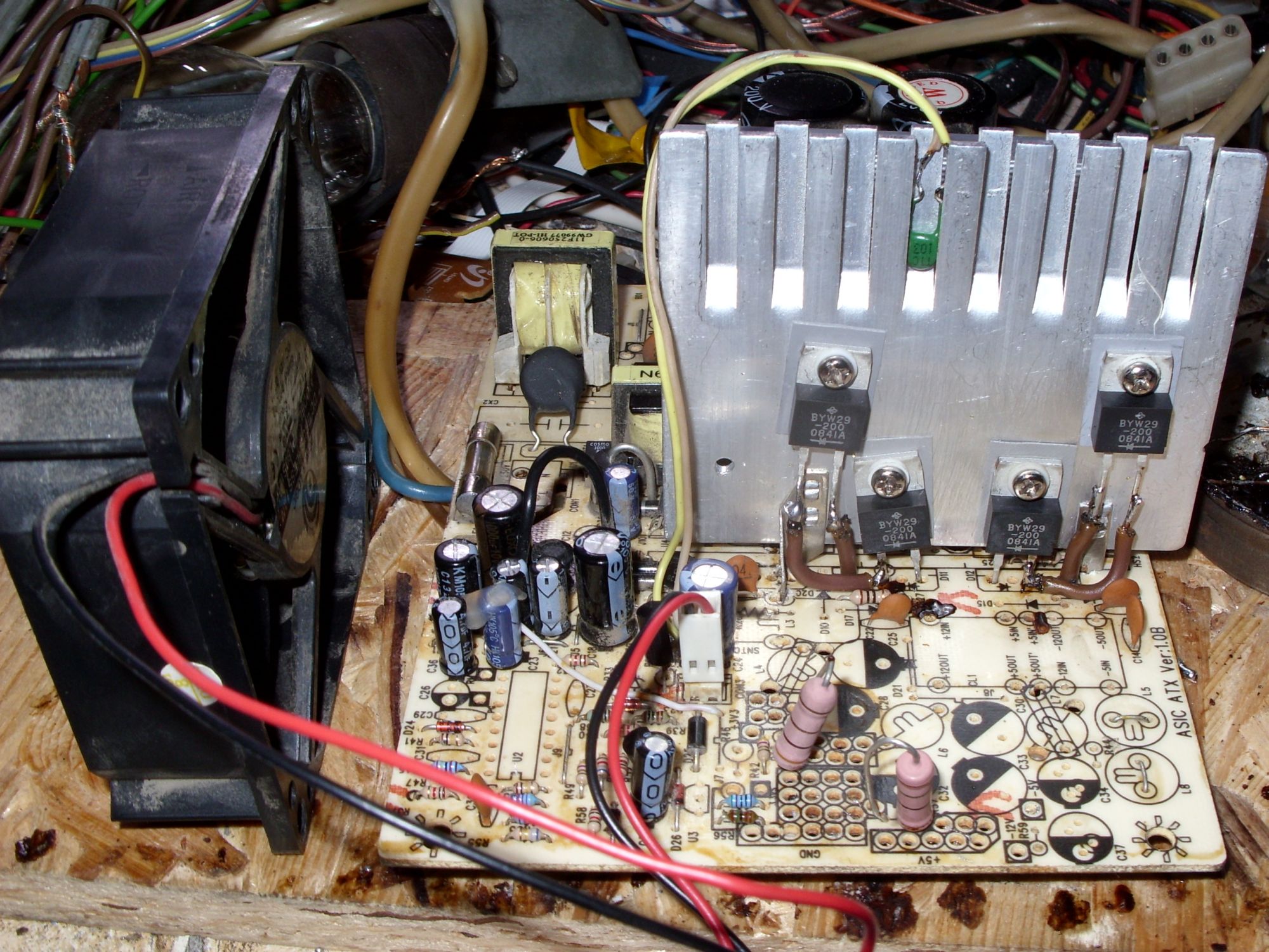

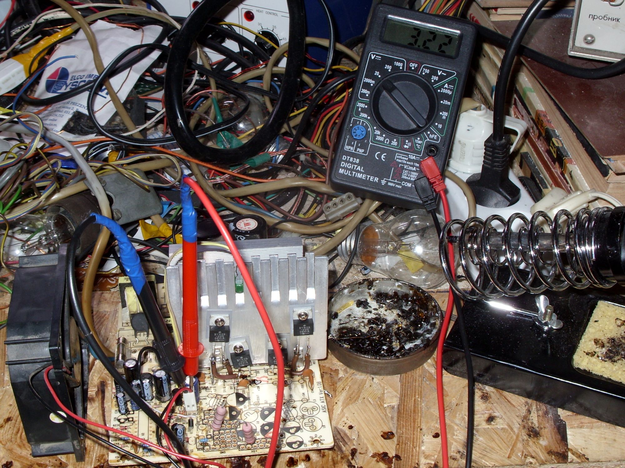

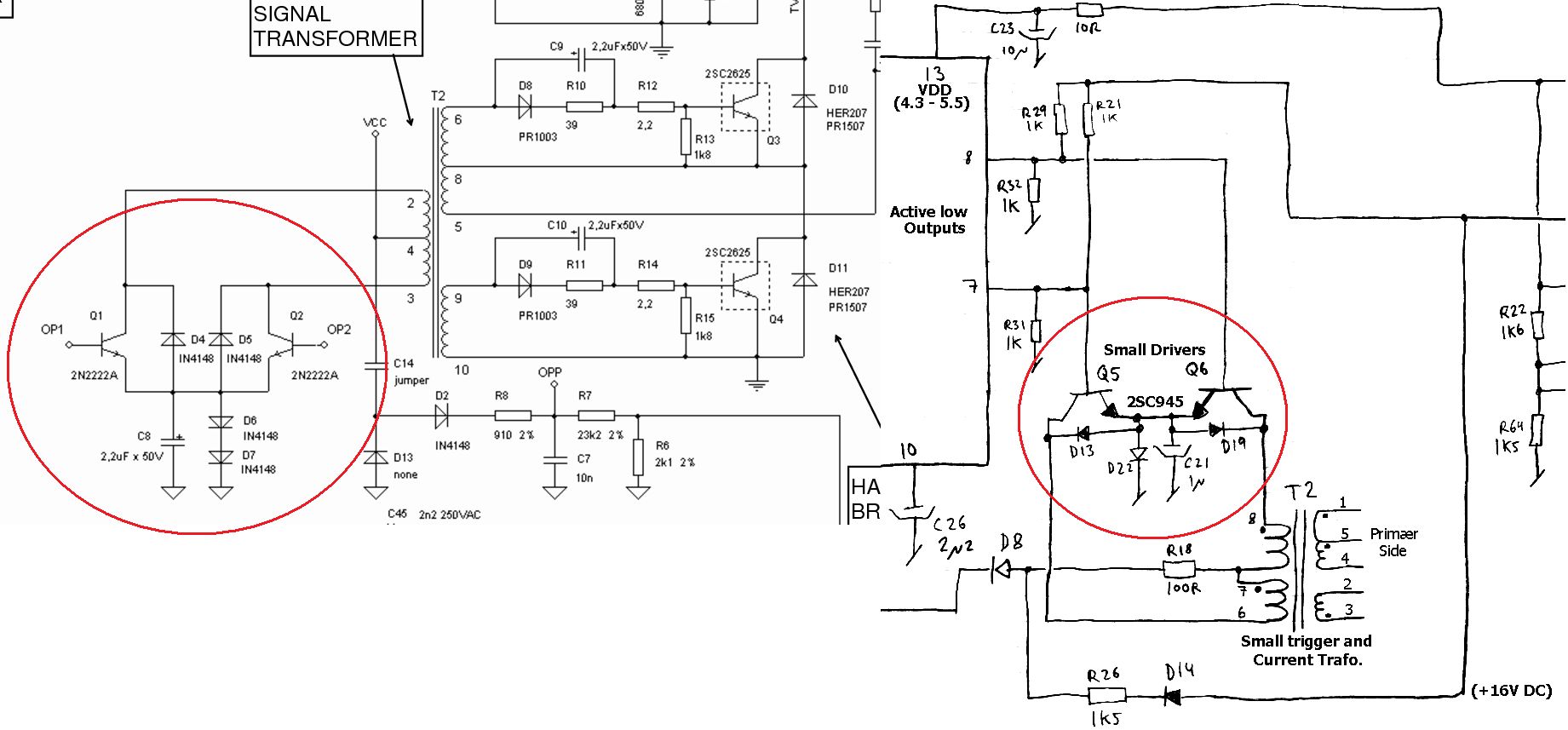

2003, 2005, AT2005B, DR0183, Linkworld, Weltrend... It doesn't really matter because ALL halfbridge PSUs are the same in the driver and power sections, and the proprietary controllers can be replaced by a TL494.
) That of course means the circuit will have to be reworked a little to accomodate the higher supply voltage.

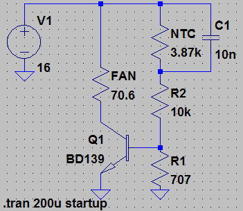

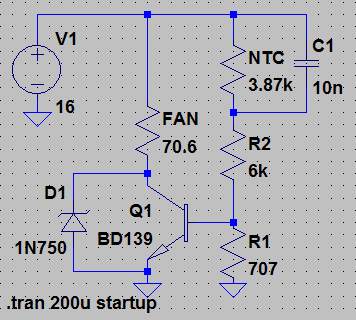

You can see the new heatsink and diodes, the insanely low voltage that the fan runs at when idle (btw, i went for a 470uF cap eventually, upping the time constant to 1.8 seconds, and i left the wires long on the NTC so that i can fit it on either primary or secondary heatsink, whichever will happen to run hotter), and a partly assembled TL494 daughterboard.
And the thermally controlled fan isn't even at full blast yet.
