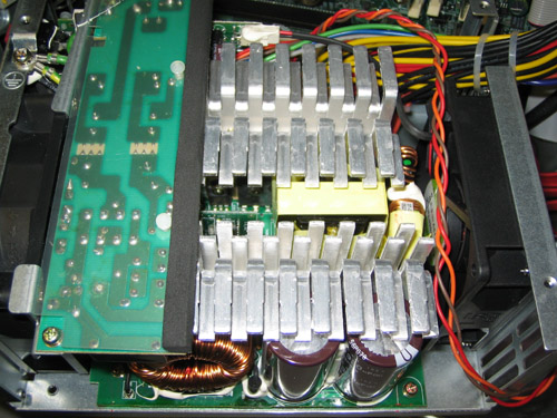

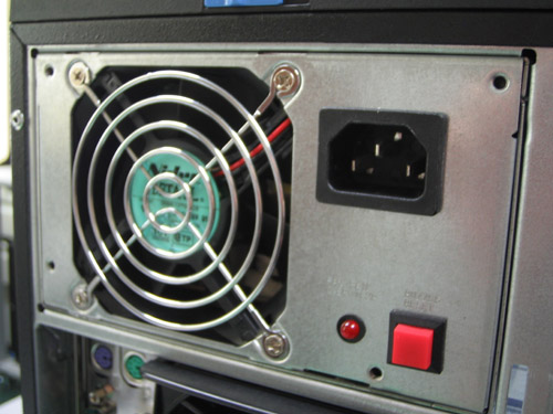

    Somewhat belatedly, but as promised, pictures of the two-fanned cousin of the 0060, the Ablecom SP650-RP aka Supermicro PWS-0056.
    The attached photos are kindly provided by John Galvanized, and Minerva of Anandtech-Forums fame.
    As you can see, the 0060 and 0056 are almost identical, save for a few defining features:
    1. The 0060 bears a single, temperature controlled fan. The 0056, on the other hand, has two fans, and a larger fan-control PCB, supporting a buzzer and LED to warn of fan failure, and a fantastically inviting BIG RED BUTTON on the back, as you can see below:
    Larger, more feature-ful fan control board. Output caps are the same.
    2. Specifications and power circuitry for the two psus are, as far as I can see, the same. The hardly-significant 5W rating difference is, I suspect, done by Supermicro to allow for customers to more easily distinguish the two models. Both units are built around the LITEON PS-5651-1 server PSU.

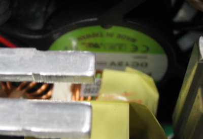

    Same heatsinks and input caps too:
    Sunon fan on the intake (shown), Nidec on exhaust (in first picture).
