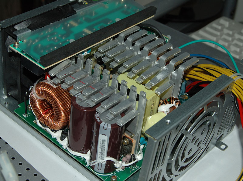

    Hello to everyone,
    While rarely underrated by the PSU-connoisseurs among us, I've always felt that those power supplies marketed as "server accessories" by Supermicro/Ablecom get far less attention from the 'enthusiast crowd' than they deserve. Despite their often impressive price:performance ratio, suprisingly little information is available on the web as to their inner workings, detailed specs, and, of course, their true manufacturers. Hence this thread.
    I'll start with the Supermicro PWS-0060 (Ablecom SP645-PS) model, which can be bought for $130 or so, a bling-free 'enterprise-class' workhorse rated at 645W total output, and 46A on its single +12Vdc rail. I've cracked open its hood to reveal a few of its "secrets":
    1. Who's his daddy? LiteON, interestingly. (It's actually a Liteon PS-5651-1A1)
    2. Output caps? All green Taicons - any experience with these?
    3. Input caps? 2x N.Chemicon 450v 300uF (bottom image)
    4. Fan is a Sanyo Denki San Cooler 9A0812G405
    5. Output wiring for main rails is 16AWG, rest is 18AWG

    Re: Supermicro-Ablecom PSUs
    welcome
    taicon caps are not so frequently seen in the market. we have seen them on an intel serverboard sai2, a few asus/asrock boards and a monitor from 1995 still working. i am still running an asus board with them on without probs for a few years.
    but the asrock were not so fortunate
    https://www.badcaps.net/forum/showthread.php?t=1308
    thats remarkable...should be adequate for next years gaming systems lol.
    sanyo denki are good fans but why no second fan. looks nice anyway enjoy.
      LiteOn produces high-quality PSUs for OEMs.
      I haven't seen any problems with Taicons.

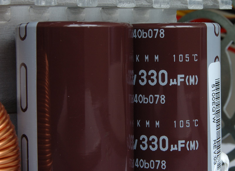

      450V - so they're probably connected in parallel which gives you 600uF. In most PSUs they're 200V and connected in series which halves the capacitance.
      That's high-quality fan, it will still work fine after 10 years.
        Originally posted by willawake
        welcome
        Thank you After a few weeks of 'lurking', I couldn't resist joining (in the active, posting, sense), following my perusal of your fantastic "Funny Stuff" thread, with such gems as the "World's tallest building", The Glory Smooth Company, and the Albatron Cap-Popper Pro.
        taicon caps...
        I had indeed heard that Taicon caps were, in general, adequate - although there had been a few instances (peculiarly, almost always those on ASRock PCBs) in which they had all failed. If I understand correctly, Taicon is a Taiwanese "daughter" of Nichicon - could it be that the failed Taicons are differently-skinned analogs of the occasionally-failing HN/M Nichicons?
        I'm not a gamer myself (unlike my two kids!), although I am something of a PSU fetishist (Disclaimer: not in any way that my wife would mind).
        The absence of the second fan is, I agree, peculiar - and, as far as I can tell, due to the fact that the same metal "chassis" is used for both this version and its twin, the SP650-RP (marketed as with redundant cooling feature, also known as 'two fans'. And a little buzzer to warn of fan failure.) The PCB/component choice on both PSUs is, however, identical as far as I can see.
        Yes indeed - I've noticed with Fortron units that they will often use two 200v input elco's (always Teapo, it seems) directly connected in series. Two Enermax I have here, on the other hand, each use a single 450v 330uf Hitachi.
        And yes, my apologies - I've rather moronically 'typoed' the value of the Liteon's caps as 300uF, while they are clearly 330uF as can be seen in the enormous picture I included. That's what I deserve for trying to brag with my Nikon SLR on my first post.

                        Due to popular request (I've even noticed a number of other forums linking to our "discussion" of this particular PSU! ), an update of sorts with some more not-easily-looked-up information regarding this unit.
                        1. Some have voiced concern about the very short motherboard cables Supermicro-marketed PSUs often use. This is probably due to the fact that SM motherboards almost invariably have both 24-pin and 8-pin connectors at the very "top" edge of the board, which, in an SM chassis, would correspond to the position directly below the PSU's outputs. Measurements taken after my intense re-grommeting and cable-tying session, which probably reduces actual length by a centimeter or so.
                        24-pin connector: 36cm
                        8-pin EPS: 36cm
                        4-pin 12v: 43cm
                        Not the longest, but not insanely short either. Unless your case or motherboard is very unconventional, it'll probably reach without incident.
                        2. The unit has Active PFC
                        3. Not evident from the pictures is the size of the main components in this power supply - they are easily twice as massive as those found in my 480W Enermax. Particularly striking is the size of the two toroids, which are the largest I've seen in any ATX-compatible PSU.
                        4. The two input caps, as mentioned are UCC KMM, 450v and each 330uF. Apart from these two, every single vented electrolytic I've been able to find anywhere in the PSU is a green-sleeved Taicon.
                        The fan-control board has one tiny, non-vented OST, just to be contrary.
