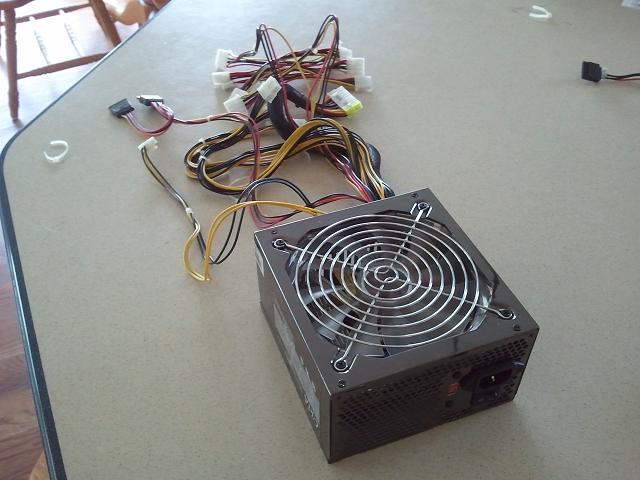

    First lets start off with an overall shot.
    With this unit, you get what you would expect from a 650W from 2001.
    1x 20+4 pin motherboard connector
    1x 4 pin P4 connector
    1x 8 pin EPS connector
    1x 6 pin PCI-E connector
    1x 6+2 pin PCI-E connector
    7x (!) molex connectors
    2x Floppy connectors
    3x Sata power connectors

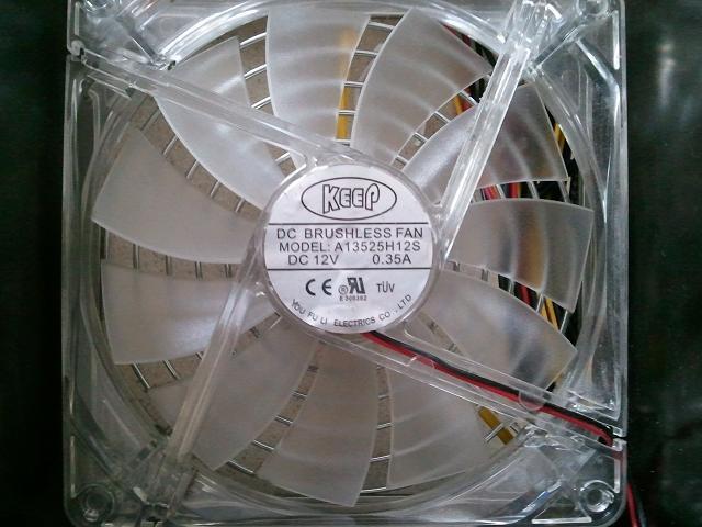

    Uhh, thats a new brand. The UL number leads to You Fu Lin electronics. The fan is pretty cheap, when I first got this unit and fired it up, it spun real slowly, me just thinking the temp control was real aggressive (this unit does indeed have temp control,) then it slowly started spinning up and made a horrible racket. I took the fan out and noticed that the bearings were completely dry, and look like they never had any oil from the factory. A few drops of oil later and it runs just fine. Interesting to note, it is a 135mm fan, quite impressive, but the hub has the motor of a 80mm fan inside of it. Cheap.

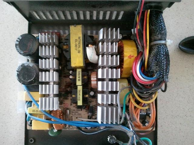

    Geez, this looks really familiar. I don't know why. Anyways it looks favorable for a 400W at the max. Decent sized heatsinks. Big ol' transformer. Full input filter, and a bridge rectifier!
    But why does this layout seem so familiar?

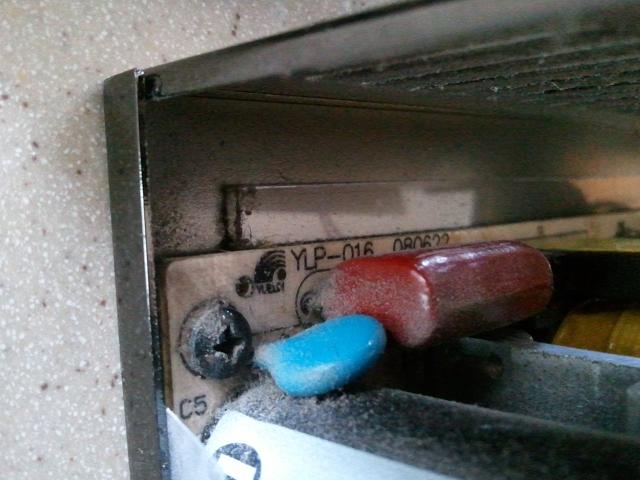

    Ahh, thats why. Its another YueLin unit. I'm use to working with the YLP-013's. This is a YLP-016. There is a few notable differences. I will...uhh...note them as I go.

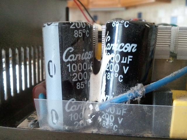

    Canicon is a recurring theme in this unit, as in everywhere. Every single stinking cap in this thing is a Canicon, and none are visibly failed. The bridge rectifier there is a 6A, 600V KBU package, good for up to 100C.

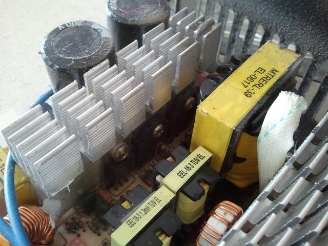

    The primary switchers on this unit are two D4515 by Jilin-Sino in a TO-3P package. Rated at 400V and 15A continuous. They are used in a half-bridge configuration. The larger 5vsb transformer is closer to the primary switchers than on the YLP-013. It still utilizes a two transistor 5vsb circuit.
    There was too much in the way to get a good shot of the secondary rectifiers, but I was able to eyeball their part numbers using a flashlight and lots of squinting. The 5v is supplied by a 60A, 45V schottky rectifier in a TO-247 package by Mospec. The 12v is supplied by two 16A, 200V ultra-fasts both in TO-220 package, again by Mospec. The 3.3v is supplied by a 40A, 45V schottky in TO-247 package, once again, by Mospec. All three rails are silkscreened for up to two TO-247 devices, where as the YLP-013 was only silkscreened for two on the 5v.

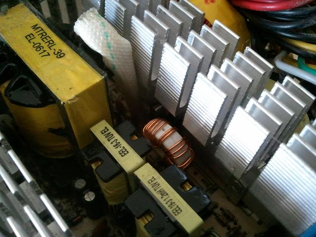

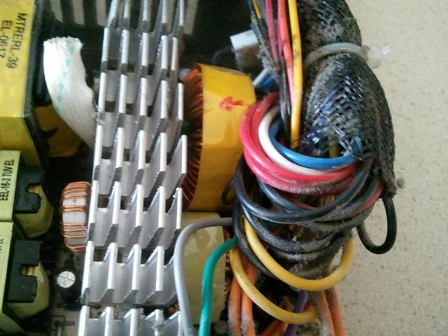

    The secondary toroid coils are quite sizable.

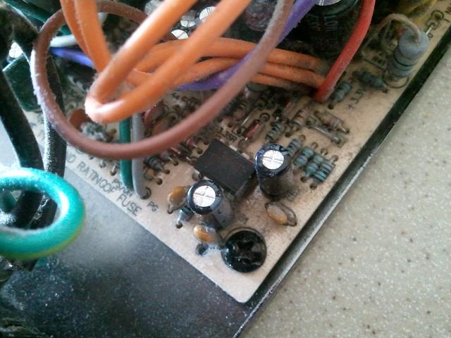

    The PWM controller/protections IC is a standard EST7502B found on the YLP-013, and the 013 is silkscreened for this little controller but is missing it. The little chip here is a Weltrend WT75180. I can't find a data sheet for it. I'd like to know what it does. I thought it was for 5v and 12v correction, as there is a 5v sense return and a 12v sense return silkscreened on both the 013 and 016, but they are not used on both. I'm thinking maybe it's for OPP?

    The Weltrend chip is most likely monitoring the rails and doing OVP/UVP. Not likely for this to have OPP. Even if it does, it'll probably blow up before the OPP point is reached.

      The EST7502B takes care of OVP/UVP.

        My bad, just read its datasheet now. I don't think you're gonna find out what it does unless you trace the circuit and do some measurements.

          >>The little chip here is a Weltrend WT75180. I can't find a data sheet for it.<<
          Perhaps WT7518D ??

              Ah hah! Yes, it is, yes it is. It says it does OCP in the data sheet, but I can't find any shunts on the secondary so I must assume it does OPP then.
