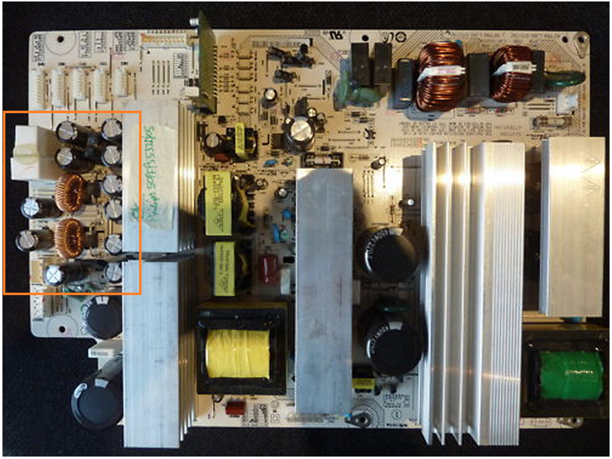

    I have a Philips 50PFP5332D/37 with bad caps on the power supply. It had some bad caps that were making power up very slow. While replacing the bad caps, I got confused and fear that I do not have the correct caps in the correct place. The power supply is a lj92-01511a. I have searched in vain for several hours on the net trying to find out the correct cap sizes. I even purchased a repair kit off of ebay, but the included directions do not match the location numbers on my board. I need to know the cap sizes for the following locations:
    DC8402
    DC8410
    DC8417
    DC8418
    DC8414
    DC8413
    DC8405
    DC8404
    DC8407
    DC8524
    DC8013
    Any help with this would be greatly appreciated.

    I think I can lend some assistance here ...
    Assuming you still have the 11 caps you removed you can use them to determine uF and V you need to replace with. Then, looking at the attached photo compare sizes to locations on the identical board for positioning. I boxed the caps I suspect you removed in orange. Of course, if you don't have the caps you removed this won't be much help.

      Re: Philips 50PFP5332D/37 Power Supply Cap Info Needed
      Thanks for the reply. Unfortunately, I do not have the original caps. I really need something that shows the correct size for the location numbers.
