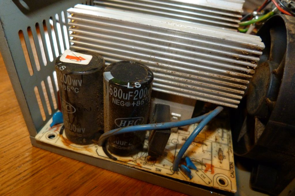

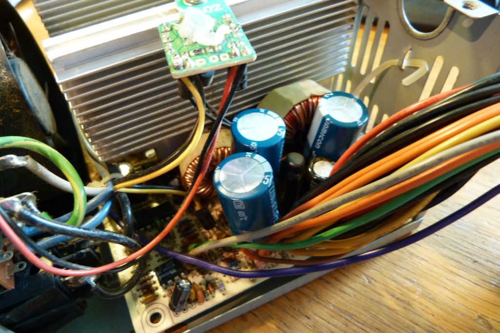

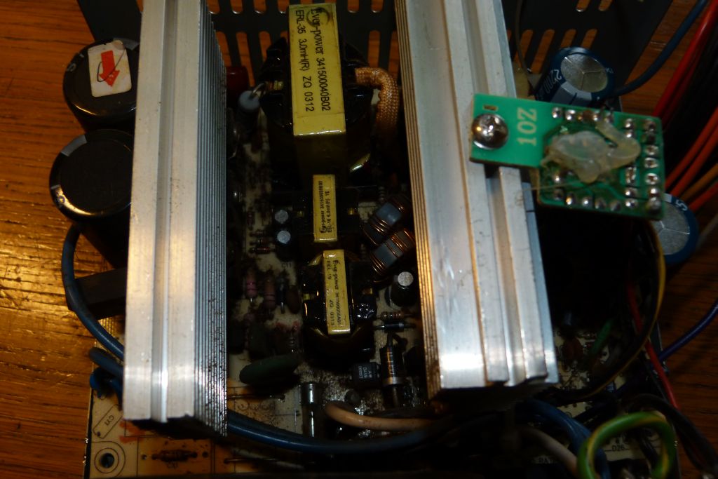

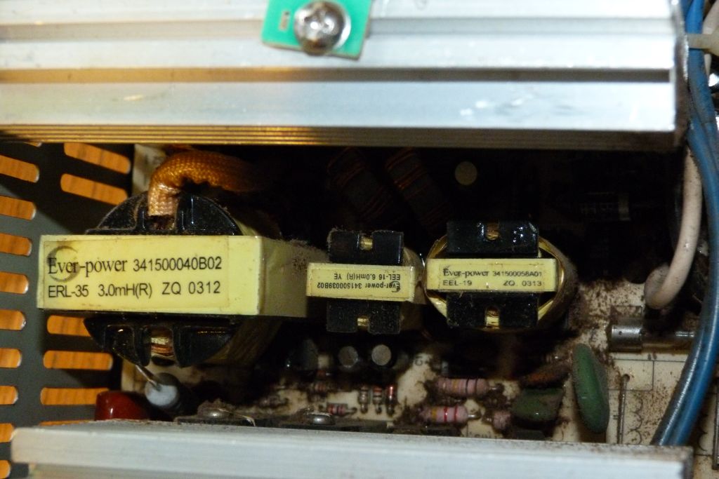

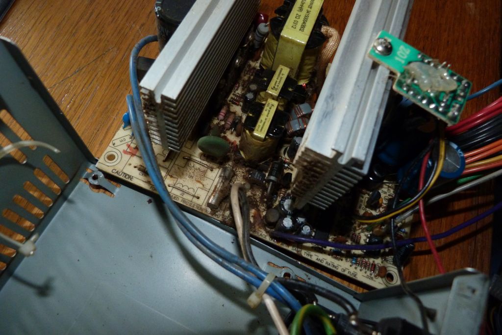

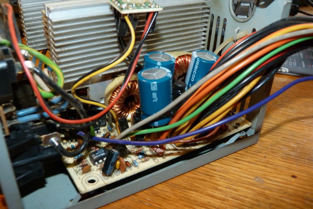

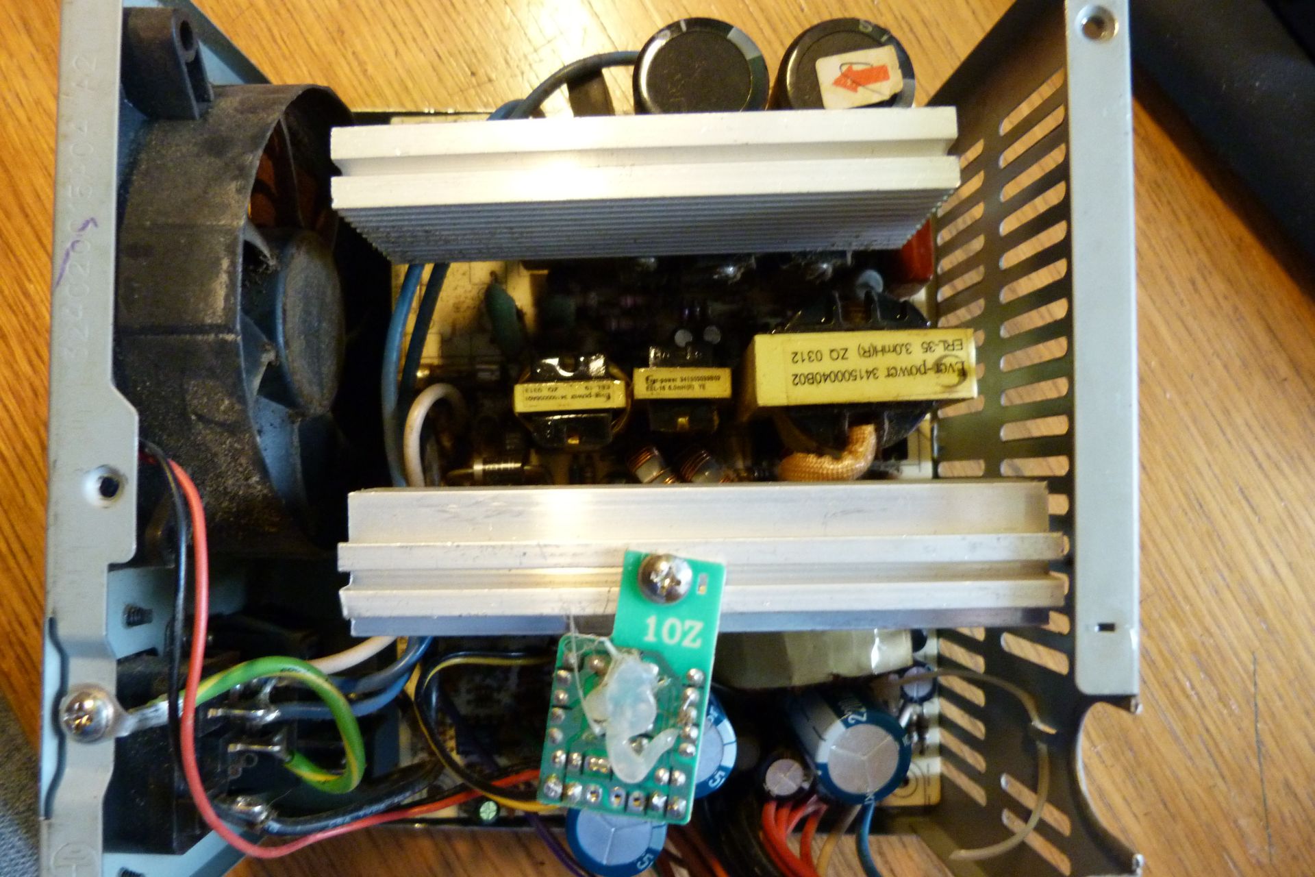

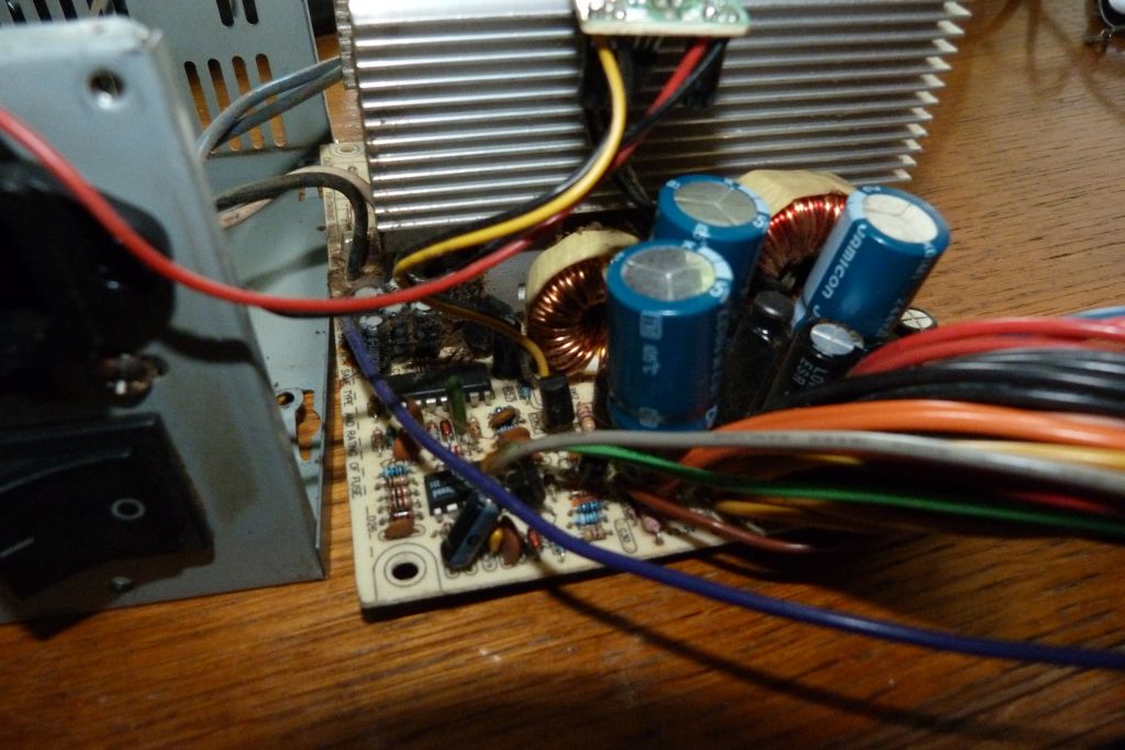

I got PC on repair with this bad PSU (Maxpower PL-400, 400w) which was overheating (vent blocked by alot dust).
Unfortunately, PSU fryed MBO and CPU because of huge oscilation in voltages.
5v oscilating for +-2v, and 12v oscilating between 6-10v.
When I opened it, 3 caps were bad (2200mF). When i swapped them, nothing changed.
Is there anything I can check and swap component for low cost or should just throw it away?
Thanks in advance
