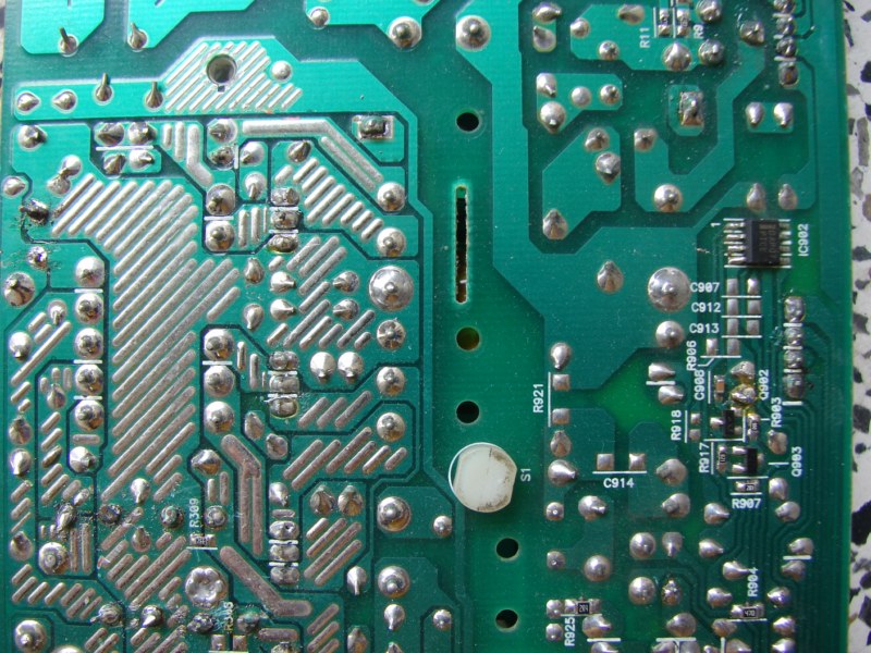

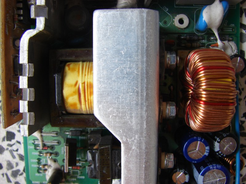

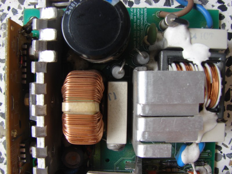

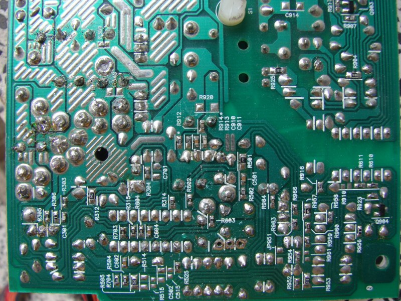

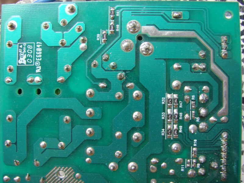

    I have some problem with my newton's power supply. The purple line have 5 volts but it can't start.
    So i decided to replace caps in secondary side but nothing changes.
    If anyone can help me please tell me howto fix it.
    I attached some pictures of this power supply.
    Thanks All.

      Thanks Th3_uN1Qu3 but i don't know howto
      1.check the shorts
      2.i can't find controller datasheet ("2M4 1000DS" label)
      3.primary transistors, could you specify for me.
      Could you please write in the pictures , i provided?

        I try to check Resistors ans Idodes, no found opened.
        If someone have any idea, please tell me.
        Thank you all.

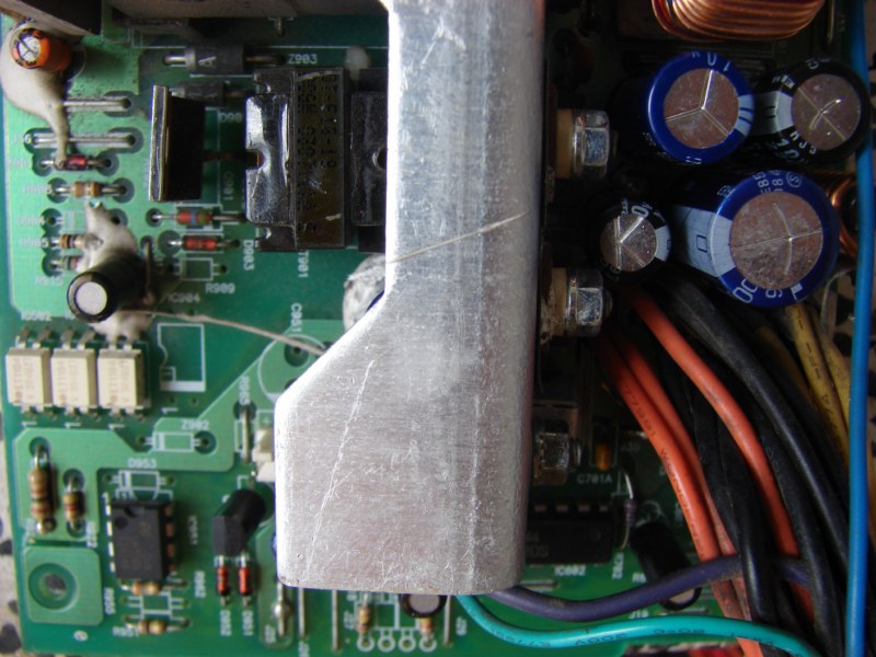

                      fan twitches. I'm sure the problem in secondary. But i don't know where.
                      shorted component not found , i checked all resistors and diodes and transistors.
                      i suspec in controller/monitoring IC , can i replace another one instead?
                      label on front of controller is "2M4 1002DS" < Is it a controller we need?

                        Re: NEWTON POWER NPS-180 Can't Start
                        If the controller were failed the power supply wouldn't start at all.
                        in picture after i shorted 2 legs of controller, anything work fine.
                        so can u explain , where is the bad in this case.
                        I'm very
                            You haven't told us what controller it is and what pins you shorted.
                                No... but i think some of those parts around it did. Does the power supply work normally, with no trouble, with stable voltages, when the two pins are shorted? If so, you could just leave it like that and call it a day. It is probably one of the protections, if the power supply is working normally they do not need to fire.
                                If you want to fix it, look for cracked soldering and open resistors around it. Check voltages between each pin and ground when they are not shorted together, it'll give us a better chance of understanding what that section does.
                                  when the two pins are shorted , the power supply work normally, the voltage at each line
                                  red 5V yellow 10V orange 3.3V (I'm not sure why yellow is 10V).
                                  ----cracked soldering , scanned not found.
                                  ----open resistors , tested all not found.
                                  Do you have a datasheet of this controller?
                                  Do you have a schematic of this power supply?
