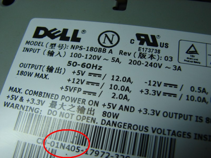

        Are you sure you read the label correctly?
        I can't find any mention of a NPS-180PB anywhere.
        NPS-180BB is a Dell proprietary unit [and very common.]
        NPS-200PB seems to be a basic uATX size PSU.
        [Although if it was in an old Dell P3 system some had proprietary pin-outs.]
        Mann-Made Global Warming.

            Re: NEWTON POWER NPS-180 Can't Start
            That's not what I was looking for. - It does not help at all.
            The PCB number is rarely what the model number is.
            That same PCB might get used in 20 different models.
            It is the model number on the box that helps to find things.

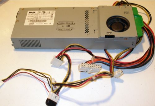

            - I need to see a picture of the sheet metal box that goes into.
            - I need to know the model number of the Dell it came in.
              HI PCBONEZ,
              here is your request.
              Yellow should be 12V that u told us.
              Why this power is 10V? Where is the problem? I'm so tried for fixing it.
                  So it looks like this then?
                  That is a very common Dell part used in.
                  Dell Optiplex GX60 Small Desktop
                  Dell Optiplex GX240 Small Desktop
                  Dell Optiplex GX260 Small Desktop
                  Dell Optiplex GX270 Small Desktop
                  And some others.
                  Should not be hard to find even in THAILAND but search for Dell PSU instead of NPS PSU.
                  There are maybe 3 Dell PSUs that fit but that are not NPS.
                  Also now that we know exactly what it is some members may actually have one to look at/check to help answer questions.
