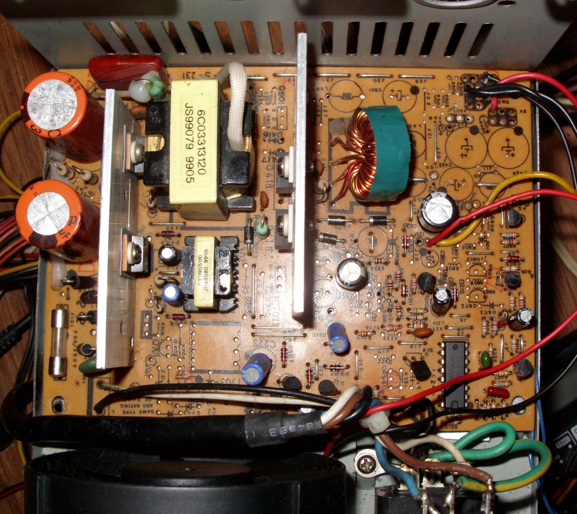

    I have said myself that building a PSU from scratch is better than modding an AT/ATX supply. Well, inspired by kaboom's work, i'm ready to prove myself wrong.
    I have a JNC "200W" AT supply. If you think you've seen gutless, you ain't seen this. There is zero input filtering - not even the room for it. The primary diodes are 2A. The heatsinks are ridiculously tiny, they don't even have fins. The caps are Capxon, SD and E.V.A.Top. No PI filters (but at least the board is silkscreened for them). It does have TO-220 output rectifiers tho...
    Funny thing, the board is printed for both AT AND ATX versions! Talk about low budget. I've been using it as an adjustable power supply for powering the control circuit of the power supply i am building from scratch. I wired a pot from ground to + input of error amp and that was it. Btw i managed to blow all Capxons on the output when i turned the PSU up to 28v - if there is an overvoltage protection circuit, i don't see it working. The SD cap on -12v escaped because it's rated for 50v.
    Well, i've been getting accustomed to compensating the TL494 (which btw is a lot easier than the textbook examples, because it uses a non-inverting error amp which gives you an extra 180 deg of phase headroom, and it seems not being able to have negative gain doesn't give trouble at all). The typical compensation for the TL494 is type 2, but the 2nd capacitor, that is to be put over the R-C network is usually missing. Either way, the 494 is easy to work with.
    The current state of mods: I have removed the 5v rail from the feedback loop. Next up are the -5 and -12v rails. I have temporarily installed 470uF 25v Rubycon caps for both 5v and 12v. The fan is now running from what used to be the 5v rail, this will be changed. It will be running from a temperature controlled circuit.
    Goal: Transformation to +/-45v with both rails regulated. Step by step, and with lots of pics.

    I almost built the big supply from scratch, but realized ~80% of the old Hipro could be reused. Driver TX, PCB, quad opamp, '494 and enclosure. Rather than redundantly duplicate what I already had, the thing got 'recycled.' Saves time when you don't have to do the PCB layout, etch, drill, etc.
    Eww... one of those cheap AT/ATX crossover bastards. I've seen what was essentially an AT PS with a small PCB for the standby/aux mounted across the two heatsinks! Lousy design too, the primary snubber resistor for the aux ran real HOT. Probably dissipated as much heat as all the standby ckts on the old mobos put together. Did the 'JNC' label have red stylized letters on a white background?
    The fact that you got such high voltages out of it by manually poking the feedback is interesting. This would indicate that unusually low duty cycles were used to 'regulate it down' to the 'puter voltages. I'll guarantee that thing was discontinuous, even till a few tens of watts out! Makes for nice high peak ripple current through the coupled inductor and caps. High output ripple voltage, too- what with no PI filters.
    They left the cap over the RC combo out 'cause they didn't want to AC comp it. Perhaps because of the stupidly low duty cycle?? The output inductor and capacitance of the rectifiers ring every time the 'spikes' from discontinuous operation excite it. The AC comp cap would feed these parasites into the error amp and upset it, so they left it out. They're counting on the extra phase margin...
    The Deers/Allieds/Apevias are pretty bad, but those crossover things were just junk. 'Crown' comes to mind immediately when I think of the AT/ATX trash. Just bastardize an existing design instead of starting over properly.
    I wouldn't have thought one of those things would be around so long after ATX became standard.
    The later it gets, the more transistors like to explode, so don't go too far in each day. Just sayin'...

                          Re: The "proper" AT-to-split-supply mod!
                          Nope, it's blue stylized letters on white background.
                          With a ~100W load i can still achieve 22.5v maximum. That's quite a bit, and seems to reinforce your theory. Strange thing however is that the highest measured efficiency is 60%, and with 100W dissipation the thing should have been burning in minutes. That doesn't happen. I think that due to the small capacitors i currently have, the ripple is high enough to fool one of the two cheap meters on the output (as i only have one TrueRMS meter and it's obviously used for monitoring current drawn from the mains).
                          Btw, over power protection only kicks in at 2.2A input. That's almost 500W! This is a 200W unit, right? Either the lousy efficiency numbers are real (but i can't figure where all the heat is going in that case), or it was simply designed to work only as short circuit protection. I don't know. The positive side of things is that i won't have to mod it.
                          That's interesting. I put in a 680pF cap with no issues. I also changed the original RC pair from 10nF/24k to 4.7nF/24k. Anyway, the thing starts oscillating when it's turned lower than 10 volts, because the duty cycle required is so low that the 494 starts skipping cycles!
                          I traced the -12v rail and it seems to be summed with the -5v rail before going somewhere. I assume it'll be going to the feedback node. I haven't traced the rest of the circuit as it's messy, but since i already left the 5v rail out of the regulation loop, it looks like it'll be safe to remove -12v and -5v too. Before, if the -12v and -5v caps were removed the supply wouldn't start. We'll see what it does now.

                            Well, removing the negative rails proved too much of a hassle (at least for -12v), but while tinkering with them i figured something out. I don't think they're even in the feedback loop but i think they power some of the driver circuitry.
                            "Wait... aren't those derived FROM THE SAME TRANSFORMER WINDING???" Why yes they are, it's just that the diodes are the other way round. So that means... yup. Just beef up the negative rectifiers, rewind transformer and coil, and tada, i have a split supply with perfect regulation.
                              Correct.
                              Only problem is that sometimes those diodes hide under the main coil, but you need to rewind that one as well, so no prob.
                              -5V and -12V usually aren't regulated, tho they sometimes are monitored for under/overvoltage.
                                The negative rail diodes are in plain view here. Btw, i just lifted the 5v rectifier and (apart for the fact that i now have to cobble up something for the fan), the power supply still works.
                                Here you have a pic. And before you ask, yes the 5v rectifier is still in place, i was too lazy to remove the transformer or heatsink to take it out. I just unsoldered it. And the -5v diodes too. Believe it or not, this PSU didn't have a lot of parts even before i started on it.
                                  Update. I have replaced the primary caps (2x 330uF CapXon) with 2x 470uF CS. Not the best but they'll do for this one. I have also replaced the lame PR1007 primary diodes (1A!!!) with 5A ultrafast ones while i was at it, and also installed a 4 amp bridge rectifier instead of the 2A diodes. These parts were quite a tight fit, this board really wasn't intended for quality. I've also done away with the big bulky external power switch and installed a regular single pole one. For now, it can only dream of an EMI filtering stage. I know i had one of those filtering boards that attach to the AC receptacle, but i can't find it.
                                  I have also successfully tested the positive/negative rectifiers. But i realized one thing while trying to make the output filter - iron cores start losing ground fast at high output voltages.
                                  So what's the next logical step? Of course, ferrite. Since i have tons of EI33 cores anyway (and a dozen more PSU boards coming in the mail), i took one of the untampered bobbins and hooked the primary (40 turns) then a half primary (20 turns) for an inductor. Results? Excellent. With 40 turns the core worked even with no air gap, and got just moderately warm after a 10-minute run at 100W. The core was out of the reach of the fan btw. And i'm sure that is 100% copper loss since the primary wire is 22AWG or maybe even thinner. Keep in mind the inductance is a few millihenry, more than 10 times higher than can be economically obtained from an iron powder core! But indeed this is too much inductance for my application and will cause overshoot.
                                  At 20 turns the core saturated without a gap and made this horrible screeching noise, then the power supply shut down. A gap made from a sheet of copy paper bent over 4 times corrected the issue, and the inductor runs even cooler since there is now just half the copper in the way. Problem solved. Now all i need is a new transformer and job done.
                                  I'll make some measurements of the actual inductance tomorrow.

                                      Believe it or not it ran fine for years. A Pentium MMX wasn't that demanding...
                                      • Current progress: Installed positive/negative rectifiers.
                                      • I'm going to make the 5v rail into the negative rail.
                                      • Found a bigger heatsink for the diodes but i'll have to drill a hole in it, as the only heatsink i had that had the mounting pins in the right place, doesn't line up in terms of holes.
                                      • Rewound transformer, used an ER-35W core this time. Should be good for 500W if the rest of the supply can take it.
                                      Now, time to patch it all together and fire it up. Stay tuned.
