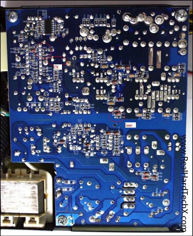

                      • venksp
                        • Feb 2016

                        Re: help, PSU without PG SIGNAL
                        I have a Cooler Master 460Watt PSU. I dont get a PG signal to boot my Desktop. Whent I Opened up the PSU, the PG circuit was outputting 0.7Volts The IC is WT7527 which gets only 0.15Volts in the PGI. WHen i checked the PIN 1 (PGI) the first Resistor was a 87K and the other side of it was getting a 15.5Volts. All other voltages 12,5,3 are fine. Please help fix this PG output problem. this is the PSU model RS460PCAR-A3.
                          So the resistor is 87K Ohms as marked on the resistor? Beside the resistor, what else is connected to that PGI pin?
                          What resistance do you get between PGI pin 1 and GND pin 2?

                          • venksp
                            The Resistor is connected to a zener diode on the back side of the PCB. This resistor is too small to verify (I check this 87K using MM) it has got 5 lines brown,red,orange ,yellow,brown on it.
                              http://www.realhardtechx.com/index_a.../Page24794.htm
                              This is the same board on my PSU but in a different name.
                                'it has got 5 lines brown,red,orange ,yellow,brown on it.' If that is the case it will not be 87K resistor.
                                How about GOOD CLEAR pictures of both sides of YOUR board if you want the helps in troubleshooting the problems.
                                Check the resistance between PGI and GND.
                                  The resistance between PGI and GND is 2K. I dont have access to a camera now ,so uanble to take photos now, the board is the same as the one i had mentioned earlier
                                  http://www.realhardtechx.com/index_a.../Page24794.htm.
                                    Basically 15.5VDC feeding the 87K and 2K Voltage divider, you are not going to get much voltage on the PGI pin.
                                    Take the resistor and the Zener Diode off the the board and check the resistance again, it can also be bad input pin PGI. I also expect a cap or two on that PGI pin also.
                                    I also do not believe the resistor is 87K Ohms, more likely 12K Ohms.
                                      After removing the resistor (87K?) the connectection between the Zener and PGI is removed. There is only a resistance marked 338 which mesausres ~2.2K between PGI and GND.The zener is not shorted. The zener side of the 87K shows the 15Volts. the PGI end shows 0.15 etc. I have marked the Components.
