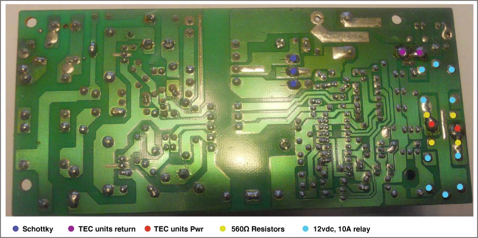

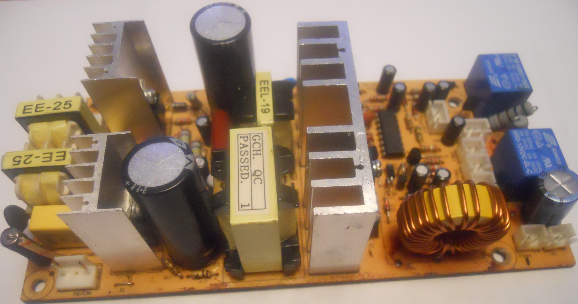

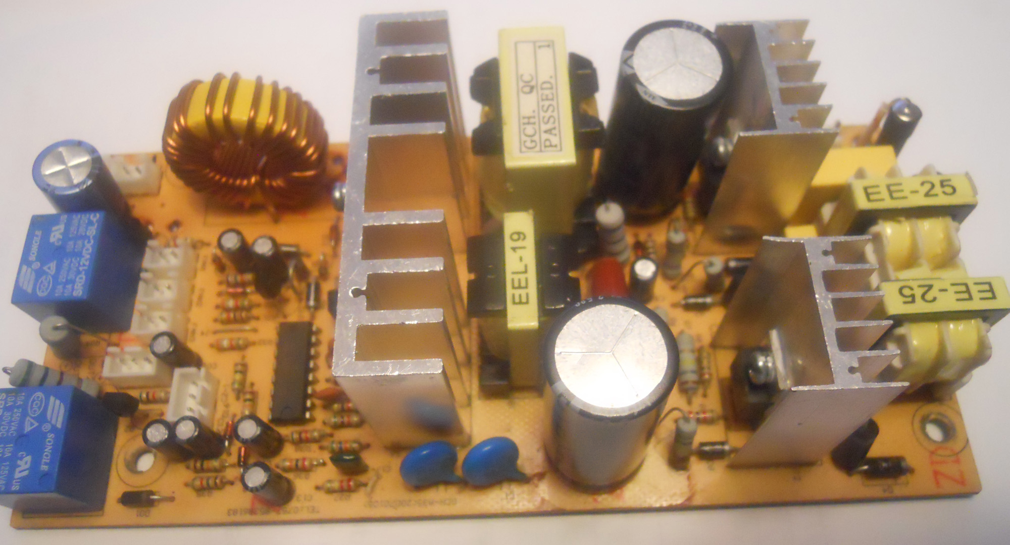

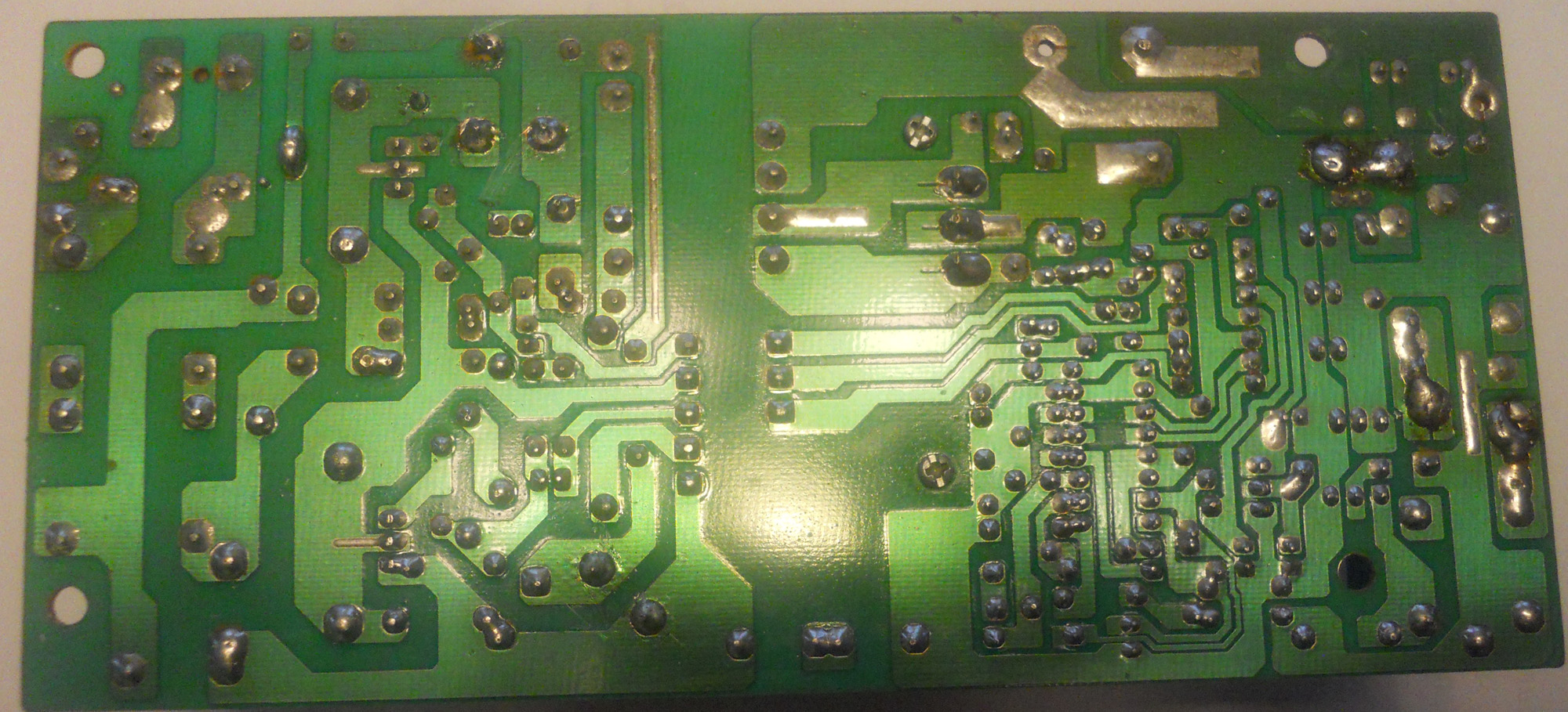

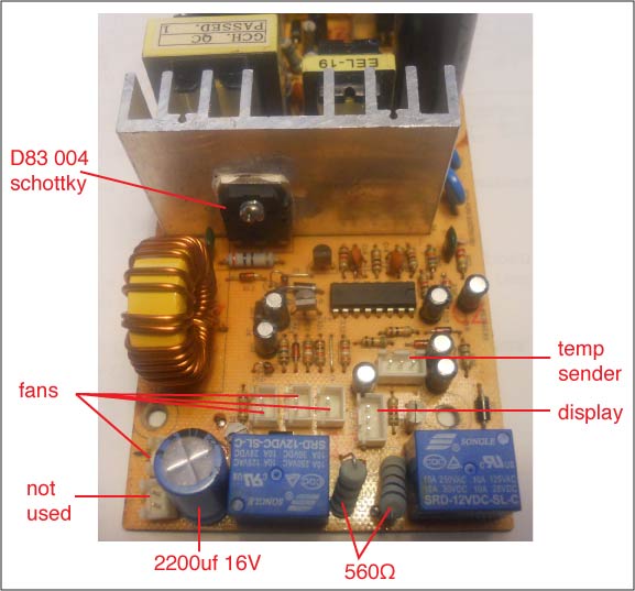

    I have a PCB from a Haier wine fridge (HVT18DFBB) that powers two thermoelectric units. when I got the fridge it had two TEC1-12706's (12V, 6A) that were not working. I replaced them with two 12709's (12V, 9A)The problem now seems to be that the units are under powered and it takes over a day to get to the correct temperature.

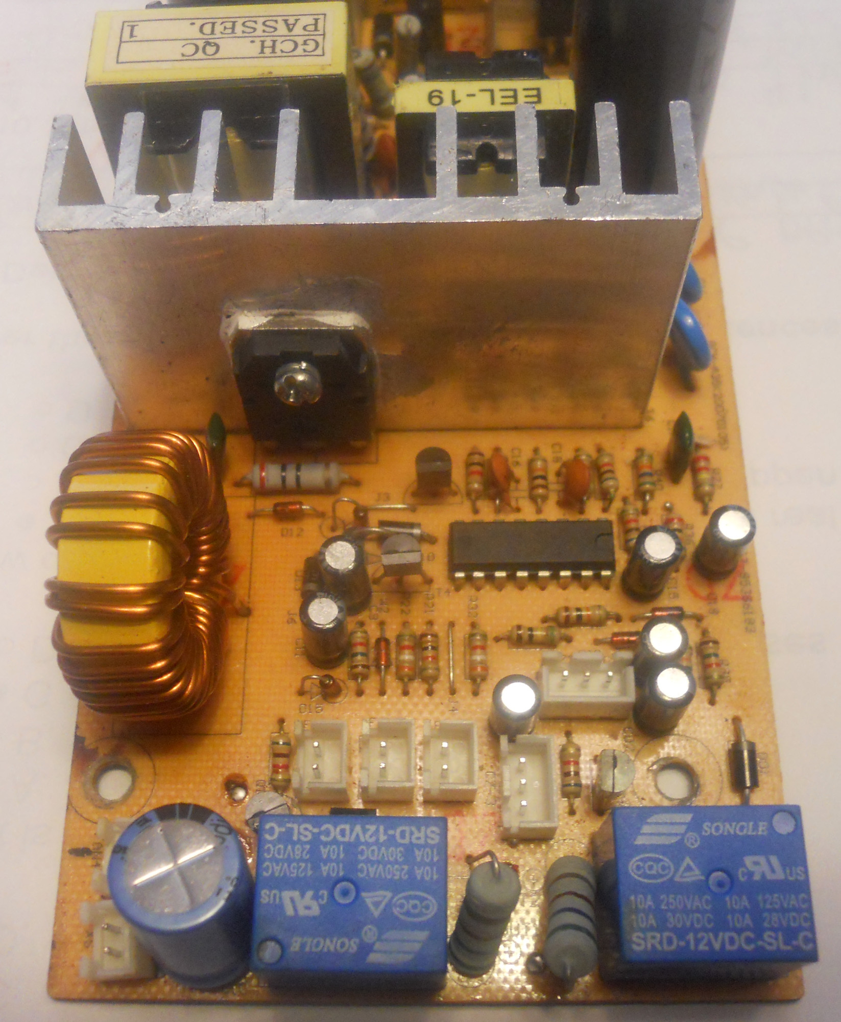

    I can't find any information on the web on this board, it's labeled GCH-A35(20070105) Part# is RF-5210-37. The PCB is a 1.9A 130Watt. The current going to the TEC's is 3A at 12V. The PCB seems to be working correctly, but I would expect to see something closer to 6A at 12V going to the TEC's. The D83 004 Schottky is rated for 30A, when the fridge is on this Schottky and heat sink get very hot.
    Anyway, I wanted to know it it was possible to increase the current going to the TEC's? I would like to give each TEC 6-9A

    Something is telling me that it's not the current output that is failing you but the load on the circuit may not be correct. What was the output from the original power supplies? Were their Schottky's getting too hot?
    If the load in this circuit is the compressor, maybe it's not correct somehow. Although, I've seen that the load usually increases and draws more current from a faulty compressor but I could be wrong.

      So you replaced the stock cooling modules with new ones that draw a higher current? Of course the secondary rectifiers are overheating the current being drawn from the PSU is too high.
      You need to find cooling modules with a max draw of 6 amps not 9. Surprised the power supply didn't die.
      These cheap Chinese Haiers have the power supply rated for not a milliamp more than needed. It can't absorb that monumental increase in current draw from the new modules.

        Is it possible to replace the schottky with one that will supply a higher current or will I have to change every component to get my 9A TEC's to work? Maybe I should just get 6A TEC's and forget about it.
          Re: PCB from wine fridge
          You would have to redesign the whole power supply and change the input rectifiers, switching FET, switching transformer, and output rectifier. All of these devices are rated for a certain max current that can safely flow through them without the risk of a burn out.
          A switcher is a tightly knit system you can't just swap out one component.

            Thanks, that's the info I was looking for - one last question, shouldn't the TEC's be getting close to 6A at 12V I'm only reading 3A. Is there something that could be causing it to only give 3A?

                    There is nothing controlling current. Current is drawn from the power supply the supply is being overloaded the new modules are trying to draw 18 amps out of the supply which is causing a drop. From the factory it was only designed to supply 12 amps to two 6 amp modules.

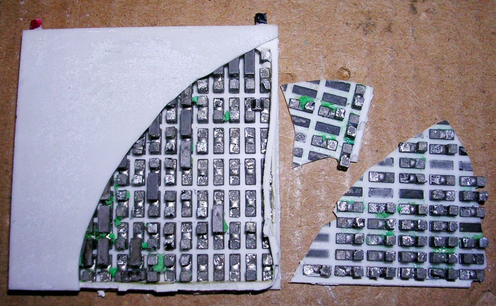

                        Not a supply question but here goes: I have replaced the TEC1-12706's in several of these wine coolers due to failure. All were "sealed" with white RTV silicone sealent around the edges. I'm a curious sort and have disassembled them all to find that in EVERY case, there has been a green colored corrosive inside which, I'm sure, led to the premature failure. Also, the sparse amount of heat sink compound used (on both plates) is appalling - it invariably dries up and adds to the problem. If moisture is going to permeate the module regardless of the silicone seal, why bother? Seems to me if air were allowed to circulate freely around the semiconducting elements, corrosion may not be as much of a problem.
                        Any comments?
                          Here's a photo of the corrosion that I referenced........
