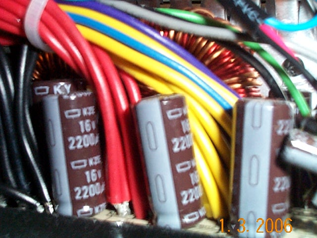

              Seasonic S12 380W with High reliability caps. This one came with United Chemi-con KZE caps on secondary side

                        Brand new 600W Fortron FSP600-80GLC. Adda 80mm fan. Caps are nearly all CapXion with a couple OST on the secondary side. PCB is marked "FSP700-80GLC main-board."

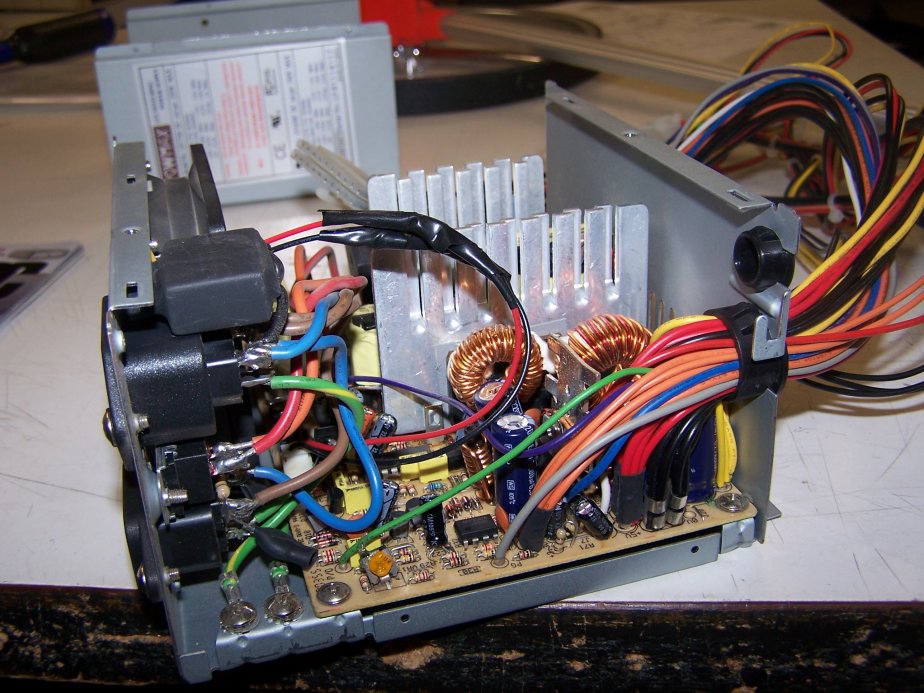

                          Bought a new PSU from Newegg to have as a spare for when I get Antec's and L&C's in with dead caps... So, without further adeu-
                          Sparkle (FSP Group) FSP300-60THN 300w PSU
                          Only down side I see is that they don't appear to have used that great of caps... OST on the main input side, and a combination of OST, Teapo and some others on the output side... not very impressive for something that's supposed to be a decent PSU. I like the big, quiet 120mm fan, but I think that a through and through air pattern cools better (in the one end and out the other, instead of having to make a 90* turn in the middle...).
                          Anyway, that's my new entry...

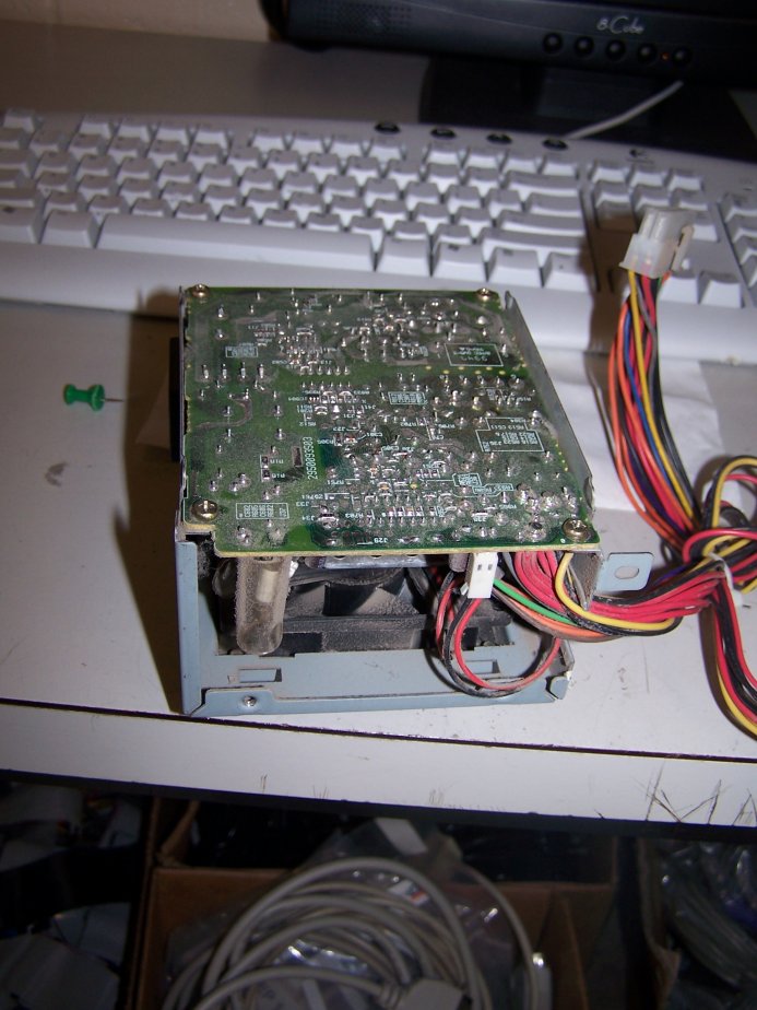

                            FSP460-60PFN
                            this is the one that went straight into the mailserver a while ago. since i am servicing that today we can take a look........and damn i should have bought more.
                            double decker? full range baby...!
