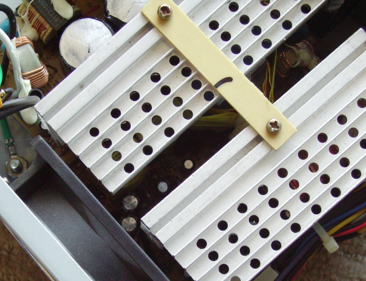

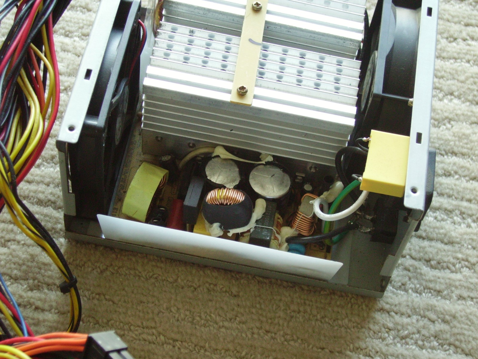

Well, I decided to open up my spare Antec TruePower 380W spare for kicks, and wouldn't you know it. Two bad Fuhjyyus! Right next to the fan, even. This came out of my Antec Sonata case that's at most two years old. The PSU has been out of the case for about a year.
I wouldn't even ask someone to recap the thing. Look at the mess of glue in there.
Re: Post your bad experiences with Antec power supplies here!
I should also mention (I can't edit a post more than once?) that the above PSU was used on a power conditioner for its first few months of life (Furman PL-Plus) and then moved to a UPS (APC Back-UPS ES 725) until it was replaced with an Antec NeoPower 480. I honestly don't know how the thing could have killed itself.
In retrospect, I have a 5 year old or so Sato (I think) LPD2-300WW that has one barely bulging 1000u 10v Jun Fu, and this PSU has been through hell with all the power fluctuations in this building and no protection.
