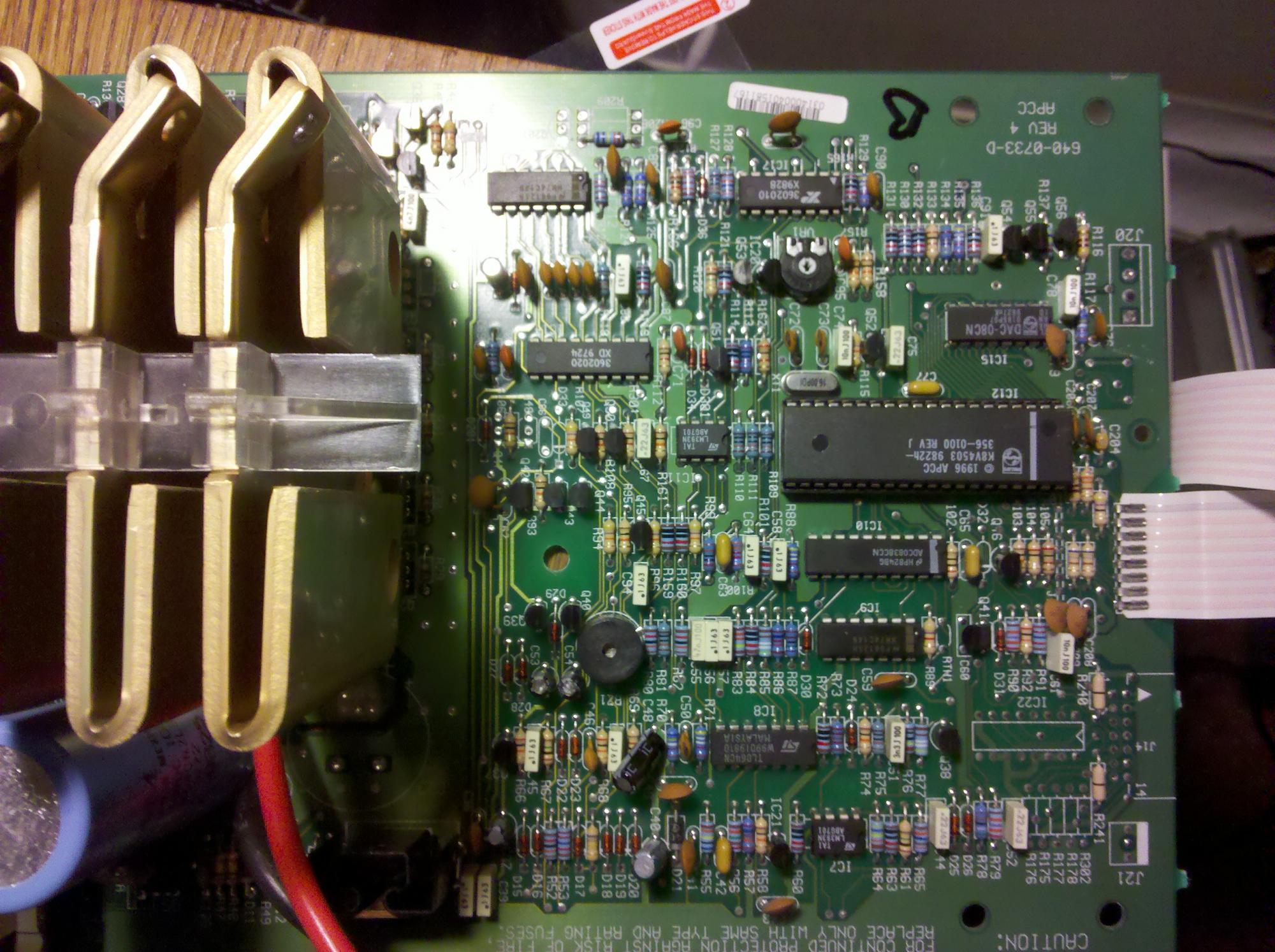

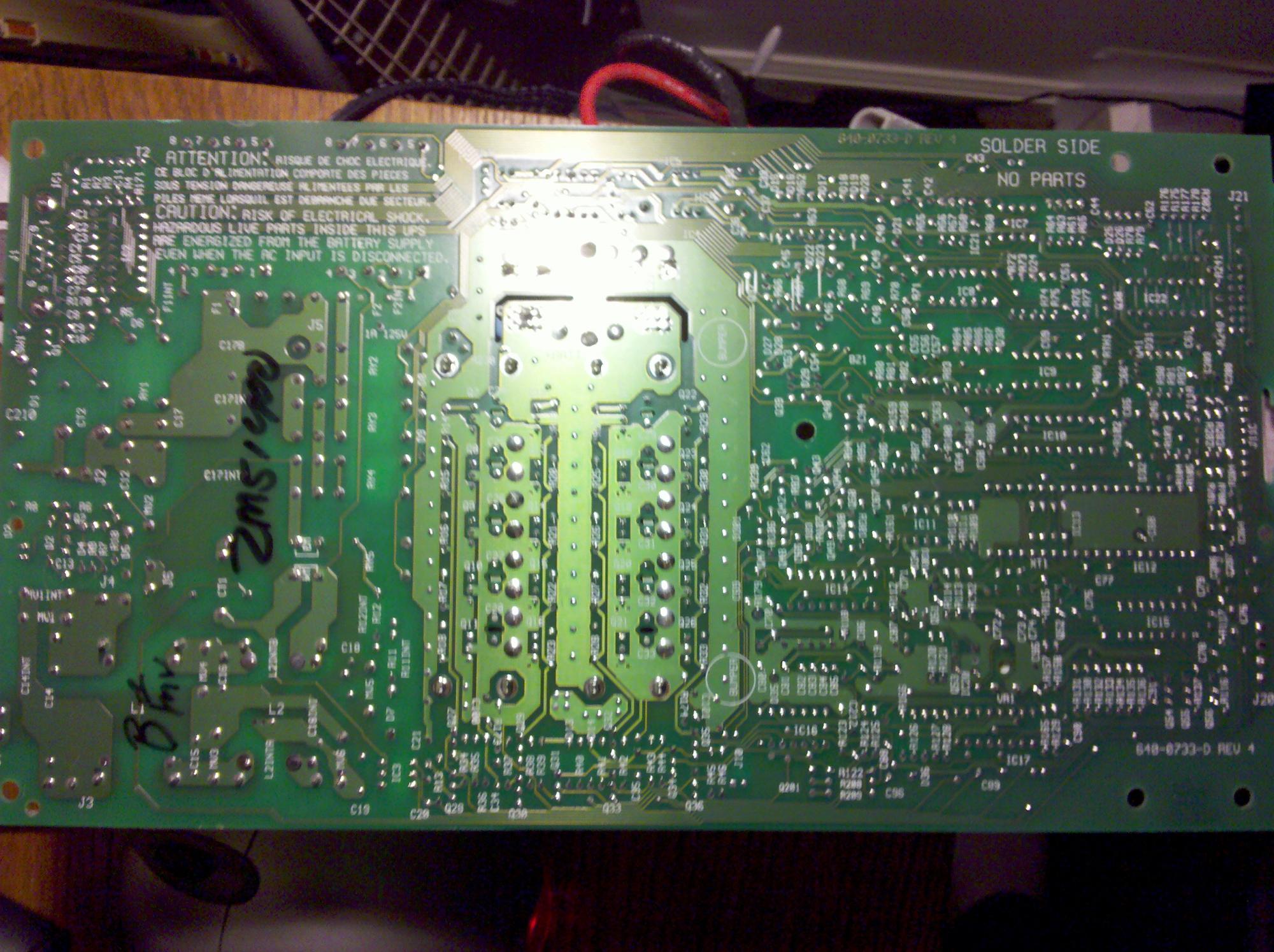

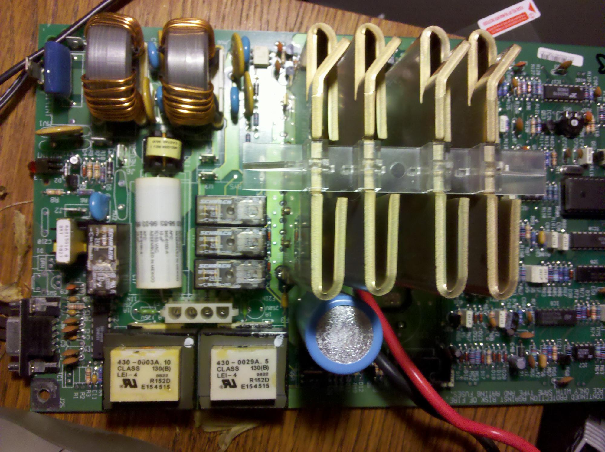

APC BackUPS Pro 1400
  • JarodTLG
    • Nov 2010
    • 5
    APC BackUPS Pro 1400
    I got this little unit from where my wife works for free, when I plug the unit in nothing happens. nothing at all. no voltage coming from the outlets on it, no voltage going to charge the battery.
    I found several small capacitors near the large chip that had been damaged by someone changing the battery from the looks of it, so I replaced them with caps that were the same value. this changed nothing.
    Am I missing something obvious? or is this beyond repair? I know how to solder/desolder, I'm not super good by any means but I repaired a 19" lcd monitor I got from the same place, had blown caps, replaced and it works great.
    I've attached some pics, I can take more if these aren't good enough or you'd like more detailed shots of certain components.
    Thanks!
  • seanc
    • Nov 2008
    • 1319
    Re: APC BackUPS Pro 1400
    Have you put a working battery in the unit? Some won't work without them.
    • Toasty
      • Jul 2007
      • 4171
      Re: APC BackUPS Pro 1400
      sean_c is correct. These -will not work- without a good battery.
      Don't mess with anything inside. There is -nothing- wrong with the unit. It's working as it was designed.
      Battery pack is RBC7. My source is:
      http://www.batterymart.com/p-12v-18a...ttery-2pk.html
      Good price and prompt shipment in 3 years of dealing with them.
      Shipping UPS Ground in 48 states is between $12 and $30.
      Toast
      veritas odium parit
      • kc8adu
        • Nov 2003
        • 8832
        • U.S.A!
        Re: APC BackUPS Pro 1400
        at least this is a decent one.the new ones are junk.
        here is what i would do with it.
        https://www.badcaps.net/forum/showth...hlight=apc+ups
        most apc units of that era are good for extended runtime with large external batteries.
        • Krankshaft
          • Jan 2007
          • 2328
          Re: APC BackUPS Pro 1400
          I wish they would at least flash the replace battery light if you attempt to start them with dead batteries.
          I think this failure mode is intentional to spur the sale of a new unit.
          Did you measure the voltage on the batteries? I believe at around 7-8 volts the unit won't even attempt to come on. Probably because the battery will draw too much current from the trickle charger.
          Last edited by Krankshaft; 12-01-2010, 10:47 AM.
          • JarodTLG
            • Nov 2010
            • 5
            Re: APC BackUPS Pro 1400
            You're all right, I don't have any batterys to try it with so I connected a pc power supplys 12v line to the battery and then to the board and everything else, plugged it in and got an obnoxiously loud beeeeeeeeep sound. So it is powering on but the power supply obviously will not put out enough power, I'll have to get a battery or something for it, probably end up doing like kc3adu suggested. I'll have to try it with a battery from my car or something
            Thanks guys
            • Krankshaft
              • Jan 2007
              • 2328
              Re: APC BackUPS Pro 1400
              Very bad move you made the battery charger in the UPS attempt to charge your PSU.
              A little knowledge is a dangerous thing. Hopefully you didn't blow any fuses or destroy anything.
              These units rarely ever die it's always dead batteries. Tests like this are unnecessary.
              This unit uses two 12V batteries in SERIES that's a 24V input. Batteries in series are the sum of the individual voltages.
              The only way you could supply voltage to the unit without a battery without risking damage would be to use some diodes to prevent the charger from attempting to charge your power supply. Then again as I said before you'd need 24V supply.
              As for a car battery that won't work unless you have two in series to get the 24 volts also expecting the tiny trickle charger in the UPS to charge a large car battery will just lead to it triggering it's over current protection, giving up if the battery doesn't charge quick enough, or if the charger has no OCP the larger battery could draw too much current in it's discharged state and the circuit could overheat and destroy itself.
              Properly sized batteries for the UPS are plentiful and relatively inexpensive on e-bay as long as you have the factory connection harness.
              If you're in doubt ask questions we are here to help.
              Last edited by Krankshaft; 12-04-2010, 05:04 PM.
              • ngml
                Repair of an LG split AC system indoor unit PCB
                by ngml
                I am trying to repair an LG split AC indoor unit, which does not start and gives a CH05 error code.
                This indicates an error in the communication between the outdoor and the indoor unit.
                The outdoor unit is fine, so the problem is the indoor PCB.
                The indoor unit is an LG PC09SQ NSJ (3SNM09JA2FA), and the PCB has the following type number: EAX35907219-1.2 (see photo1)
                I changed optocouplers ICO1X & ICO2X and the NPN transistor S9013 which drives optocoupler ICO2X (see photo2), but this did not remedy the fault.
                Does anybody have the schematics of this board,...
                02-01-2025, 12:55 PM
              • irepair559
                Ps4 1215a hdmi diode readings good everything good but no pic??
                by irepair559
                PS4 1215A HDMI DIODE READINGS GOOD EVERYTHING GOOD BUT NO PIC? everything is good! what else can it be? if hdmi diode values are good that means encoder and filters are good right? idk what else it can be guys...
                01-05-2023, 12:32 AM
              • carrzkiss
                Cyberpower cps1500avr not charging batteries
                by carrzkiss
                Hello, all.
                Cyberpower Battery Backup Unit.
                I bought two new ML18-12 batteries through Amazon (They have already refunded my money for the two batteries as we thought the batteries might have been bad.)
                When I got them in, they were not fully charged. I connected them to the UPS and waited 24 hours before connecting any networking equipment.
                In parallel, they read 24v, but within 24 hours, the meter on the front of the unit dropped from 4 to 3 bars on the battery charge indicator.
                Checking the voltage, it was down to 22v.
                I quickly removed everything...
                06-15-2024, 02:10 PM
              • DrDos
                Unit runs but no speaker output kenwood KR-6030
                by DrDos
                I have finished my work. The new lights come on except the one for stereo, I reversed the bulbs to no affect, anyway, the unit powers on, relay clicks. I have no DC voltage in speaker outputs, I also do not have any AC in the speaker outputs. There is some faint crackling in the speaker. This unit cranks up loud so I had the volume on very low. Everything seems to be fine but I can't really check the switch until I can get sound out of the outputs. I was going to do caps for the power supplys and the tone board but thought if it was cranking loud at one time maybe just leave it alone until it...
                09-14-2025, 09:57 PM
              • Mgiffune
                by Mgiffune
                06-09-2024, 10:28 AM
