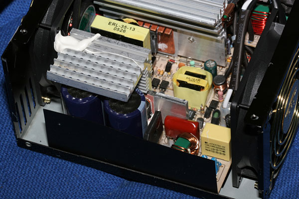

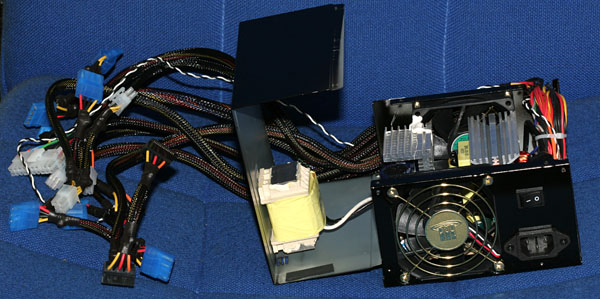

    Re: HEC Ace Power 480W
    shiny black paint is nice looking but easily damaged, together with gold fan grilles and cable mesh it makes what could have been a bland psu look good.

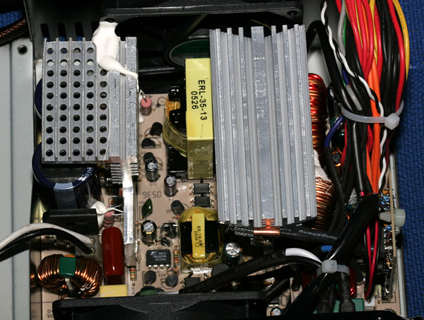

      heatsinks are cut to allow for passive PFC component. Two cooling fans are interesting. Heatsinks could be larger however

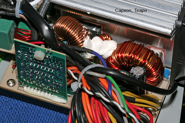

            CapXon and Teapo caps are used throughout. I would rate that as a good aspect compared to other current models with various terrible brands.
              Passive PFC required for European market

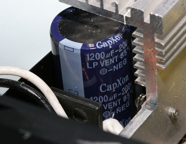

                • Greece
                1200uf is generous

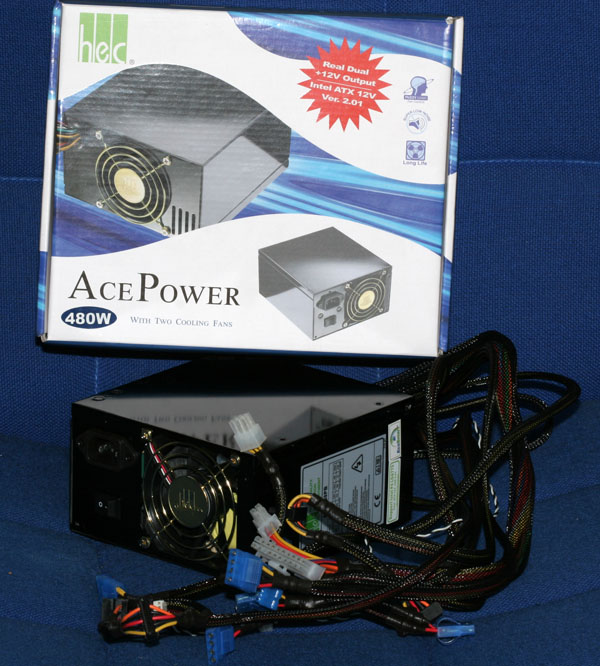

                  i think it is expensive for what it is.
                  http://www.extremeoverclocking.com/r...r_480UB_1.html
                  capxon caps and teapo are not too bad. interesting to see that they have their own brand fan. they used to be only OEM manufacturer but now have their own brand PSUs.
                        70 dollars for a quality 480w PSU is not too expensive -- less than Antec.
                        you are correct, it is priced according to the present market. the heatsinks are quite dissapointing though.
                        plus points are : nice cable mesh which is where you enter the premium category and price and of course the black finish which unfortunately is damaged very easily. then the dual fans which are the usual quiet types and typically not that powerful.
                        the 24pin atx connector is one of the new types. i was not familiar with them until recently. you detach a block which has the last 4 pins and then it becomes a 20pin connector. This is the same as the ISO PSU which i showed previously. this is very nice for older boards because the usual bulky 24pin-20pin converter makes it practically impossible to tidy the power cable nice using cable ties against the case.
                        you know the usual sticker that you break and void your warranty. well this one had not only that but it had 2 quality control stickers covering screws also.
                        i dont agree with the sticker policy. it is not on all psus. i recall my zalman which didnt have that, so after checking it out inside i was able to rma after some component detached inside a year later. anyway since this one is for me its gonna get recapped anyway so no rma. the heatsink design and lack of too much glue means it will be an easy job.
                          The two 1200uF 200V caps seem like a decent size for this wattage, and the heatsinks aren't too bad for 480W. What are the ratings on the rectifiers? (My L&C supply I scrapped had undersized output rectifiers ).
                          Watch out for glossy paint and cable wraps on power supplies - they can mislead you into thinking it is a higher quality product .

                            2x 1200uF 200V is pretty big capacitance. My 2x Sparkle 250W each had 2x 470uF 200V IIRC.

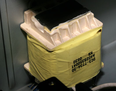

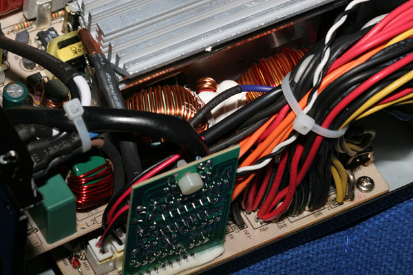

                              The secondary capacitors aren't very large or numerous. The primary caps are generous, the secondary inductors are good-sized, the main transformer is a little small. My estimate - rating is slightly over-specified, it's probably 300-400W.
                              The build quality is excellent - it's a good starting point for recapping into a very reliable, long-life server-grade PSU.
