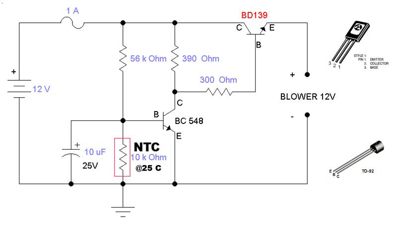

                Also: can i just stick a thermistor in series with the fan connector? Or will that not work right?

                  You'll need a little transistor circuit to "read" the thermistor afaik. Those little thermistors aren't designed to have too much current flowing thru them. But if you got extras try it anyway, if it goes up in smoke you'll know it was too small.

                    Some cheap psu makers do that. As a result the thermistor is hotter than the heatsink itself!

                      i only have two so thats a no-no. i can kust rip the temp control circuitry out of an old antec

                        Yup, you could scavenge one from another PSU, or you could make one of these: http://www.heatsink-guide.com/control.gif

                          but i dont have those parts...i want to use 100% free salvaged parts . this is a Learing experience not a Spend money experience

                            can i just put a resistor ino the fan circuit? no temp control, itll just slow the fan. and i found some filter components out of a 124w delta psu...

                                    Here is another fan control circuit:
                                    And here is something that just regulates the voltage into some value lower than the original (maybe one could put a thermistor in series with the fixed resistor?)

                                      the second one looks easy. but isnt that the same as simply putting a resistor in series wit the fan?
                                        In this case, yes.
