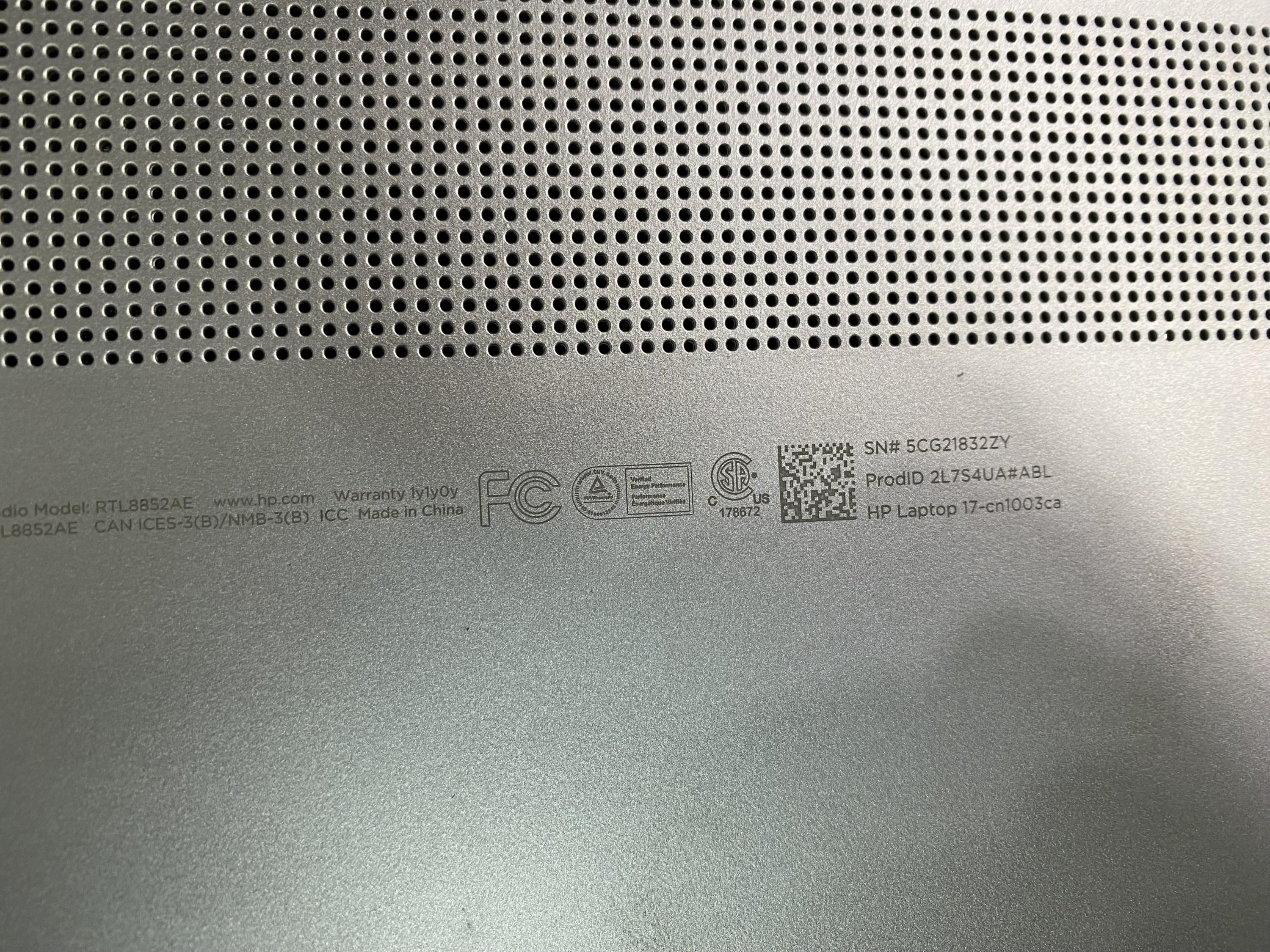

          Re: Bin Files rebuild for HP Pavilion 17-cn1003ca
          Originally posted by mferna14
          Hi, I am working on a hp 17-cn1003ca laptop., board # VLAD10-6050A3261101-MB-A01(A1).This laptop had gone to another repair shop & for no reason at all they just removed the BIOS chip (Chip missing). Checked the photo with identical board & no BIOS chip on mine & missing chip on these tracks. I downloaded the BIOS files from the Hp site for this model. The Model # is 17-cn1003ca & Serial # 5CG21832ZY. Can someone rebuild the Bin file for this Model & S.No. I have uploaded both, the 8MB & 16MB bin files, I think 16MB is required for this motherboard. Thanks in advance.
          Are you sure thats the right serial number and model.
          • mferna14
            • Jun 2018
            • 1048
            Yes, it's embossed on the bottom cover. It's very clear printing & 100% the same as mentioned in the post # 1 by me. Thanks
                Post a picture please
                • mferna14
                  • Jun 2018
                  • 1048
                  As per your request @SMDFlea, here you go the original photo of the model & serial # of the Hp laptop. Thanks
                    • 22191
