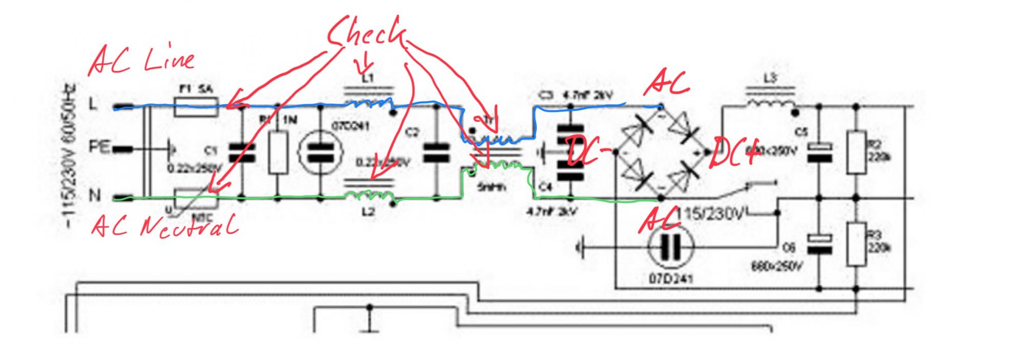

      The AC part of the power supply is simple. I marked up a generic schematic for you. If you do find an open filter inductor, unwind one turn and resolder it to the leg. You need to get full AC power mains to the bridge rectifier. Other than that there is no DC from the bridge rectifier into the main filter capacitor.

            Maybe cable or wall socket is defective, try another to replace. From mains to bridge rectifier must be continuity on both wires, that is marked blue and green on Capleaker photo. There is no need to test this under voltage, just use continuity mode to confirm connections between checkpoint.
            And one tip: when you do a measurement to inform us, put readings what you actualy have, rather one that you do not have.

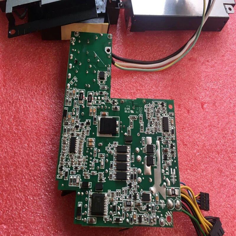

                Re: Liteon pa-3271-06mx help!!!!
                Something like this

                      Thanks to harp and the other people for the help BUT specially harp because he had a picture of a power supply and i noticed that i replaced 2 parts in a wrong place RV001 and HS3 green part varistor and black part near main capacitor.
                      i switched them according to harp schematic and now i do have 320vdc on main
                      capacitor.
