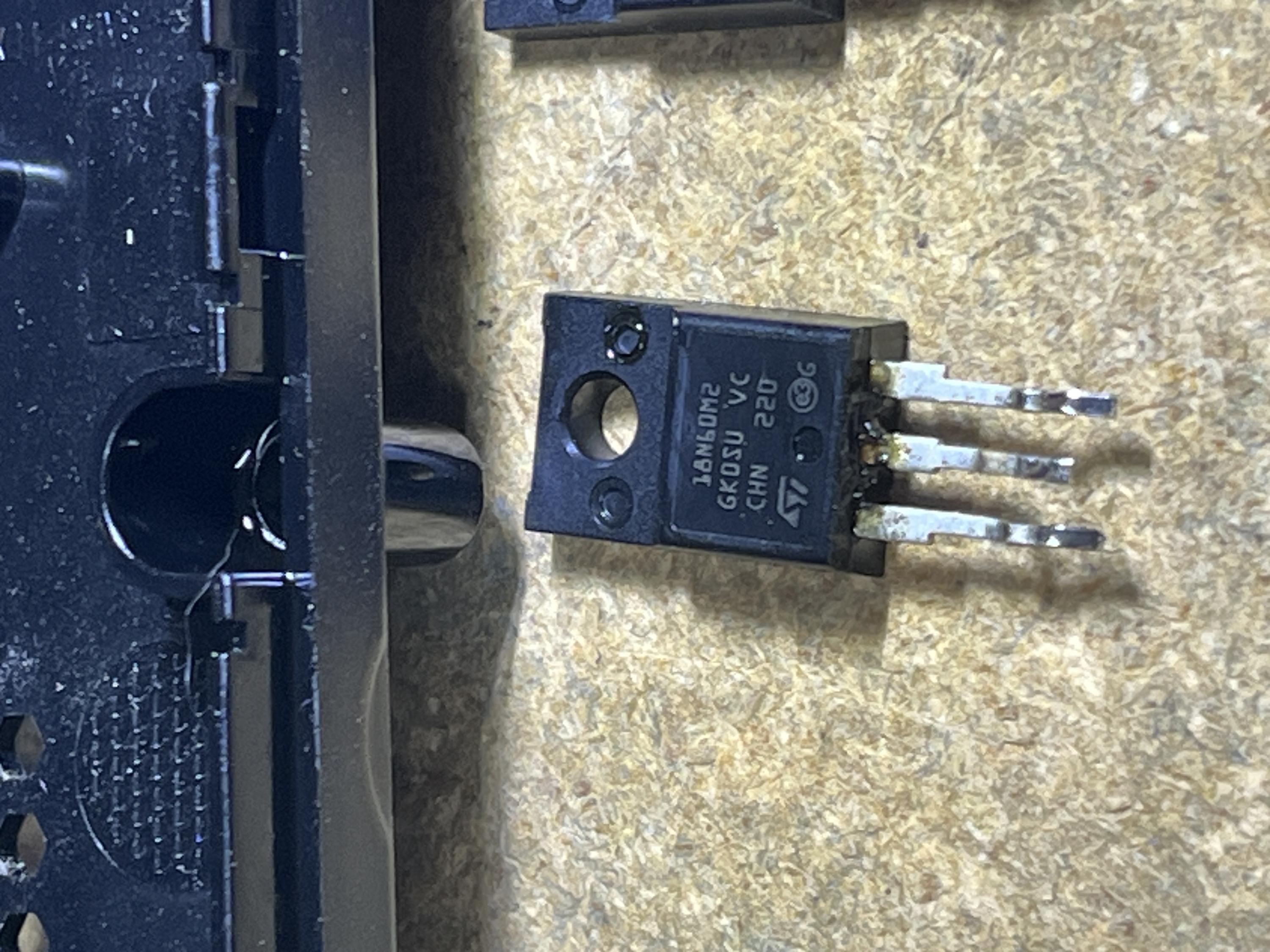

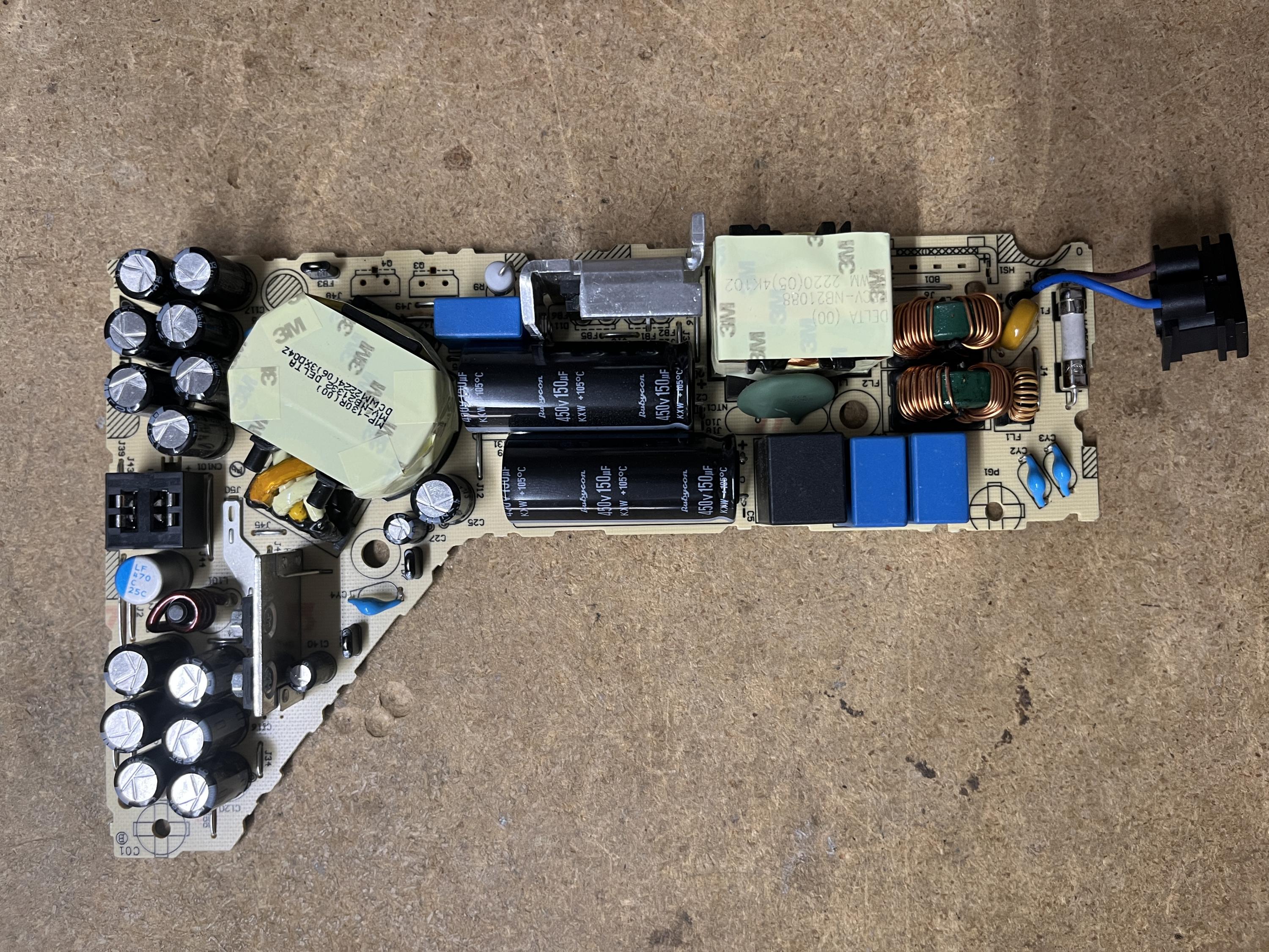

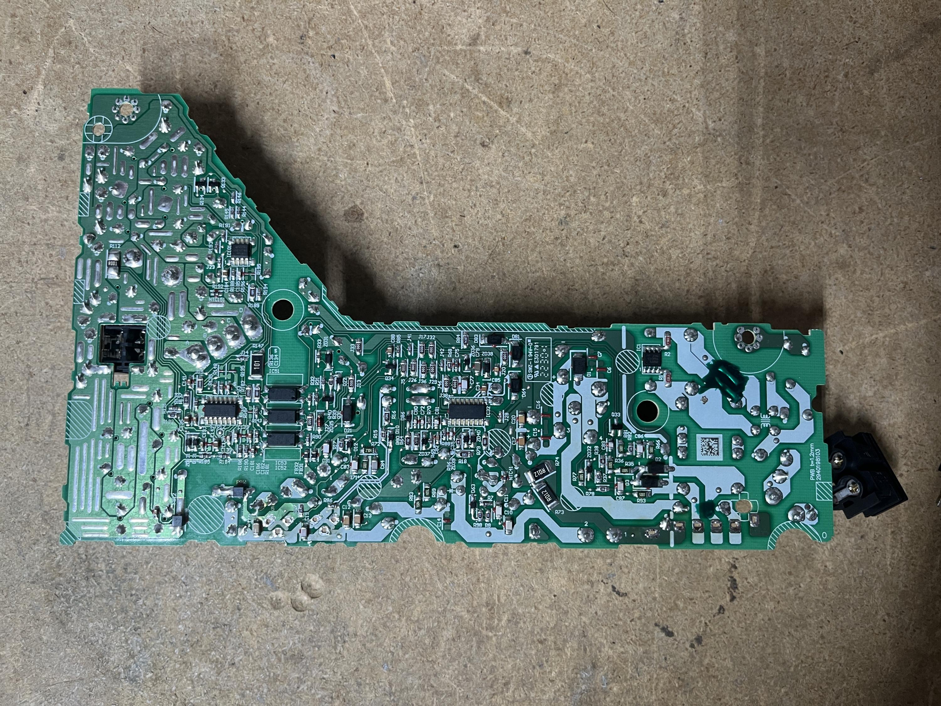

    Friend brought me his PS5. Says the outlet killed it and his PC. Upon opening there was no voltage coming out of PSU. Took it apart and could see 2 traces were destroyed. I fixed it with some thin copper.

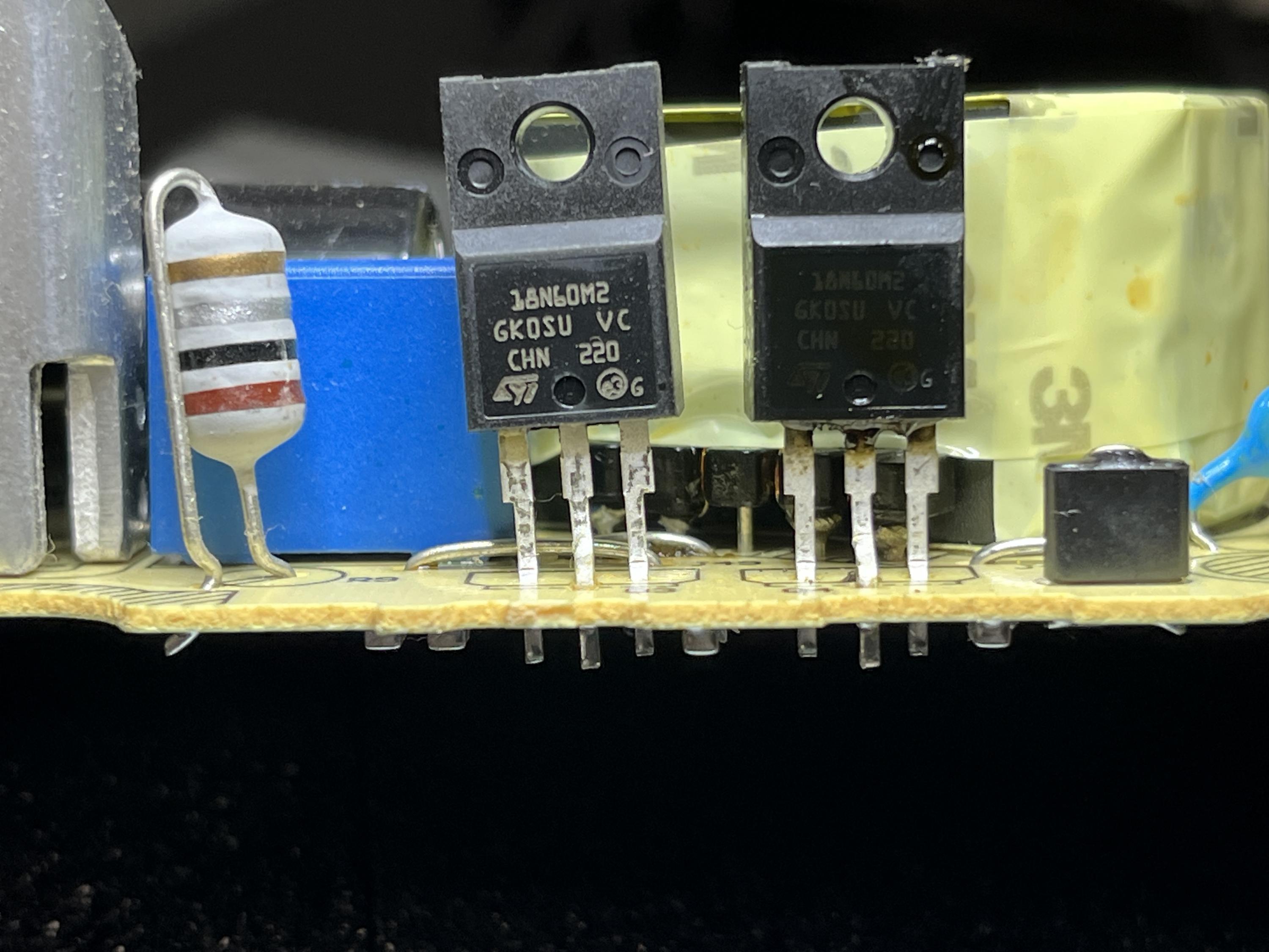

    The rectifier bridge is bad, j48 and j49 were shorted, R9 is open. There are 3 other transistors and 1 diode that checked ok. Black on drain, red on source, 0.4v. Red on drain, black on source, 0.0v. OL between gate/source.
    You can see in the pic with the 18N60M2 fet it has some gunk on the pins and you can kinda see some liquid in the screw hole on the PSU shell. Not sure where it all came from but its all along the inside of the shell. The fet was covered in the liquid when I opened the PSU.
    Is it fine to use the GBU 1510 in place of the GBU 1508A?
    Any suggestions on what other components I should check to see if they shorted those fets? What wattage does R9 look like? 5W? The body is about the same size as a bic pen.

    You can always put a "better" diode in with a higher rating. A GBU1510 is 1000V rated vs the GBU1508 800V rating. All other ratings on the full bridge rectifier stayed the same, no problems there. If any of the fets are shorted to the gate, the whole gate drive circuit becomes automatically suspect. That is because the gate drive including the PWM just got dumped full bore voltage from the main filter caps dumped on.
    R9 looks like 2w ought to do with eaz. I don't think you get a 5w in. You can take a size measurement and then determent the wattage rating of the resistor.
    I suggest you build yourself a incandescent "light bulb in series trick", repair all you know what you know is wrong with the PSU, then use that incandescent light bulb tick and fire the PSU up. IF the gate drive (PWM) would be stuck on, the light bulb limits the current to the PS5 and just lights up bright as it can be.
