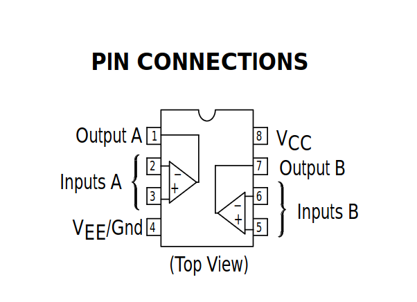

                            The way the welder is designed is that 'after' the pwm controller, the two controller outputs go through what appears to be some kind of amplifying board (there is a mosfet on each channel) before the two yellow wires supply the IGBT section.
                            Disconnecting this board (and all the output circuitry) didn't resolve the pwm controller output issues, so I had a look at the IC next to the controller.
                            It is an LM358 twin Op-Amp and taking pin voltage readings appear to show that something is not quite right.
                            The pin layout is included below and the pin DC voltages are as follows:
                            1 - 14.7
                            2 - 0.17
                            3 - 10.54
                            4 - 0.041
                            5 - 0.04
                            6 - 0.017
                            7 - 0.083
                            8 - 15.8
                            I'm not quite sure where the Op Amp fits in with the PWM controller and it's too late here to start tracing it back but I'm not giving up just yet

                                    #37
                                    Re: Inverter Welder Strangeness
                                    Ok. My 8 weeks break is up and I'm ready to have another look at this machine.
                                    I've just changed the LM358 and now we actually have even and equal output frequencies on the PWM chip, so woo-fuckin-hoo to that one! About bloody time...
                                    So, now that the pwm circuit seems fine, I think that two new filter caps is in order, so I'll order them and get back to you here.

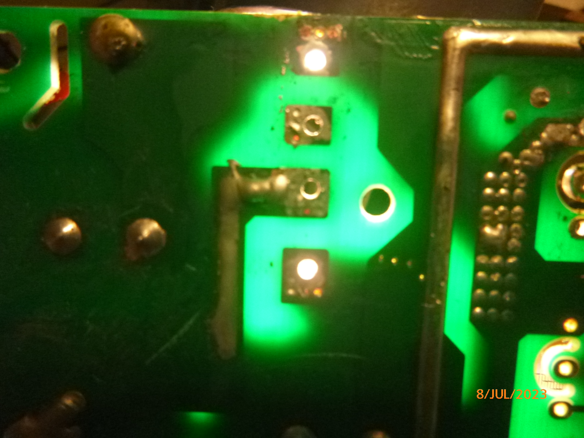

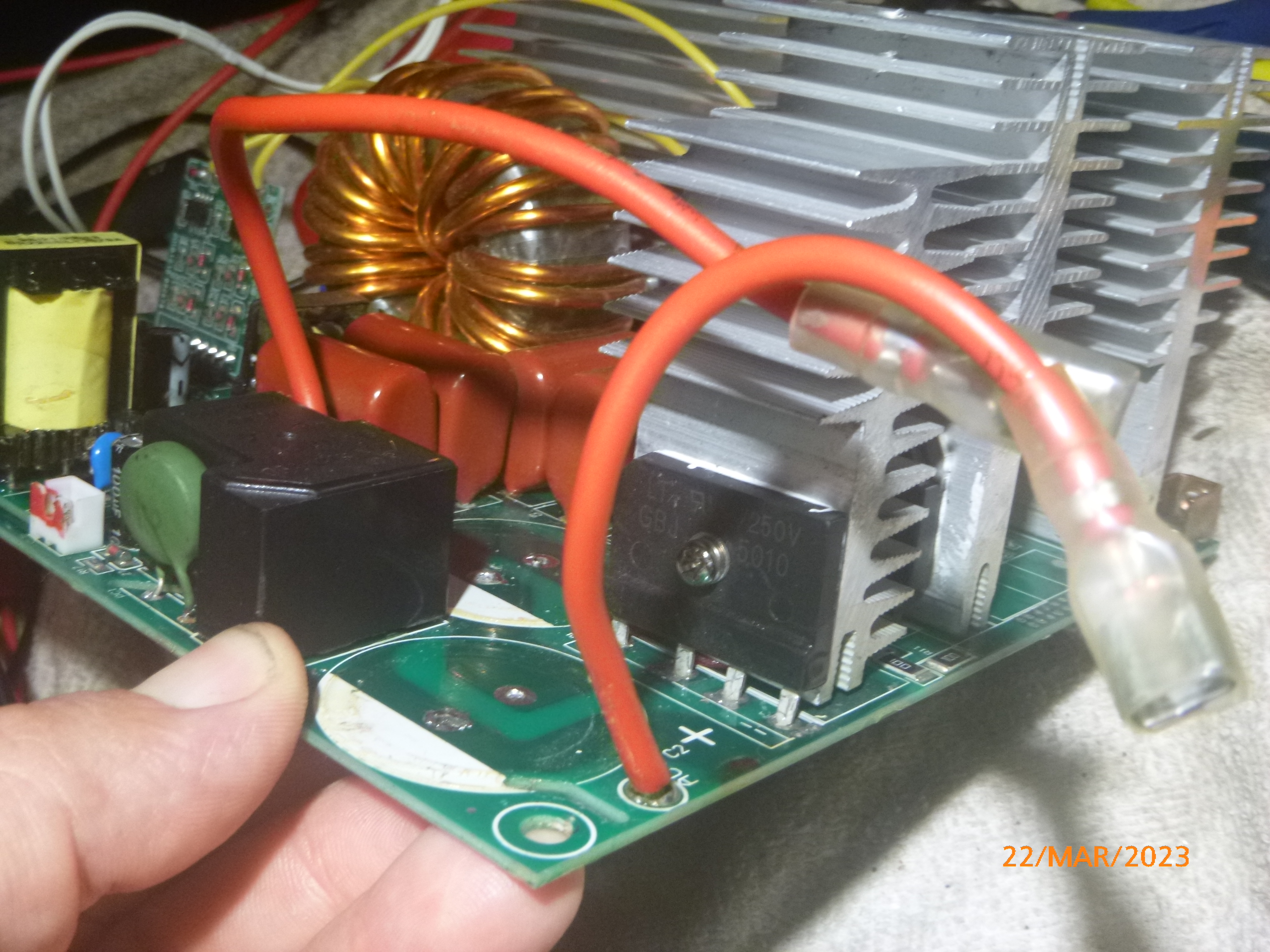

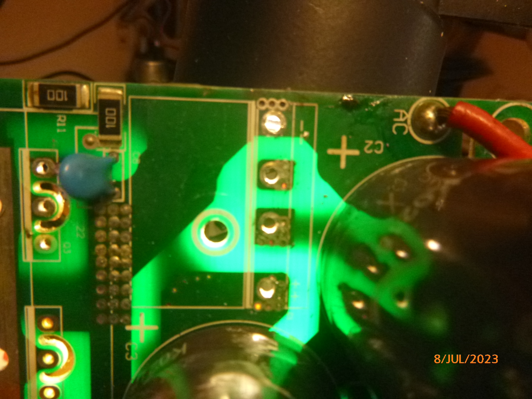

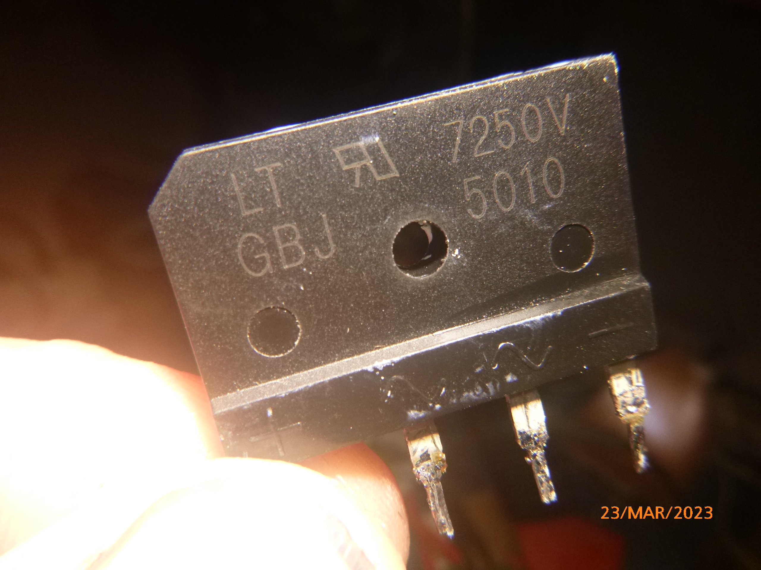

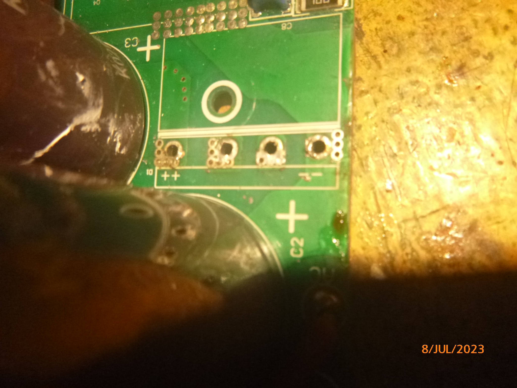

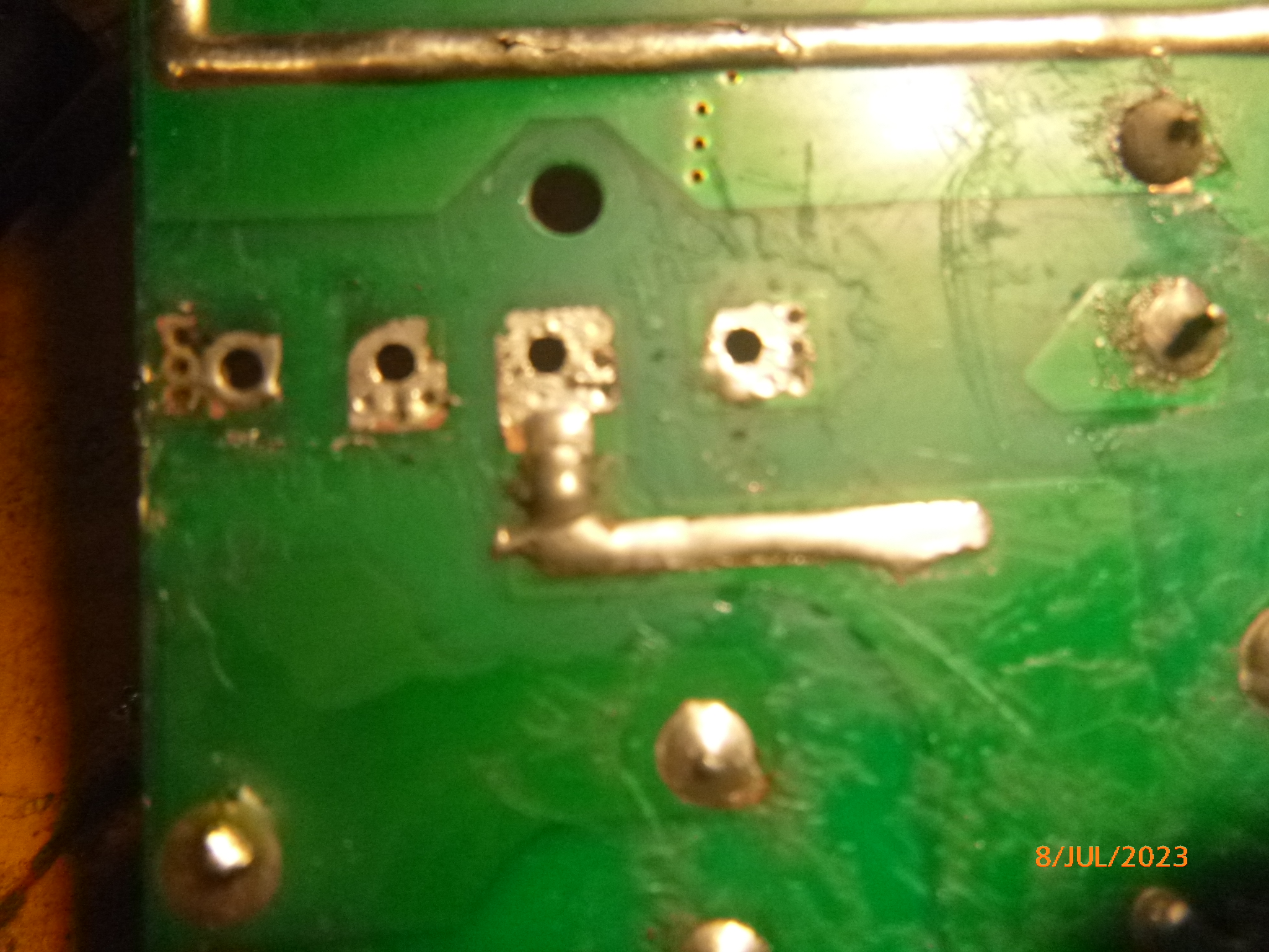

                                        There is no broken wire or trace going to the rectifier, as I said, the unit appeared brand new when I bought it, and it powers up and seemingly works with this peculiar configuration.
                                        Below are some photos showing the space where the bridge rectifier goes.
                                        It is a GBJ 5010
                                        If you focus on the second hole from the board edge, it can be seen that there is no trace connecting to it on either side...
                                        So how then, with or without LSD, can the current be rectified in this manner?

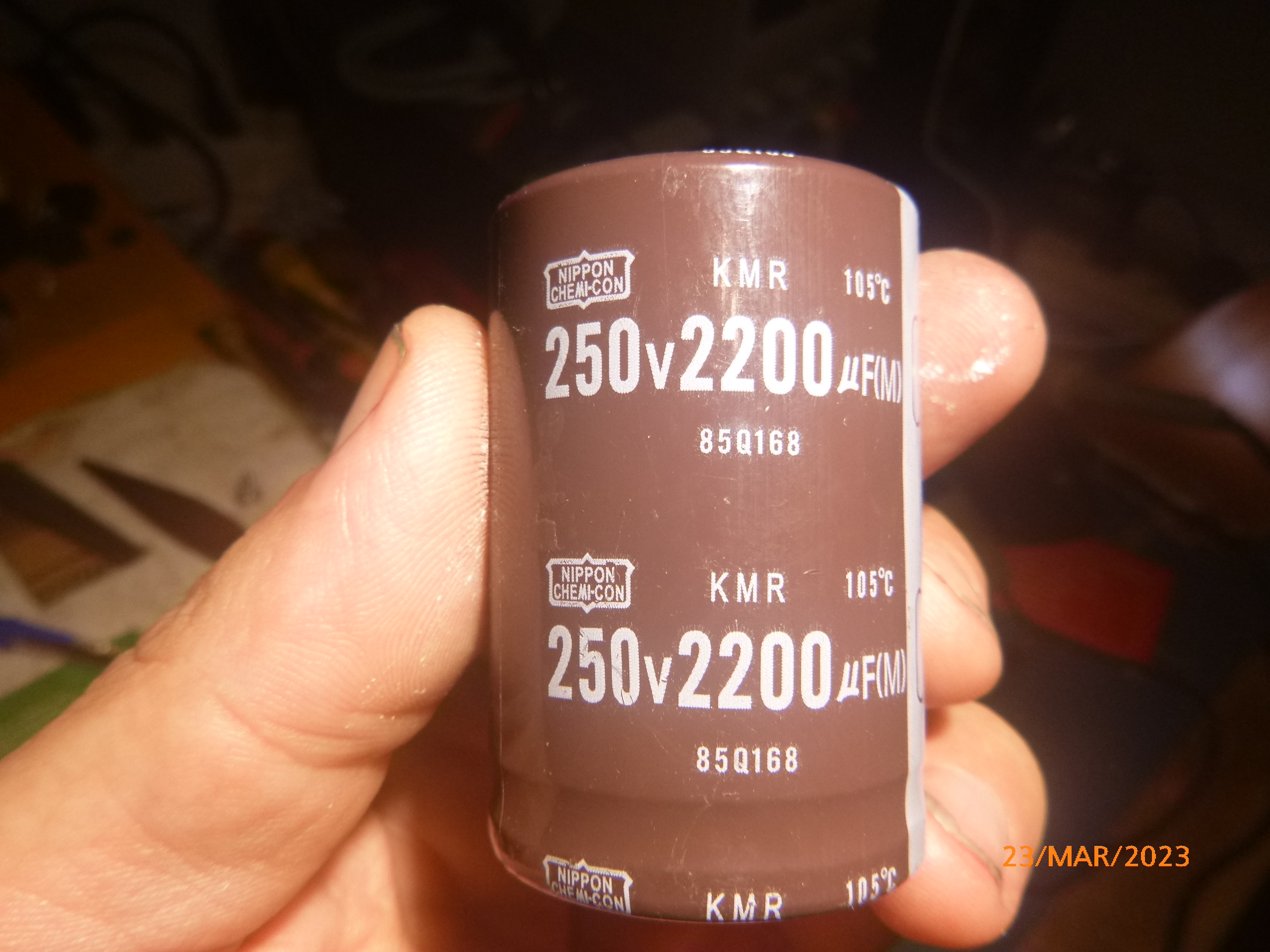

                                          The welder has 127 volts AC on it's input. The output of the rectifier is a steady 305 VDC - which seems absurdly high!
                                          Measuring across the two input AC pins on the rectifier, gives around 30v. Which I suppose is what happens when you only connect one wire of the AC mains. ????
                                          Looking at these readings however, has revealed that with the main 2200uF caps being rated at 250v... (on a 305v supply).. That the original problem surely has something to do with the caps being underrated, (or perhaps more accurately, 'over-loaded').
                                          Good thing I hadn't ordered the new filter caps yet...
