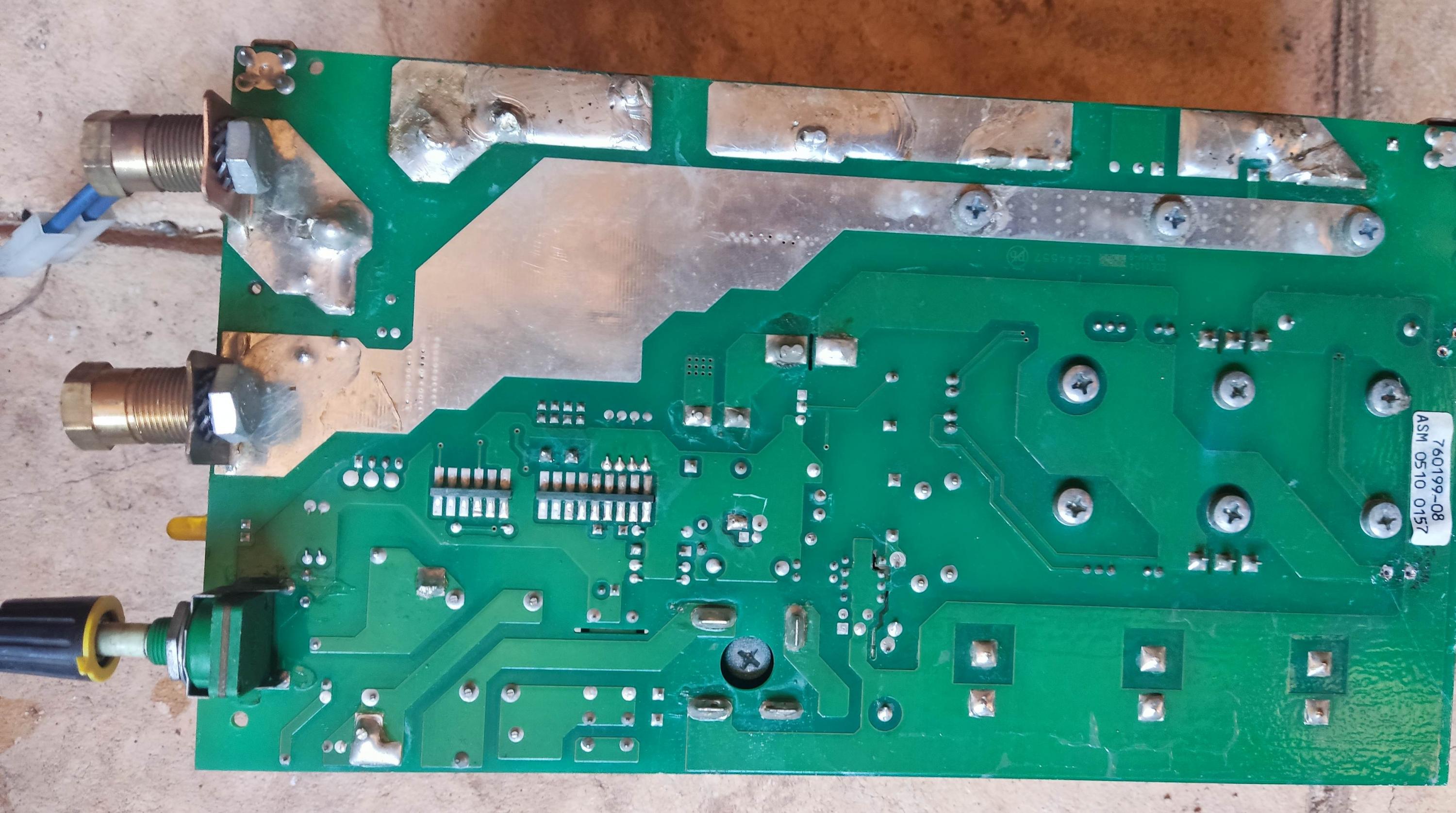

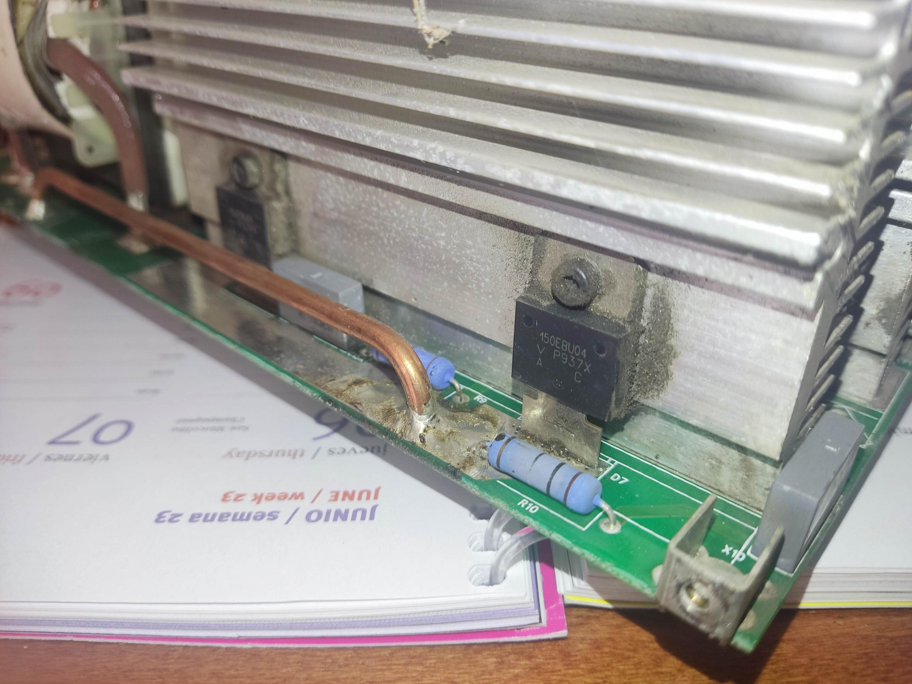

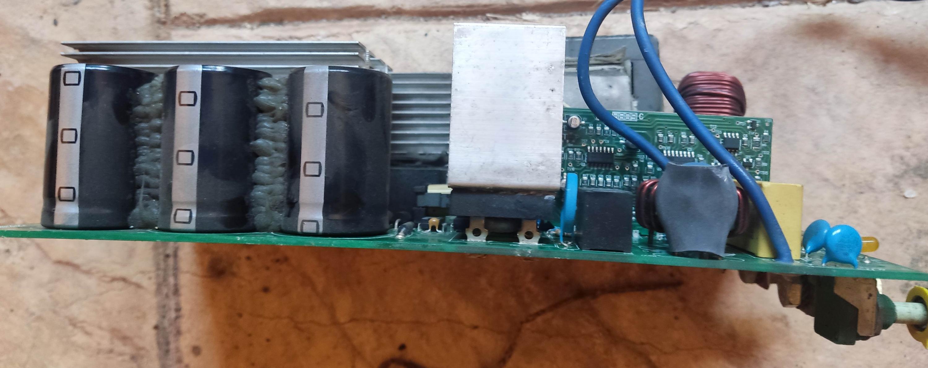

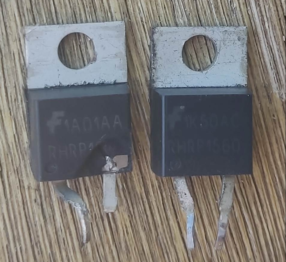

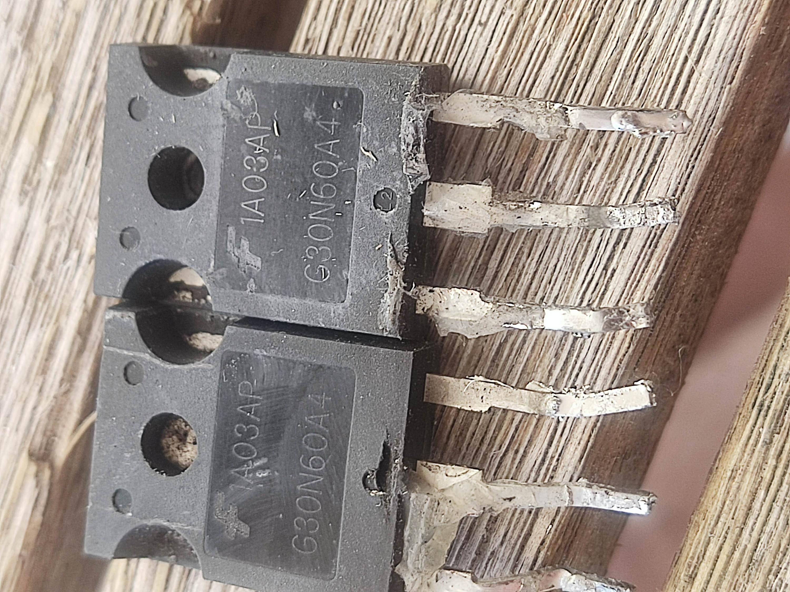

    Hi! I got this (see pics) welder which wouldn't work at all at the welding leads. I tested output voltage and got 0v
    Opened it and found a diode that was busted (missing resin...). Ref RHRP1560.
    I believe this diode protects one of the IGBT's that drive the transformer
    His twin diode wasn't physically damaged but measured OL on both polarities so both will be replaced
    Now, after watching some videos on welder repairs, it seems that the IGBT's usually fail together with the diodes, is this true? I tested IGBT with multimeter-diode mode, still on board, and got OL on all pin combination, both polarities.
    Should I go ahead and swap IGBT+Diodes?
    Thanks!
    PS: Rest of electronics "could" be ok, at least I checked +12v at the largest electrolytic in the control electronics area...

        Some more photos will help, but without more details, I can tell you for nothing that 12v on 400v main filter caps is way too low (at least if the caps are in a standard configuration).
        You first need to confirm that your 220v AC mains is getting rectified to DC, then you need to confirm that there is also your low DC voltage to power the chips, this is likely via an LM7805 (although I can't see one in the photos).
        Check the IGBT's for shorts and if shorted then replace them. I wouldn't change things just because you can, but you do need to verify that second RHRP1560 diode.

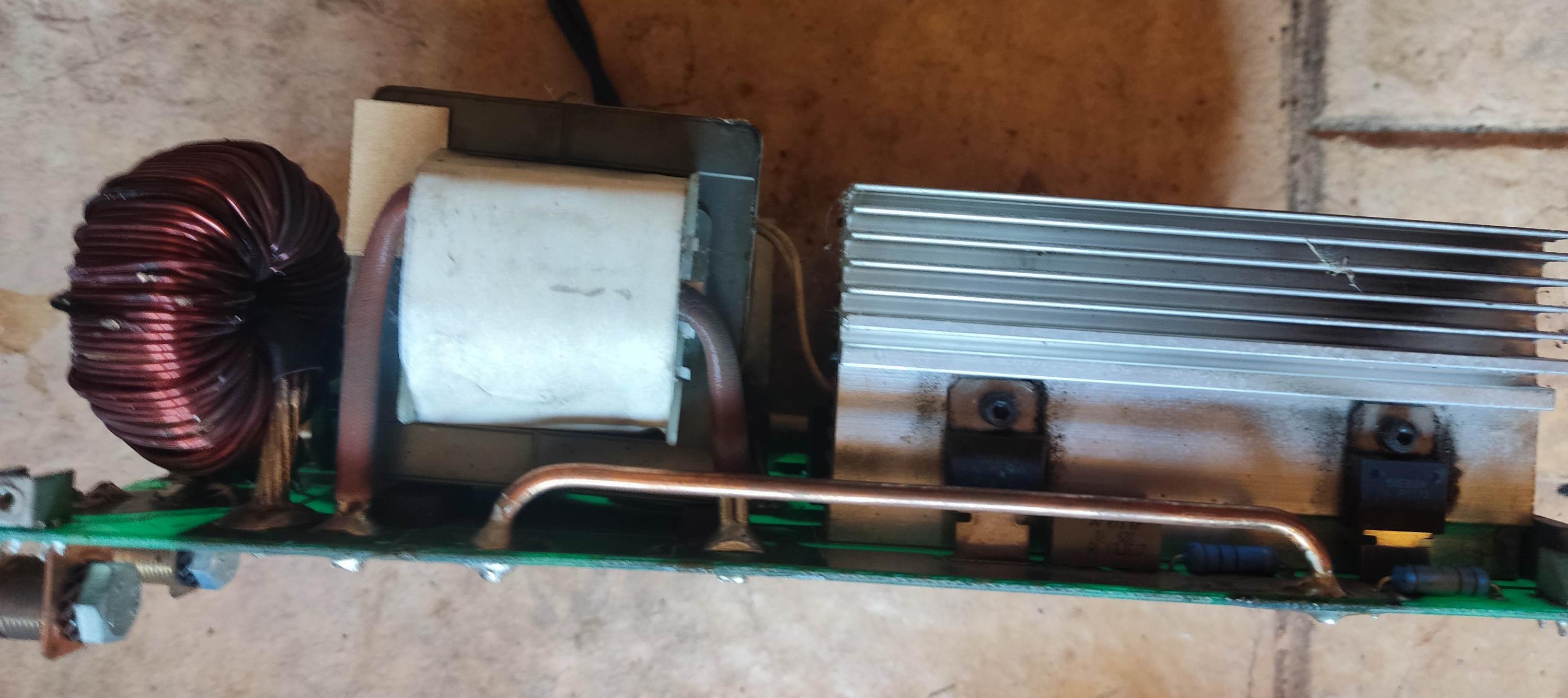

        Your vertical doughnut inductor is also burnt and has a loose wire.

          Thanks a lot for your reply. Before I go ahead and do some of the tests you mentioned, just some points:
          1.-The 12V I was refering was not the one after the rectified AC bridge, that one has the right voltgage (>300v); i meant the smaller capacitor near the electronics which is probably after a volt regulator (7812 expected but I didn't check)
          One of the recitifiers was physically blown as in pictures and the second onewas shorted (DMM tested)
          I realized the output inductor has one burnt wire but it still has 100% continuity (with reduced max current theorically) as this is a single coil with 10-15 wires going all together in parallel. If I get all this back to work I will try to solder that loose wire

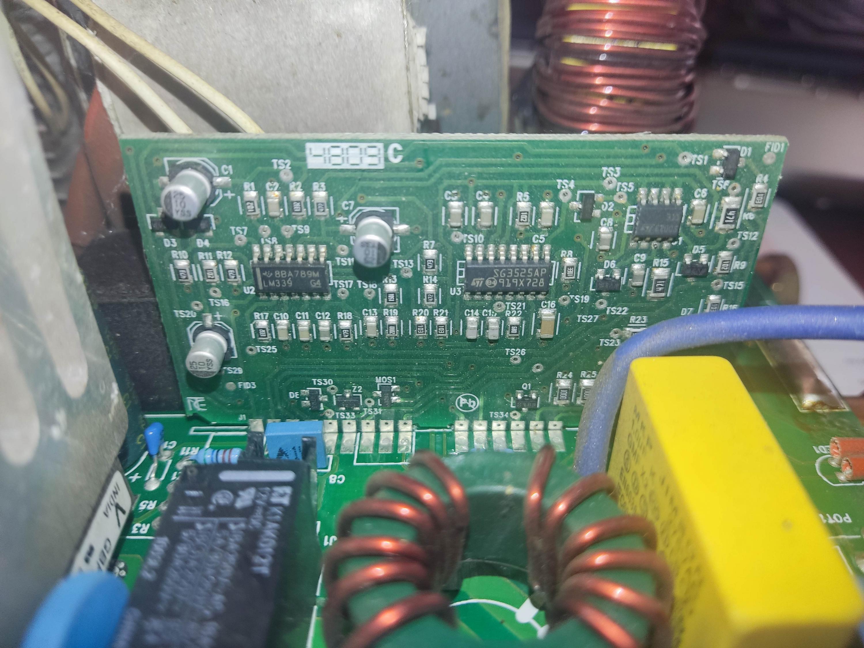

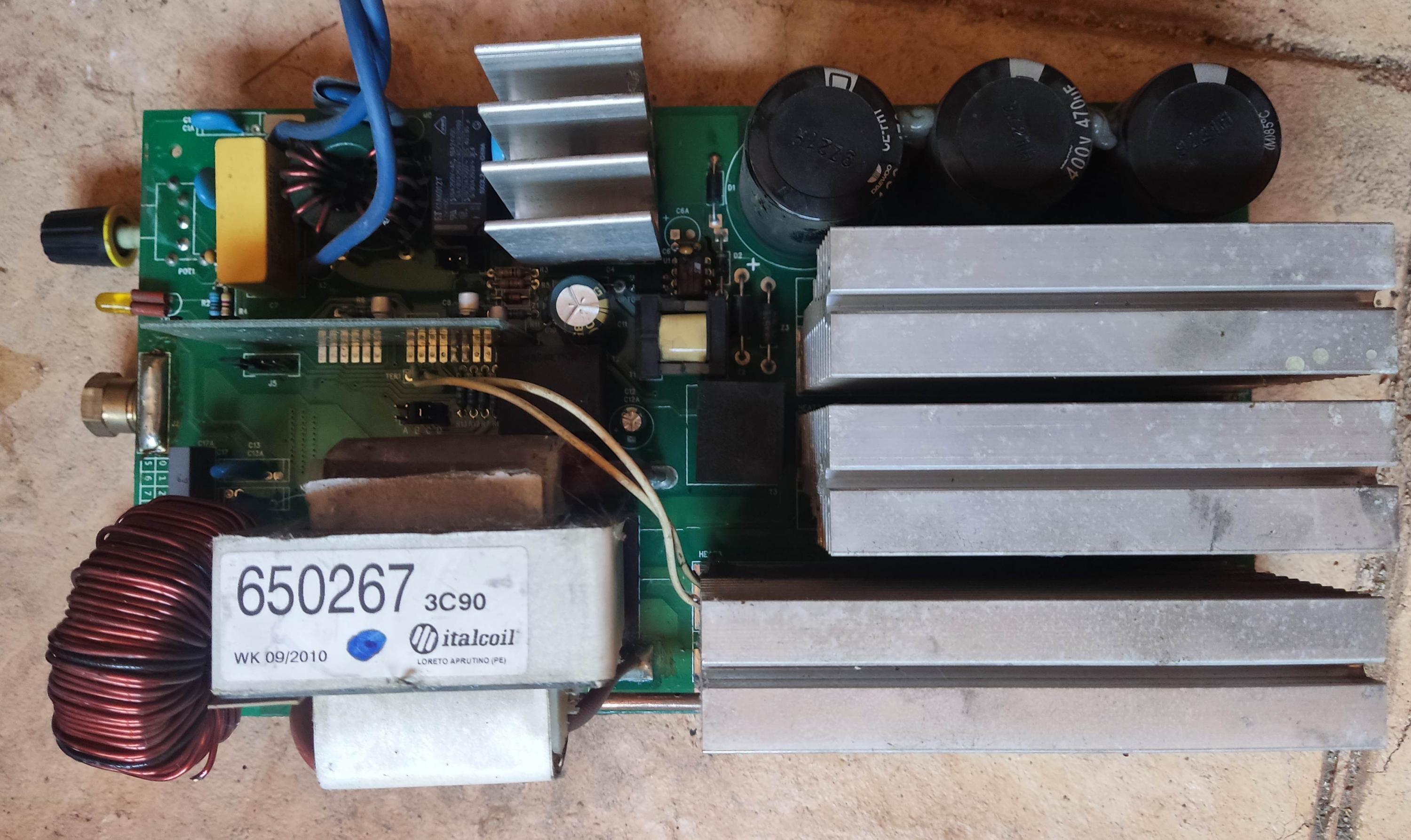

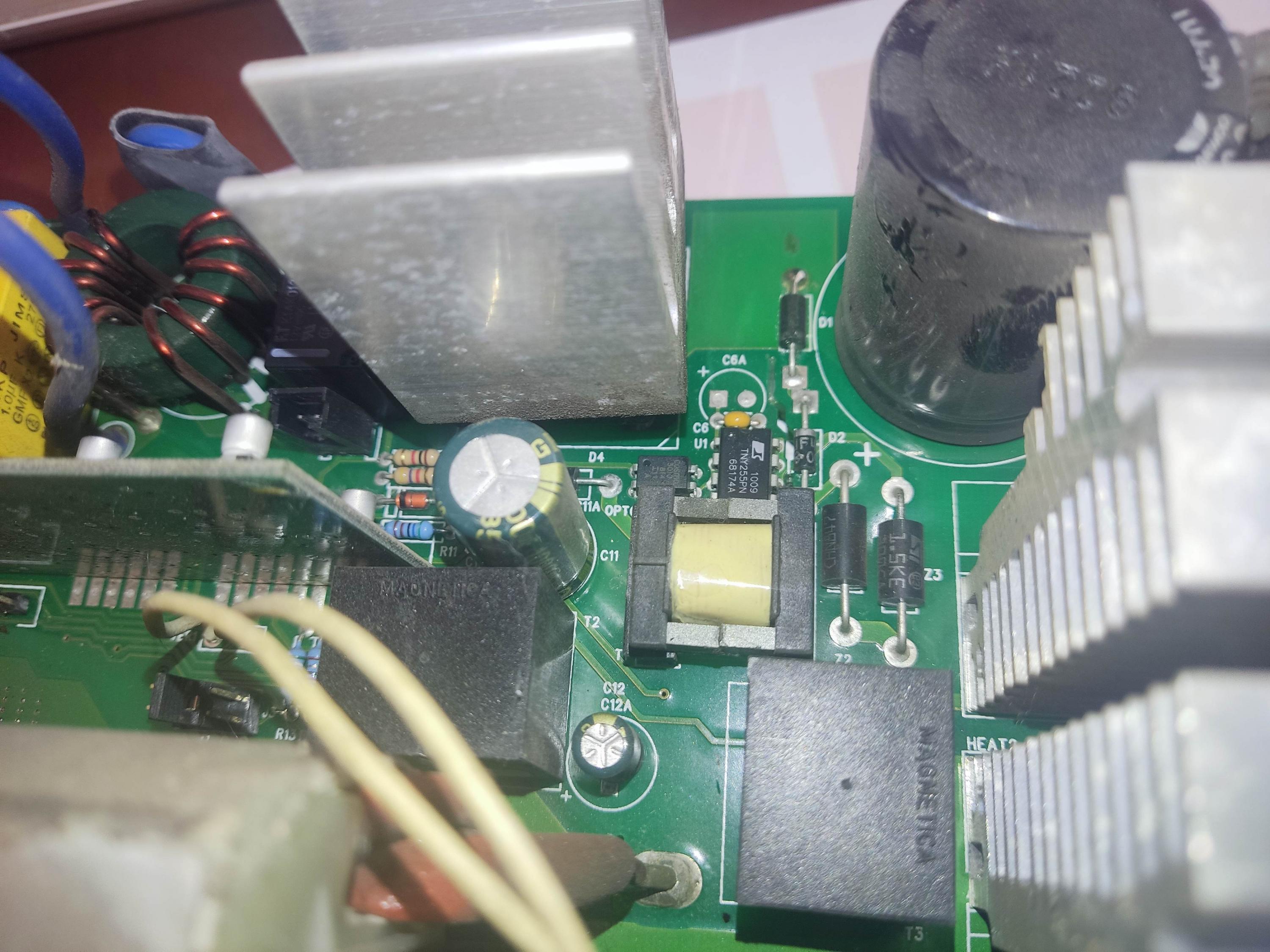

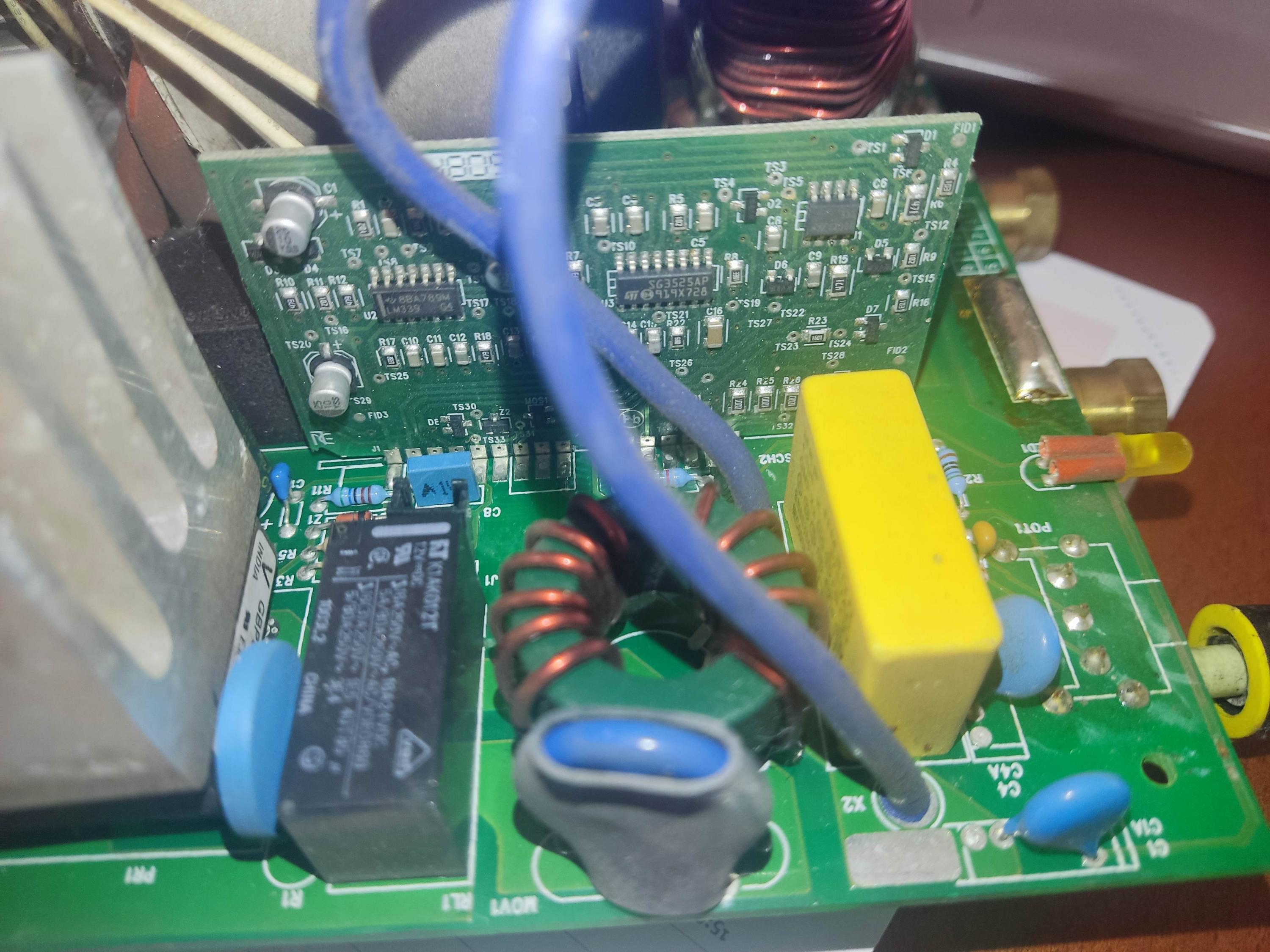

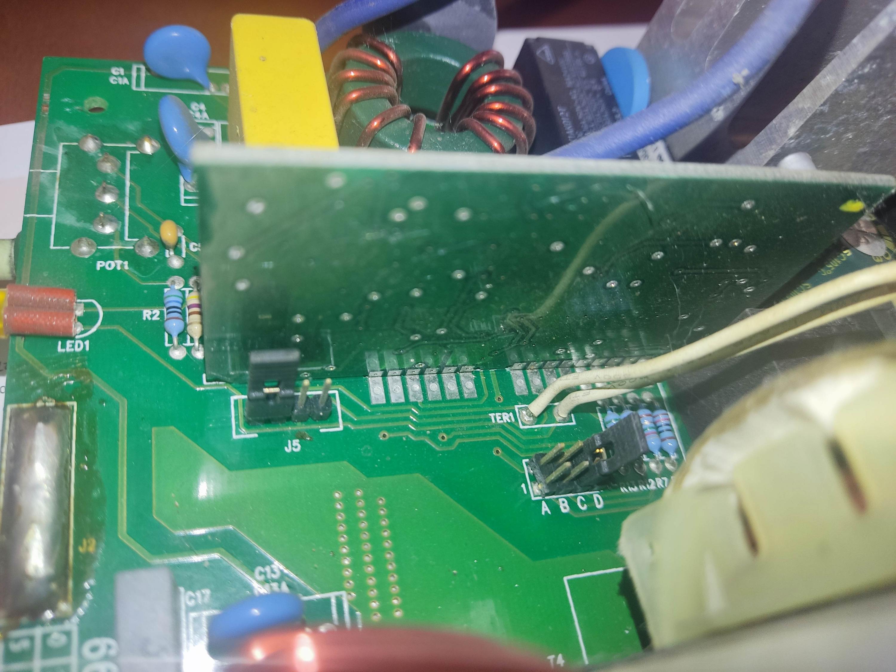

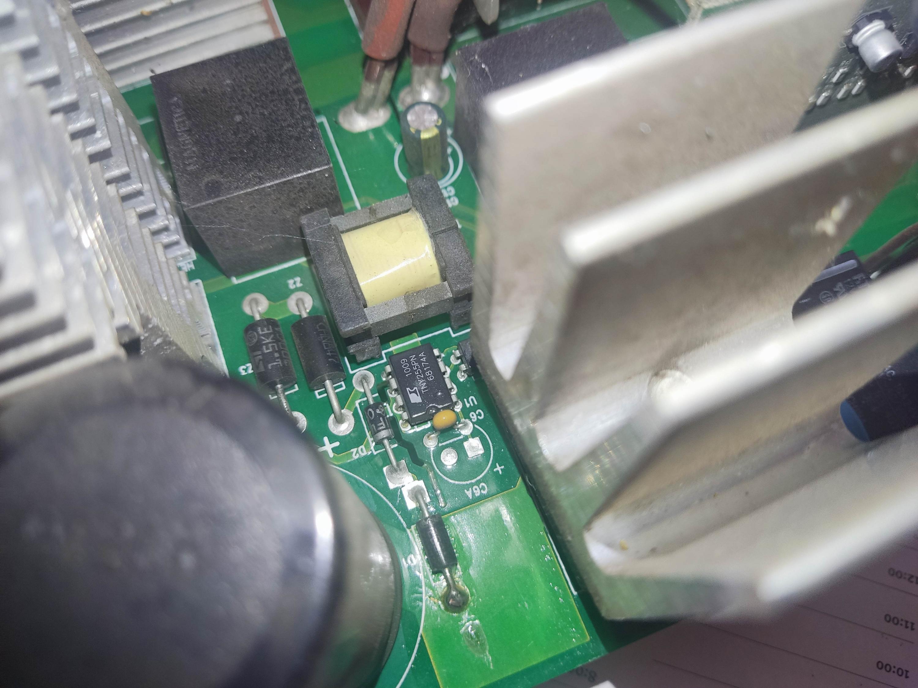

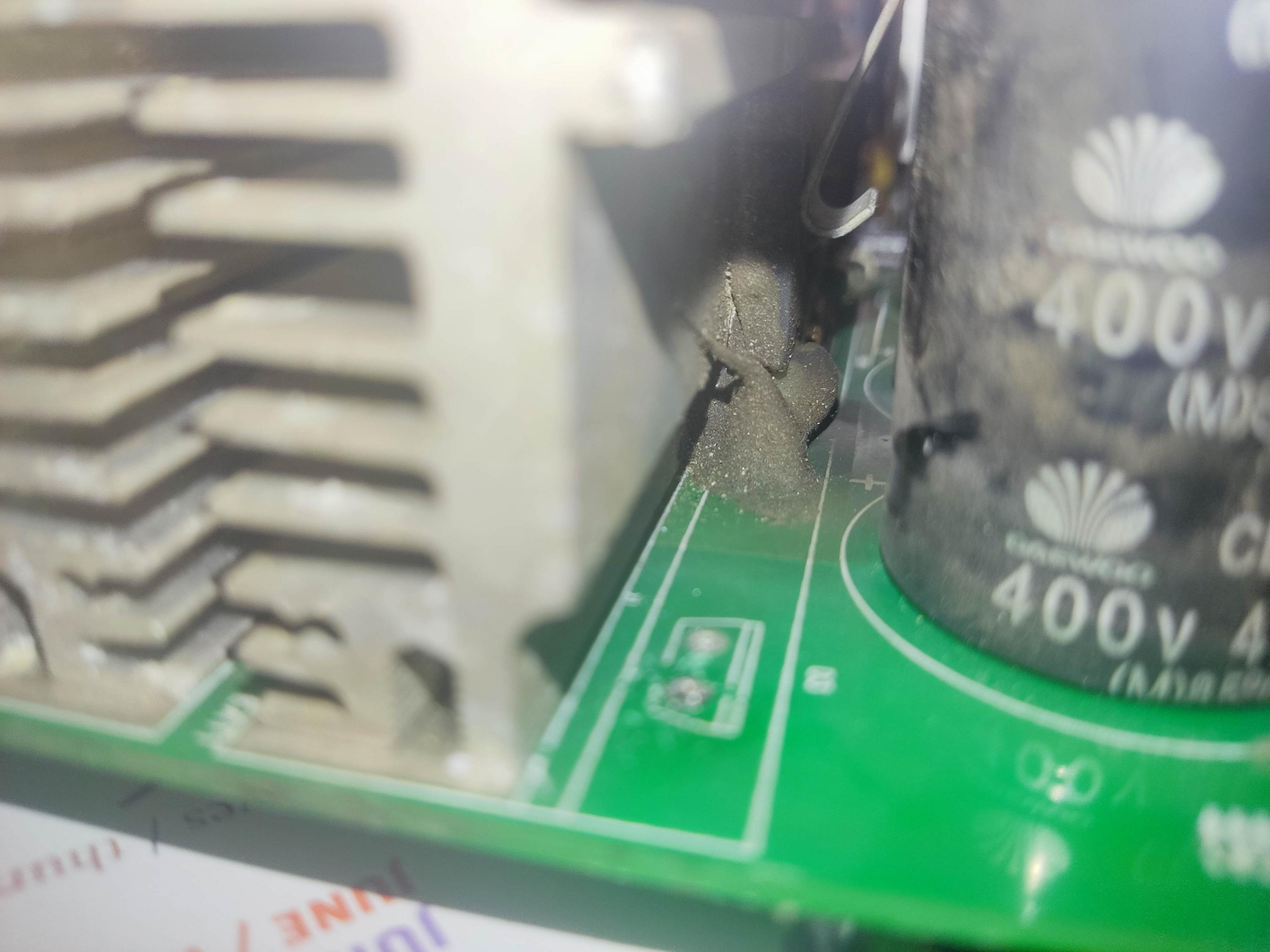

            Ok I was able to take a quick check and pictures from the board before I leave for vacation
            I tested both IGBT (still on board), nothing in continuity (not shorted) and got nothing either in diode mode (combining all leads and all polarities). Are they all open? I can't see the model until I desolder them
            The relay coil is 12V so I guess this is a good voltage for the electronics (I measured 12v on the control side capacitor)
            I took some close pictures from all sides. Note that the protecting diodes for the IGBT's are removed from the board. The other 2 output diodes are testing right with the DMM
            Thanks!

              I can see on your very fist picture first post there is an open inductor on the very bottom left!

                That SG3525 is your PWM controller and if you have a frequency option on your DMM you can easily verify if the chip is working properly, by measuring outputs A & B to Gnd.
                The LM339 is the comparator which monitors the PWM chip.
                There is some serious dirt on those heatsinks so wash all that off too.
                  Yes, thanks for checking, read comment #5 (it still has continuity for tests)

                    Do you know the make and model?

                      Did you make sure the wires wound on the inductor aren’t shorted? Kind of hard to do using only a DMM, since you really can’t put power to it to see if the insulation broke down.

                        Yes, I just checked, its a Deca MOS 170

                          Did you make sure the wires wound on the inductor aren't shorted? Kind of hard to do using only a DMM, since you really can't put power to it to see if the insulation broke down.
                          It doesn't look too bad, the cut wire is not stuck to the rest of the wires. The rest of wires don't look dark at all and moving them with my fingernail they all seem loose

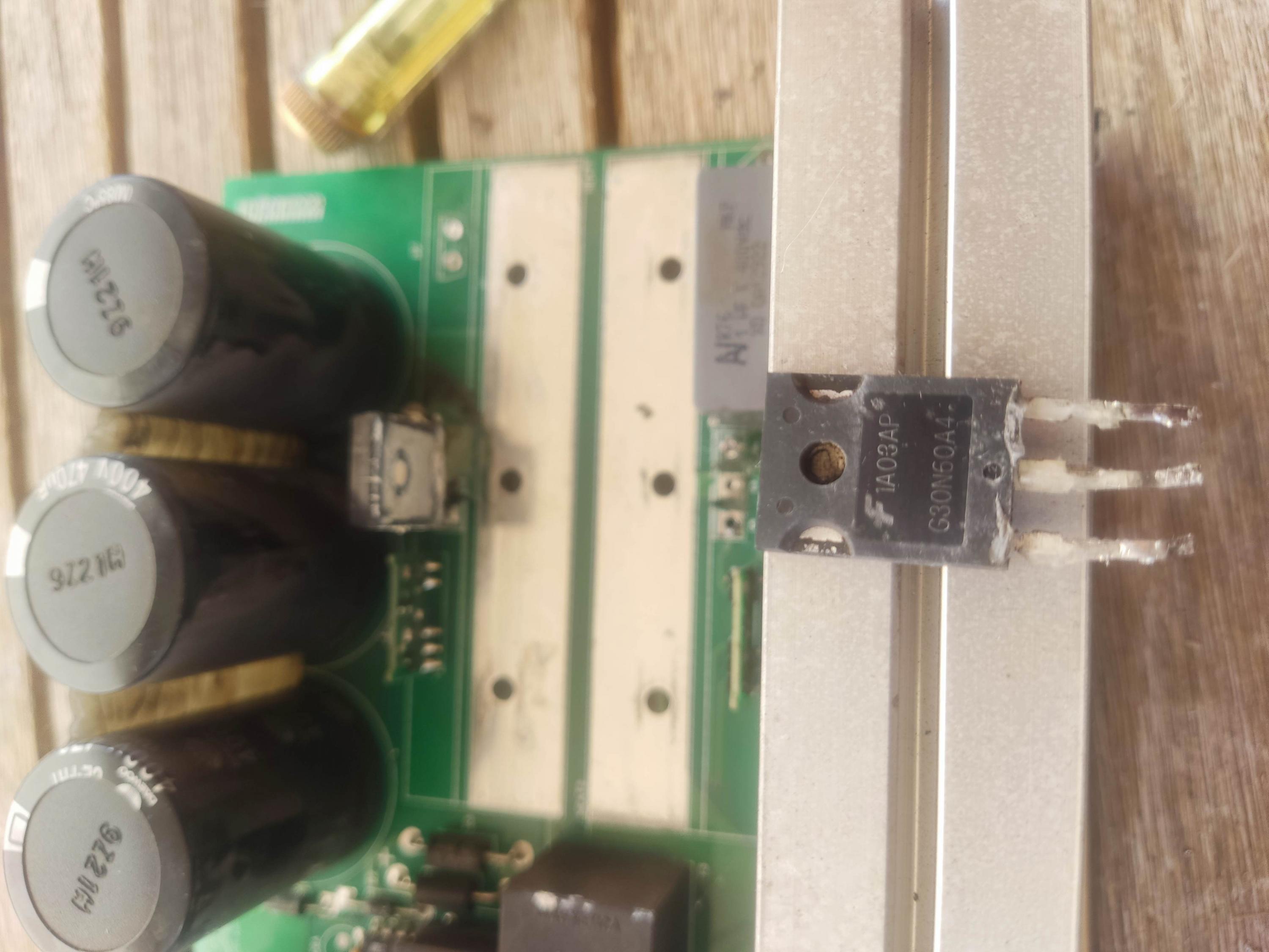

                            Ok today I returned and had time to check all this again
                            I removed the IGBT's. Both are OPEN. One of them has a missing chunk of resin. The other one looks fine outside but still measures OL on all pins all polarities (OHM and DIODE mode), so I guess they both are blown
                            IGBT's are G30N60A4
                            Diodes are RHRP1560
                            Should I go ahead and orden these 4 parts?
                            Thanks!

                              Before you go and order stuff, check that gate drive circuit for the IGBT’s. Because if it’s blown, your new IGBT’s gonna blow again!
