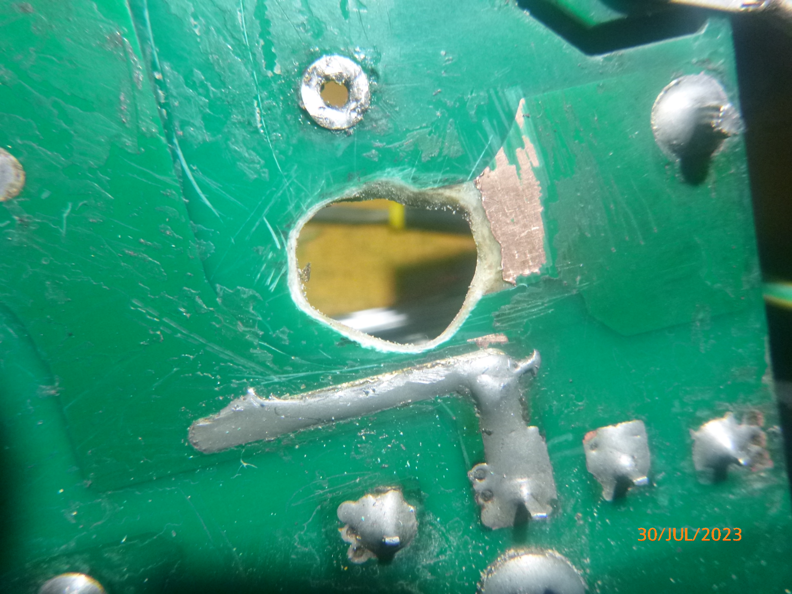

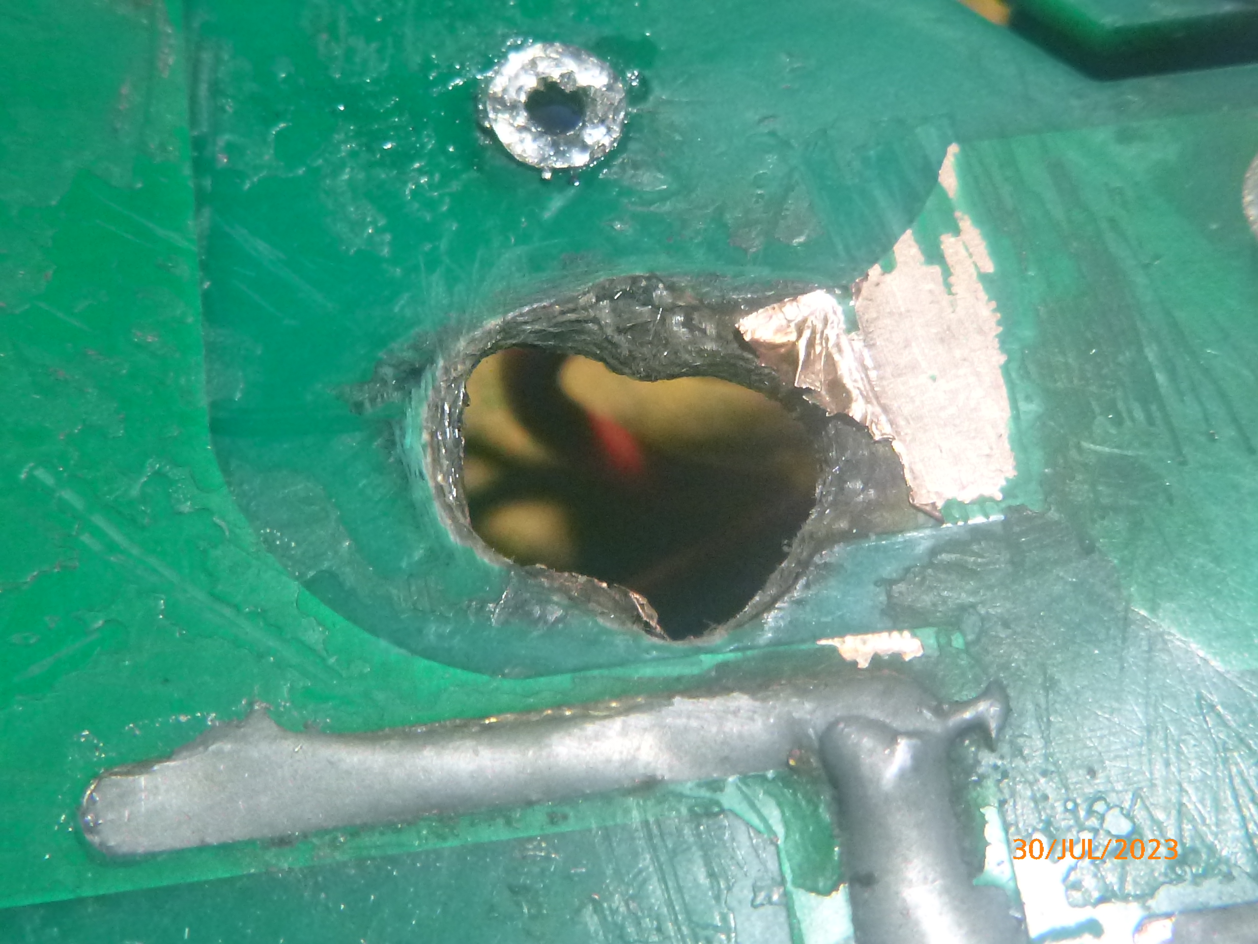

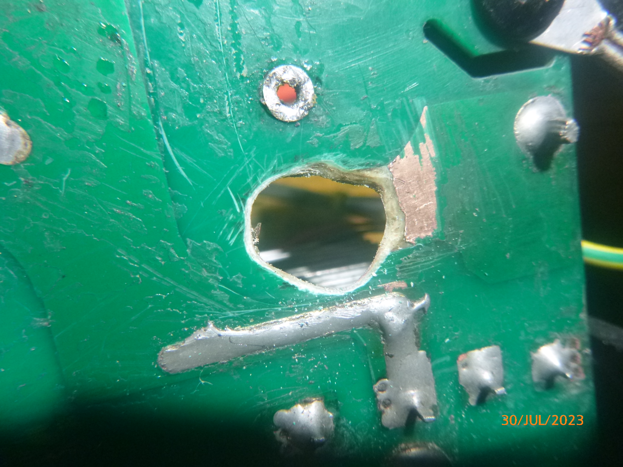

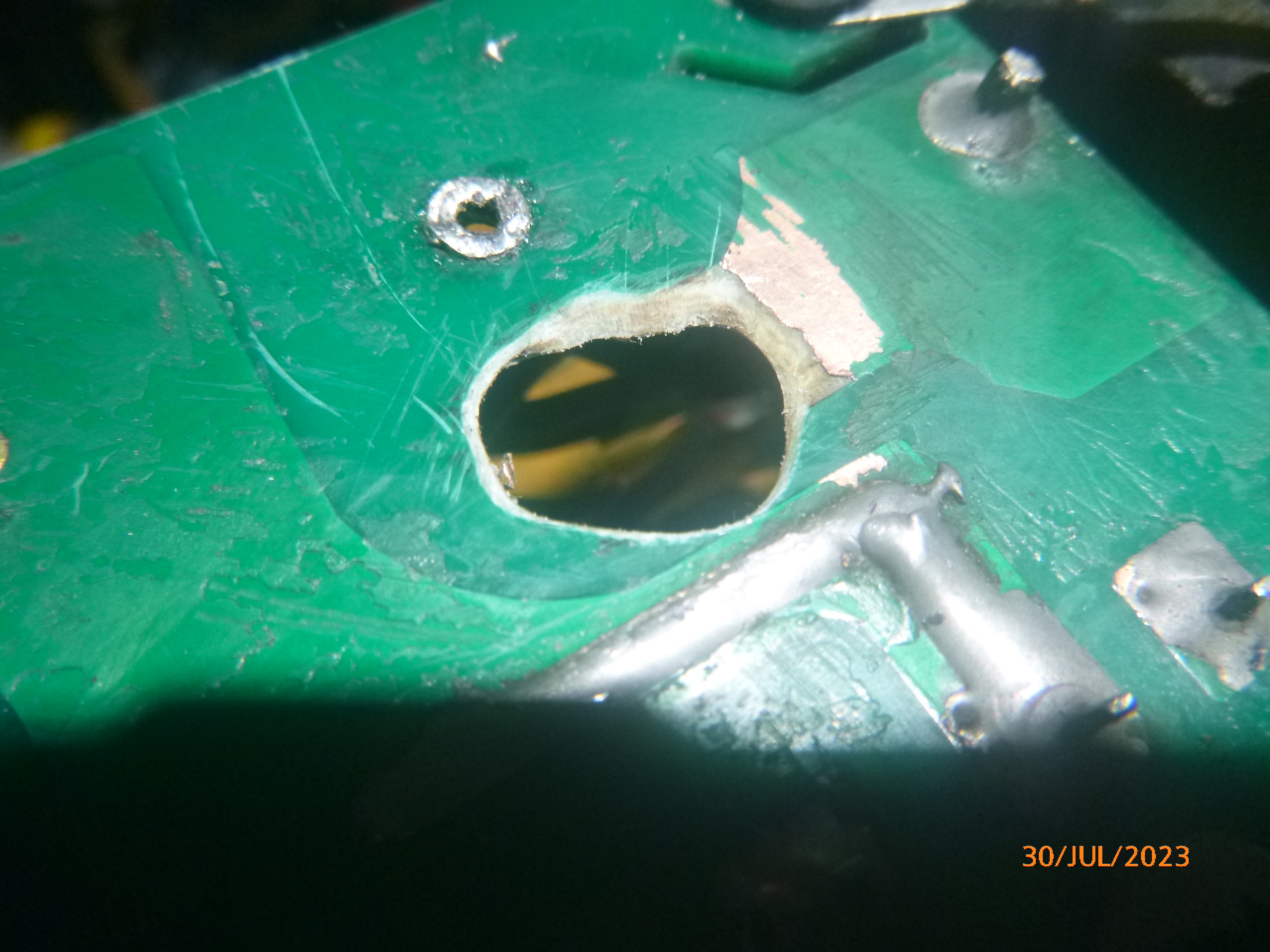

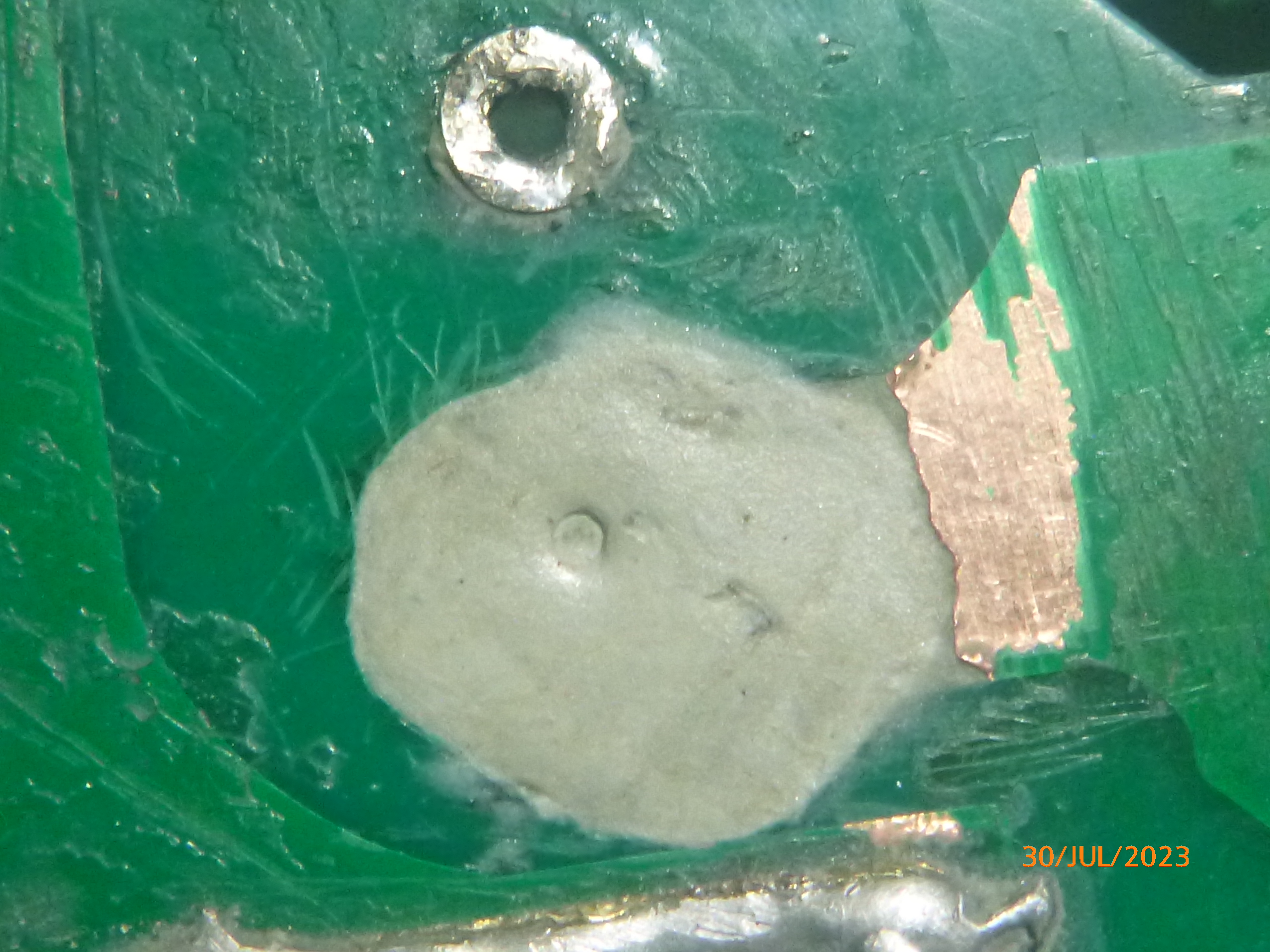

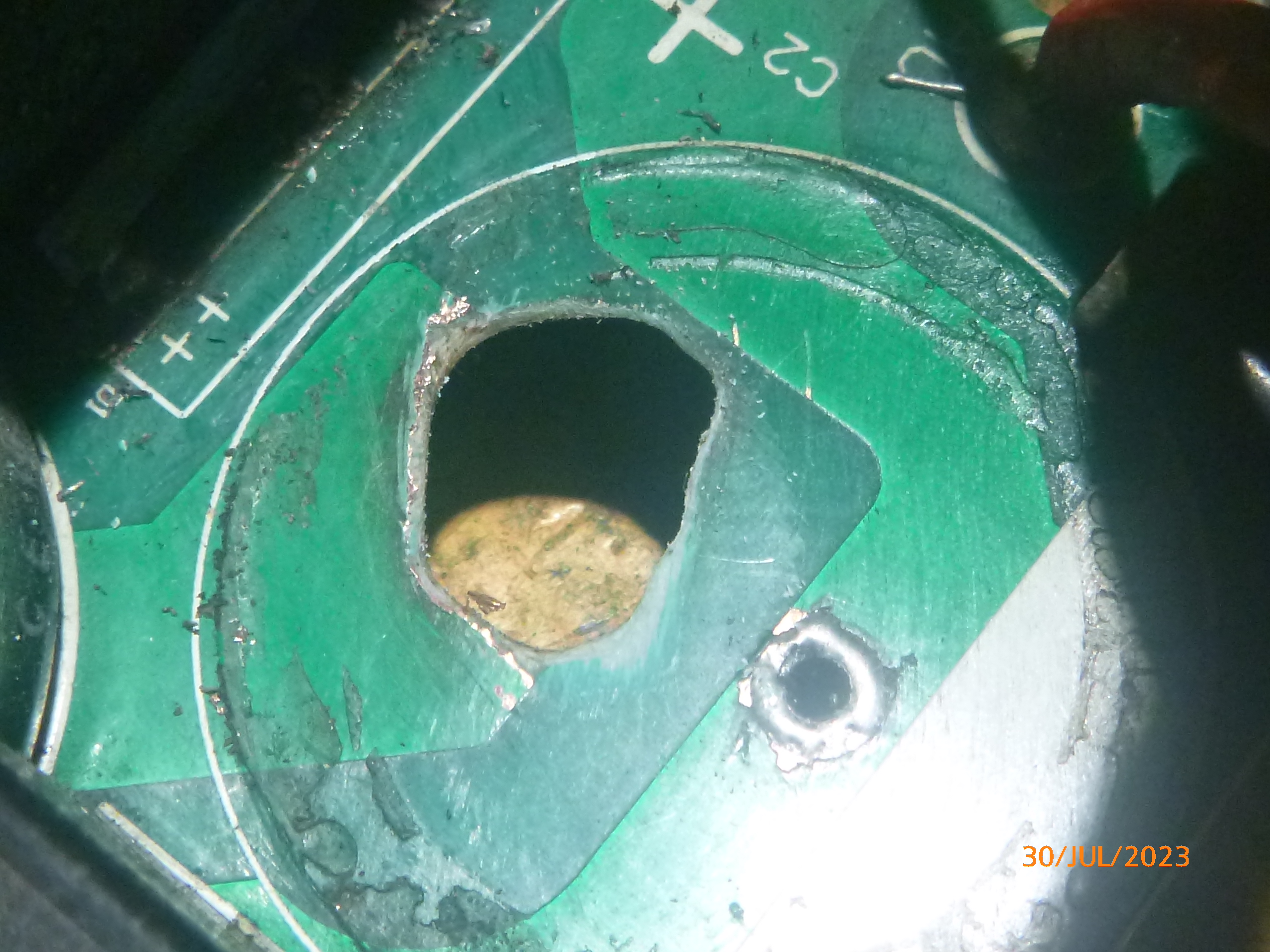

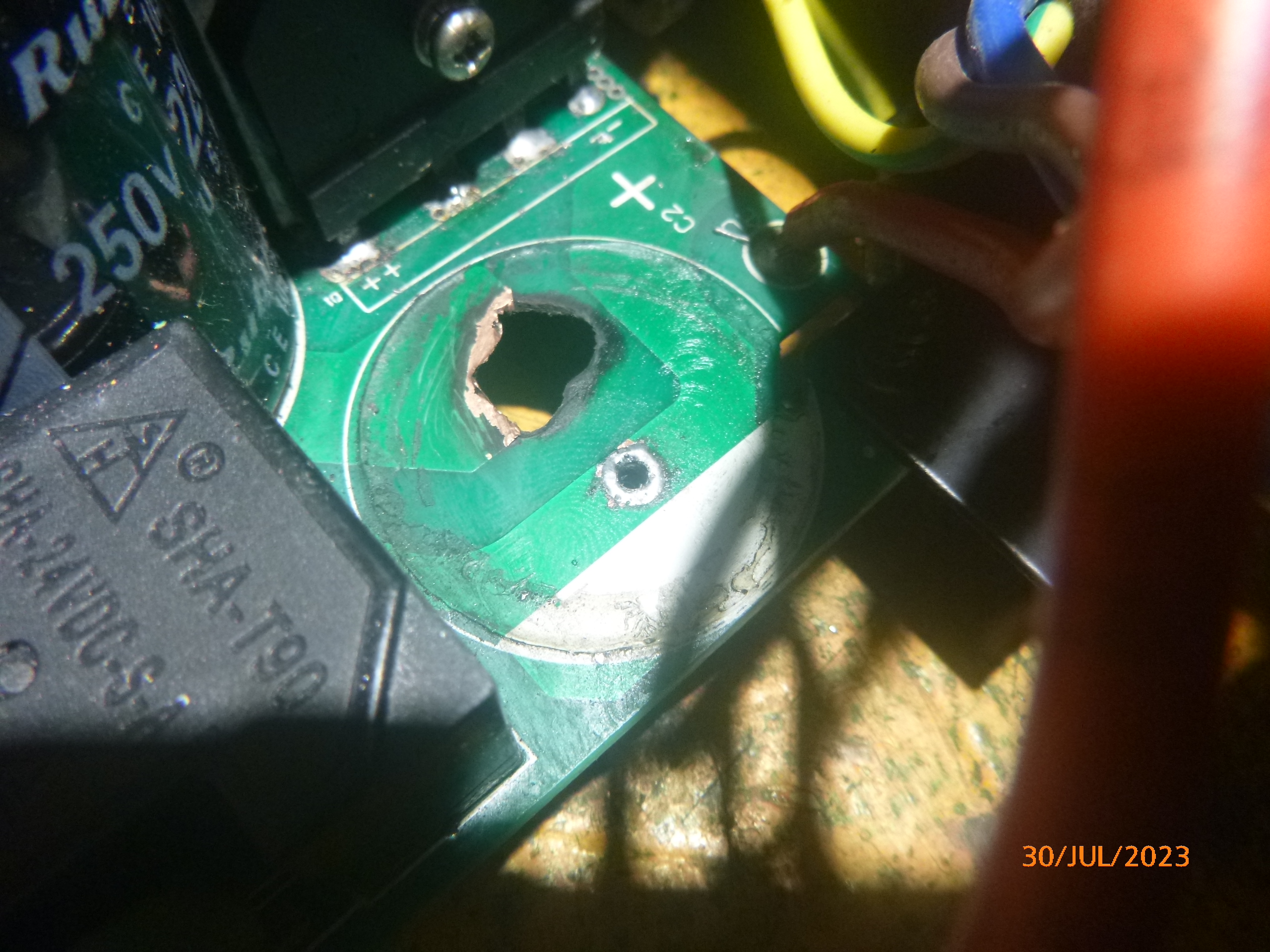

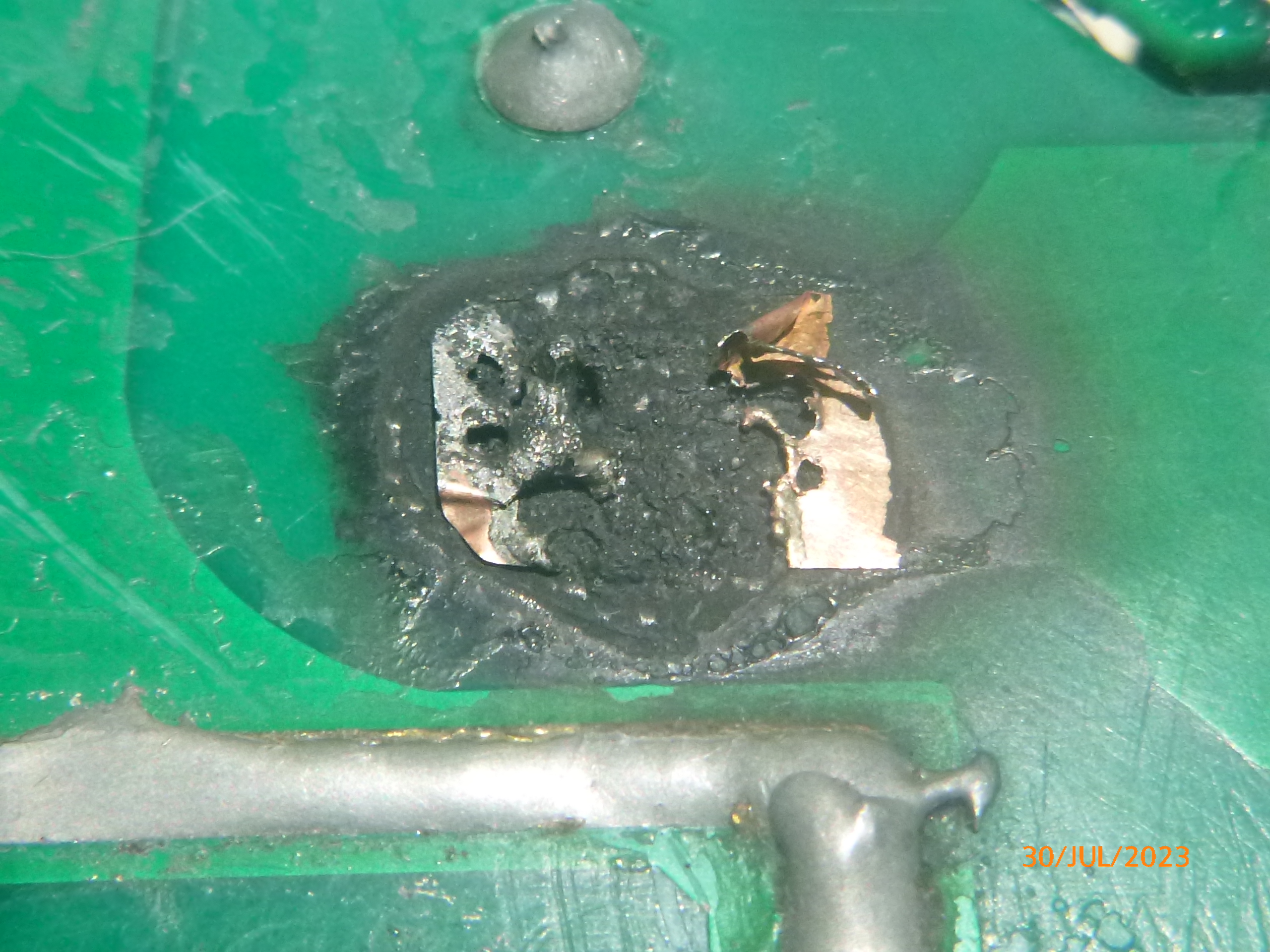

    The black carbon is conductive and gets worse if high humidity is in the game. You have to get all that black stuff removed using a rotary tool or cut it out and fix the hole and the trace. It's a wide trace, so it needs to support a lot of current.
    I've cleared out all the carbon, which left a fair hole, so that has been filled with resin and is now setting. I'm not gonna attempt to repair the traces, but rather use flex wires to bridge the points of contact.
    I'll be back tomorrow when it is all dry and fixed.

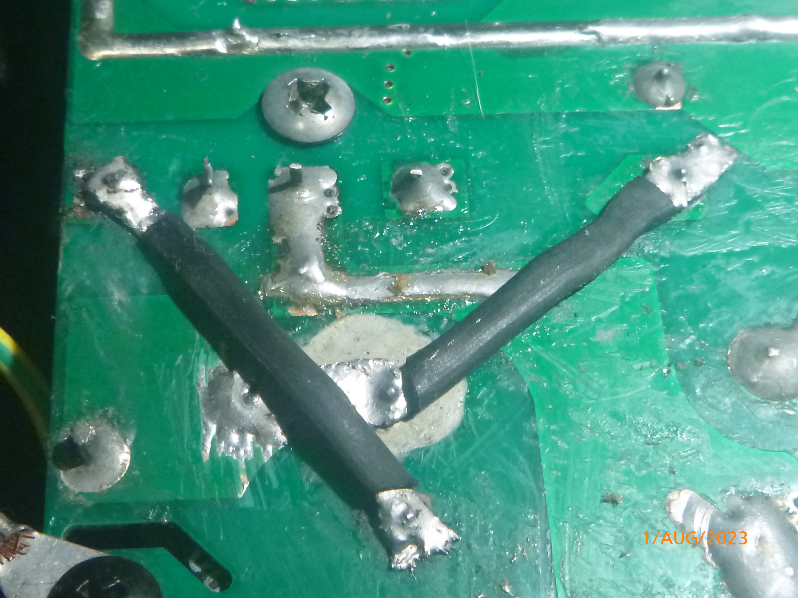

        The AC mains wires to the pcb are 4mm stranded, so I was thinking of that, or perhaps even desoldering wick, mainly for ease of use, but are you suggesting to use two or three solid core wires instead?
        I have 2.5mm solid core here for sure. I suppose 3 of these would be more than enough.

          You could use stranded, just make sure to soak it all the way with solder. But I prefer solid core.

            Re: Inverter Welder Strangeness
            This was actually why I thought of desoldering wick. I have some already soldered all the way along...
            This trace only goes from the mains switch wire to both the 2200UF caps, so it shouldn't be such a problem (he says...)

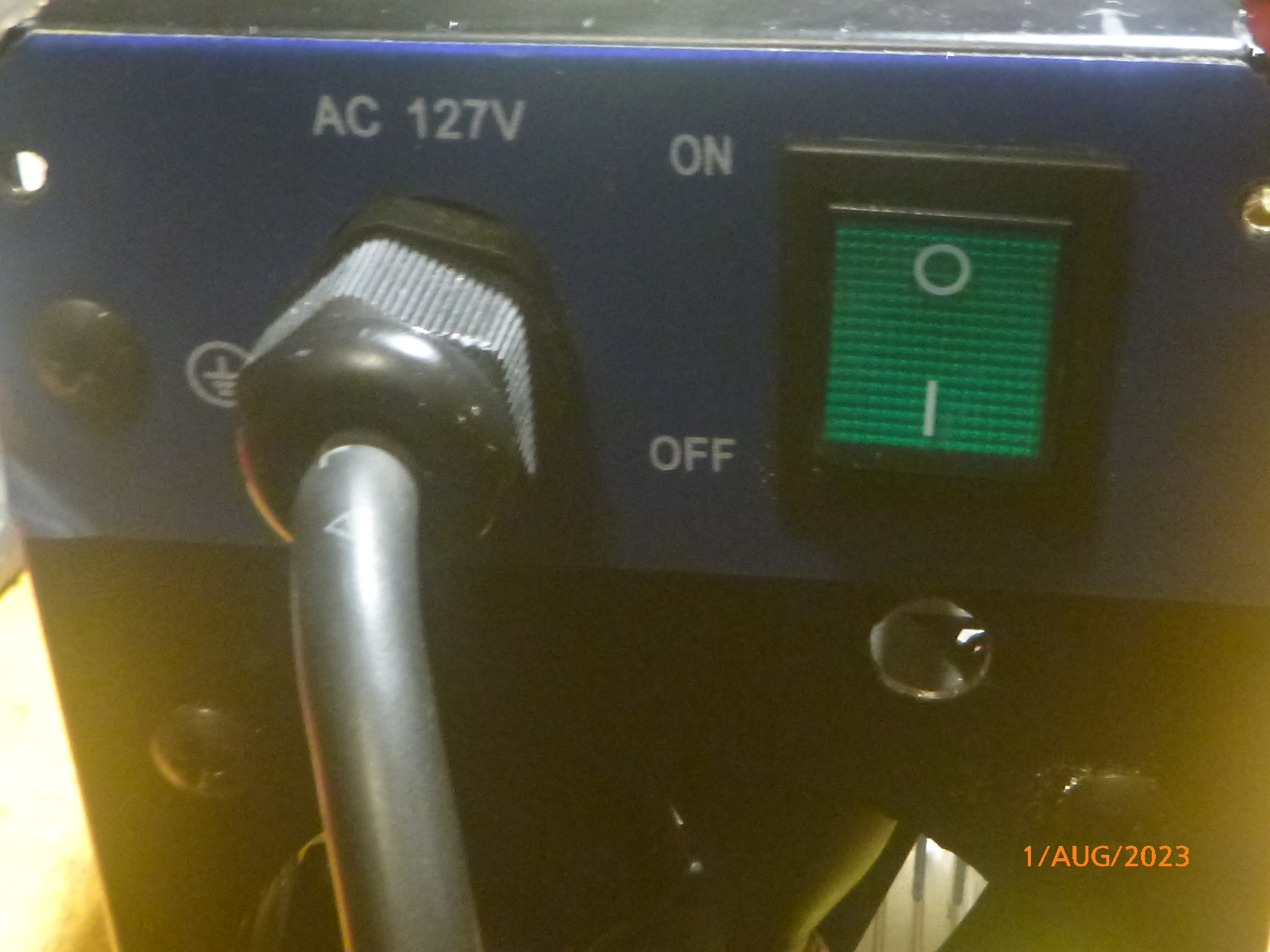

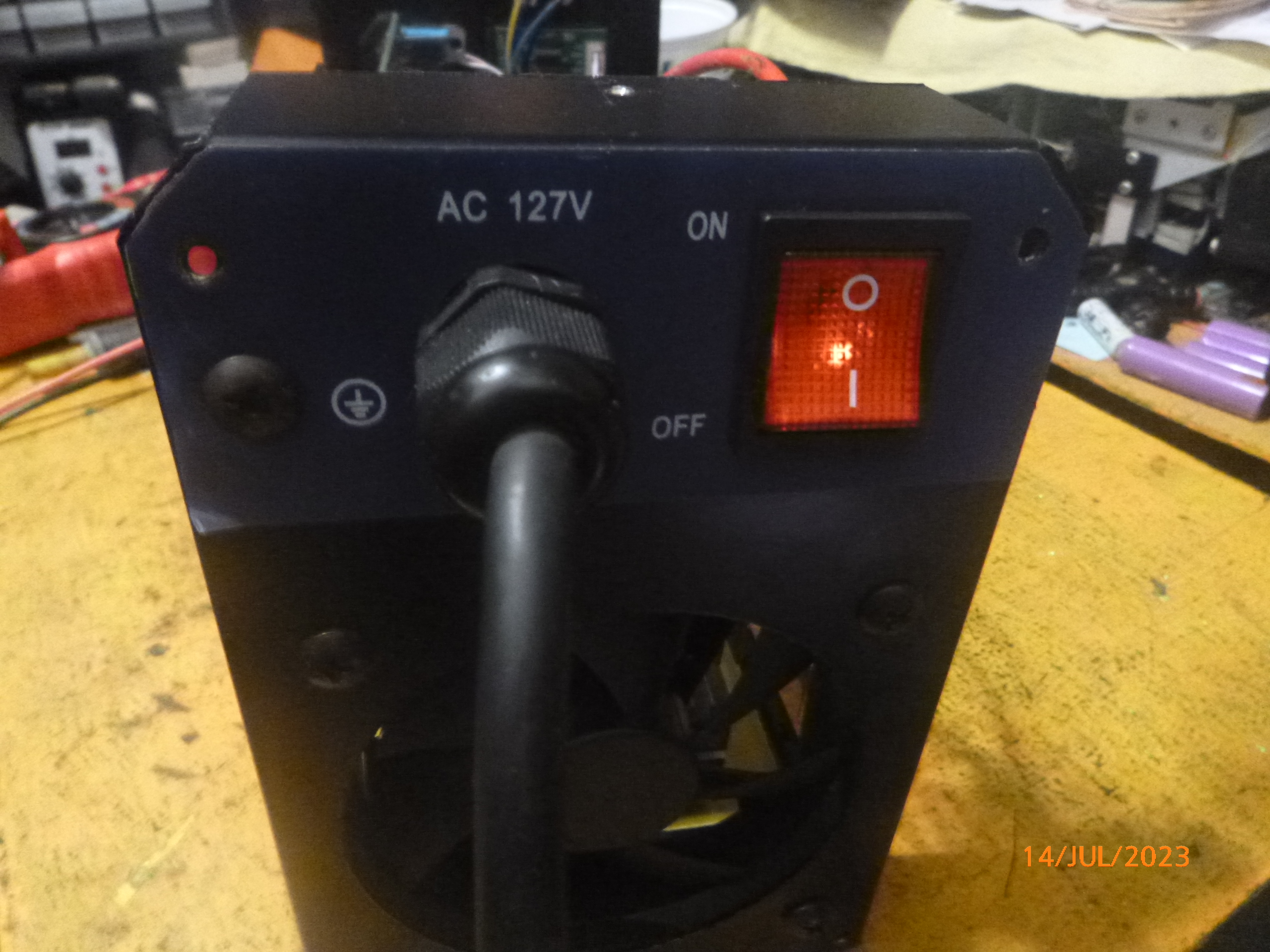

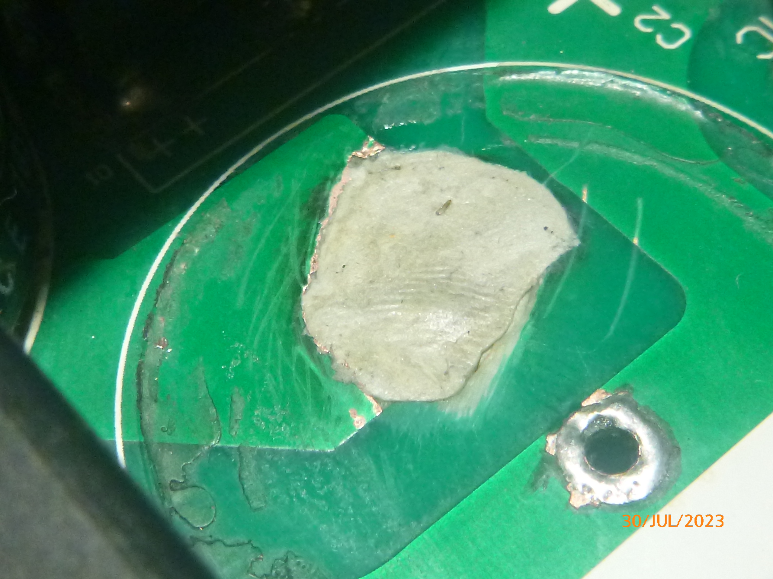

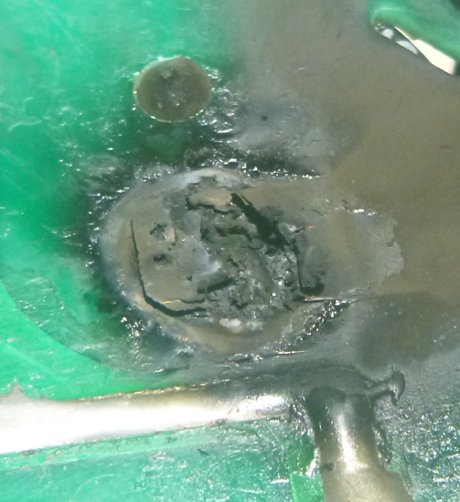

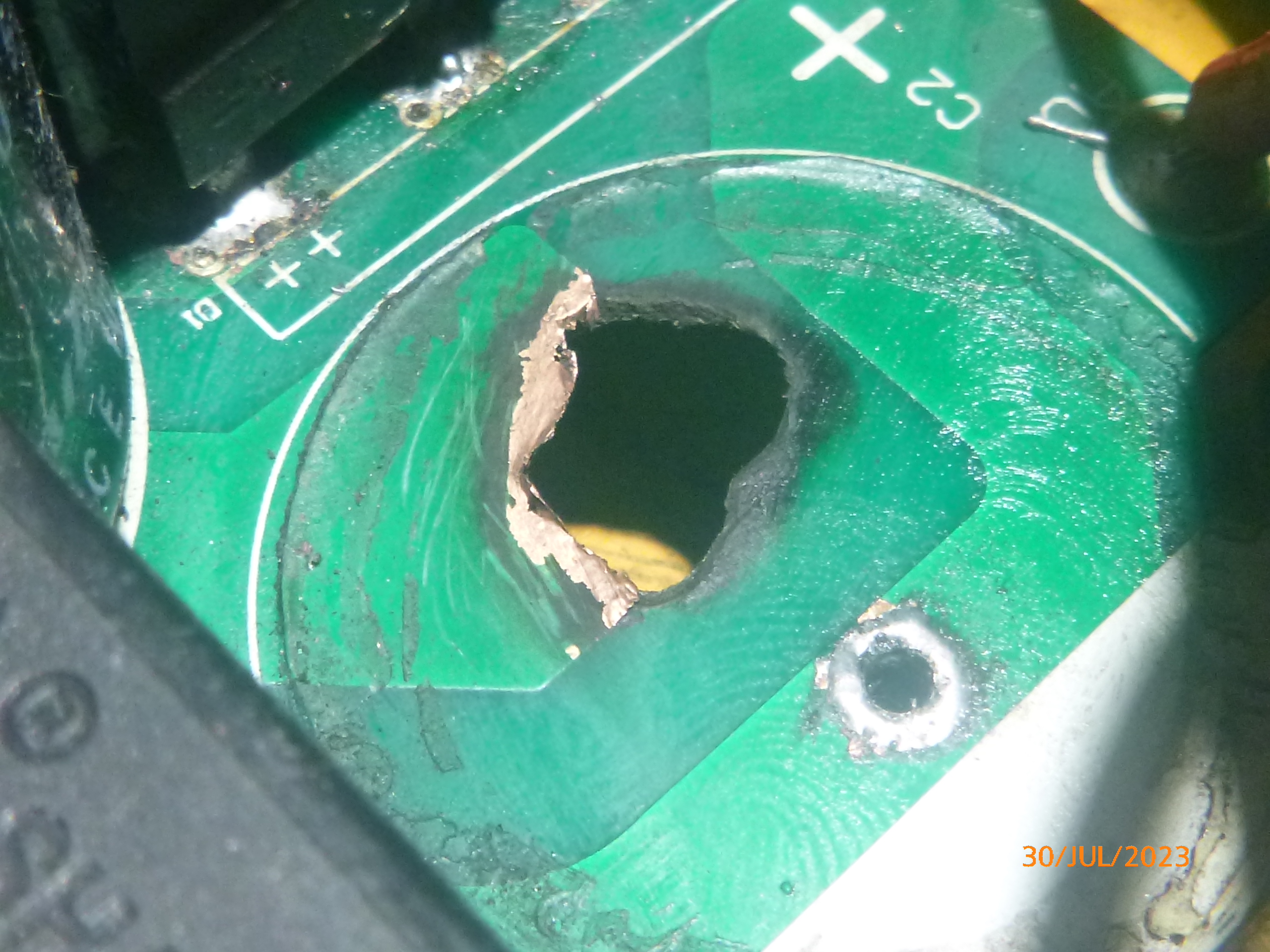

                  So, after four months, I think it is safe to say that the problem was poor connections between the mains input and at least one of the 2200uF caps.
                  Remember that this welder was bought (broken) in order to learn how these inverters work (at least more or less) and that mission has well and truly been achieved.
                  Just returned from the garage, where the welder laid super clean welds for the first time since I bought it.
                  Ok.. It took a carbonised pcb to finally reveal that the problem was hidden under the green varnish, but these are all invaluable lessons.
                  Performing resistance tests today from each point of the mains input/rectification section, revealed that two of the traces had breaks in them, even though before the burnout they had 'appeared' (to the eye) fine.
                  Invaluable lessons in my electronic repair journey...
                  I wanna thank all who have given their time in this thread, but especially CapLeaker, as he dissuaded me from scrapping the welder when I was itching to do just that!
                  Posting the pics of the pcb repair, for posterity...
                  ... Or was the problem solved because I changed the red (stop) on/off switch, for a green (go) one?
