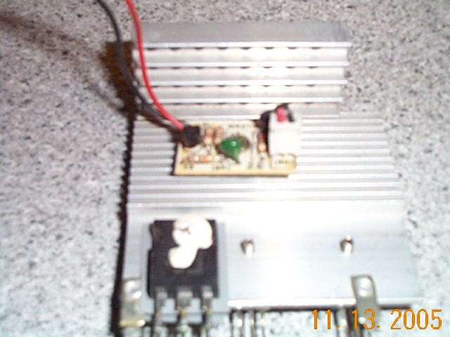

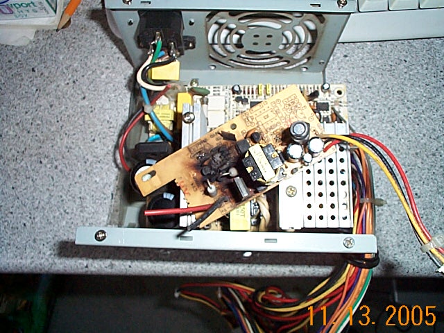

    Antec PP-303X
    Here's another Antec that fried. I'm not sure if it was caused by bad caps but it is loaded with fuhjyyu caps. I have since opened every PS and replaced all on the low voltage side with quality caps from Digikey. Voltages when monitored in the BIOS are much more stable now! Should the 22uf 50v caps be replaced as well? Some of the threads on this forum indicate these are also the cause of problems.

    how old is that psu? the later ones look better. where is half the components on that pcb heh

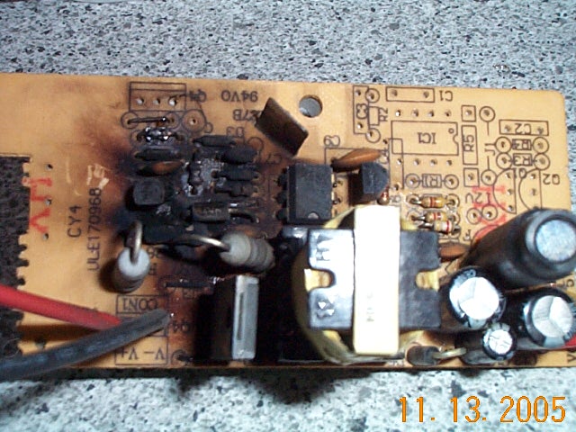

      If that's a a 300W P/S, those are very decent sized heatsinks (How often have I said that in a post?). What is that fried daughter card, a temperature-controlled fan O/P?

        later models had the nice heatsinks and glue (how am i supposed to to service this junk or inspect the caps) and of course a lot of teapo etc
          All of the Antecs I've seem to be well designed with beefy heatsinks etc. Their choice of fuhjyyu caps kinda negate the decent engineering however.
          I think this is the fan control circuit. Not sure what the blown daughter card's function was except scaring my wife when it blew up hehe.

            I think the fried board is for the +5V standby rail, if I am correct, from the size of this board.
              correct.likely had the chopper short and blew up the parts leading to its gate.
