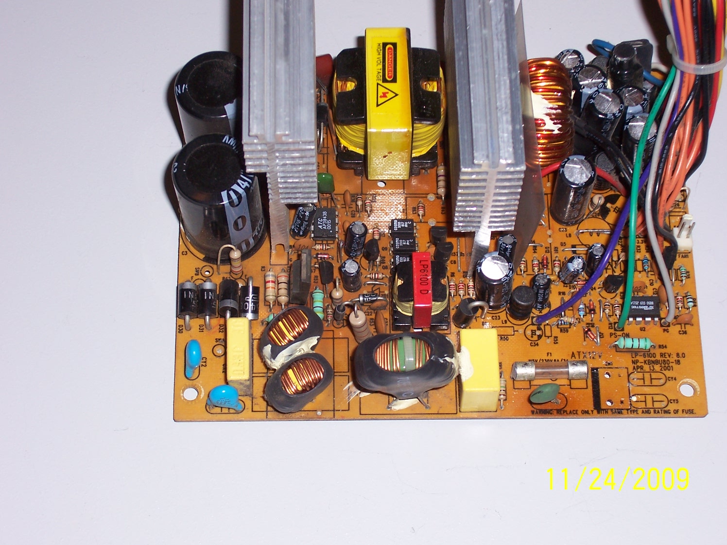

          I have a crappy store brand "CompUSA" 250 watt power supply - marking on the pc board is LP6100, so it is a cheaply made L&C product. Most of the capacitors were bloated, so I replaced them all with the better quality Fuhjyyu (comparatively better than what was in there!) from an Antec I recapped. I checked all the Fuhjyyu caps for ESR, so they are all "good". Then I fired it up with a light load, and shortly thereafter blew it out - shorted the main switcher and cracked the pwm chip. I am convinced that ALL of the parts used on this one were cheap low quality. So I replaced the pwm chip, the main switcher with a new Fairchild 18N50, and a buffer circuit between PWM output and the 18N50, Now lets see if it can blow out that switching transistor!
          Every once in a while, I fire it up, beat on it, put a heavy load on it, etc. So far it has held up. But I am still curious which will fail first - the Fuhjyyu capacitors or the 2 transistor 5vsb circuit.
            Actually, L&C is with Deer and Allied. Solytech is the company behind these three. The one you have is a Leadman/Powmax (as indicated by the model number).

              Yeah. LPXXXX part numbers are made by leadman. They can also start with KYXXXX
