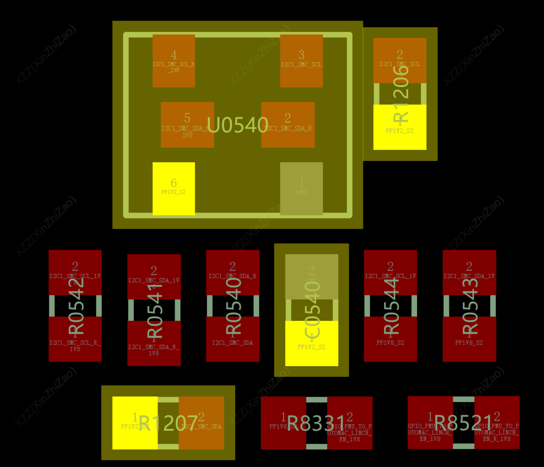

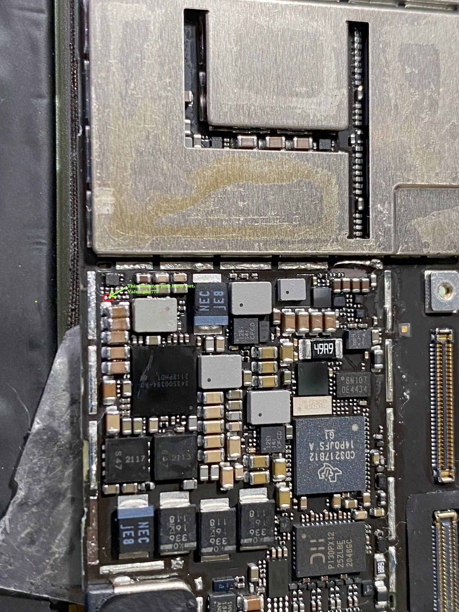

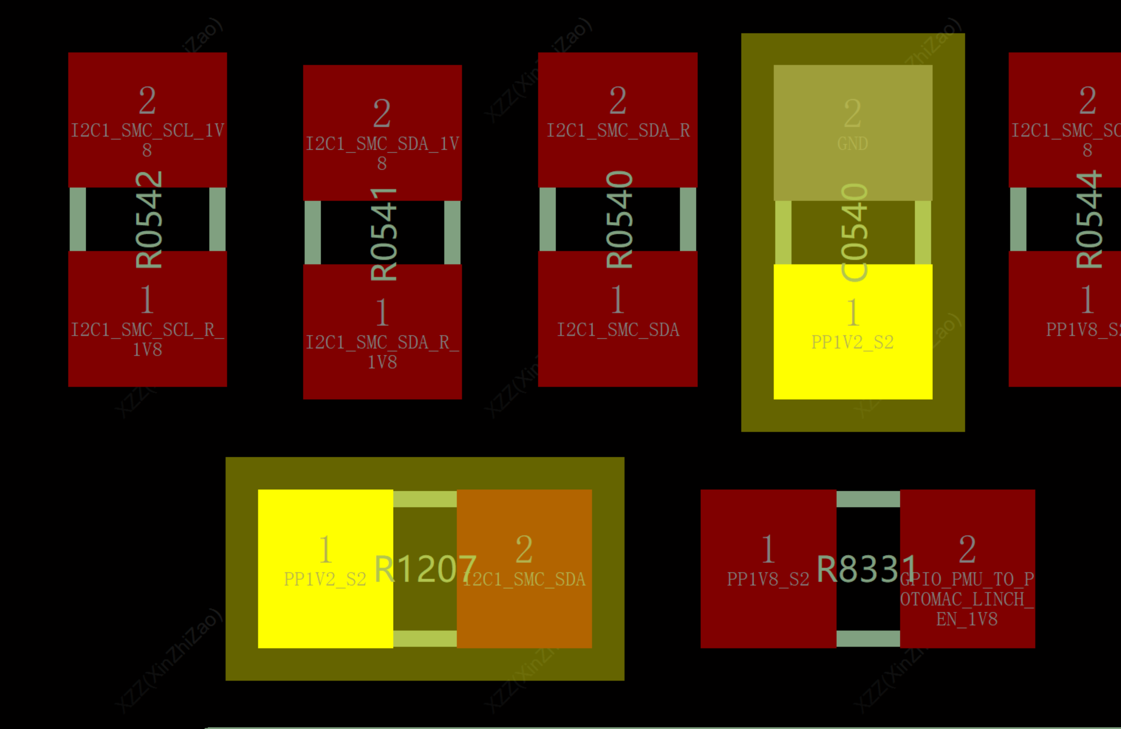

                Can anyone share the schematics from iPad Air 4th Gen A2316. I accidentally blew out one resistor by mistake & forgot to measure the resistance before removal. Attached is the photo of the missing resistance. It's near the LCD/charge circuit under the shield, next to the charger chip 343S00394-A0.. Hope someone can help me finding this resistance value. Thanks in advance.
                • mon2
                  • Dec 2019
                  • 14841
                  See attached.
                  R1207. This is a pull-up resistor for the local I2C bus - SDA line. Respectively, review the resistance of R1206 which is the other pull-up used by the SCL line. You can use the same resistance here. I2C bus interfacing does not demand the use of a critical value. We have used 4k7 / 10k on our designs without issues. In the end, the # of nodes may not be text book perfect but 2k2 is a value that has been used forever in reference designs.
                  • mferna14
                    • Jun 2018
                    • 1050
                    Thank you mon2... Hoping the value of R1206 might help. & you are right 2.2k might be fine out here. Thanks for the help.

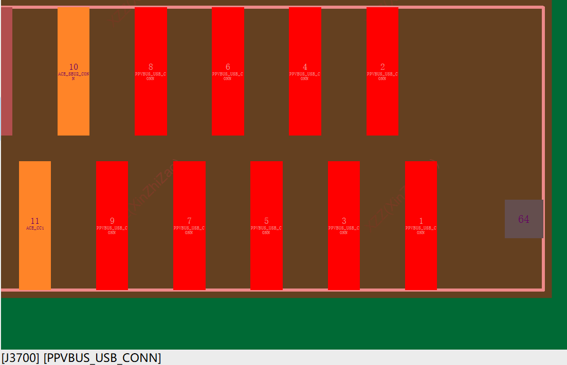

                      Hi, gonna hijack your thread
                      It's the same iPad Air 4 LTE with the same charging problems, but I've managed to rip one of the PCB contacts and need to wire it. Given this is the top view, could someone with the schematic tell me where I should lead the wire? Thanks a lot
Name:	Screenshot 2024-07-20 004147.png
                      • mon2
                        • Dec 2019
                        • 14841
                        This connector appears to be J3700 in the boardview file (do not have the schematic for this one).
                        The missing pin is pin # 1. The group of pins here are mated together for pin #1..pin #9.
                        To confirm, remove all power. Meter in diode mode. Then touch the meter probes together and the meter should tone beep.
                        Proceed to touch any of these 9 pads with one probe and touch another pad from this group and the meter should tone beep again.

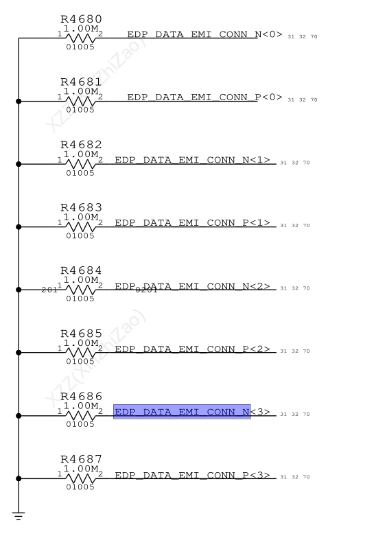

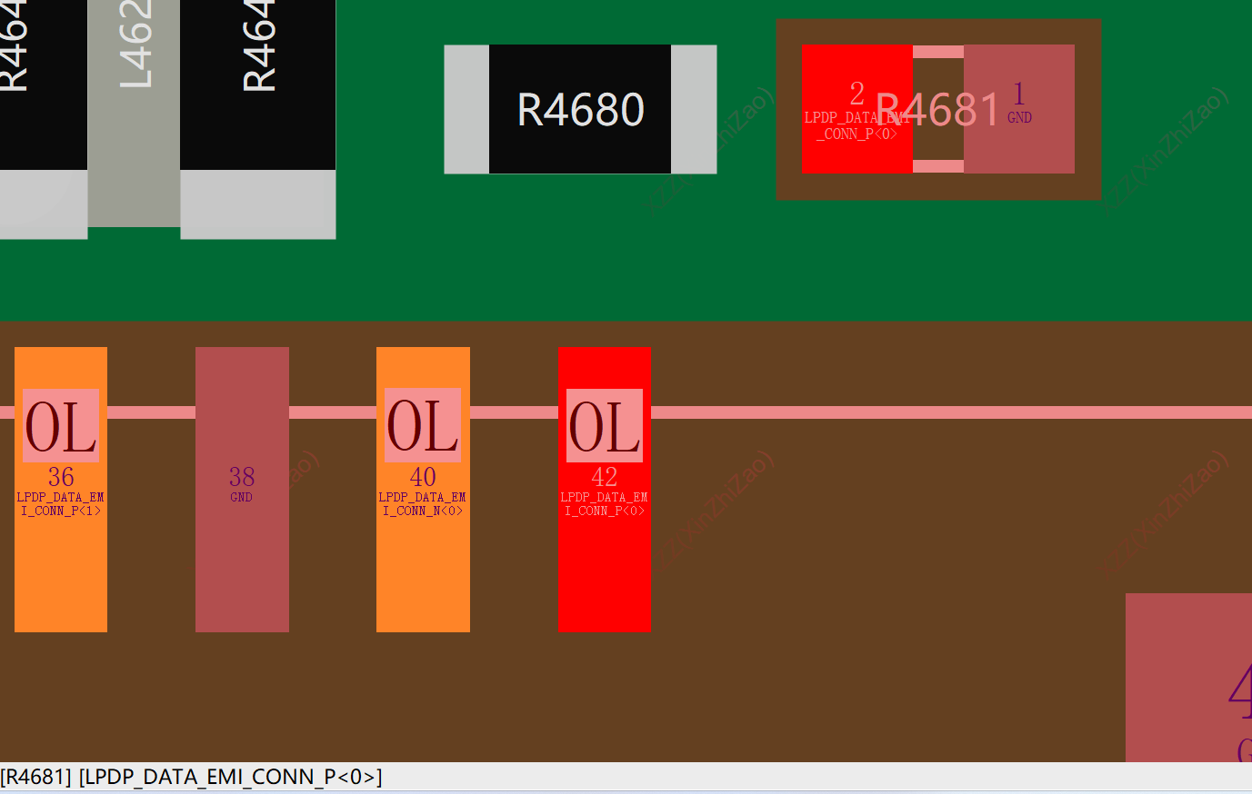

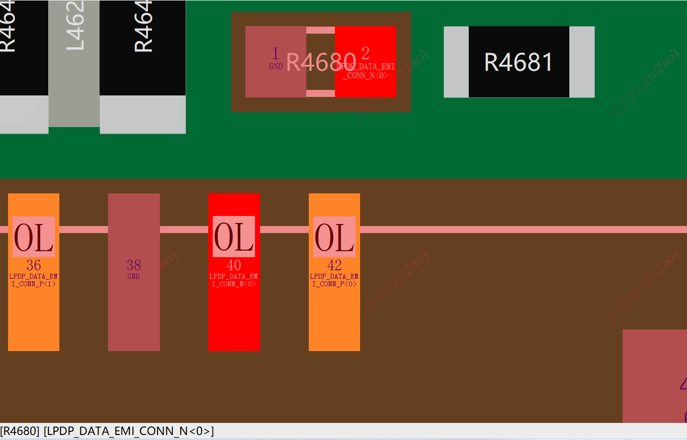

                          Does anyone have the readings to these 2 resistors? We can name them by number starting from the right. Resistor 1 and 2?
                          • ejaboz
                            • May 2018
                            • 10
                            • Norway
                            managed to makena double post.....
                            • mon2
                              • Dec 2019
                              • 14841
                              So far, only know their function from the BV file.
                              Update - see below. From other ipad schematics the EMI resistors are @ 1M ohm each.
                              Click image for larger version  Name:	r1.png Views:	0 Size:	48.2 KB ID:	3319804
                              Click image for larger version  Name:	r2.png Views:	0 Size:	48.1 KB ID:	3319805
                              • ejaboz
                                • May 2018
                                • 10
                                • Norway
                                thanks! I had one semi intact and it said over 1m but thought maybe it was bad. But this confirms that it in fact is 1m. Appreciate it mate.
                                • strtcstr
                                  • Jul 2024
                                  • 3
                                  • Austria
                                  mon2, thanks a lot. They seem to be connected, but I've ripped the PCB-side contact, not the one on the flex. Could you please check where the PCB pin #1 goes? Thanks a lot.

                                      Hi same problem i need help for two resistor, R8900 R8901 I2C SMC SDA 1.8V. Or schematics???
                                      Can someone have specifications of this resistor to replace it? thanks
