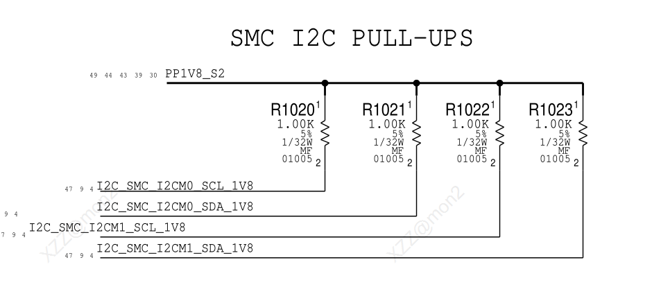

    You can use 1k to 2k2 on these resistors which are very likely to be pull-ups as required by the I2C specification.
    See attached (from other ipad schematics)

      Hello mon2,
      thanks for your anwser, i don't speak english well but i try. Yes its very good idea and you have wright i go to change this resistor by another same like i2c line.But with zillion xzz i don't understand why have boardview but not schematics. its abnormal.
      Big thanks i go to test your way ans reply after. Have i nice week

        Hello, I soldered 2 1k resistors it's true that on these lines there are 1k resistors except that it doesn't work. These are the resistors on the I2C gasgauge and SDA lines resistors near the battery connector of the 2 thin pins. The iPad Air 4 turns on and restarts alone, and stays on 0%.... I think battery has a problem too maybe...
