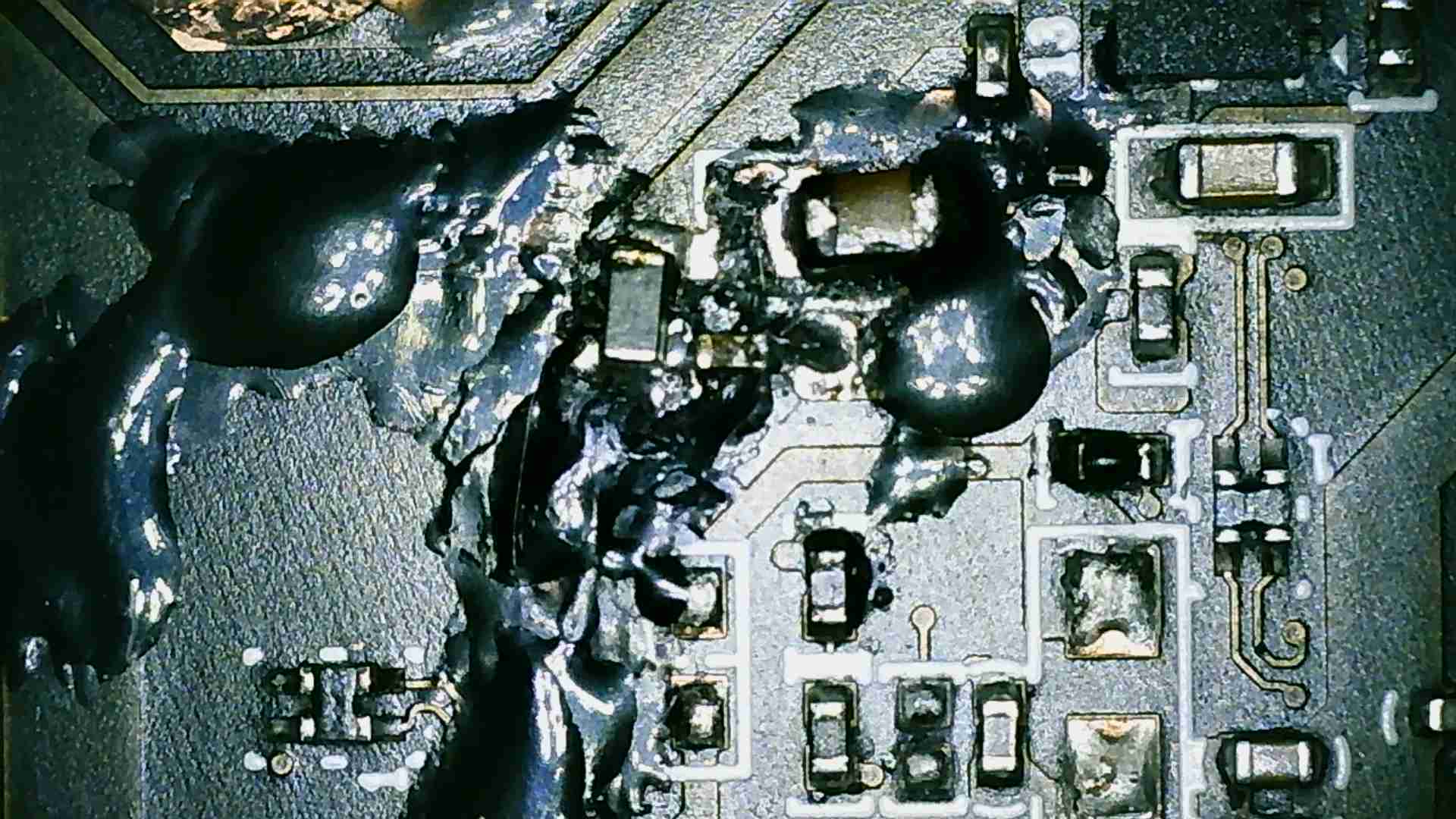

                        dear Friends
                        I made a mistake while using my hot air, I have lost an unknown resistor value, I would like anyone to get this value to me, please, I attached some pics for that resistor location on Panasonic lenovo 13MB core i5
                        https://mega.nz/folder/TWxBDbYS#oJB83YOBGW-XFWE5hmQzBg

                          Saludos cordiales colega... ya soluciono su problema, porque tengo esa placa en mis manos y le podria colaborar con esos valores.
                          El valor en ohmios es 000,5 de la que esta señalada y de la que esta junto a ella tiene el mismo valor en ohmios.
                          Best regards colleague... I have already solved your problem, because I have that plate in my hands and I could help you with those values.
                          The value in ohms is 000.5 of the one indicated and the one next to it has the same value in ohms.

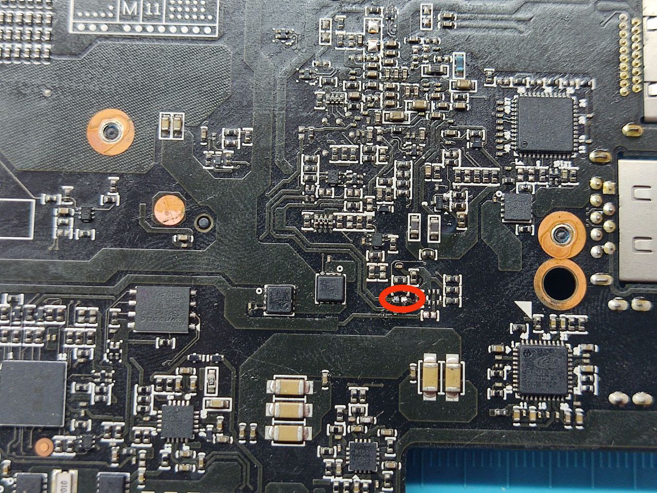

                            Hello everyone Help needed plz i had some corrosion on this resistor and while trying to clean it resistor got lost and now i dont know the measurement of this resistor if any one have same board plz help me i have uploaded the picture its part no is lenovo yoga 13 mb panasonic.

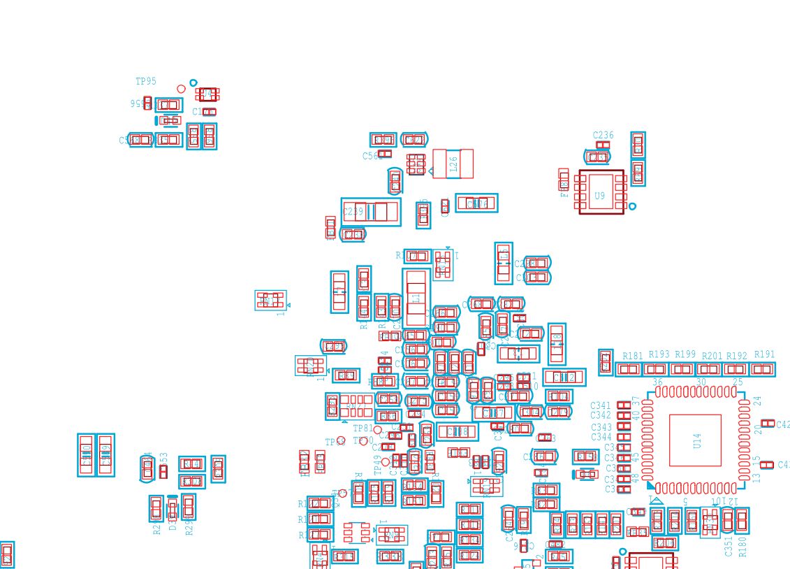

                              Boardview

                                PLEASE HOW CAN THE BOARDVIEW BE OPENED
                                • fahri01
                                  • Dec 2013
                                  • 3
                                  • Türkiye
                                  pdf file from picture will do the job
                                    • 21874
                                    That pdf is fake, Mocca 2.0 SIV MB . Ivy bridge.

                                      Originally posted by gunjanksh
                                      Re: Lenovo Yoga 13 - Schematic Needed
                                      Hi, this one (what you show) have 0 om resistance.
                                      If someone can send me photo this area. I will be happy. (See photo below👇)
