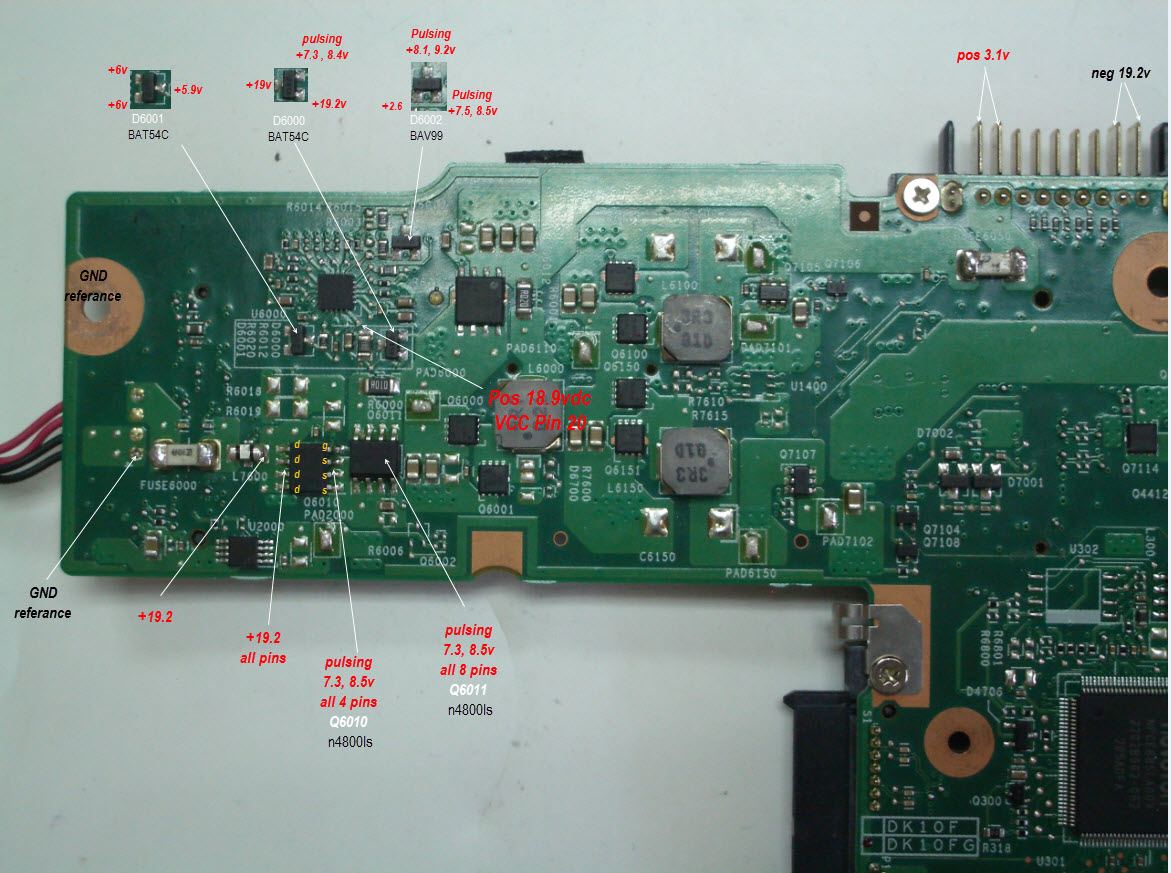

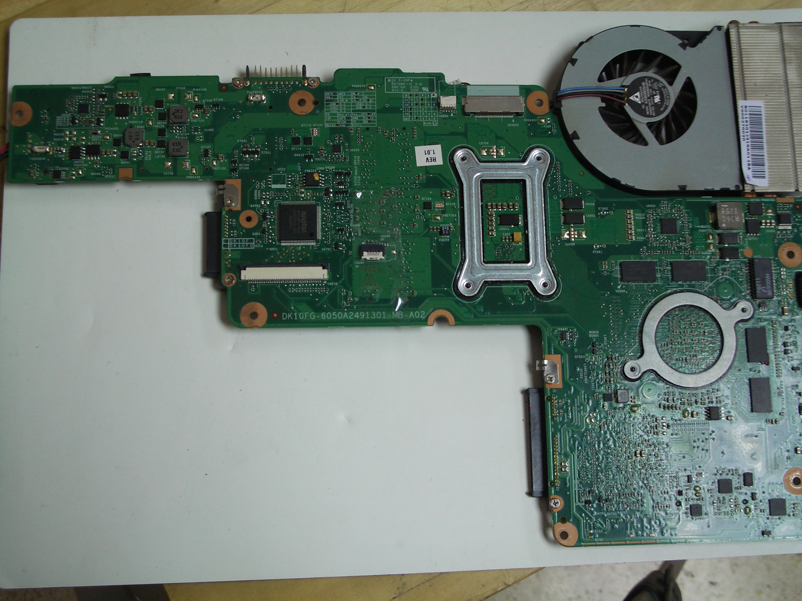

    I have a L855-11K Toshiba with this MB DK10FG-6050A2491301-MB-A02. The power was applied with reverse polarity and now their is no power lights. I am getting voltage up to the battery terminal but only 3.1v
    I downloaded the schematic but I am noob at reading them.
    Could anyone with experience direct me to the component that would have been damaged, or the section I should be focused in the schematic. I am not seeing any burned out Mosfets or diodes and both fuses test ok.
    I am getting a pulsing reading of 7.x and 8.x vdc out of Q6010 and Q6011 Mossfet's at the pwr connector.
    I don't understand the schematic as the voltage is not listed, and as I said I am learning.
    Thanks in advance.

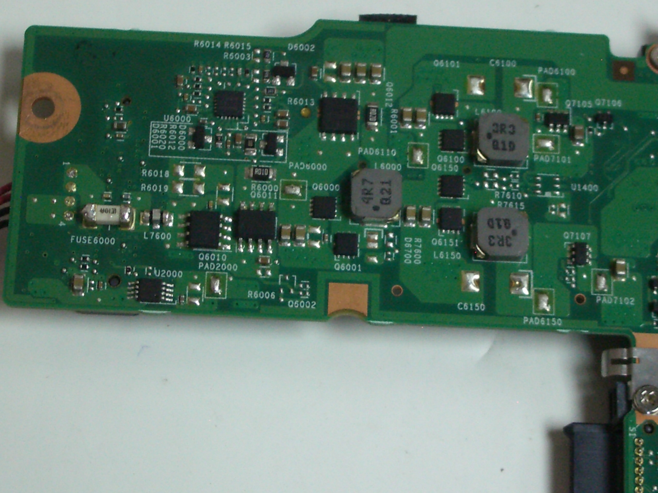

      And fuse 6050? Picture of your board may help as schematics do not always match the board exactly

        Fuse 6050 is showing +3.1v I will post pics and notes tomorrow, I am away from the mb.

              I am getting Positive 19vdc at at fuse 6000, COIL L7600.
              I am using an alligator clip on gnd through holes on MB.
              The VCC pin of the U6000 pin 20 = Pos 18.9vdc
              The reverse polarity applied was 19.5vdc, (I did it by mistake with a wrong adaptor on a universal charger when it fell off.)

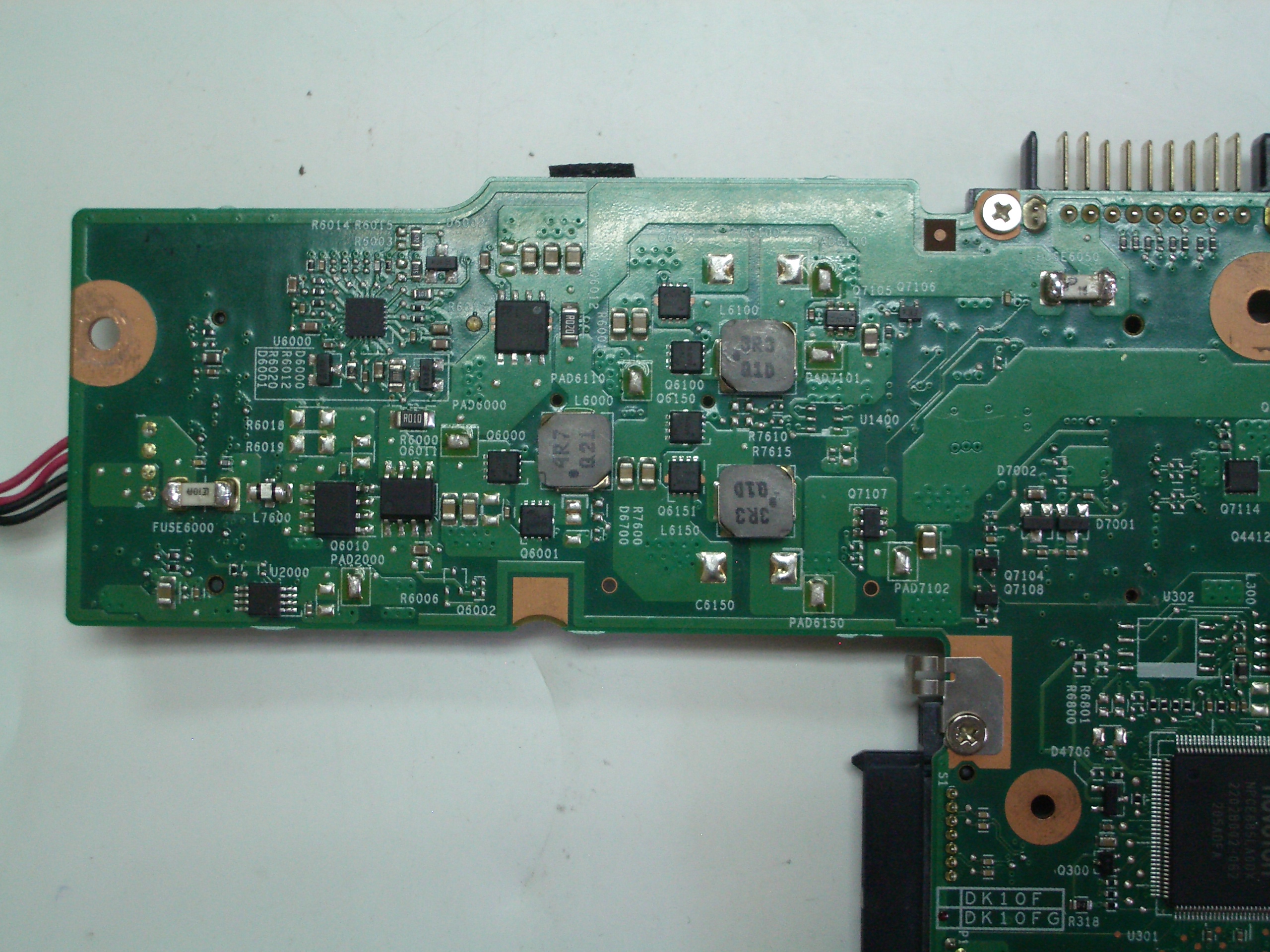

              selldoor, I attached photo's with some details as you suggested, fuse 6050 is Pos 3.1vdc
              aanan, Pos 19vdc at 6000, COIL L7600
              I will upload any other details and follow your suggestions, please be patient with me as I am in the EU and our time may not match!
              I am very appreciative of you guys helping!

              • selldoor
                Slow Learner
                • Dec 2010
                • 7870
                Re: Need help reading schematic for Toshiba motherboard
                Id say get the voltages on the other coils and add info to your pics which are good.

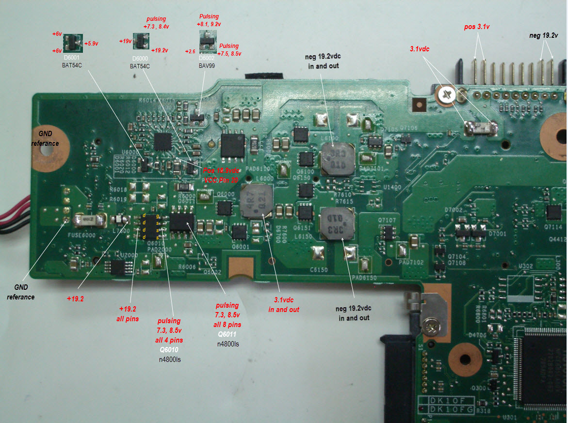

                  selldoor,
                  Please find revised photo with additional coils.
                  I was getting zero volts on L6100 and L6150 I reversed my test leads with Pos on the pos Pos in terminal, and neg on the coils and got 19.2vdc.
                    Right now if there is damages in the AC detect/charger section which is controlled by the IC U6000. If you are using the Batteries right now and it is still dead, then I believe that the MOSFET Q6012 (which is turned on when it is running on batteries, batteries voltage is applied to Source pins 1~3, the output comes out on Drain pin 5~8) is not being turned on by IC 6000. So try using the batteries to see if the computer will run (do not have the AC adapter connected).
                    Check the DC Voltage on the Gate pin 4 of Q6012 with good batteries connected (no AC adapter connected).
                      budm,
                      It does not turn on with battery and no ac adaptor.
                      I do get much heat on the large chip to the right on the detail photo. (I'm not sure of reference number)
                      DC Voltage on the Gate pin 4 of Q6012 with good batteries connected is 18.1vdc

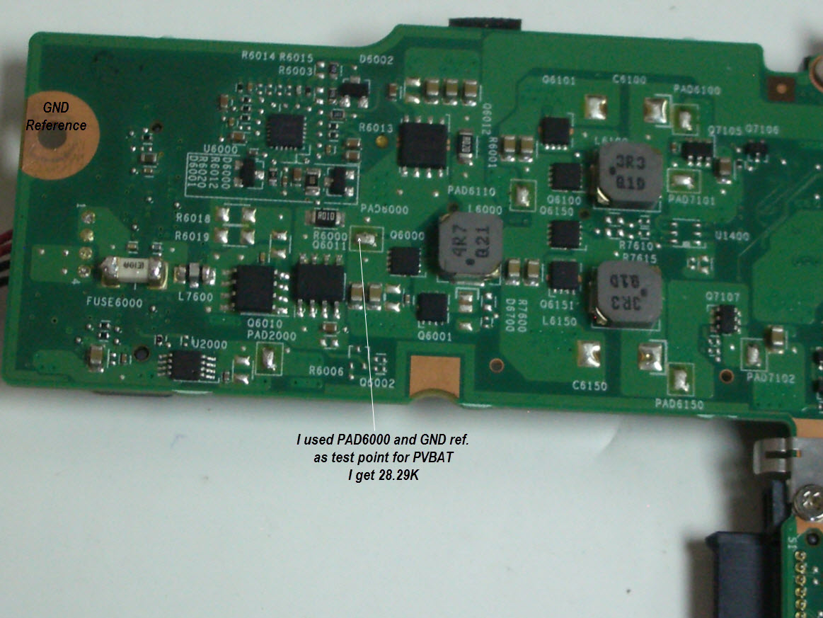

                        Remove the batteries and then check the resistance between PVBAT and Ground to see what resistance you are getting.
                        • tonylock
                          • Jul 2014
                          • 10
                          • Spain
                          Good Morning budm,
                          I tested between PVBAT and Ground, if I am correct on my ref.point and get 28.29K
                          Please check my ref point as I am not sure if it is correct.
                          Please see photo.
                          Thanks again for taking time to help.
