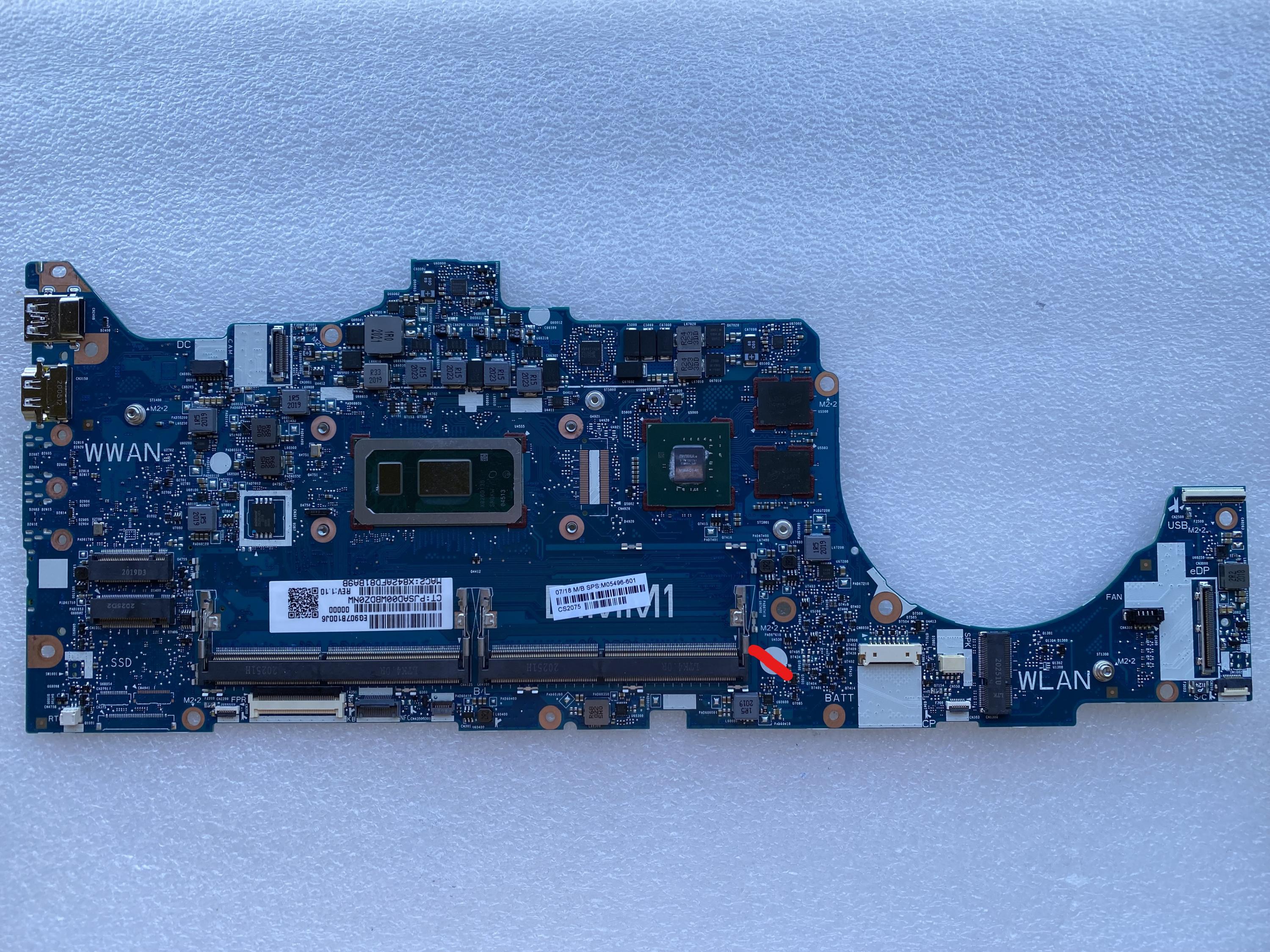

Hello guys kindly help me identify this component in the picture or if anyone has schematics then pls send it to me....Thankssss
Hp 850 G7 CAMELLIA 6050A3140901 MB A01(A1)

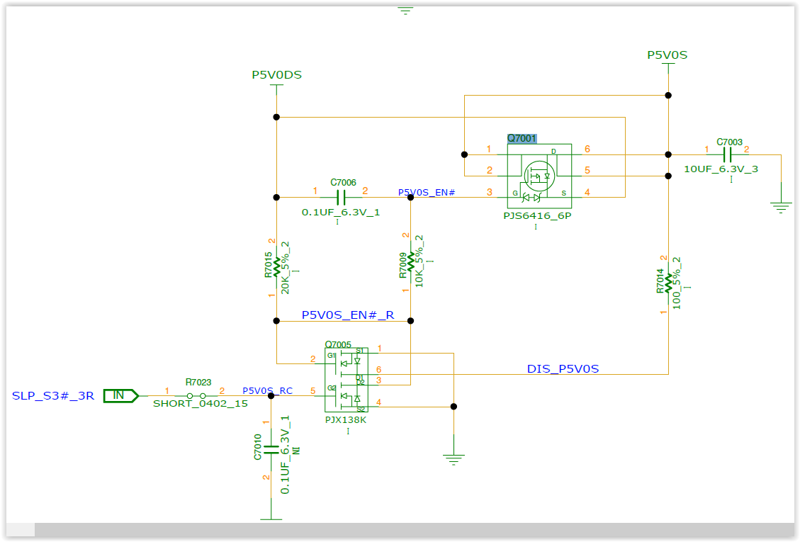

most likely ,
drawn with CAMELLIA-6050a3136201-mb-a01
which are not the same schemeComment
