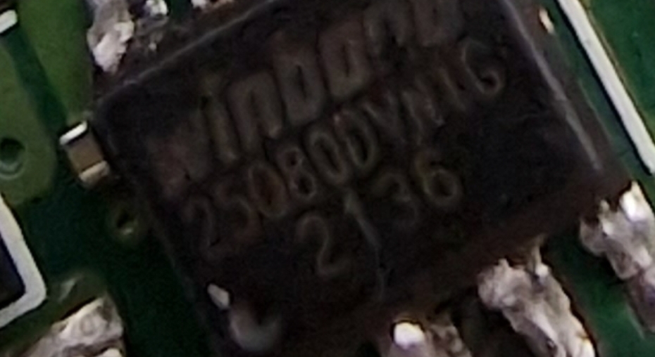

      Why you say that?
      This is the original chip

        This chip is 1MB! your chip must be 8MB, 16MB, 32MB or something like that.

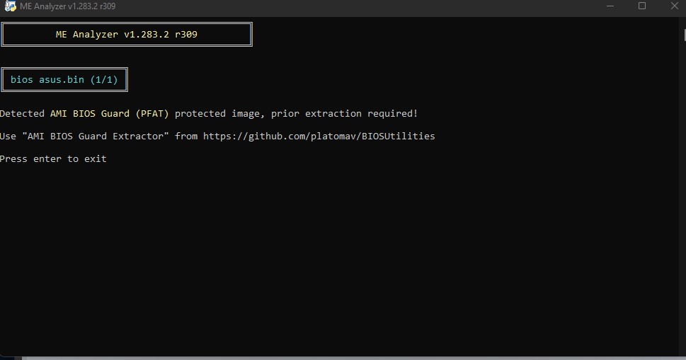

          Yes but it works fine if you write the bin on chip,i tried to use the bios from asus website but it has 27mb archive when extracted.
          The laptop is a asus vivobook pro i7 11gen . When i use MEanalyzer it says that needs to be extracted with ami extract

              Its 8 megabits ,which equals 1 mega byte. What youve posted isnt even a proper backup of the chip.The chip is for something,not sure what but could be for the thunderbolt or USB-C firmware.
              Did you make a backup before you overwrote it .As hardware1 said,the bios chip is somewhere else.

                AMI PFAT extract will only remove the PFAT header, it still needs editing to the correct size using a hex editor. It is not a full bios image,only an update, it is the bios region, there is no ME firmware,no flash descriptor. The update can/could be merged with your bios backup and the DMI copied (if you could find the correct chip... ) . Thats one way to get rid of the password,but there are other ways as well.
