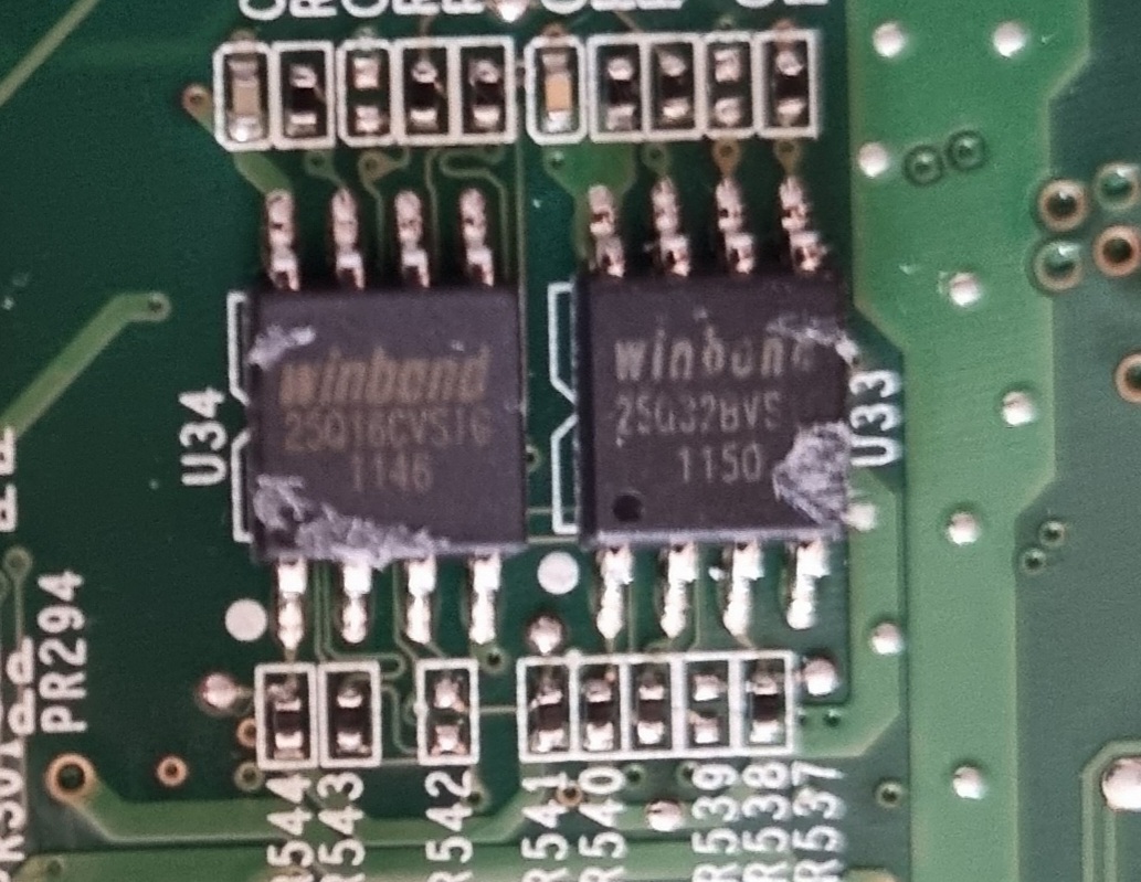

    hello
    I am looking for where to find the bios eprom on a Dell E5520 motherboard?

      There are 1 or 2 bios chips https://www.badcaps.net/forum/attach...0&d=1658397338

          Originally posted by SMDFlea
          where can i find it on the motherboard
            I looked and there are 2 biochips

                Re: Eprom bios dell E5520
                I can't dump the bios (the 2 chips) is it because of the password?
                  I succeeded in dumping the bios of the U34 chip but the U33 chip was not possible.
                  is this normal?

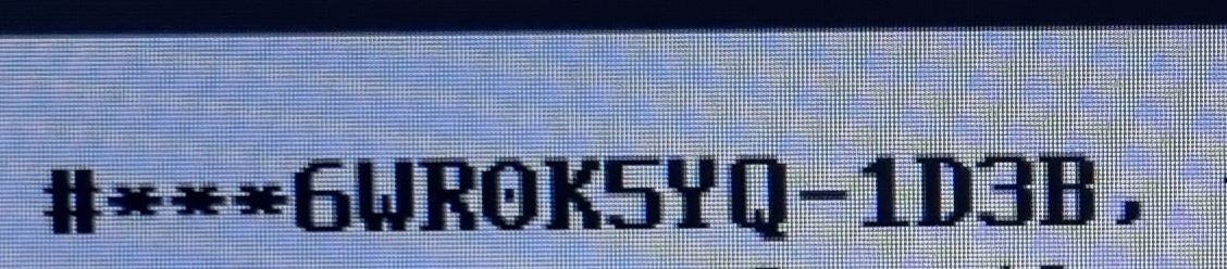

                  if you can clean me the bios, there is a photo that I can't remove
                    is this normal?
                    I successfully dumped the U33 chip
