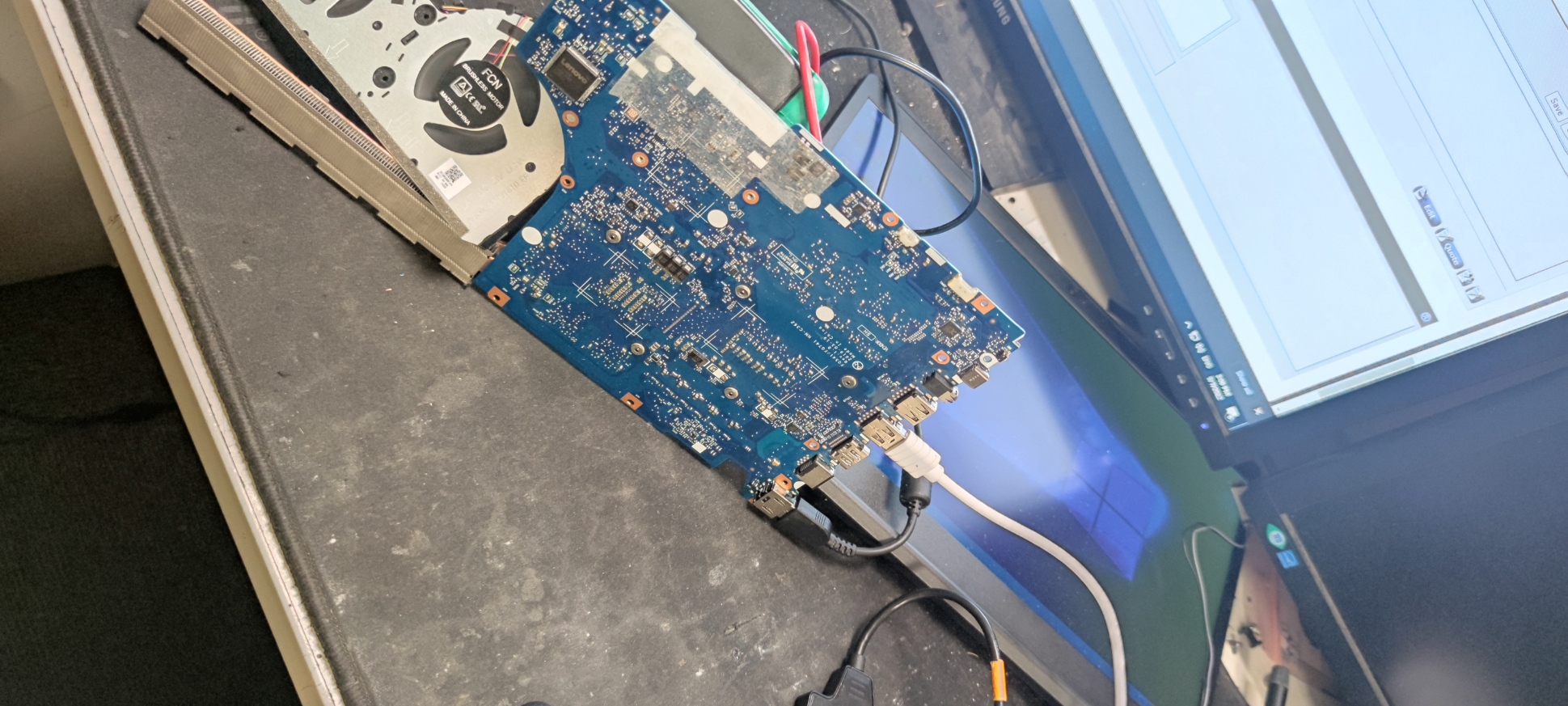

    Hello, i need a new (rebuilded) bios for lenovo l340, can anyone help ?

    post your serial number

        motherboard ref !

            Nm c361 !

              NM-C362

                i find this , try and report

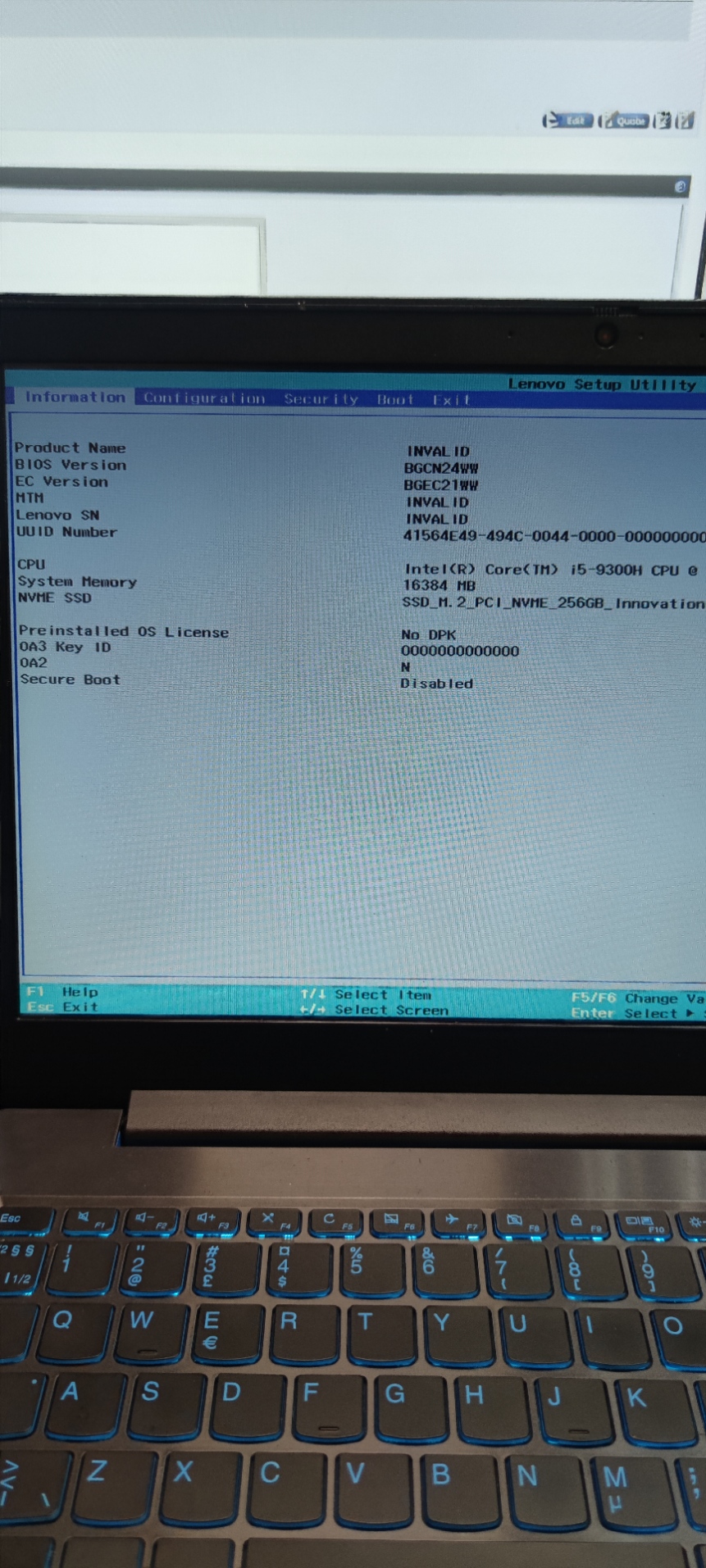

                  Now turns on, works for few seconds (showing lenovo logo,lets me go to the bios and etc.) and turns off.
                  Before it will turn on and work for few seconds and turn offs.
                  solution?

                    Sorry for double message.
                    After some time it seems to be fine, turns on and works perfectly.
                    after some more time does it again.

                          Sorry for late response, i was sick.
                          Turns on, works for longer, still stutdonws itself.
                          BTW Lan port is not working.
                          P.S. Maybe this is version issue? Becouse EC and BIOS versions are different?

                            P.S.S. after flashing new bios and ME firmware (From Lenovo web) still doesn't work, i think it is hardware issue. Situation : Completely disassembled, when i put board on table does same thing, but when i put board vertically, computer works fine
                            EDIT : hardware issue, fixed. Computer working.
