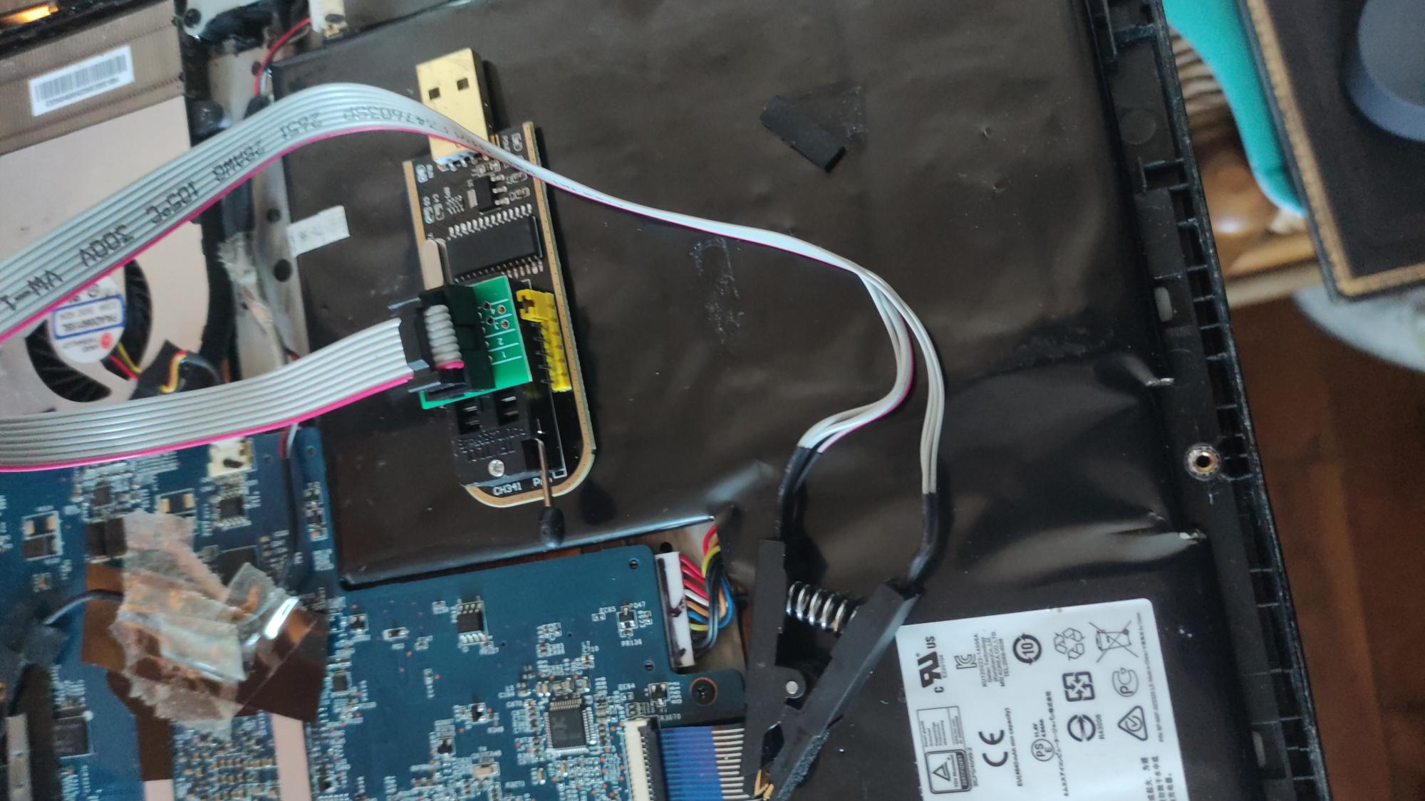

      Hi everyone, can someone please help unlock this
      Service TAG: G81JGK3
      Bios version: 1.17.2
      G81JGK3-8FC8
      Laptop: Dell Latitude 5420

        You have read chip bios failure. File is corrupted.
          what should I do?

            Originally posted by goool-007
            what should I do?
            What model is your programmer ? ,a CH341A (and what software version) or EZP**** , and are you using a clip ,a pogo pin adapter or have you desoldered the chip
              i use As Programmer, because i found SPI (WINBOND W25R256JV) only in this programmer. i use a clip.
                The chip is WSON 8x6 ,the clips only work with SOP8 chips. You will damage the chip using the clip. Solder wires to the solder blobs or gold pads.Your other options are to buy a WSON pogo adapter or desolder the chip and solder it on an adapter board.
