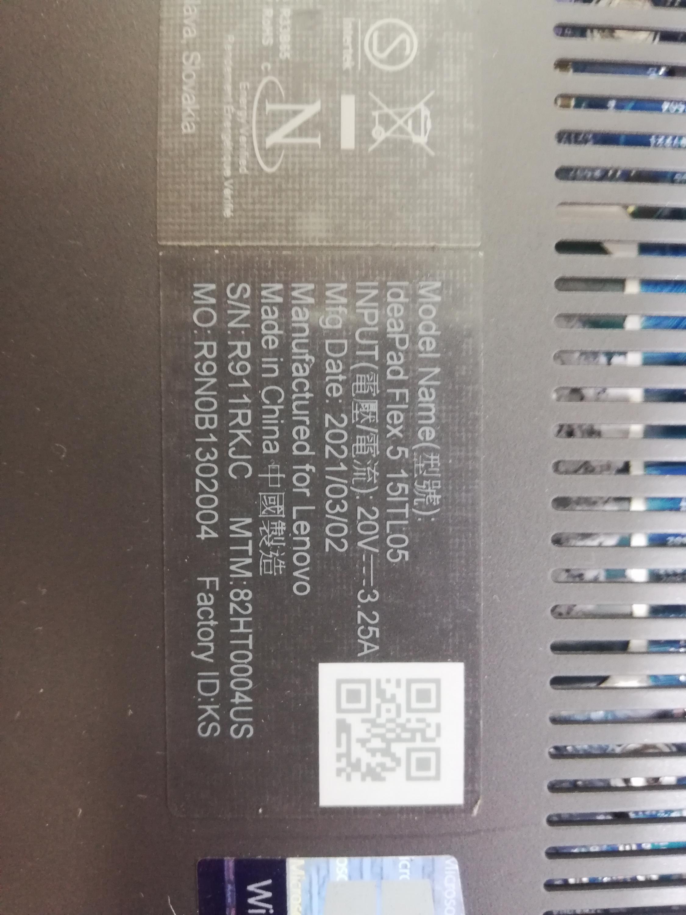

              lenovo Flex 5-14ITL05 LC56-14T 203013-1 bios
              need to fix this bios plz
                • 22077
                Re: lenovo Flex 5-14ITL05 LC56-14T 203013-1 bios
                Serial number ? ,Model Type ?
                • teto8485
                  • Nov 2016
                  • 64
                      no power not working i try an other one working but didnot read m2 hdd plz hellp old bin no data the oreginal bin
                        • 22077
                        ok
                        As its a 5-15ITL05 and not a 5-14ITL05 your posts have been moved to a 5-15ITL05 thread.
                        Different Model Types can have different bios versions ! You can find which bios version you need by entering the laptop serial at Lenovo support,then looking at the bios update version number.You can check that number by looking at your own backup with a hex editor,and searching for the same FXCN .If you ask for more help in future it does save us time if you post the serial and/or the model type
                        try this one
