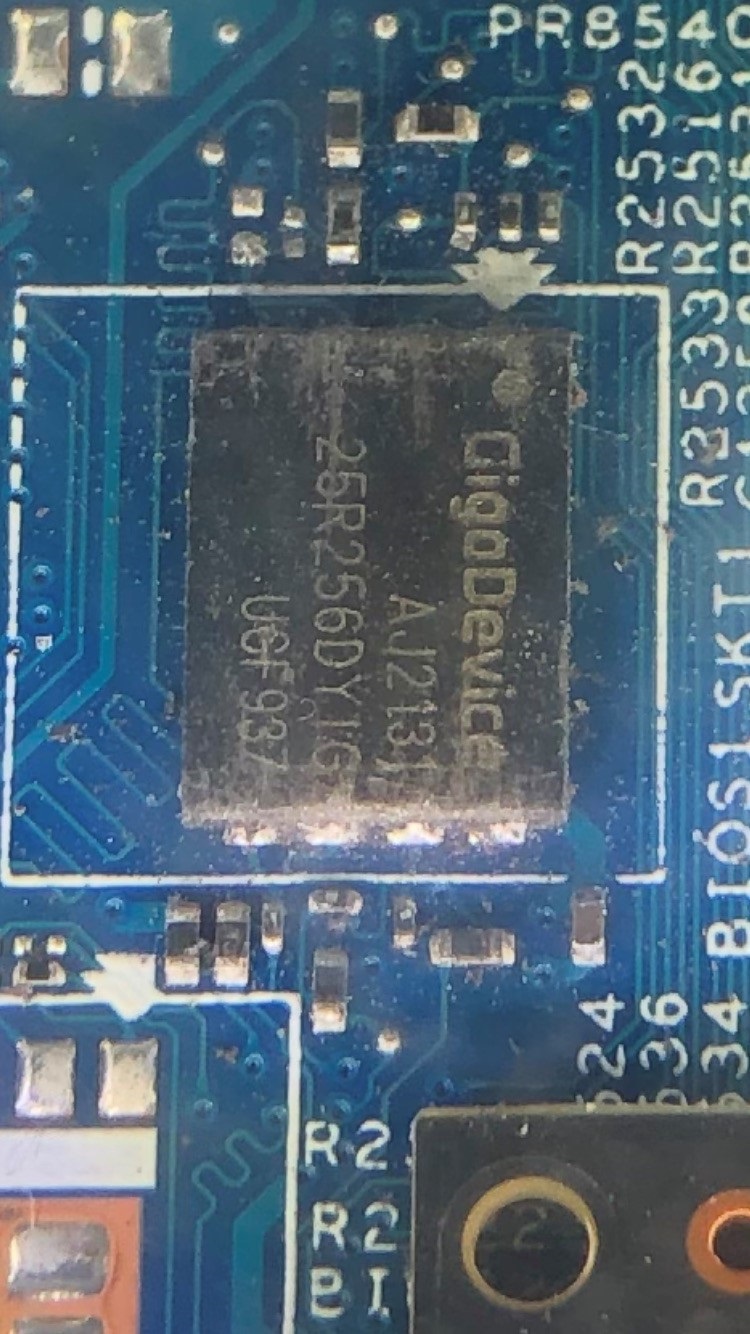

      • tigger19
        • Jun 2023
        Re: Lenovo Ideapd 5 15ITL05 Bios request
        We bricked the BIOS after a failed update
        The Laptop is a Ideapd 5 15ITL05 82 HS
        Serial: PW008SBX
        Here is a backup of the bios.
        Every time I go to load this we get a "data size is too large for the chip" warning. I am unsure what to trim in the file.
        Also I believe this is the bios chip, but just wanted to confirm (see jpg)
        We would really appreciate any help. Thank you.

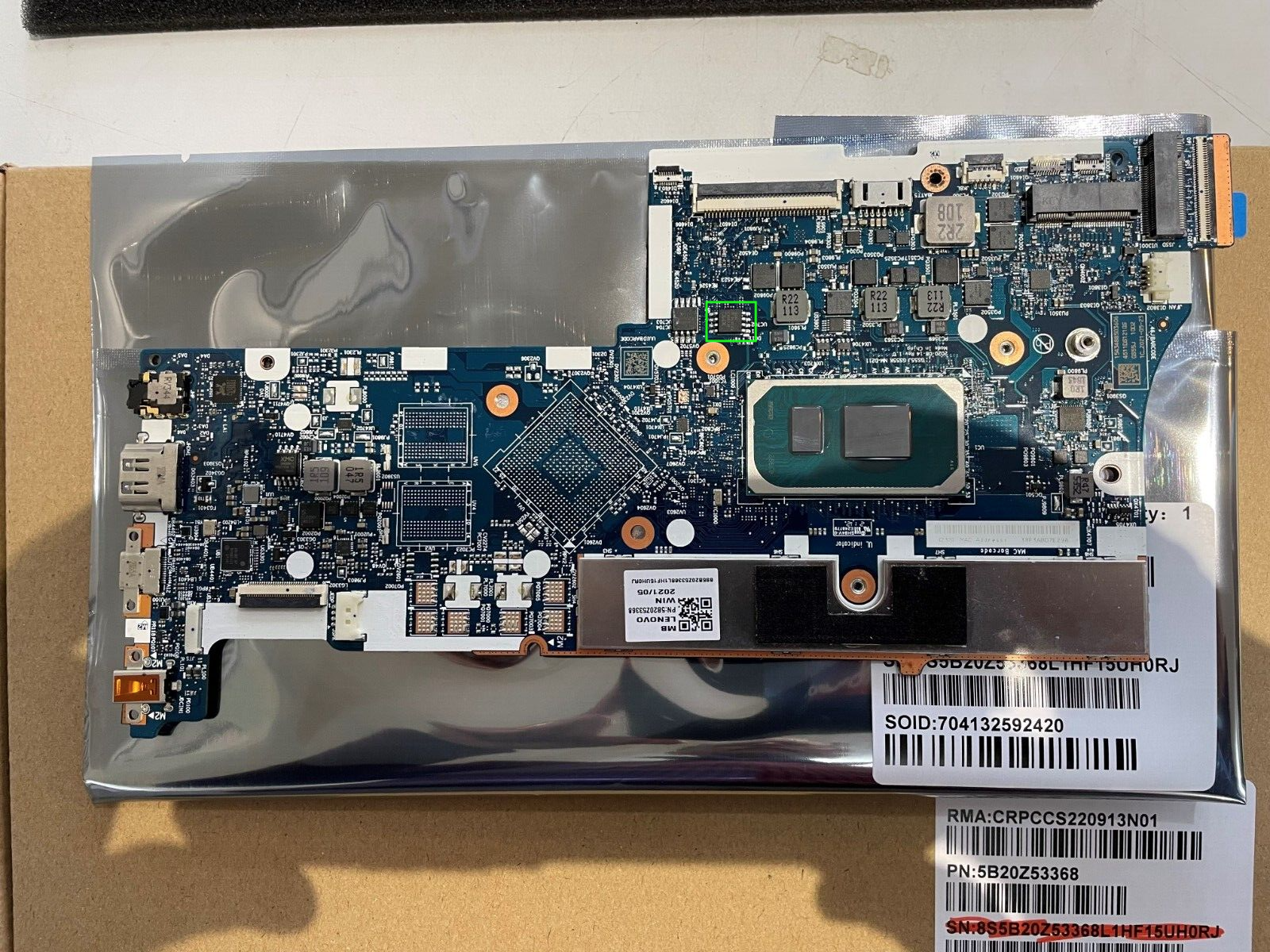

            Hello Guys,
            Kindly need your support to provide the working bios, there is no display on the screen when i turn on the laptop.
            Model: Ideapad 5-15ITL05 (Type 82FG)
            Serial Number: PF3TY1KW
            Machine Type Model:82FG01P1AD.
            Please see the attached .bin backup ​

            Originally posted by BenSor
            Hello Guys,
            read also UC702 and post dump. You posted same dump twice.
                I tried the dump files here but same issue no display
                backup UC702, 2nd bios chipset, and post it here.
                    Hi Volinakis,
                    Please see the attached UC702 bios chipset backup.
                    try. 1st is your current bios with clean ME, 2nd is bios extracted from update.
                        I tried the both files but not working,
                        fan won't spin and no display.
                        you have to write both chipsets, did you do that? outimage(1) is for UC703 and outimage(2) is for UC702
                            Yes, I did. First, I tried the Clean Me Outimage1 for UC703 and Outimage 2 for UC702. The same thing applies to the new BIOS.
                            When I turn on the power, the power light and fan do not spin.​
                            it seems there is a hardware problem, not bios.
